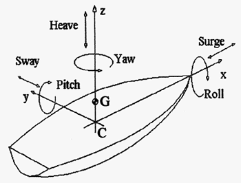

Nomenclature of movements in SimTools
Pitch is the tilt of the car forwards or backwards in [°]
Roll is how much the car is dipped to the left or right in [°]
Yaw is the heading of the car (north, east, south, west) in [°]
Surge means the acceleration of the car in longitudinal direction [g]
Sway means the acceleration of the car in lateral direction [g]
Heave means the acceleration up and down [g]

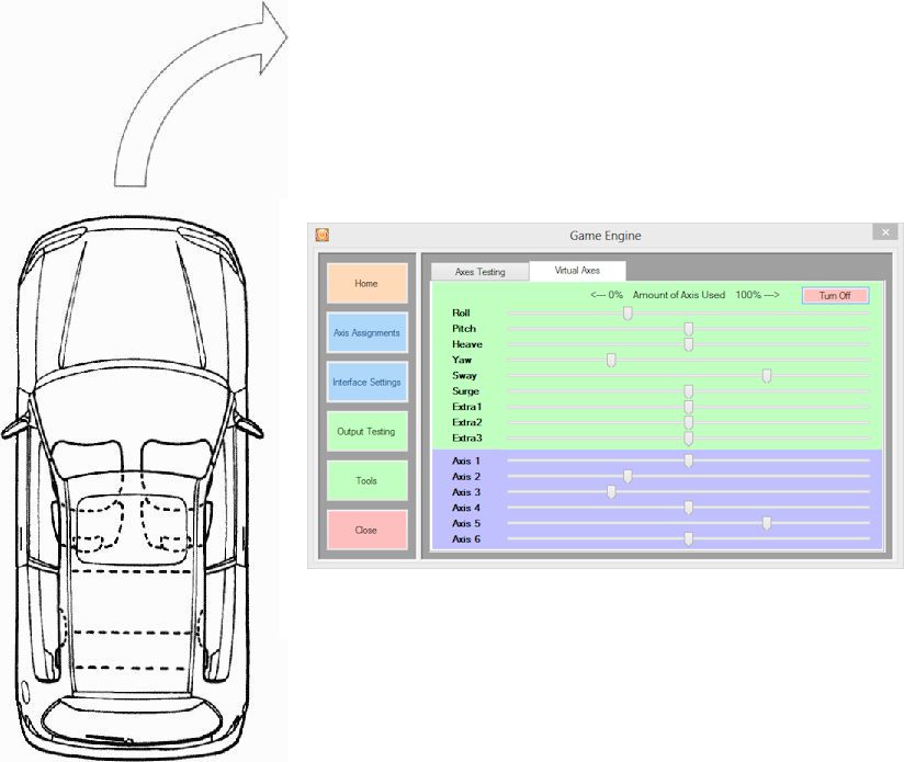

Right turnroll slider moves to left, sway slider moves to right, yaw slider moves to left
Turn right

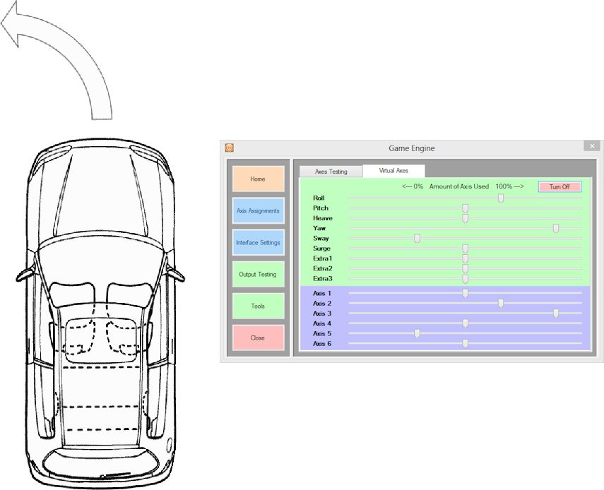

Left turnroll slider moves to right, sway slider moves to left, yaw slider moves to right.
Turn left

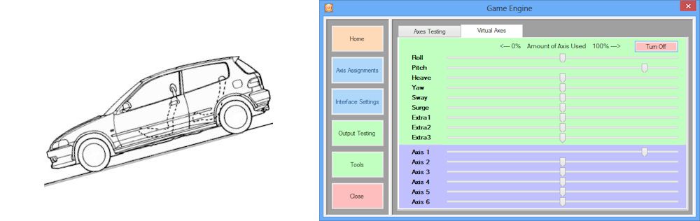

Driving downhillpitch slider moves to right
Downhill Slider Pitch
Driving uphillpitch slider moves to left
Uphill Slider Pitch

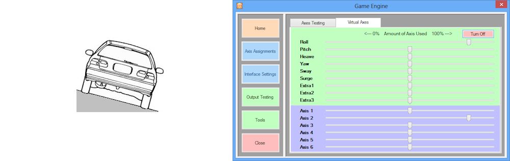

Tilted to the leftroll slider moves to left
Tilted left Slider Roll

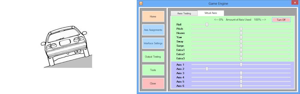

Tilted to the rightroll slider moves to right
Tilted right Slider Roll
