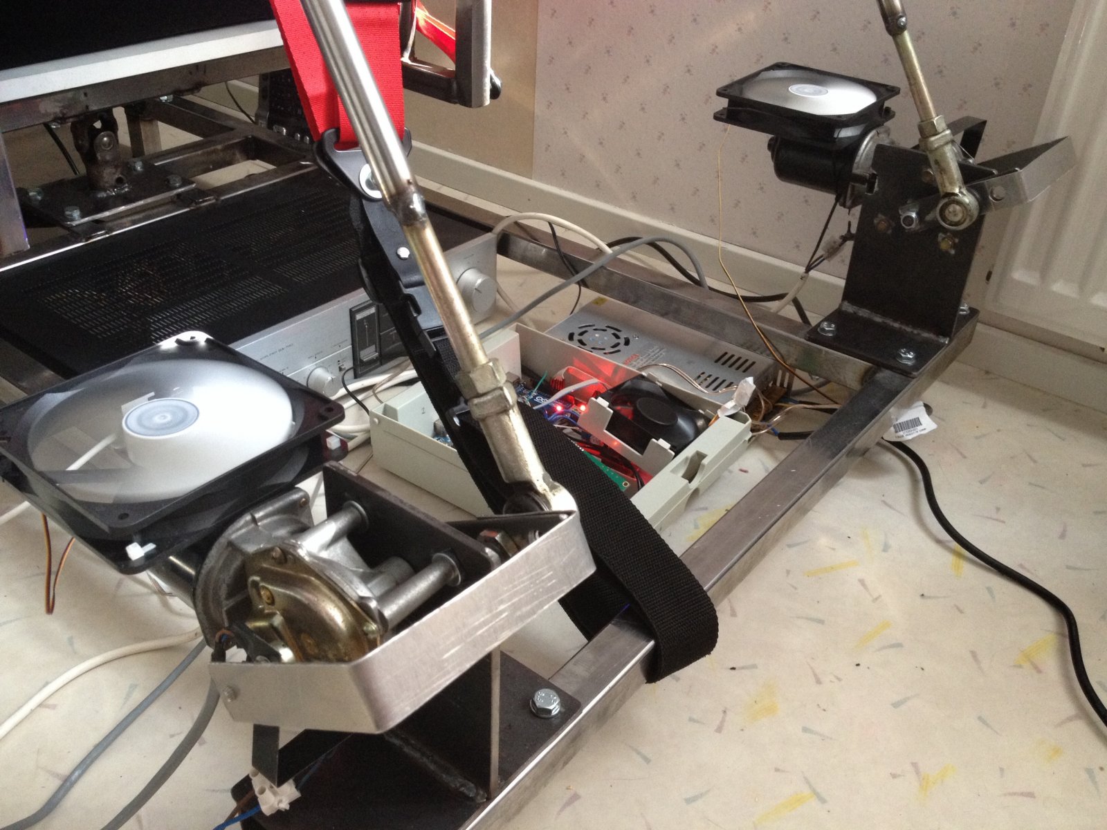

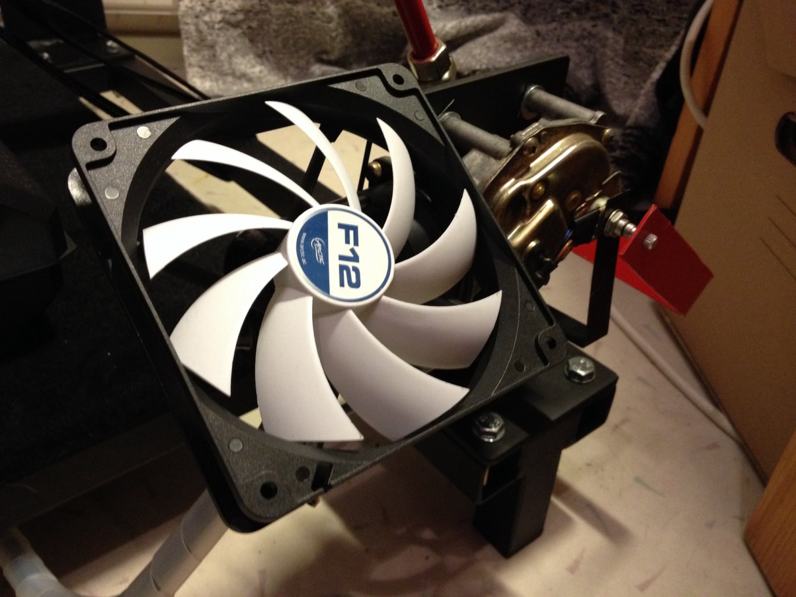

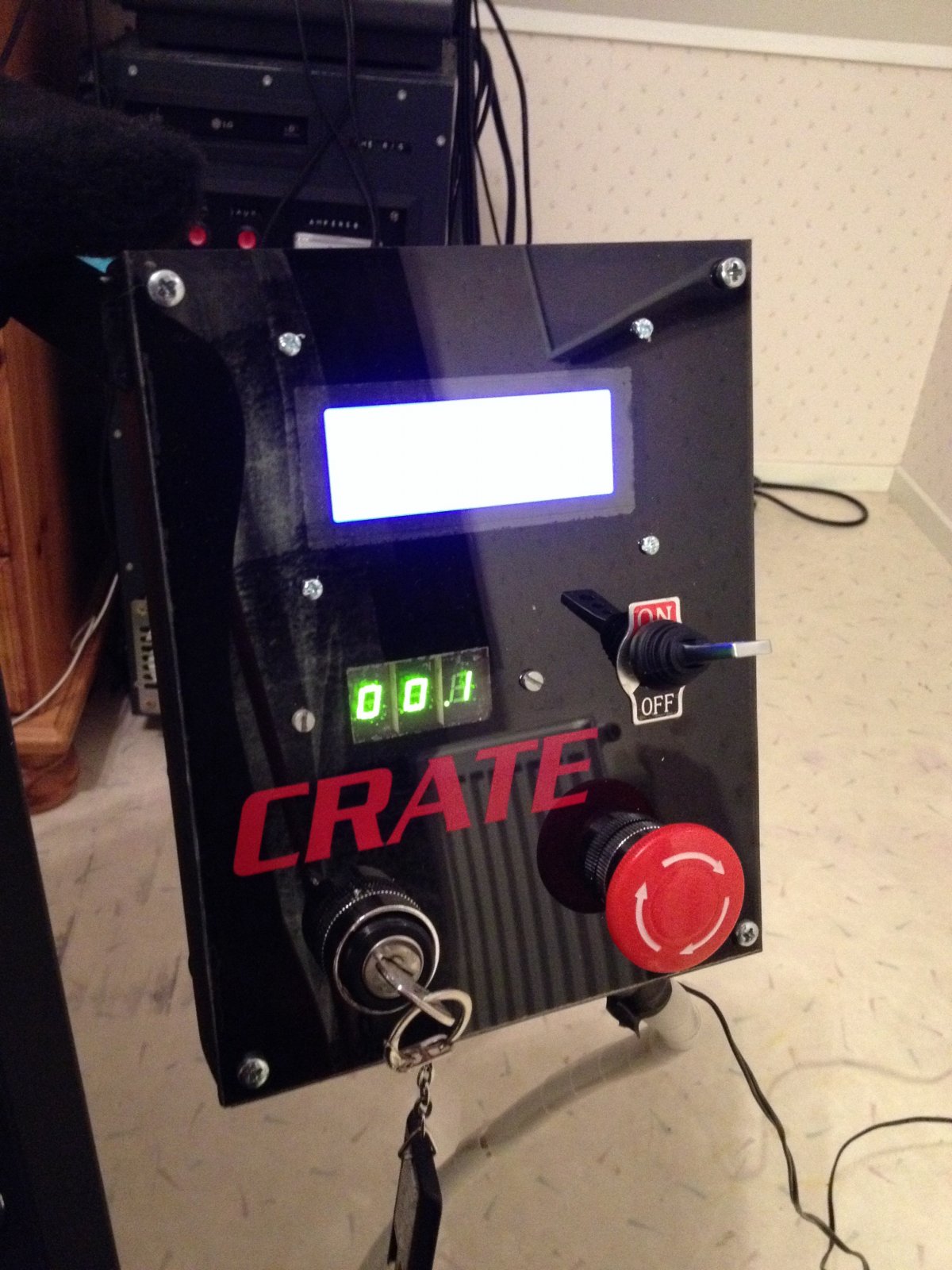

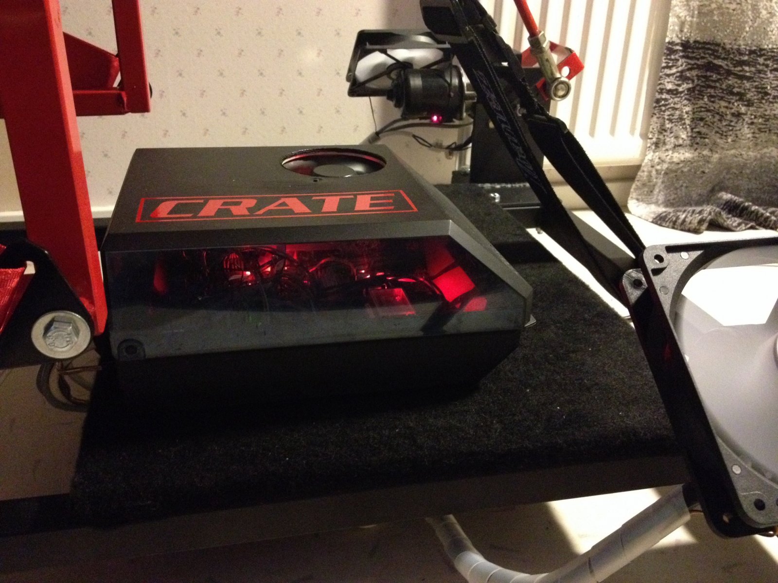

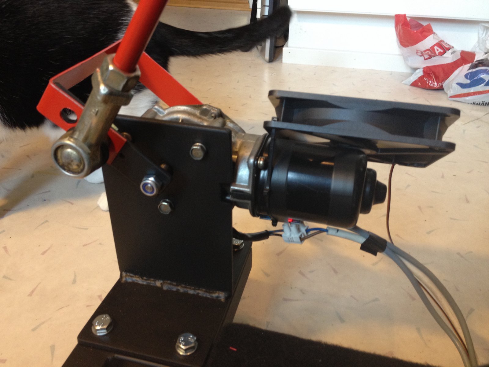

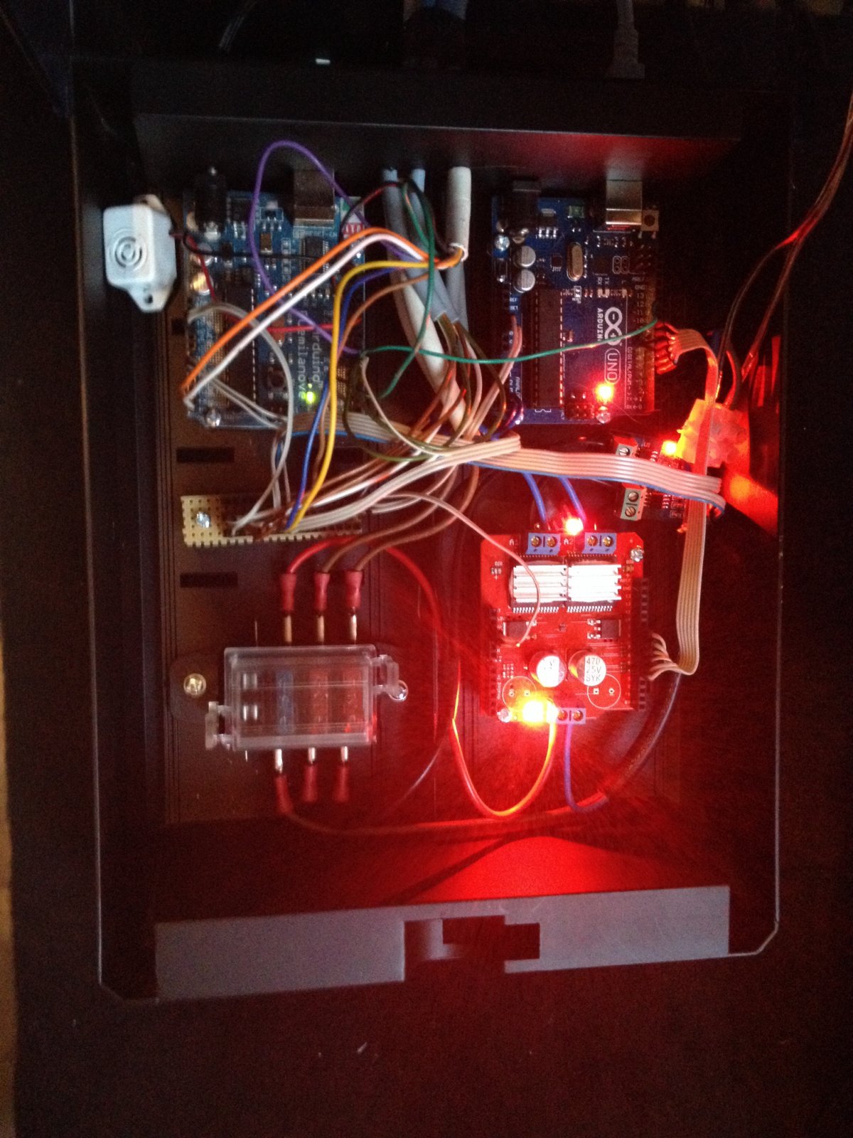

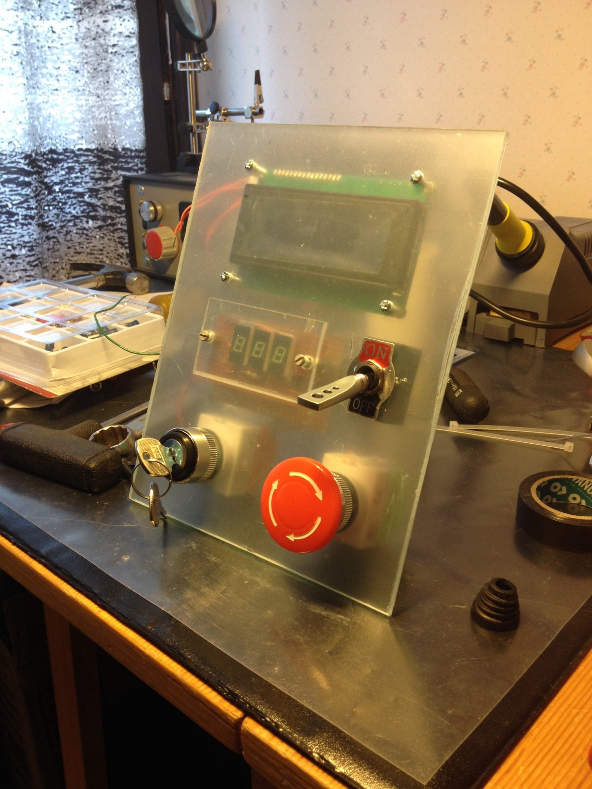

    Heat is the problem, it's almost 30 degrees celcius inside our house, computer room naturally more with all this stuff running. Added fan to both motors and started to build that switch/displaypanel so I would know what is going on during driving. Also added 15A fuse before H-bridge. So I know motors haven't drawn together over 15 amps by now, that is comforting and surprise actually. My PSU is just 30A, it drives two motors and I was planning to use a car battery with it to be sure, but it holds without it!
    Fans installed
    Added fuse box, no monitoring connections yet
    Control panel
    Edit. I think I opened this thread at the wrong section at the beginning... Is it possible to move this thread to the projects section?

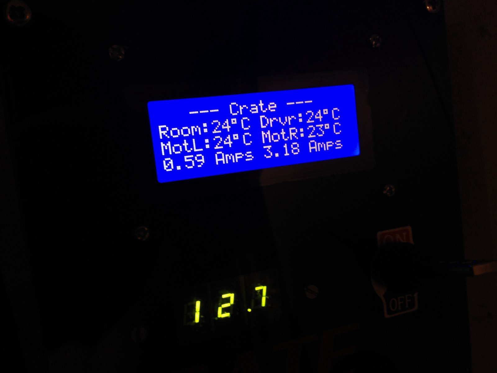

    Well, there actually WAS one problem: I'm not sure what is causing it, but two times my right motor has died for a couple of seconds but comes back to life and works rest of the session (hours) like nothing happened. At both times there wasn't particularly harsh situation, no big moves. I see my peak amps and temps from the lcd, max amps were about 12A on the right motor and 9A on the left. Temps about 31 celcius on the surface of both motors (room temp) and 41 celcius under the H-bridge.
    About the amps, I'm really surprised that motors are not drawing more, compared to what I've been reading here on xsimulator. And I actually put 15A fuse before H-bridge and 10A fuses between H-bridge and motors, none have blown yet. And I'm driving both motors with cheap 360W ledstripdriver. Without a car battery. Maybe that has something to do with the problem, maybe H-bridge shuts down the right channel when PSU cannot supply enough volts or something? I see volts fluctuating when rig is in use.

    The reason I use a DC battery in conjunction with a psu is that the Jrks (Monster Moto has the same H Bridge on it) will feed back the current generated when the motor goes into freewheel ( On a down stroke ) back to the battery with just a psu (an unprotected) I found the psu not liking the voltage being feed back to it. But a lot don't use one too, so might not be your problem, Motors not getting hot, brushes in motors still good ?

    Thanks @eaorobbie for your response. Motors get warm, but not hot. I may need to open them and check brushes.
    Problematic right motor feels actually more "solid" than the other one, it is stiffer to rotate by hand and feels newer than the other one. But both have same speed and they sound the same. Sidenote: I actually really like the sound of them :) rig sounds like a robot from anime movie :D

    If possible I would be looking for another wiper to test, and another issue a few have found that the Chinese copies of the Sparkfun Monstor Motor board can have faults too and some have had no issues with them, luck of the draw, I buy genuine only sometimes not worth the headaches another note V1 of Sparkfuns board had pin outs labelled incorrectly, I know this because I got one and blew up one side of it. Are you using a fan over it too, Jrks play up after about 10min if no fan present. Truth theses boards and not entirely designed to do what we do with them hence good heatsinking and cooling is a must. Beware heatsinks can not touch each other too, cant tell from photo. Check all your connections too, maybe a wire getting hot which will show a short is happening somewhere.
    Sorry that's about all I can think of that could be causing the issue , look for the simple thing , normally the one causing the issue.

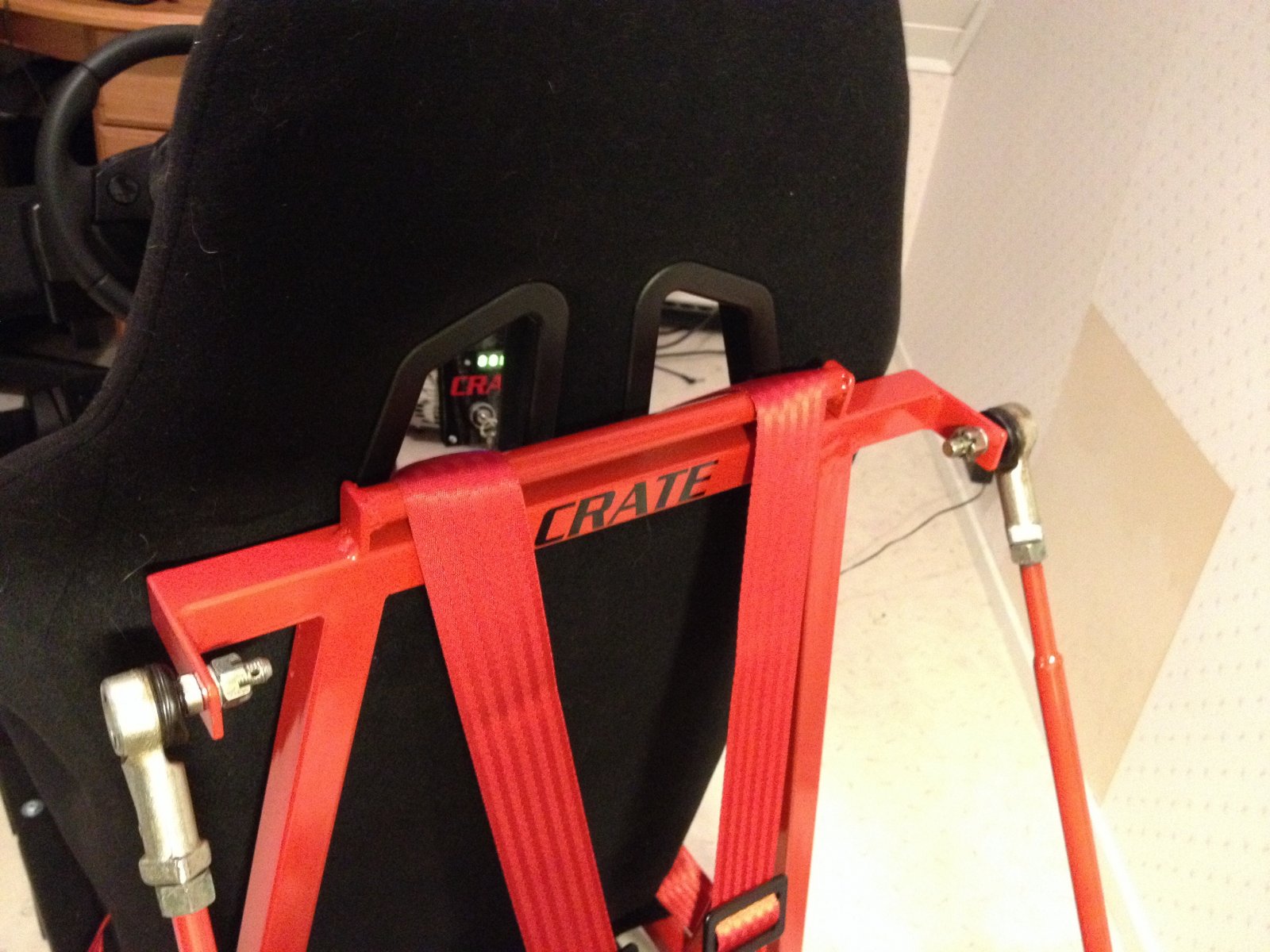

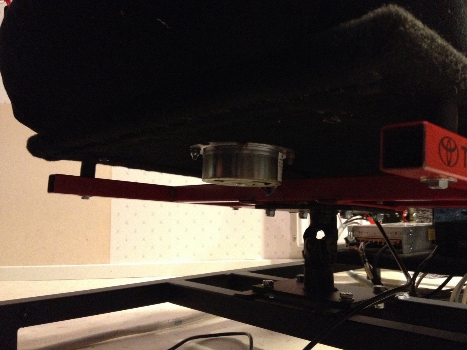

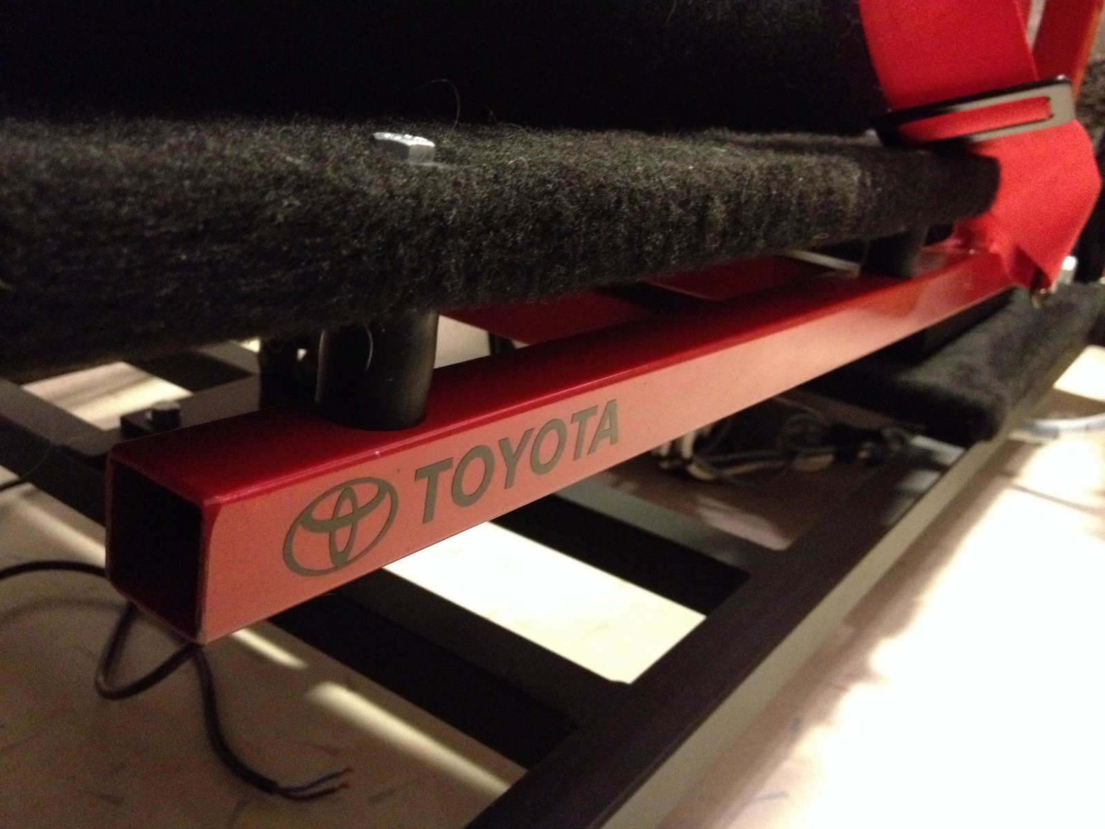

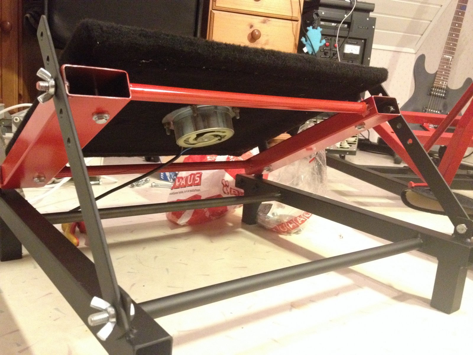

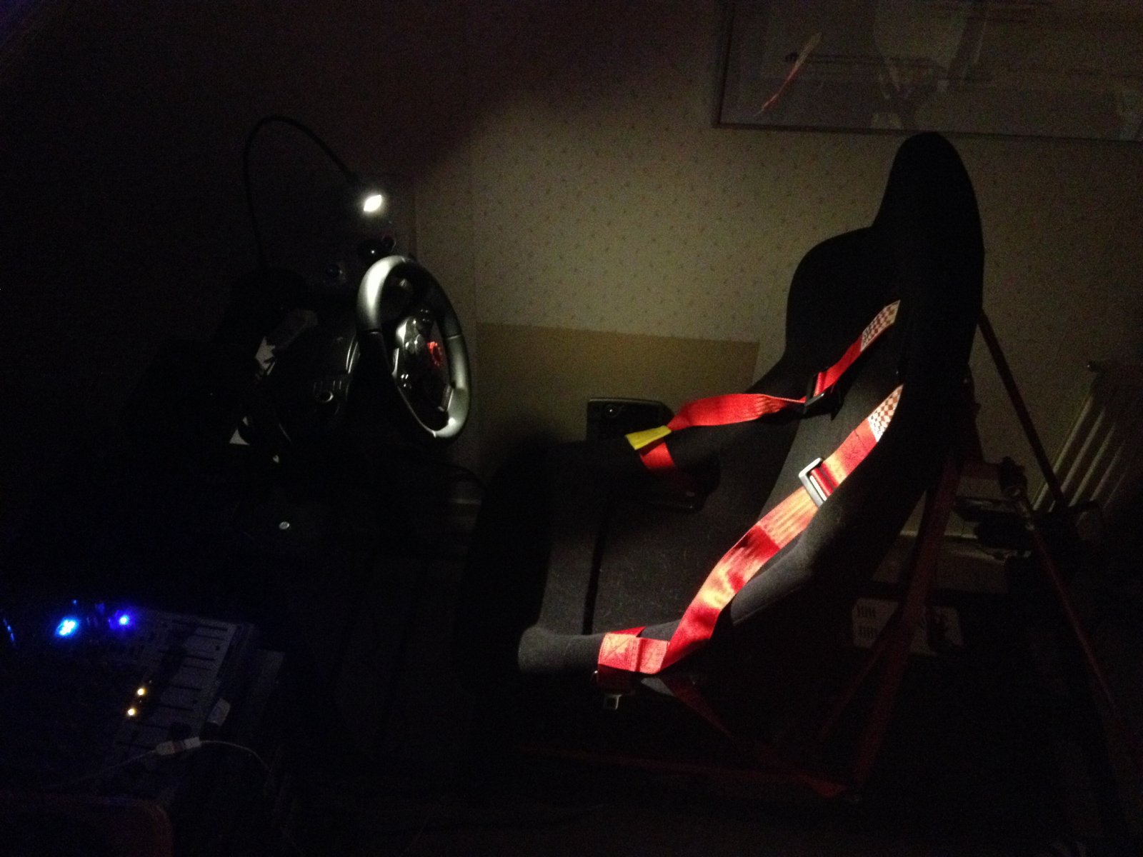

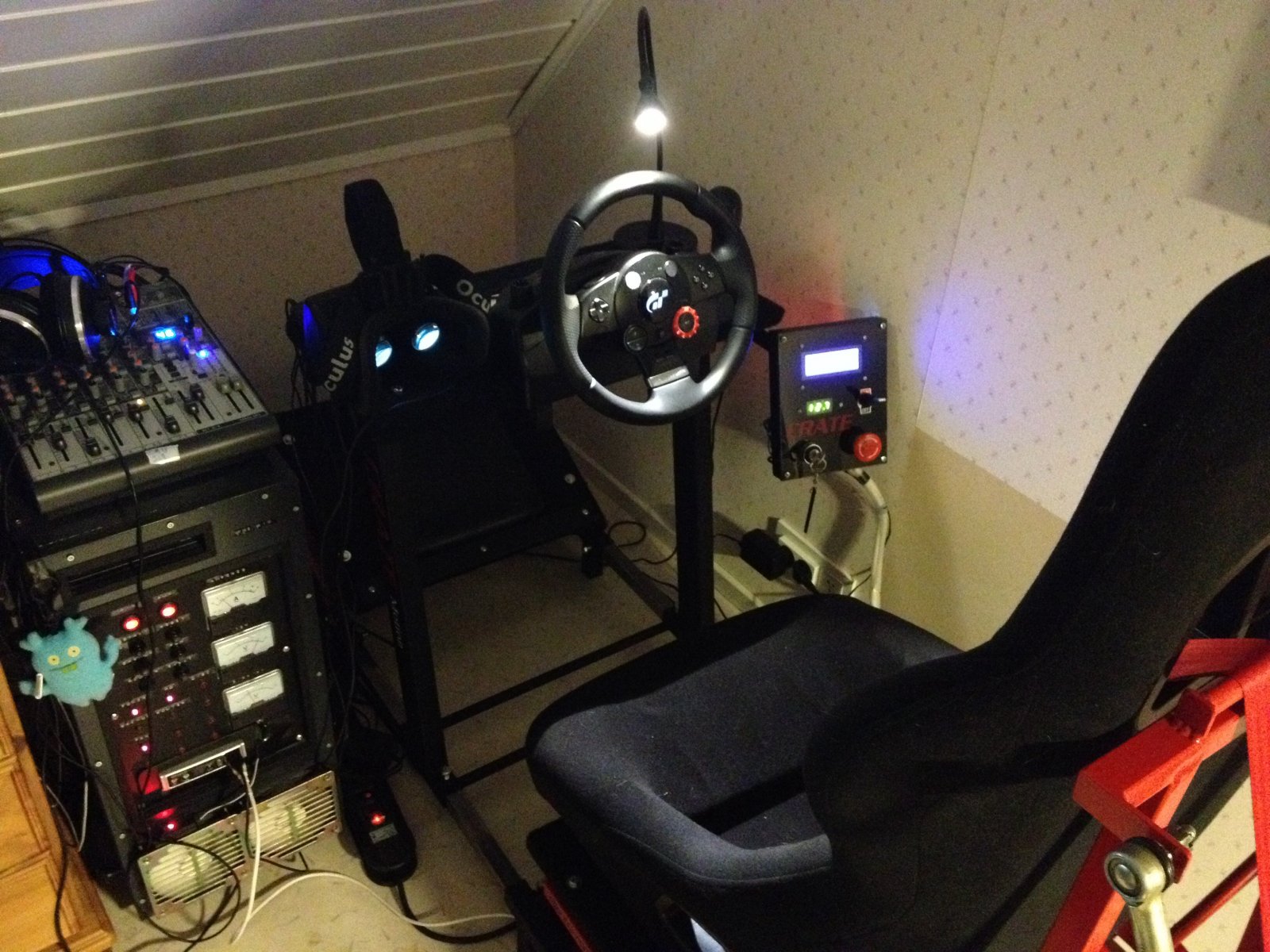

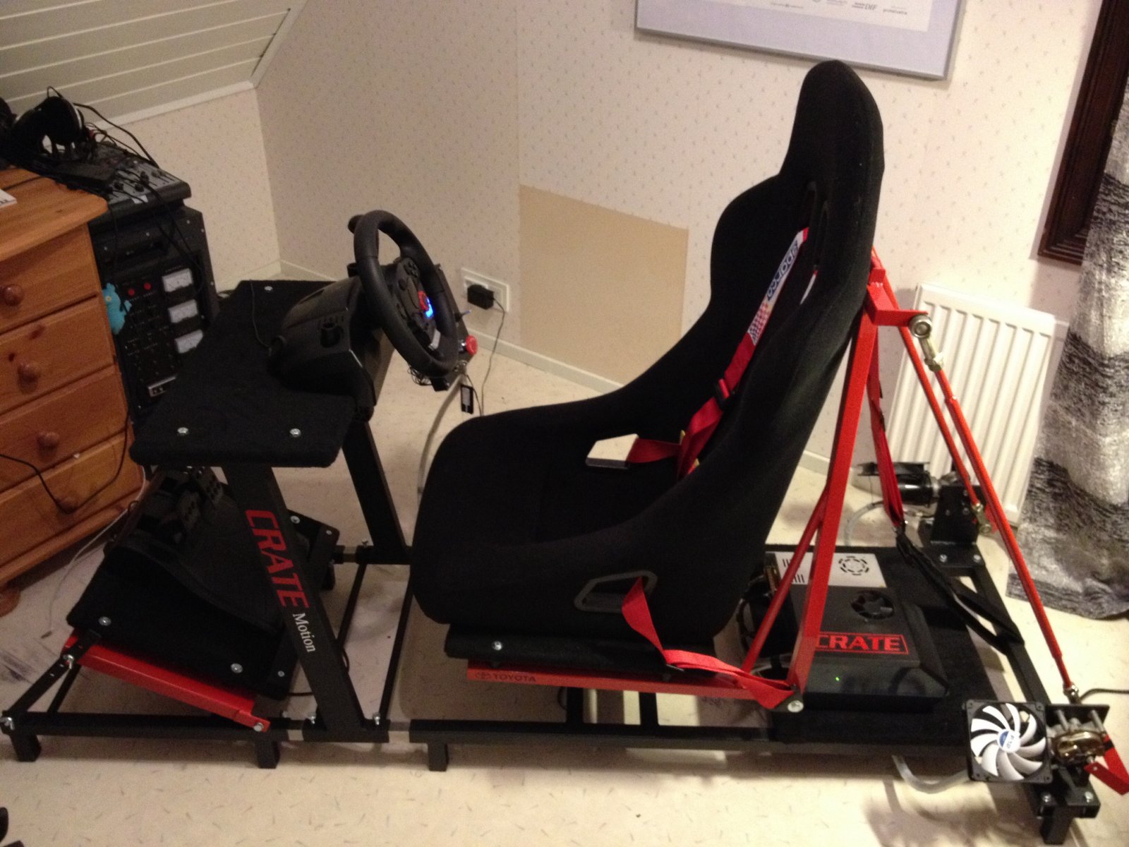

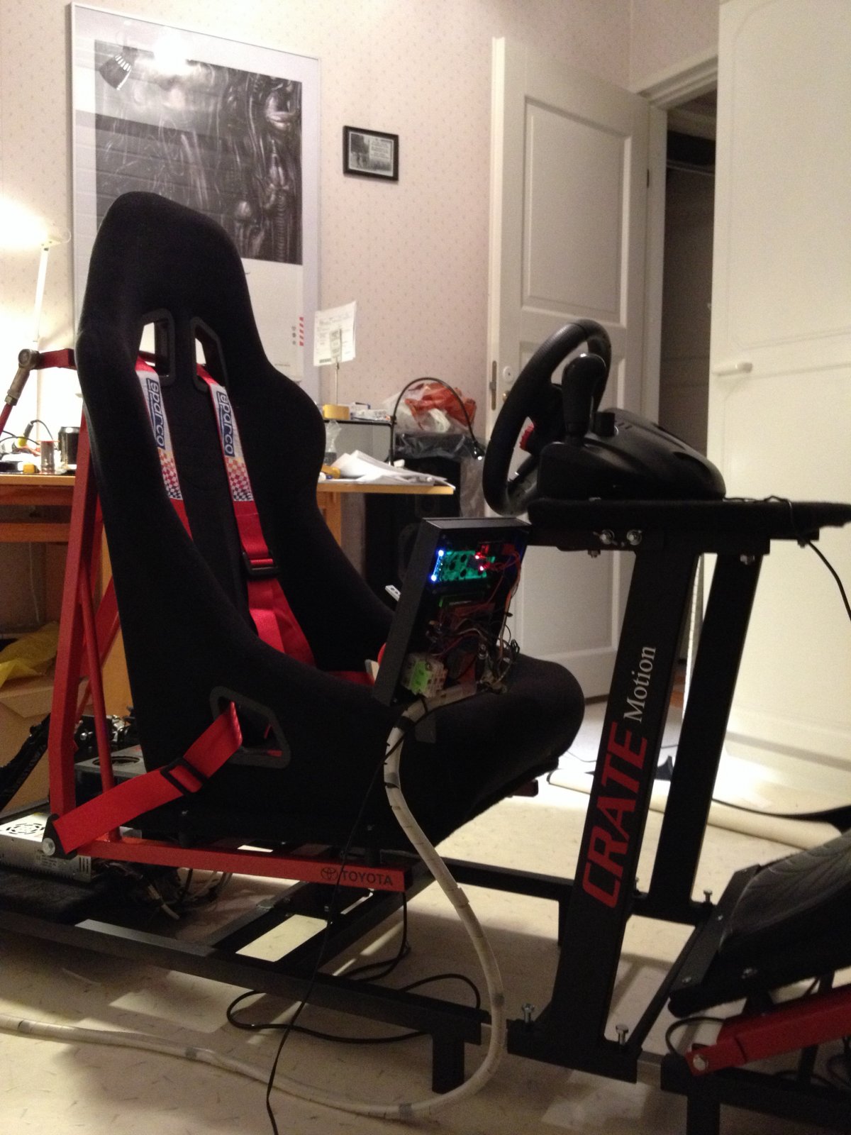

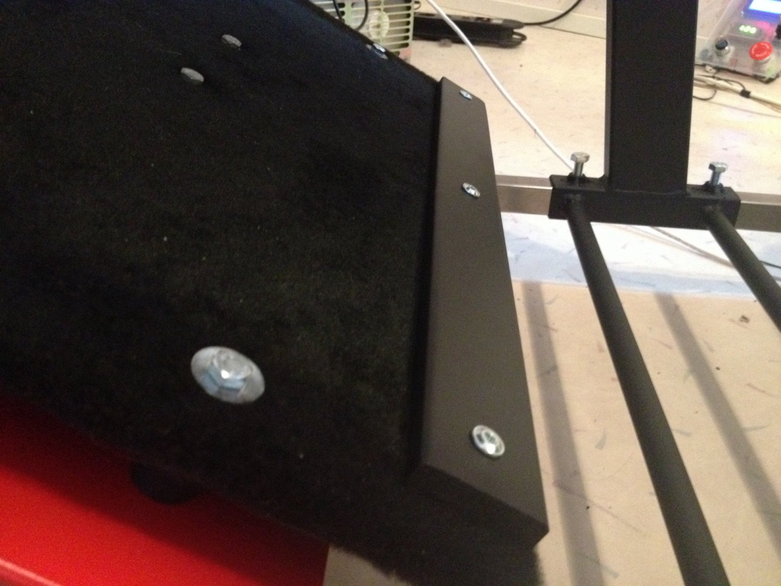

    Yup, after about a half a year the rig is ready (are they never). Little things need yo be done here and there, but overall, it is ready.
    image.jpg image.jpg image.jpg image.jpg image.jpg image.jpg image.jpg image.jpg image.jpg image.jpg image.jpg image.jpg image.jpg image.jpg image.jpg
    This has been a hell of a journey. In a most positive way possible. I've learned so much during the process and had so much fun.
    Again, Racingmat, bsft, Historiker, eaorobbie, SeatTime and all the others I forgot to mention and feel guilty about it in the whole xsimulator community, I thank you for making this possible.
    I am actually thrilled to realize that now I have my own motion simulator in my home! It was just a dream half a year ago...
