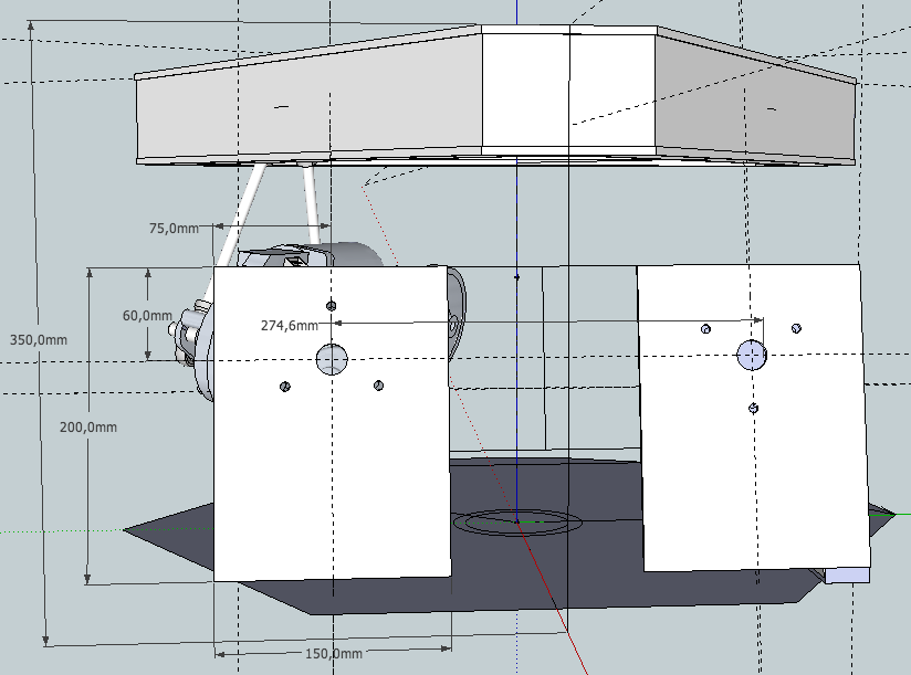

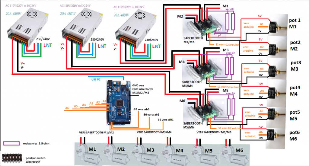

    Hi everybody
    here I have plans to make a 6DOF simulation engine 24v smolka, I think it is feasible and here is the material that will be used and not be modified.
    materials:
    -6 24v engines smolka
    -6 10K potentiometer without stop
    -1 Map Arduino Mega
    Sabertooth 2x32 -3
    -3 Power supply 24v 20a
    -12 Kneecaps 10
    -12 Thread rod 10
    -6 Bearings bearings 12
    For the rest of the materials is recovering, the plateau of the triangle is aluminum, base MDF with metal structure to stiffen.
    The use of spring is necessary in view of the engine power, this will help to alleviate the displacement and during the change of resistances since they adapt more deliver heated too much, so replace with 2.5 ohm against 5ohm originally.

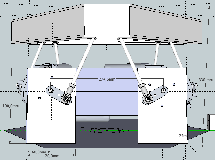

    The angles and movement made by the board.
    Sway (2 rear drive off): middle / right 8cm
    left / right 16cm
    surge: center / before 8cm
    Back / Forward 16cm
    pitch: 15 ° angle
    roll: 10 ° angle
    heave: medium / low 4cm
    Low / High 8cm
    yaw: total angle 40 °

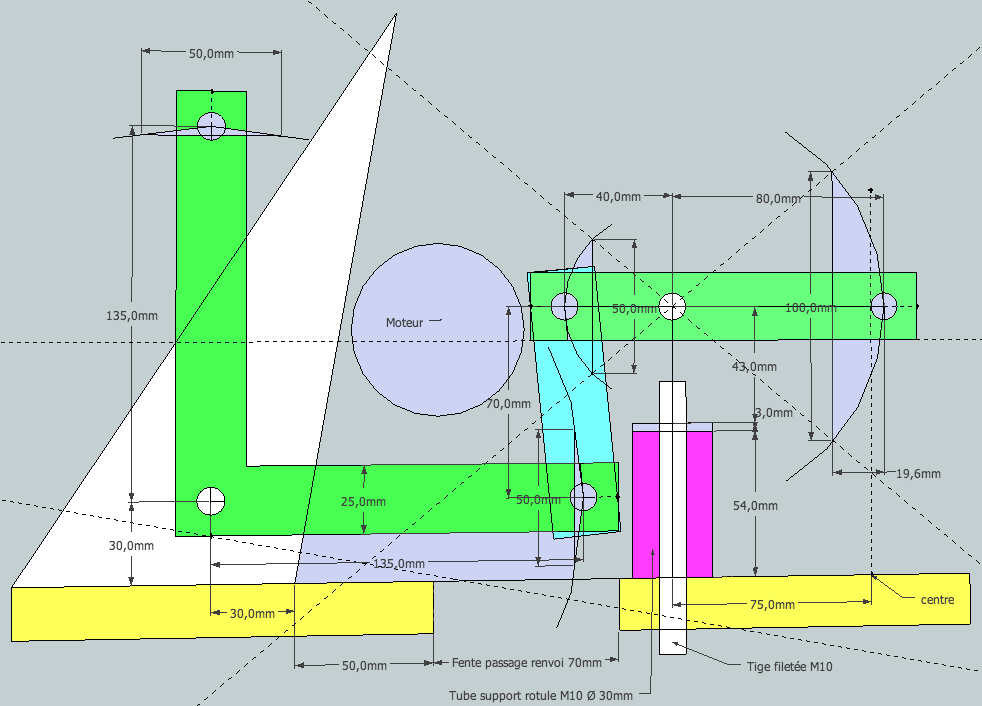

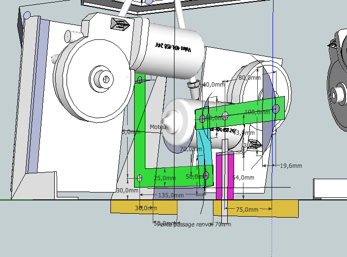

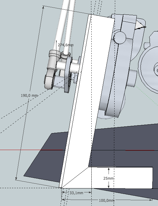

    Here is the wiring diagram.

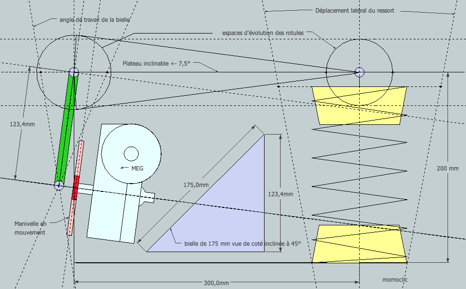

    Pattern and size:
    An inclination of 10 ° was given to engines in relieving mechanism.

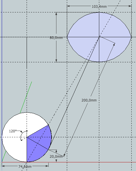

    The crank system with a 20cm rod, angle of 30 ° down to a working range of 120 °

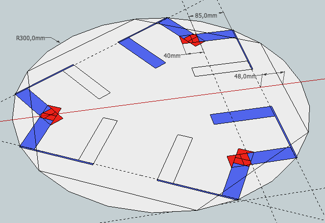

    Manufacture of the triangle:
    A hole the drill was done to the place where it is the folding of the bar to ensure that it will flex cracking, but in my case the hole was not big enough of his strength has made the angle bending.
    Cutting the bar to get a 120 ° angle of 60 ° was therefore withdraw to the logic 180
    And here the plate with rivets to assemble it all, there is one of each dimension, remains every corner of the support the same technique.
    Reinforcements at each corner of the triangle.
    Cut a metal plate to make three dish that will at each end of the triangle.
    And 3 pieces or it will house the kneecaps.
    Each of the support sides are 50cm.
    Cutting parts or will set the ball high for a 10 ° angle as the engines will be too.
    The three pieces welded onto the metal plate EVERY angles of the triangle.
    The support ball riveted on one side of the triangle, my crappy welds.
    Instead of buying chamfered washers to earn some angle on the ball, I grind nuts in a roughly 45 °, its makes me a little economy and does it very well
    Triangle finish.
    Production of media engines:
    Rolling bearings that serve to relieve the motor shaft.
    The part was removed from the support to obtain the correct size of the triangle formed by the supports.
    Here everything up.

    A strut made for two medium engines, there will be 4 bolts 8 on the turntable support and 4 bolts at the base of the strut.
    Here is the angle of reinforcement of two support more than to weld it all now.

    Manufacture of spring system to relieve engines.

    Mounting the triangle.
    Photo of all it gives you an idea of the template.
