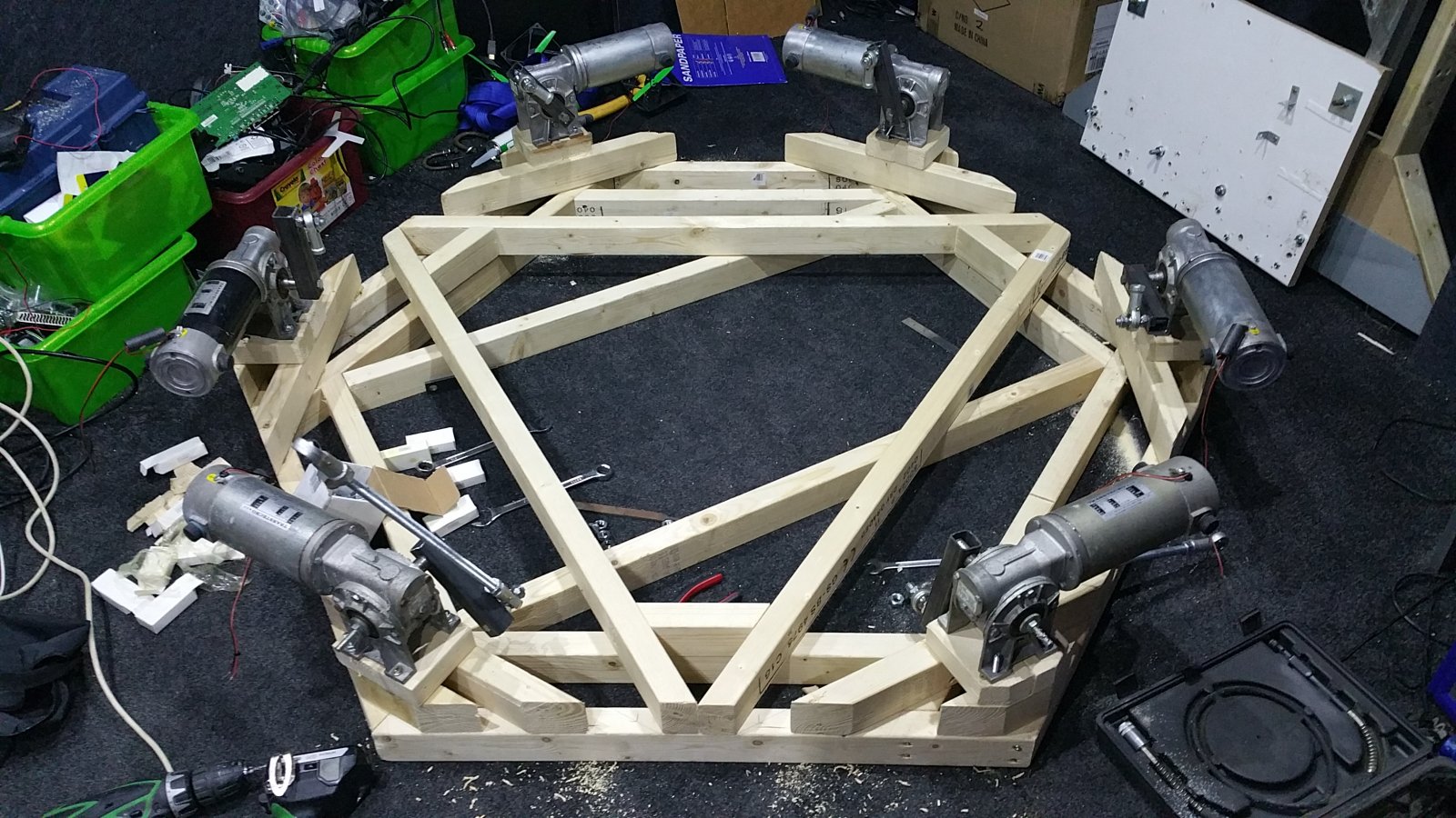

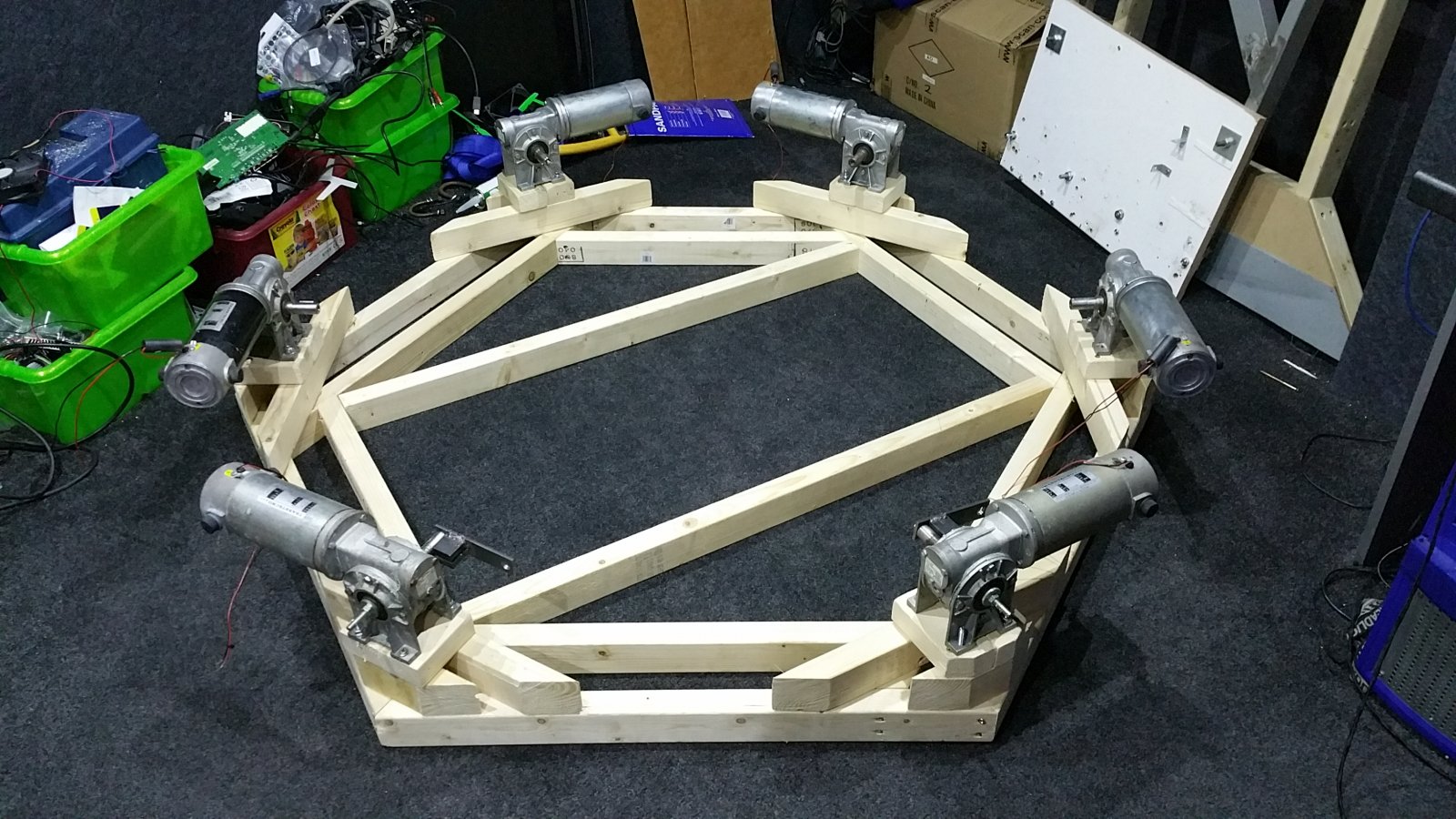

    Few more bits added time for mounting the rest of the motors 20150606_144659.jpg

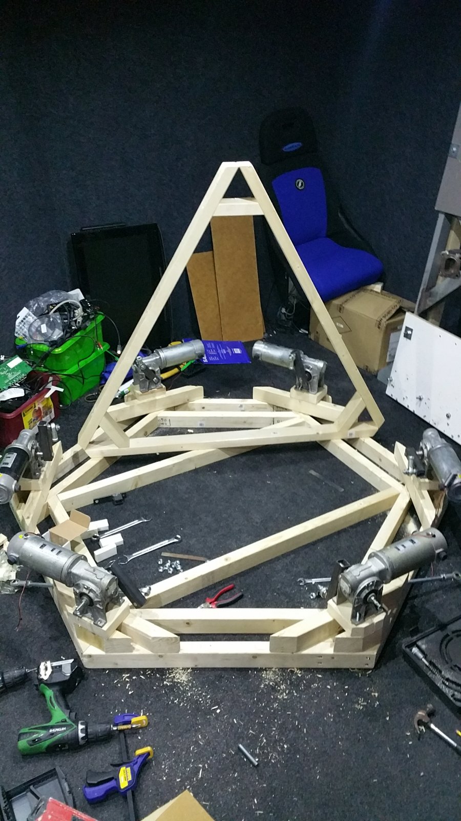

    All the motors are now in position :) 20150606_212733.jpg

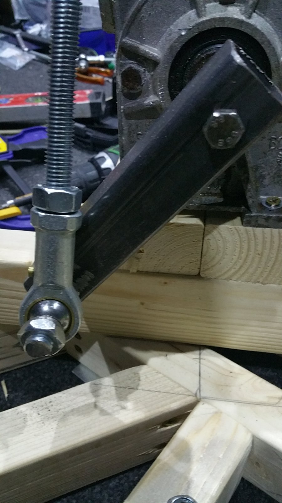

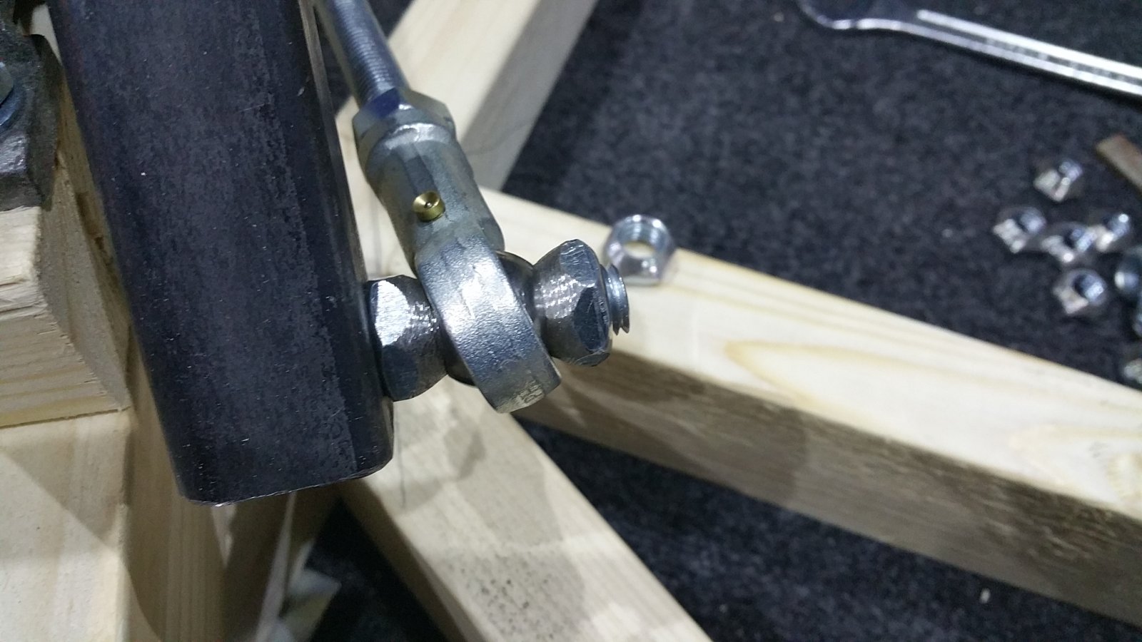

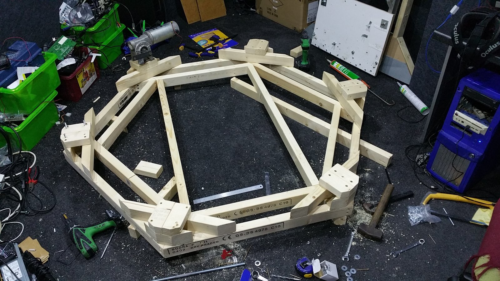

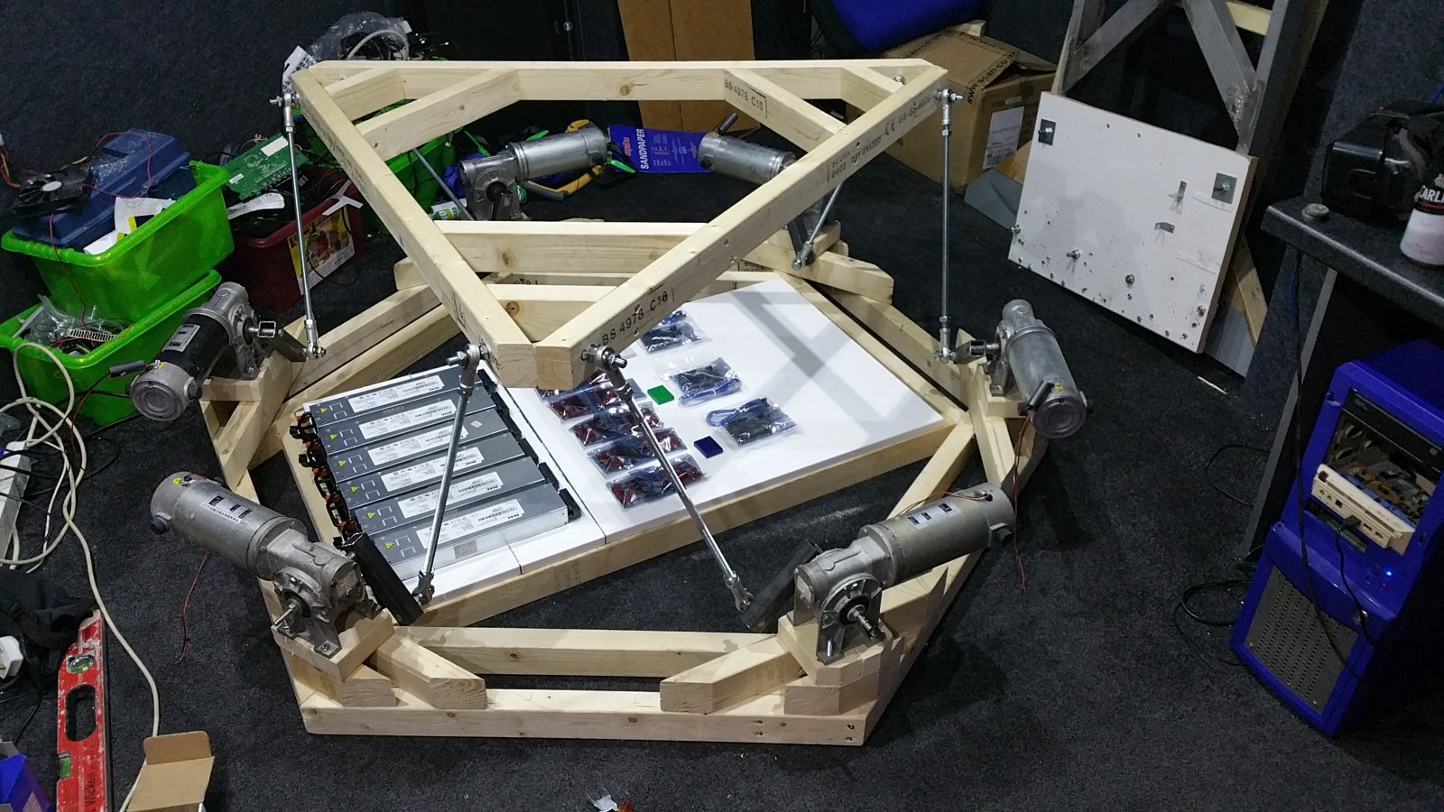

    Ok a lot of faffing about making levers and drilling holes.
    Got the Base shape of the platform done and think I got my measurements all right for the arms will have to see when I eventually mount it.
    20150607_220901.jpg 20150607_220924.jpg 20150607_220854.jpg 20150607_220958.jpg

    Coming along well, I certainly need some patience, as I'm making yet further modifications/improvements (now waiting for more parts) to my DIY actuators before I nail down the design and building all the others (back to a 6DOF - explain more later in my thread). How wide is your base - its hard to tell?

    I think wood is an excellent building material when it is designed properly so the stresses put on it don't end up tearing it apart! And it is easily cut and milled also making it faster to build with than steel; especially if you're not a welder! ;) Keep up the good work @SilentChill! :thumbs

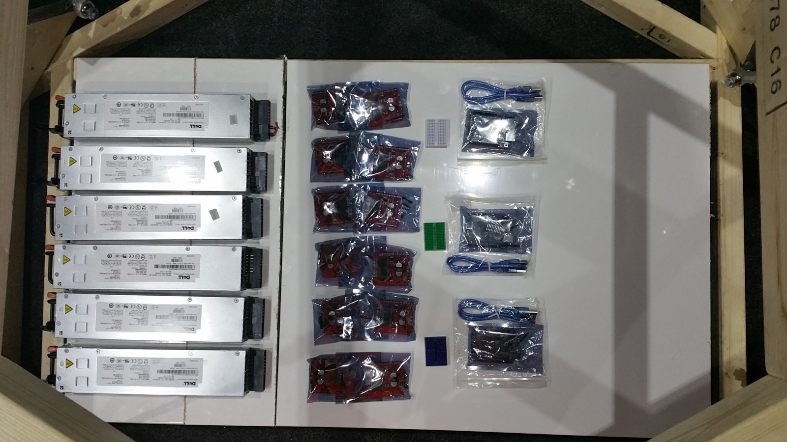

    Make sure that you use lots of 47000uF 50v caps in parallel with each PSU. Then it might work...

    @SeatTime the Base is 1370mm wide. Glad you have gone back to 6DOF can't wait to see you finally start building it
    Thanks @BlazinH there are lots of threaded bar holding it together along with screws :)
    @tronicgr hopefully I won't need the extra caps but will keep it in mind if it trips out.

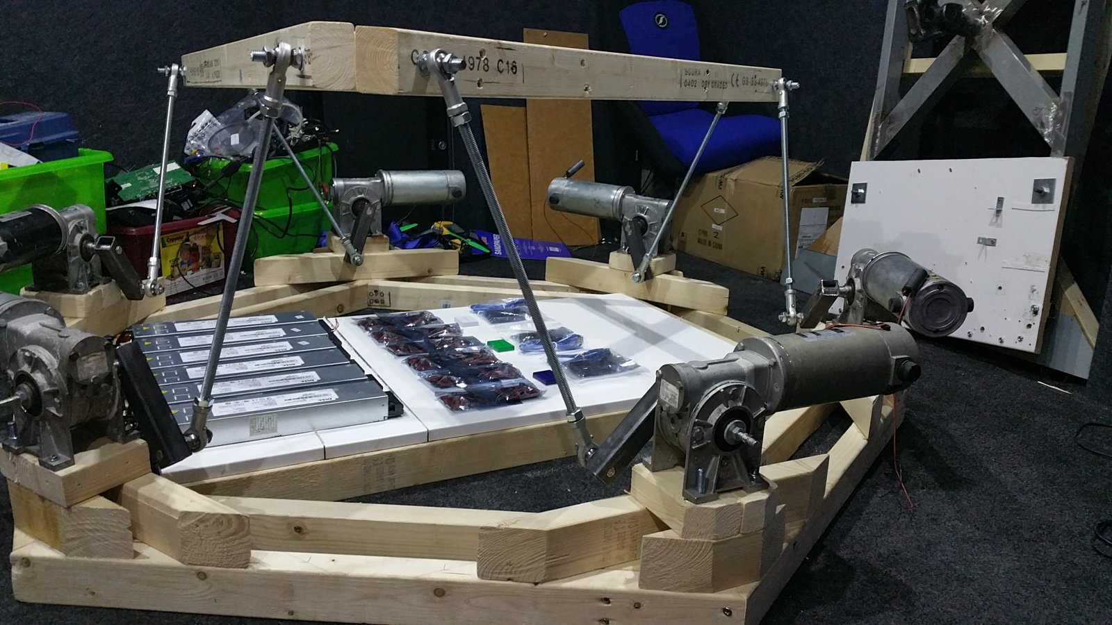

    Ok another quick update.
    Laid out where stuff gonna be there or there abouts.
    Get it all wired up fastened down and may be able to give it a test :eek:
    Probably will box it all in once I have it all up and running and it doesn't fall to pieces.
    I will probably will have to change a few things to firm and stiffen it up a bit once I have it working.
    Oh and make brackets for the hall pots can't forget those pesky things :thumbs

    Is that M12 threaded rod you are using?

    Yes @Paul Shortland used it on my 3DOF and never ever had a problem with it and its cheap as chips from screwfix :)

    Yes was just there buying some M10 :thumbs (Bent my first one)
    Interesting that 6 x M12 will take the weight, one day I will try it!
