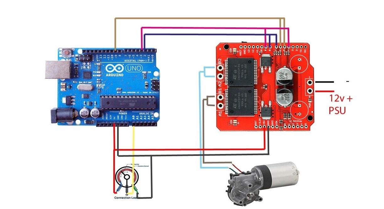

    Hi, I made a 2 dof, and my motor is 350W, I uesd this:
    but my motors will make noisy while not moving, and I test this
    http://www.xsimulator.net/community...-motors-while-not-moving-check-this-out.6697/

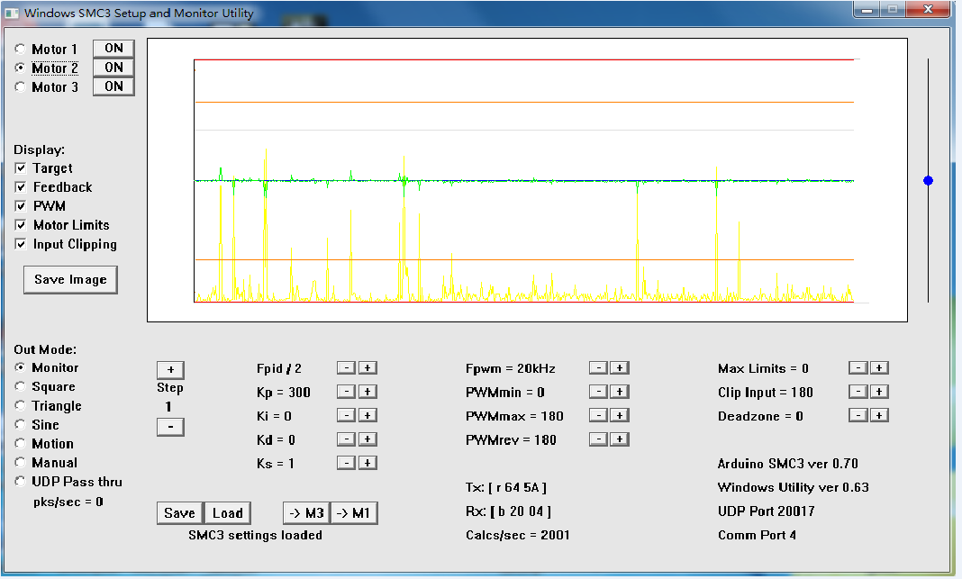

    Motor's noisy will be less, but as shown in Fig 1, 2, and 3, the feedback line(the green one) will jump while not moving ,and sometimes good and sometimes bad,
    what if we can add same electrical components on the circuit to block out those noise?

    Try a deadzone of 1 or 2.
    PS: Figure 3 shows your potentiometer signal, which is pretty noisy.
    PS2: I remember someone used capacitors on the pot to reduce the noise...but I dunno where to find this posting yet.

    Sometimes increasing the deadzone on smc3utils on the motor that make noises could help, I´ve got 2 on my rigth motor an now doesn´t make any noise.

    Increase in thedeadzoneisasolutionbutthisisnotanidealsolutionbecausesmalleffectsmaydisappearinpartinthisdeadzone

    try increasing the fpwm, the value that works fine for me with a similar hardware is 35 khz and with the fpid on 1, another thing I see is that the power max is too low. In my configuration is at maximum value. It works may be not for your hardware. But is something to try.
