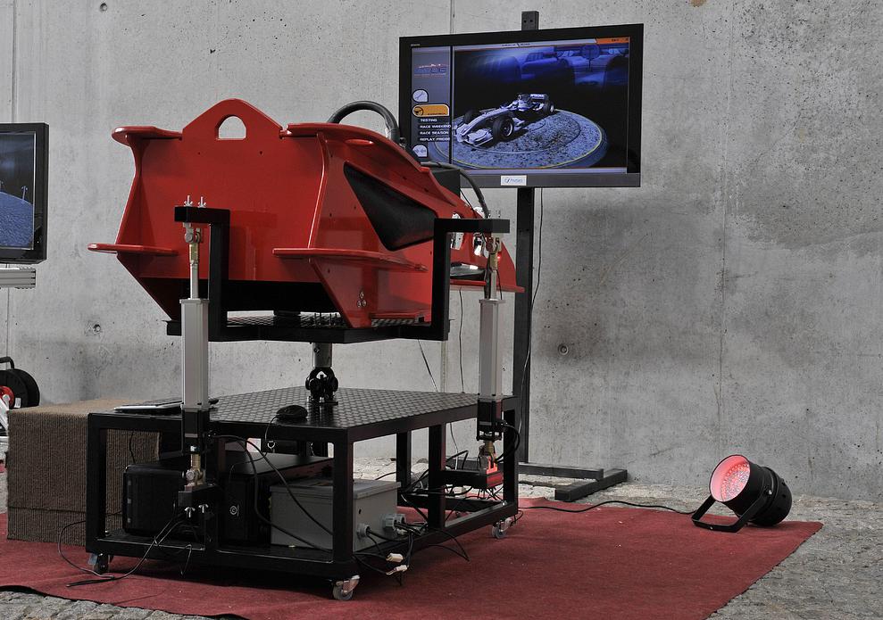

    3DOF, SCN5, SCN6
    You can also make a simulator of the same type as the D-box but with SCN6, like this.
    This is my expensive than d-box
  15. bsft
    it uses SCN6 actuators
    Still not cheap, but cheaper than Dbox
  16. Baptx
    Baptx Member
    Dec 11, 2014
    57
    Employé
    Haute-Savoie
    405Coins
    +29 / 0 / -0
    3DOF, SCN5, SCN6
    Yes, they are cheaper than the D-Box
    In addition, SCN6 cylinders have better range (100mm, 150mm 200mm and above) 100mm sufficient to make the same system as the D-BOX
    If I have time and money, I would throw myself in one year in a simulator 3 or 4 axes with SCN6
  17. prodigy
    prodigy Burning revs
    Oct 27, 2013
    459
    Croatia
    6,698Coins
    +399 / 4 / -0
    At first I thought this was 3DOF because of it's look and photo angle, I thought it was 3 SCN's, but when I searched for more photos, it's actually 2DOF, since it has fixed unijoint on seatbase. Nevertheless, it looks pretty neat and not so hard to make, except for cost of SCN's of course - but surely it can be done for way less money than their commercial price (if they are selling it).
  18. bsft
    Its a hyperstimulator and I think you can get plans somewhere to make your own out of MDF.
    2 DOF is easy for this, mount the motors at the feet or shoulder mount at rear
  19. Baptx
    Baptx Member
    Dec 11, 2014
    57
    Employé
    Haute-Savoie
    405Coins
    +29 / 0 / -0
    3DOF, SCN5, SCN6
    I can not find a video of this simulator ....
    I would like to see the movements
  20. RacingMat
    2,236
    20,963Coins
    +2,089 / 21 / -2
    The interesting point about this 2 DOF is that 1 motor is dedicated to 1 DOF
    Then the Simtools setup is easier for Roll and Pitch: 100% and 0%
    no mixing
    If I would rebuilt a 2 DOF, I would do this!
