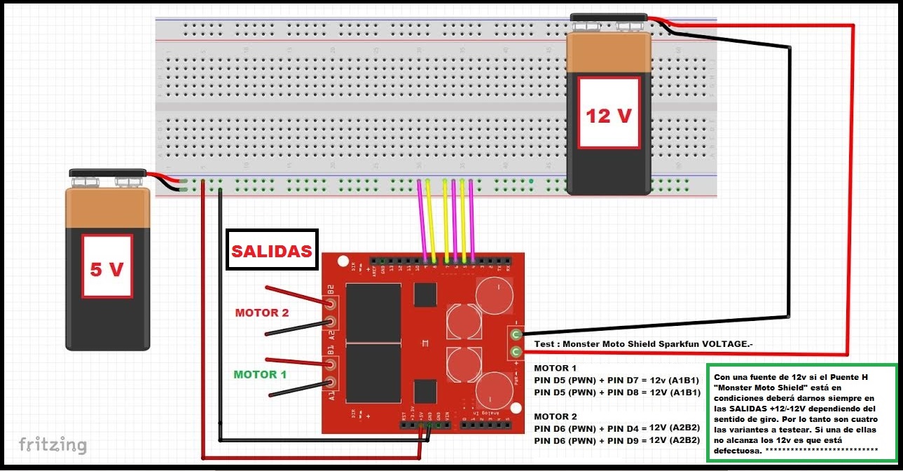

    Hey guys!
    I did this test yesterday, and my Moto Monster gave an error, 3 of the 4th test gave me 12v/-12v and the 4th gave me 4,96v, is this test known here and valid?
    MOTOR 1. Unimos el pin D5 de la "Monster" al positivo (5v) y su pin D7 también al positivo (5v) verificamos con un multímetro que efectivamente arroja un resultado del +12v/12v indistintamente en la salida A1B1. Luego veremos que al usar los pines D5 y D8 el resultado debe darnos su sentido opuesto.
    Un error "algo común" es que una de las cuatro combinaciones arroje un volaje nulo (cero) o que no llegue al maximo de lo que tiene que dar. Por ejemplo 9v.
    Tendríamos ante nosotros una pieza defectuosa de fábrica.
    English:
    Connect pin D5 and pin D7 ( 5v ) of the "Moto Monster " to the positive ( 5V ), check with a multimeter that effectively gives a figure of + 12V / 12V output in A1B1 . Then we will see that by using the D5 D8 pins the result should give us the opposite direction. A common error is one of the four combinations voltaje throw a null (zero ) or does not reach the maximum of what to give. For example 9v . We would have then a defective Factory part

    I would say no not a valid test as you need to put the MM under load with something that's going to draw some current from it.
    I had a few that showed 12v and -12v but as soon as I connected a motor it just dropped to zero and the motor didn't turn.

    No I just used a rc motor from my fans to test . Probably using a light bulb may work also

    I hope I'm wrong but in the datasheet the VNH2SP30 shows that the PWM needs to have a minimum off time so as not to go into fault mode as it might see the constant voltage as a short circuit. The test shown here has the PWM pin clamped high. The datasheet also provides a diagnostic truth table so that the fault can be diagnosed. My knowledge in this area is limited and the datasheet isn't particularly clear on how to properly interpret these fault conditions.
    http://cdn.sparkfun.com/datasheets/Dev/Arduino/Shields/10832.pdf
    Page 10 has the reference to the PWM protection shown under Table 9
    Page 14 has the normal and fault truth table
    Page 20 explains a little bit about how the fault protection works
    Page 21 has the fault clearing method
    I suppose my biggest concern with the test is if the PWM protection does kick in or not after applying a constant voltage to the PWM pins.

    I hook mine up just like I would in a sim with a ARD + pot to supply the enables/PWM to run it, except the motor is just sitting on the bench. As per @SilentChill s video.

    Yes I think that is the best way to test them, as you would actually use them in the simulator.

    In my case near 50% MM from alibaba have problems.. Tested with motor with ~1A no load current.
