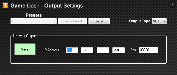

  9. soraz
    soraz Member
    Mar 5, 2013
    68
    Noale VE, Italia
    5,161Coins
    +80 / 1 / -0
    today test gamedash output to network interface, but nothing see on network..
    can someone tell me any suggestion ?
    thanks
    below my config where can't create preset.
  10. eaorobbie
    20,461Coins
    +1,686 / 23 / -2
    An application can be written to receive the UDP packets and serialize them back to data.
    What are you trying to achieve ?
  11. soraz
    soraz Member
    Mar 5, 2013
    68
    Noale VE, Italia
    5,161Coins
    +80 / 1 / -0
    thanks.
    wireshark on lan see anything, but a local udp listener receive all data.
    i'm working for a wrapper between gamedash and generic ODBII software to visualize rpm and speed on tablet, but the real goal is create a simple android app as dashboard for gamedash.
    regards
  12. eaorobbie
    20,461Coins
    +1,686 / 23 / -2
    This is possible , I wrote a personal app that communicates to the jrks via a udp connection and uses the dll's that pololu supply just as a test version to see if I can get more definition out of the motion cue's. And yep it sure does, but early days for it, many little errors in it that I have to fix.
    Ok what are you coding this in , Im familiar with VB.net - Basic , learning C# and MCF very quickly too.
