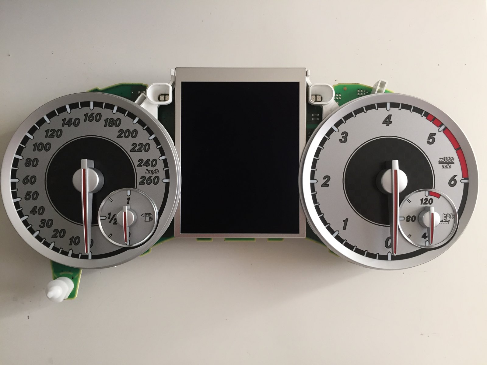

    Hi guys!

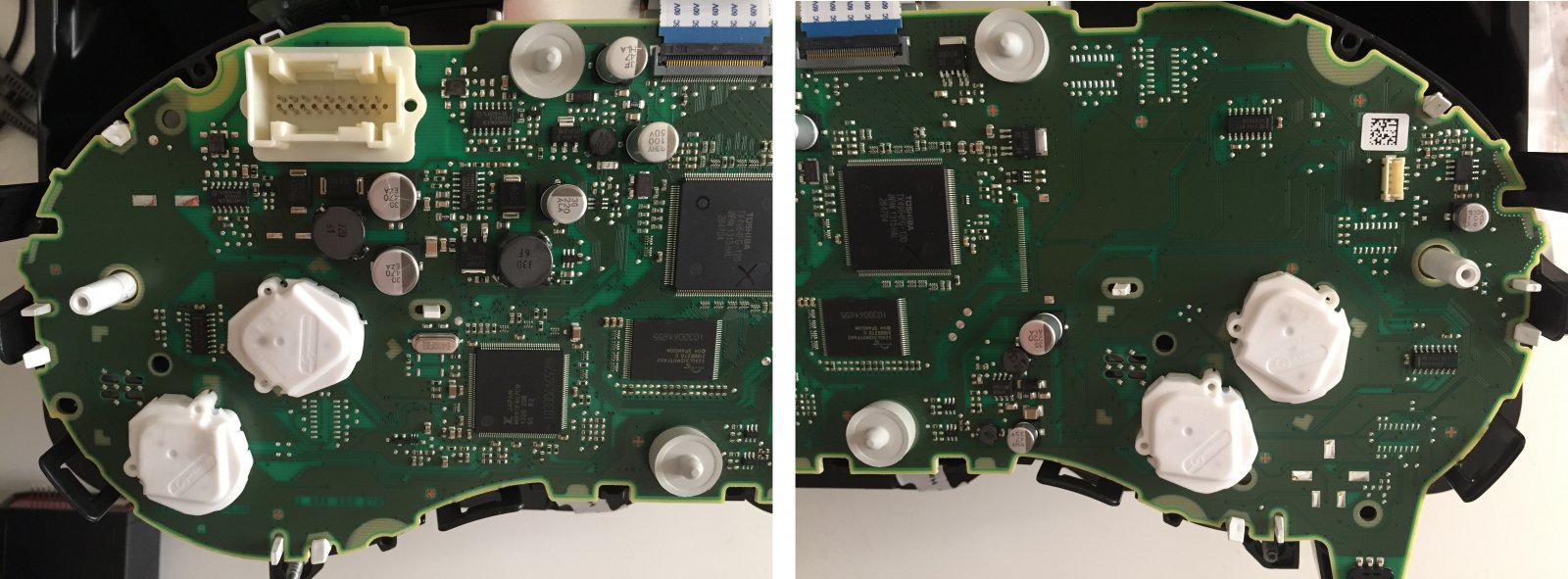

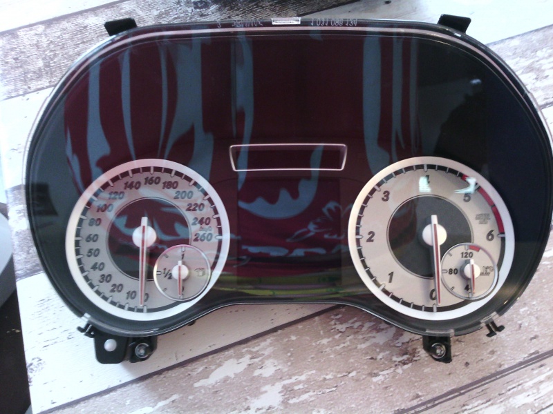

    I have got a very nice cluster from a Mercedes A-Class W176 and I'm looking for information on how it's possible to drive it via CAN communication?
    If not I would be forced to drill and plug straight onto the motors
    like switec motors tests I achieved... but that would be quite disappoiting :(
    Mercedes Classe A W176 cluster.JPG Mercedes Classe A W176 cluster TX4964FG-120 MB91F476CB.jpg
    Do you have any information about this? :)

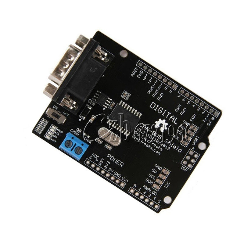

    I have seen some CANfilter PCB boards but I cannot figure out exactly what it does... or if it could give me some hints?
    http://www.ebay.com/itm/Mercedes-Be...7-W166-X166-W218-W172-W246-W176-/271269820219
    http://fr.aliexpress.com/item/Hot-S...2294967838.html?spm=2114.06010108.8.67.md9bUO
    This item can help car owners to repair (exchange to used parts) broken car electronic computers and keep original car data: like odometer, coding and other functions.

  5. tombo
    tombo Active Member
    Oct 5, 2013
    269
    2,443Coins
    +246 / 2 / -0
    DC motor, Arduino

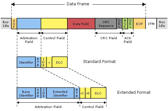

    this should be a canbus device. It can be driven by various canbus boards for arduino.
    The hardest thing would be getting the right adress data to drive the cluster.
    Maybe you can find something on the net. If not I can maybe ask at work if you are interested. I work with cars and got good connection to Mercedes, Vw and so on.
    Or you know someone with this car, than you can sniff the canbus and get the propper Ids.
    I don't know about your knowledge about can bus but for information here is a little Document, it's from Vw but for the general process it doesn't matter.
    http://www.volkspage.net/technik/ssp/ssp/SSP_238.pdf
    At page 18 you can see a can Data Frame which you need to reproduce.
    The Identifiers change from car to car and manufacturer to manufacturer and it's hard to get them.

    I will not promise too much as the Ids are a secret, but asking is worth a try.
    I don't want to annoy you, but I think it will be taking very long and will be a very hard way to get this device working, as it is from a newer car. In case of Security reasons the info is not avalible like for older cars.
    I thought of something like this some time ago and gave up incase of so little info for ids avalible.
    The best way would be to use the housing and implement your own electronics.

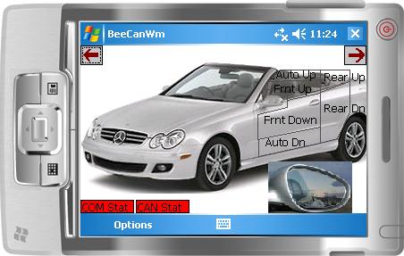

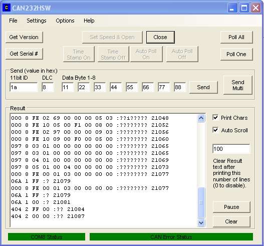

    Some more informations:
    this guy wrote 2 softwares to help reading the CANbus of a car
    http://www.honeysw.com/canproject.php
    and ended with a palm application that remotly controls its MErcedes car (just like K2000)
  10. RacingMat

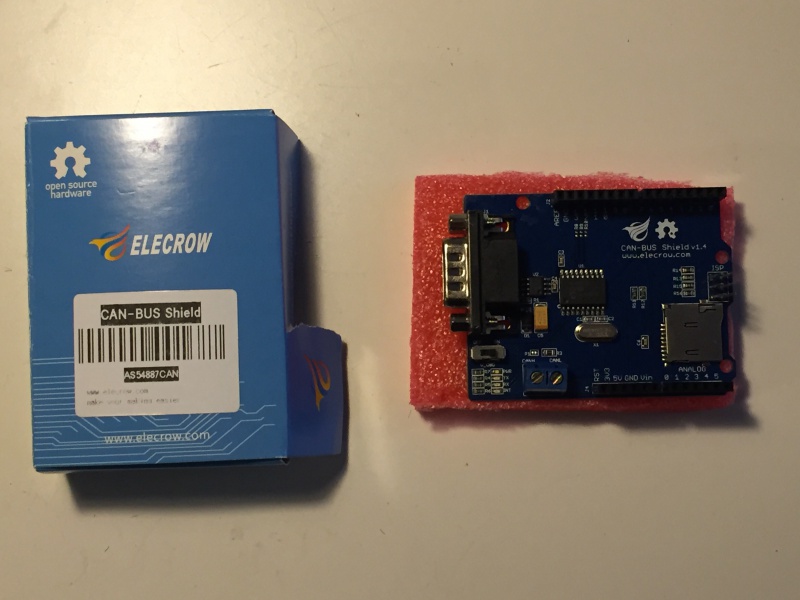

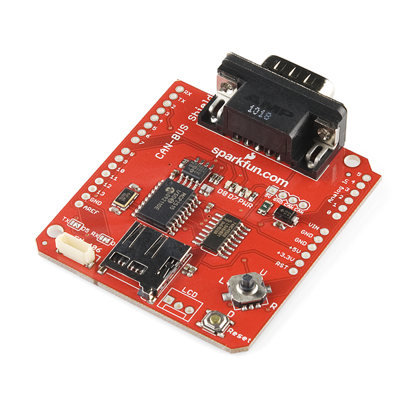

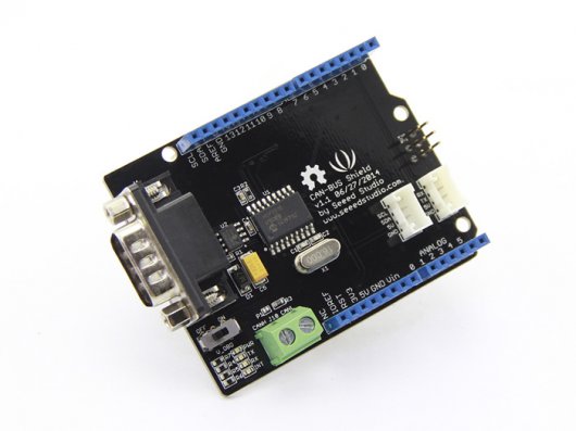

    I've just received my CANBus arduino shield :) 328892image264.jpg

    21,039Coins

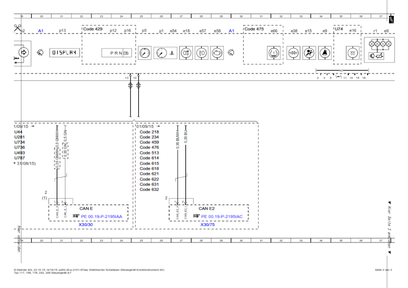

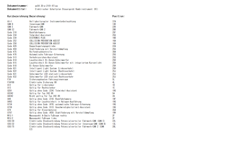

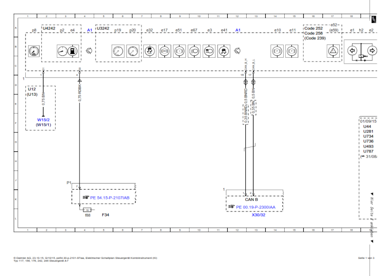

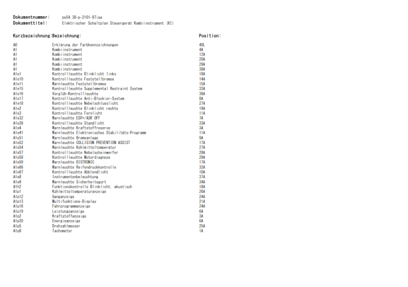

    Nope! I'm stuck... I cannot start the Cluster
    I have try this based upon electrical wiring information, but nothing happend [​IMG]
    .jpg
    I need some expert help to get some more documentation...

    I'll try to find a scheme for the cluster but probably need some more information about the car (year,gas or disel)

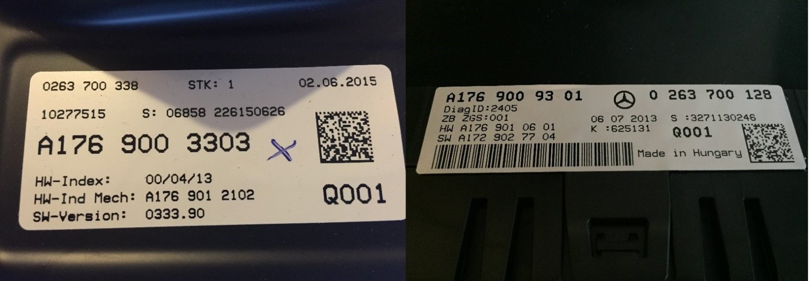

  17. RacingMat
    2,237
    21,039Coins
    That would be really really great @Jadran!!
    it's a Aclass 176 model cluster
    2013 hardware design (from label)
    made in 2015/06
    A176 900 3303
    HW index:00/04/13
    HW-Ind Mech: A176 901 2102
    SW-Version: 0333.90
    .jpg
  18. Jadran

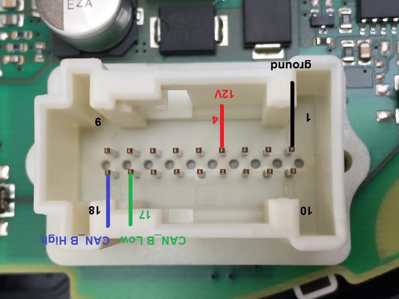

  19. RacingMat
    2,237
    21,039Coins
    @Jadran: great! jap.gif
    Sorry I didn't answered because I hadn't received any alert...

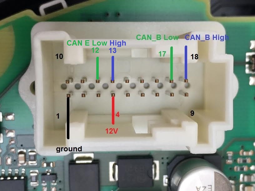

    According to this, the complete pinout should be the following:
    And CAN_E should transmit information from motor, RPM, speed...
    I'll try tonight :)
