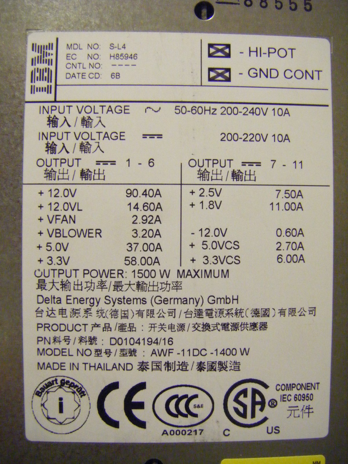

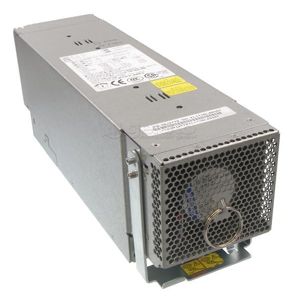

    Hi!
    With @Pit 's method to multiple HBridges, we have to find more POWER!!
    http://www.xsimulator.net/community...alf-bridge-60a-continuous-and-120a-peak.6537/
    Here is the way to use this powerful PSU AWF-11DC-1400
    1400W total
    ibm-p560q-p570-power-97p5676-39j2779-awf-11dc-1400w-bee-1403-28-bee@22.jpg PSU IBM AWF 11DC 1400W (1).JPG

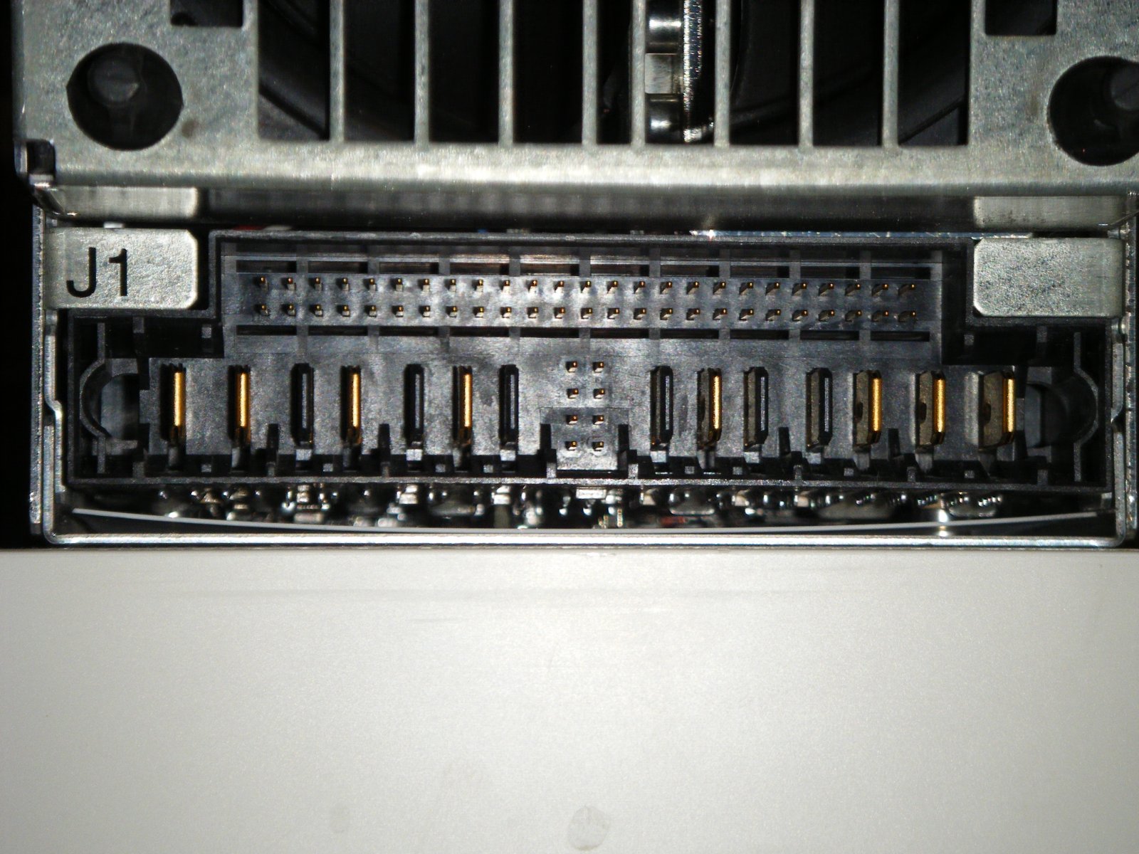

    Here is the method from RCGroups.com
    http://www.rcgroups.com/forums/showpost.php?p=11640787&postcount=7
    how to solve an unknown supply
    Bringing that up, this is the method I used to find the correct pins to power up this supply. It also works for a majority of PS units out there.
    With power off and testing each pin to ground.
    1. Exclude any pins that are common to each other(including ground pins). Usually these are the 3v and 5v rail pins. They also show the same resistance.
    2. Exclude any open pins(pins with no resistance that don't connect to anything).
    3. Exclude any pins with a value below 1k ohms and above 10k ohms. From my experience, I've found that the pson and pskill resistance usually falls between a 1k and 10k range.
    With power on.
    4. Exclude any pins that show no voltage.(pson and pskill are held partially TTL high or just not grounded. So they show some voltage on them).
    This will usually leave between 4-6 pins.
    Use a .5k ohm resistor on each of the individual remaining pins and connect each to ground. The power supply will usually power up at this point.
    Disconnect one resistor at a time from ground.
    If the PS remains on after a you disconnect a resistor from ground, then the remaining pins contain the pson and pskill. So keep it disconnected from ground.
    If the power supply turns off, then the disconnected pin is either the pson or pskill. So reconnect it to ground.
    Repeat this process until you find the pson and pskill pins.
    In some cases the PS will turn on with a fault.
    If this happens then disconnect one resistor(pin) at a time from ground to find the one that is causing the fault. Then continue with the process above to find the pskill and pson pins.
    Let's try to find out what pins are required to start the PSU

    Here is the result!

    @RacingMat , I've just received this PSU to replace the 12V battery I'm using on my rig. Works fine...2minutes, then it turns off (while driving...hard), I believe to protect itself even though it's not warm at all.
    I was wondering if you have connected the +12V on one connector or both connectors available on the PSU output? See picture below, I have only connected the ground on the blue pin and +12V on the red pin,I'm wondering if I should also connect the +12V on the yellow pin, just in case those are two separated circuits.
    Thanks for your help :)

    yes, that's a good idea: you should use the 3 pins to see if it's better
    23A x 2 = 46A that should be okay
    but depending on your motors, peaks can be very high... Can you share some pics of your motors?

    Pit suggest to use 1 psu PSU AWF-11DC-14001400W for each motor? what does he mean? the motors receive the power from card and not directly from psu. So if I use sabertooth 2x32 in wich I connect 2 motors how can I use 2 psu for each motor??
  13. RacingMat
    2,236
    20,963Coins
    +2,089 / 21 / -2
    With such a PSU (12V 90A) you can satisfy to what is demanded by your Sabertooth to drive the motors.

    Hallo, I've just received 2 of these psu
    I apologize if I put the question, but having no competence in this matter would not do damage. In addition the use of google translator does not allow me to fully understand what to do.
    Let's see if I understand it:
    - I have to pick up the + 12v from all three available pin connecting them
    - I have to pick up the -12V from the only available pin (pin 0)
    - I have to connect a switch between Pin 11 and Pin 12 Gnd start to create a switch on / off power supply.
    All correct?
  18. RacingMat
    2,236
    20,963Coins
    +2,089 / 21 / -2
    yes! :) only one 12V pin should be enough but you can link them as @Vef445 did
    and pin 0 is 0V (not -12V)
