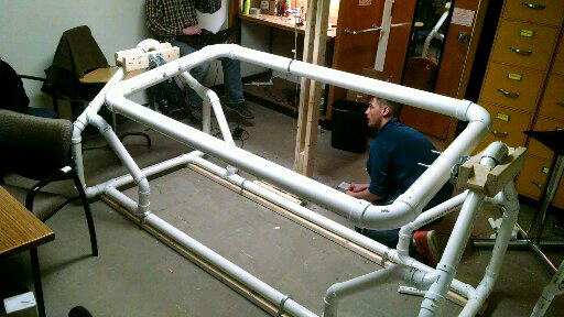

    That's a really nice build..Here's what we've got at the moment: [​IMG]
    It's still very much a hack. We just got our motors running with the jrk tonight. PSU seems to be tripping though, because we can only run it in one direction or the other. Reversing it doesn't do the trick (99% sure this motor is grounded correctly). We're definitely looking to transition away from the pulley system.
    Our outer part of the frame bends in under load, which needs to get fixed.
  9. bsft
    Frame looks good, and yes, you said you need to spend more time making it stronger.
    I know the issue regarding the motors from Rob, he said get "these" and you bought something else.
    Not sure on PSU tripping, how much output power is it?
    Otherwise, Id really suggest go along the lines of Jugles sim build. That would be a good base to work from, using the motor/lever/gear setup, is strong and powerful.
