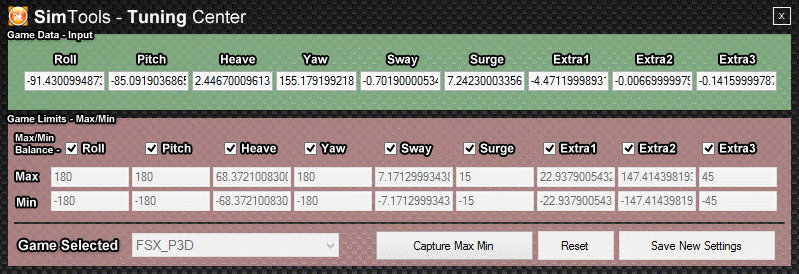

    Have setup SimTools correctly as in done an axis assignement and setup an interface, without nothing will be present.
    One way to check if data is flowing is to check the GameEngine - Tuning Centre , if values are rolling in the green area then the plugin is working and it will be your setting that are wrong. We need more information to inform you what is actually wrong.

    Update: I get rolling in Green area that seems to match FSX I bank left number get larger right smaller ect. Crash it all stops :) still no movement in motors so there is a settings issue somewhere, Do you have a suggest presets for FSX?
    I can run the motors using AXIS testing no problem, dof testing nothing happens until I change to axis testing
    Both computer say connected and game running like there suppose to.

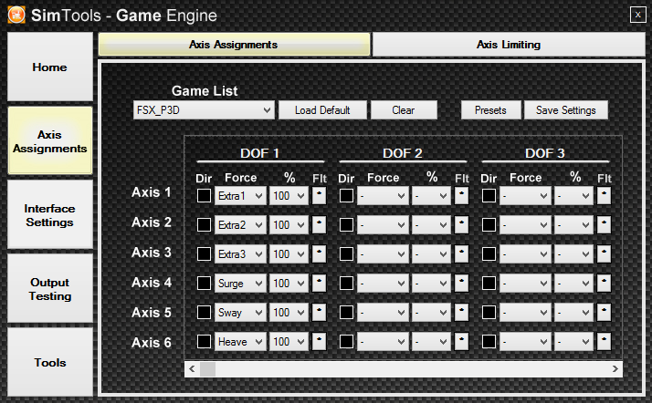

    Have you assigned the values to the respective axes for the FSX_P3D plugin?
    And do you see at least changing data in Tuning Centre?
