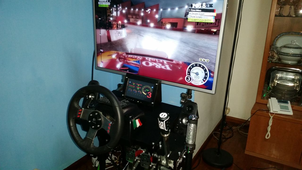

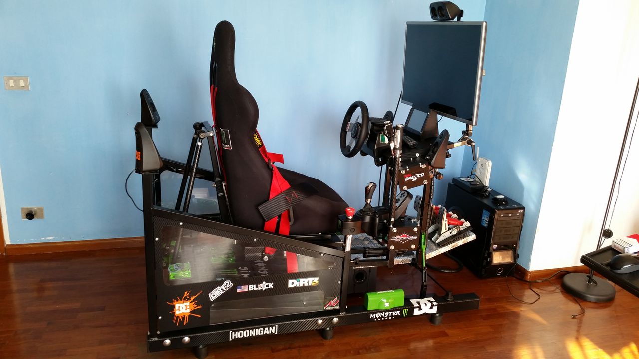

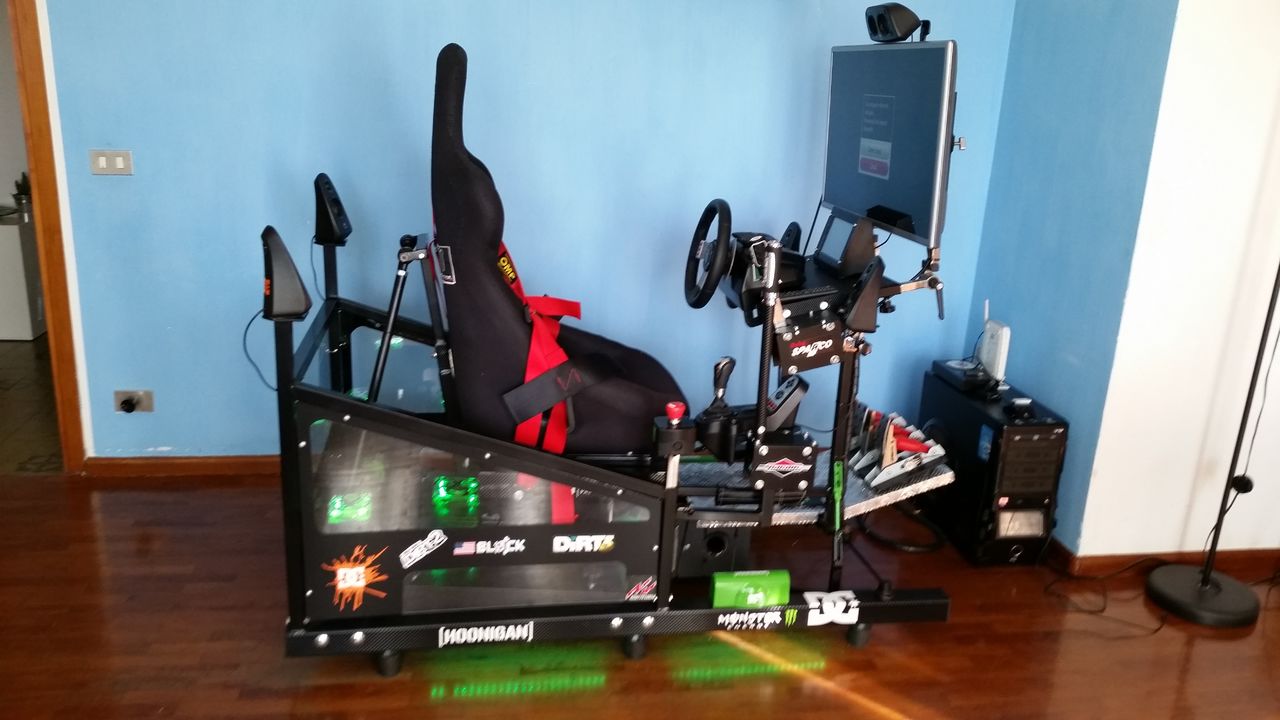

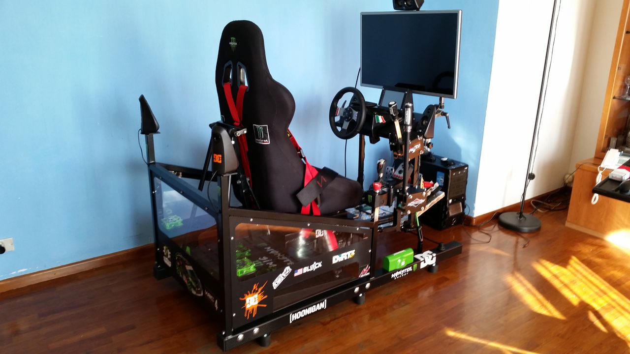

    Hello everyone ;)
    I took a bit of time to build this other sim (about 3 months in his spare time)
    after I sold the other (only sruttura and electronics) I have left the G27 the
    seat and seat belts ... for other things I bought back again.
    My new sim is more or less built the foundations of the old one as
    the lower structure cooling system electronic engines ....
    I used wiper motors once again and I have to say
    despite the extra weight ... they do their job egreggiamente and after 2 hours
    of the race I noticed that the engines are pretty cool !! this means
    that the cooling system works very well ... clearly I
    also had to balance well the total weight !!!
    This time, I cared too much aesthetics and tried to take care of even the smallest details.
    Adhesives and lighting special effects and so on. wanted them to my son who is
    amused to attack them everywhere :grin
    This time I installed the TV that moves with the upper structure
    (Much better screen fixed) and the bracket adjustable in depth, height
    I will modify the slope and then for a triple monitor.
    I used square tubular
    60x60x3
    40x40x3
    30x30x3
    25x25x3
    and 20x20x3
    Compared to before I used 2mm tube that is more robust.

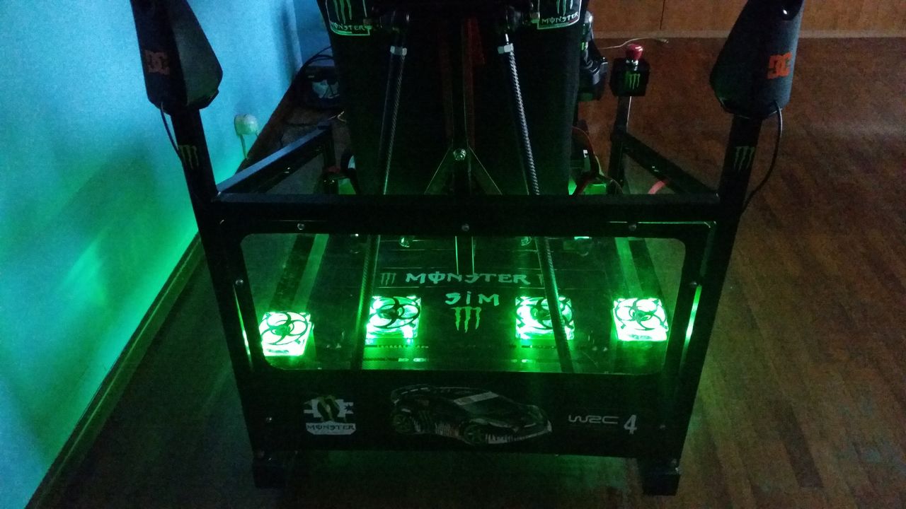

    I added a 5.1 audio system and subwoofer and placed under
    and some good vibrations to the structure as well as a fantastic sound
    I used cooling fans 120x120 1200 rpm for electronics
    and fans 80x80 2000 rpm for cooling the engines
    If you have any questions please reply as soon as you can

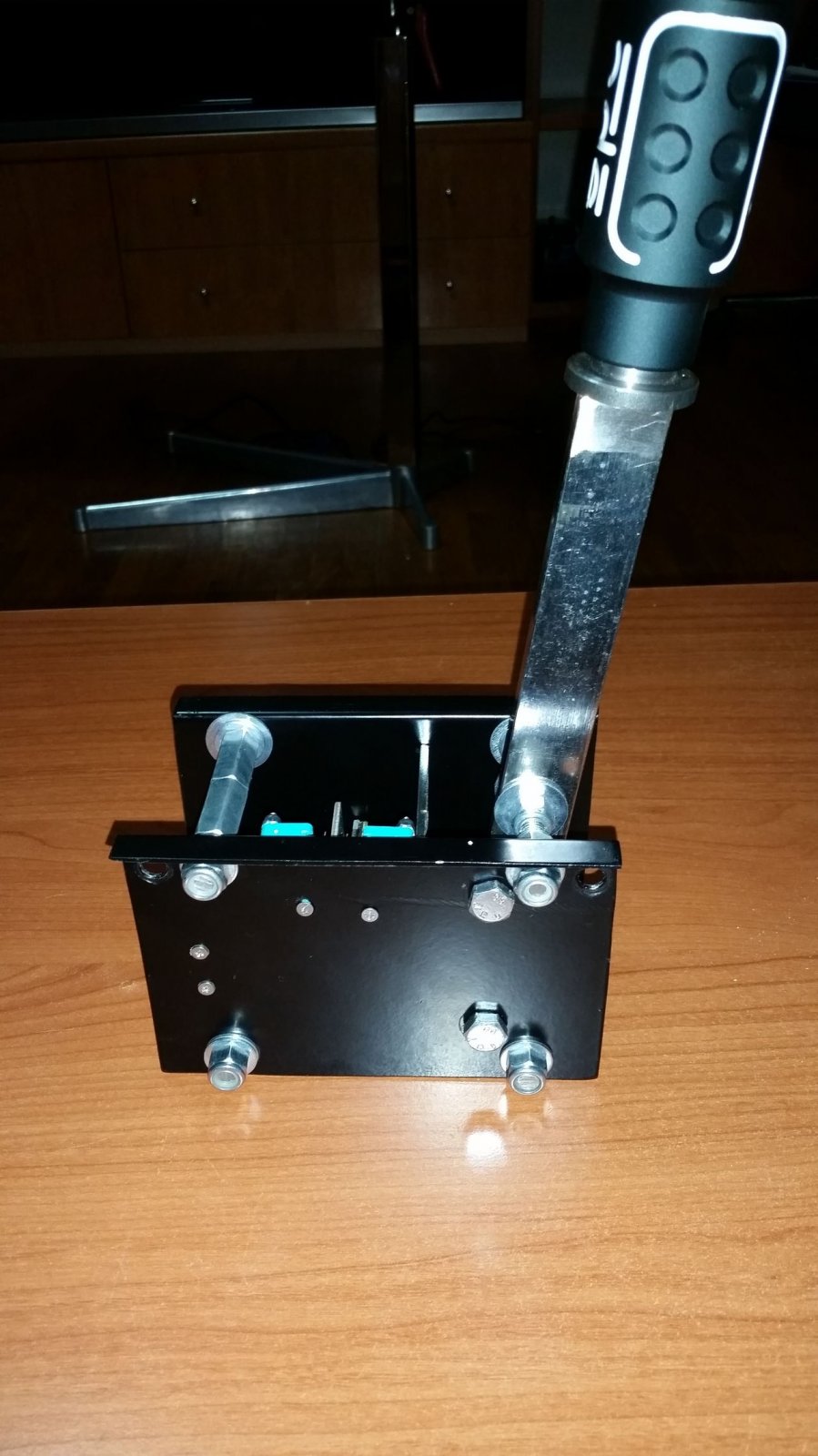

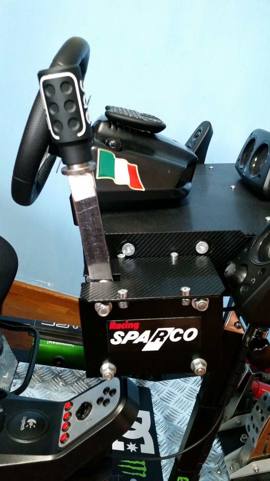

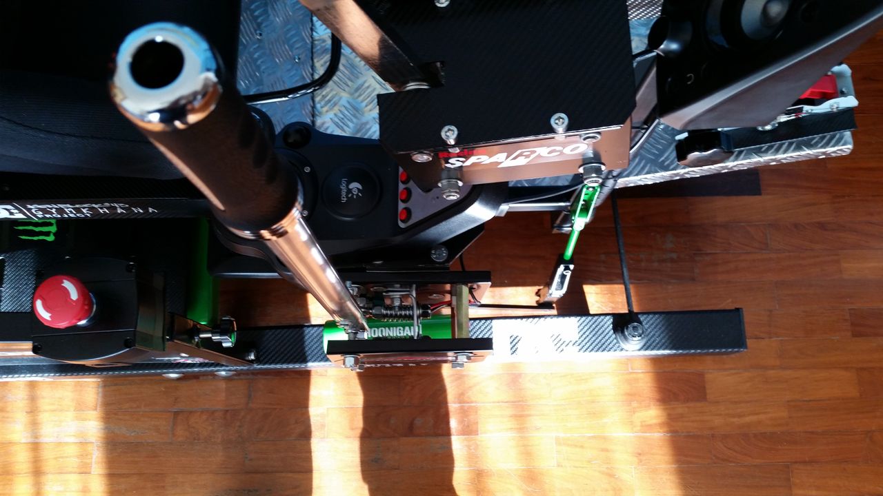

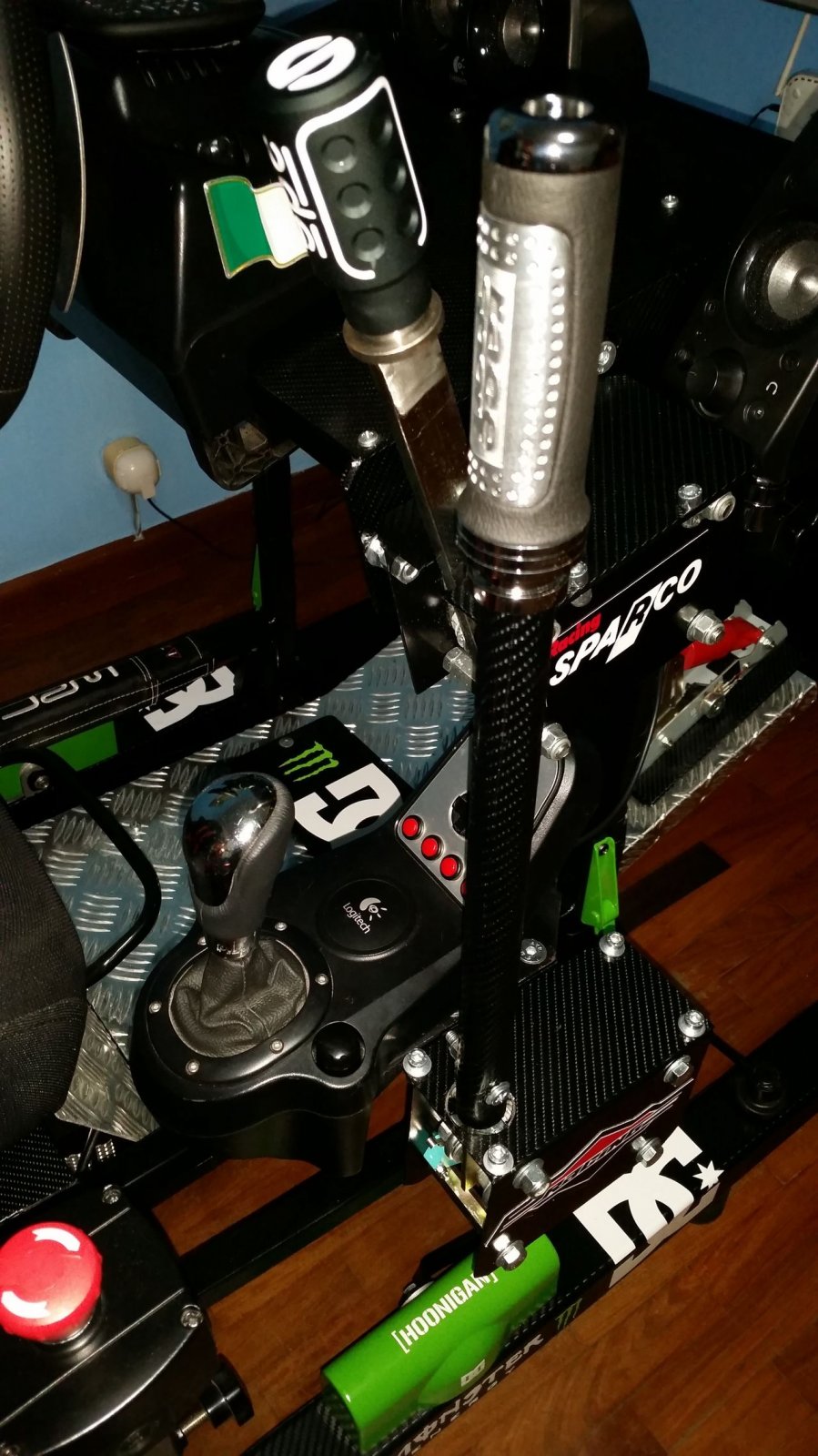

    Sequential gearbox homemade
    I also took the time to build my sequential gearbox
    Here are some photos:
    1° Upgrade
    2° Upgrade
    Handbrake Homemade
    3° Upgrade
    Monitor 7" Dashboard
    Even the dashboard and made
    I am using a software called SIM monitors

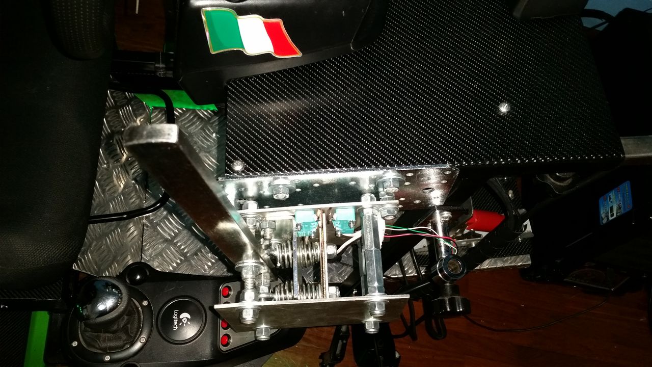

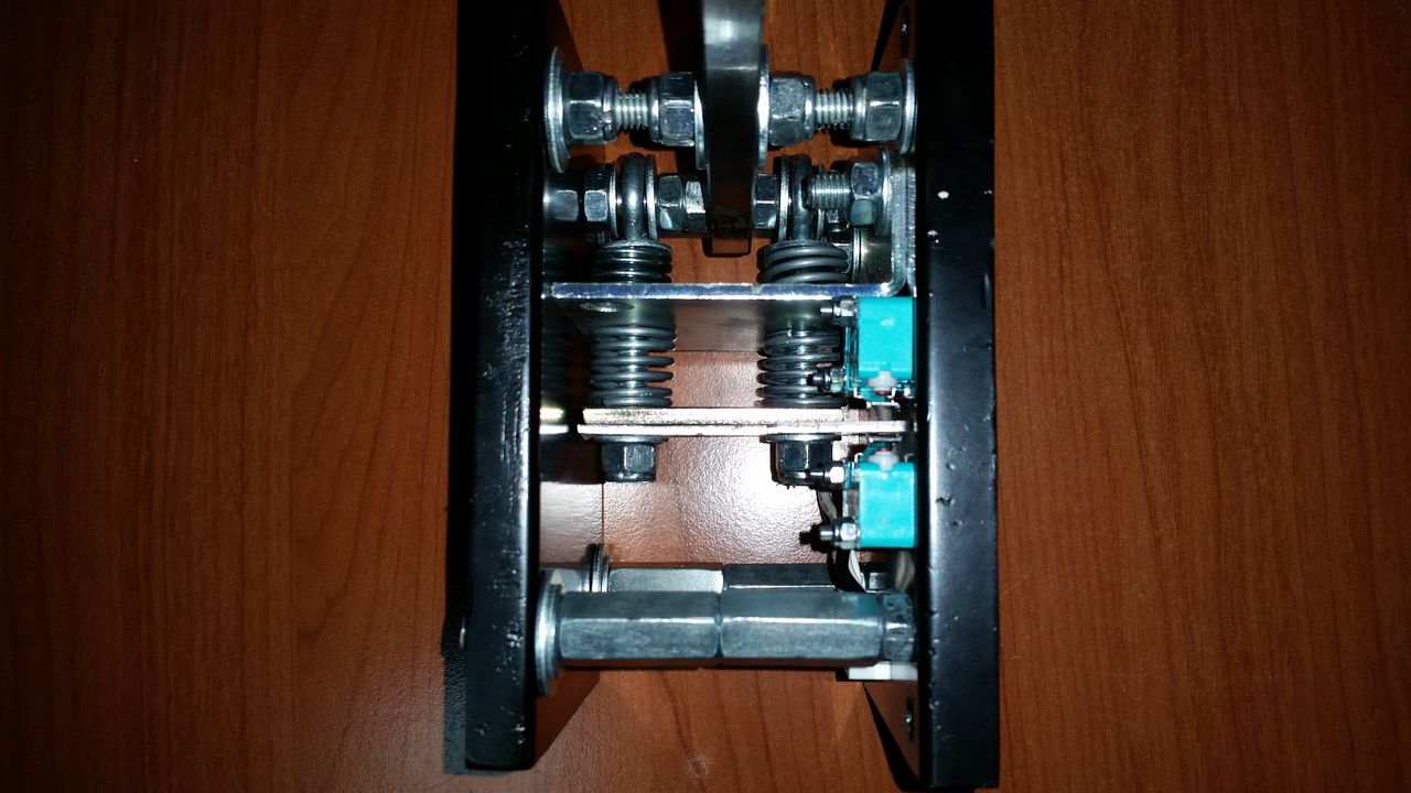

    is also the handbrake and done. More details photo in 2° post ;)
    For now it is digital then I can tell how to do it with analog potentiometer. If anyone knows how to say what I need to do analog. Thanks in advance
