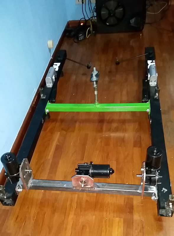

    Purtroppo il mio sim non è più come lo vedete in foto.. guardate come è ridotto adesso :D
    Mi è ripresa la malattia da smanettone.. per il momento ho abbandonato l'idea del progetto 6dof in corrente continua e ho ripreso questo per portarlo da 2dof a 4dof aggiungendo la perdita di aderenza (Yaw) e l'accellerazione e frenata (Surge) ovviamente oltre al (pitch) e (roll)
    Il lavoro è appena iniziato e andrà per le lunghe perchè posso farlo solo nel tempo libero purtroppo... ma vi terrò aggiornati in questo thread dei progressi che faccio.

    Hi guys, it took me a while but I finally finished this also upgrade to the surge skid and loss of grip ... I still miss some things, but I can finally say it is over :)
    This is the current state:
    The next video will be moving;)

    I look forward to seeing how the Chain drive Traction loss works out.
    PS DO NOT use YAW for traction loss, Use Extra 1

    Thanks noorbeast, I am committed also on the aesthetics, but also on the operation :thumbs
    If you mean the video function, I think for the next week if all goes well the place ;)
    Thank you :thumbs
    The first tests I have done, the chain drive works well, I still have to finish the test ... then you give me your own judgment which is always appreciated by me. :cheers
    Ok , Thank ;)

    Curious what the TL wheels are made of ?

    Very nice construction! And good explanation! It's very good explained with the video! Now I understand better the motion of the loss of adhesion.
    How many degree the plateform can rotate on your simulator?

    Hello
    The wheels are of hard rubber, and they were installed on an automated gate.
    Hello
    Thank Six Cyl, The crush I calculated 15 cm to the left and right limit.
    First test with Project Cars, logitudinal and Traction loss.
    Next video I'll do with all effects ;)
