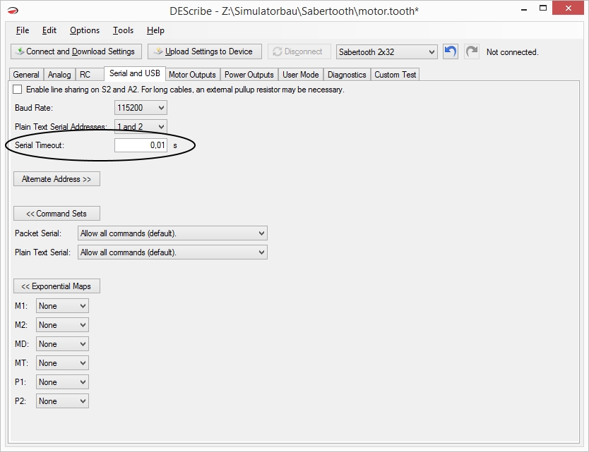

  14. Pit
    3,007
    30,516Coins
    +3,098 / 31 / -0
    100ms should be enough, mostly the rig is operating around the middle position and accelerates after malfunction. I attached the settings of Desctibe which should allow to set the timeout function on the sabertooth using the serial mode:
    An arduino code should go as well:
    Code:
    // Set Serial Timeout Sample for Packet Serial
    // Copyright (c) 2012 Dimension Engineering LLC
    // See license.txt for license details.
    #include <Sabertooth.h>
    Sabertooth ST(128);
    void setup()
      SabertoothTXPinSerial.begin(9600);
      ST.autobaud();
      // setTimeout rounds up to the nearest 100 milliseconds, so this 950 will actually be 1 second.
      // A value of 0 disables the serial timeout.
      ST.setTimeout(950);
    void loop()
      // Set motor 1 to reverse 20 (out of 127), and sleep for 5 seconds.
      // Notice how it cuts out after 1 second -- this is the serial timeout in action.
      // Since we configured it in setup() for 1 second, 1 second without any new
      // commands will cause the motors to stop.
      ST.motor(1, -20);
      delay(5000);
      // Why do this?
      // If the S1 wire gets cut for some reason, or if your program crashes,
      // the Sabertooth will stop receiving commands from the Arduino.
      // With a timeout, your robot will stop. So, it's a safety feature mostly.
