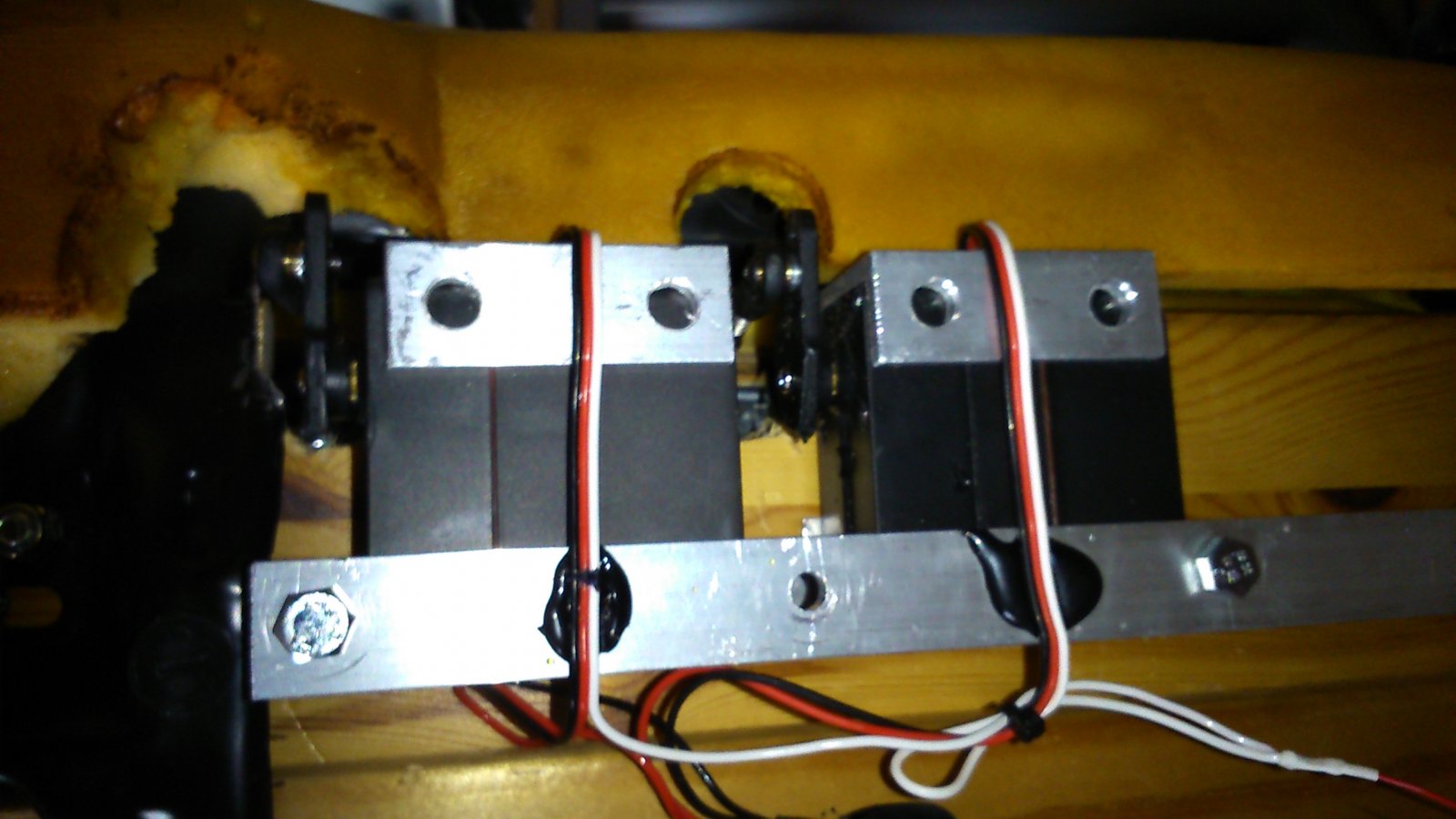

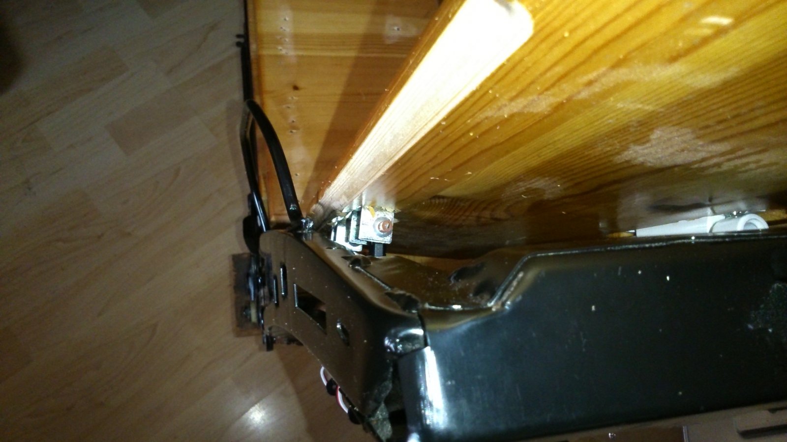

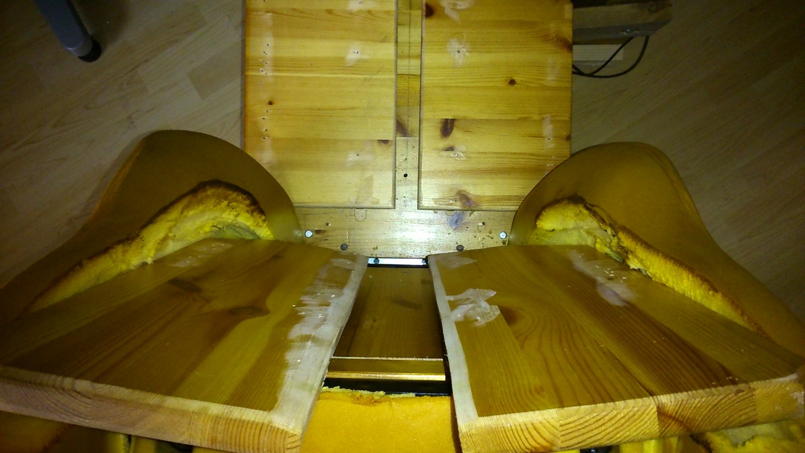

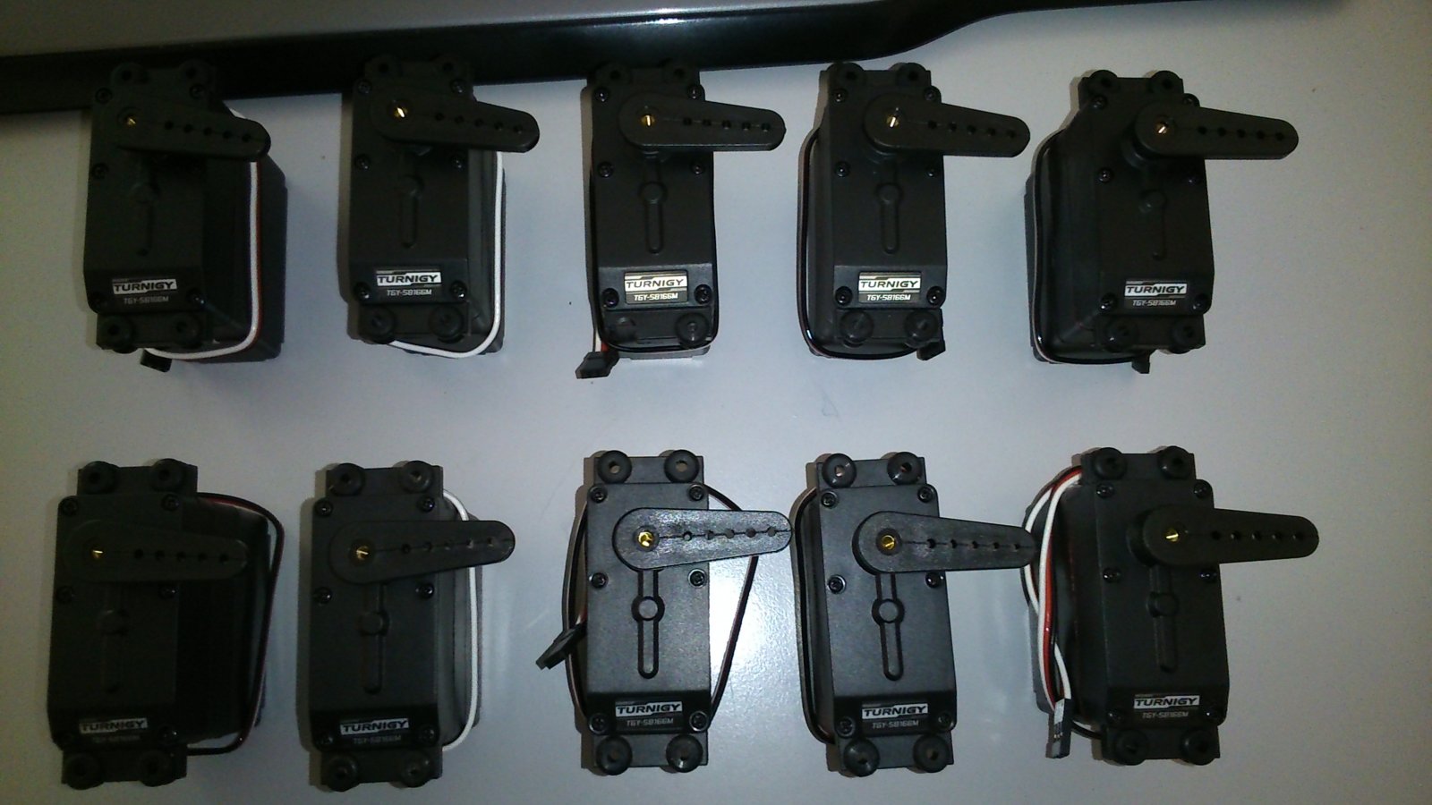

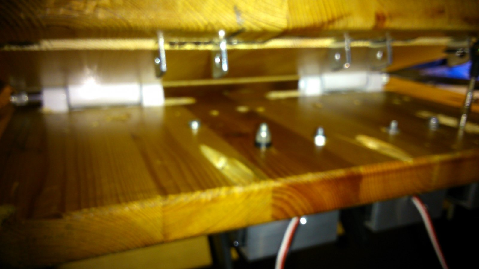

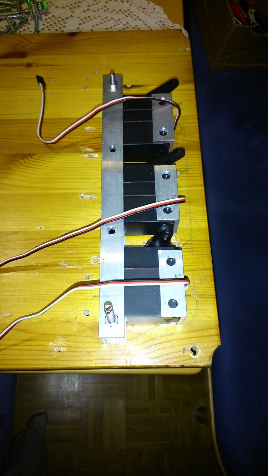

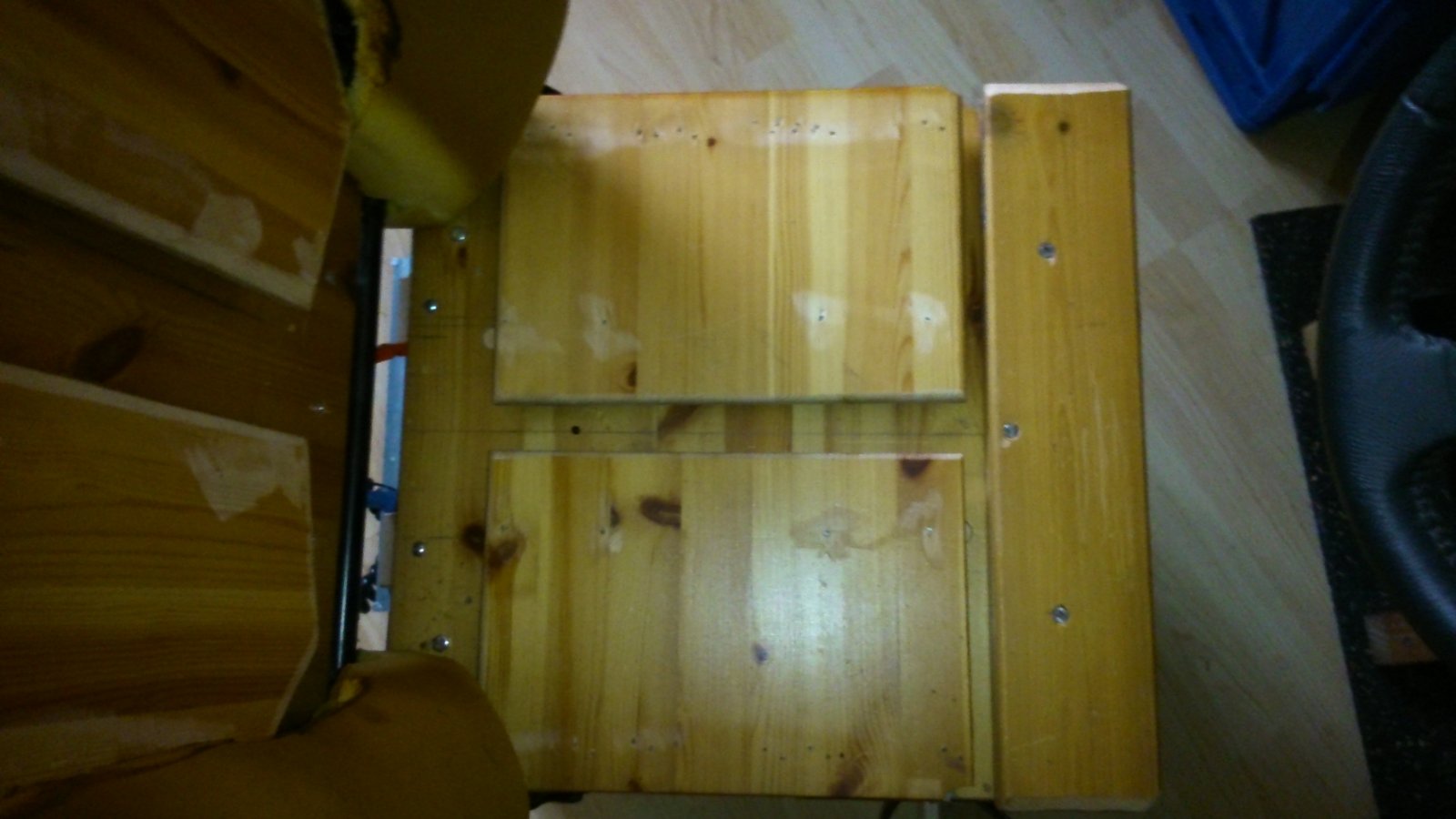

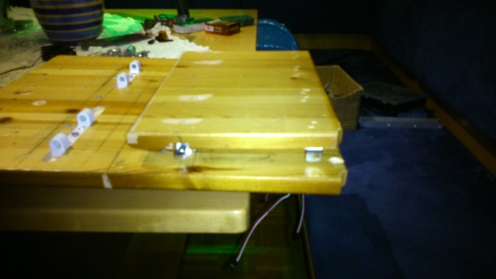

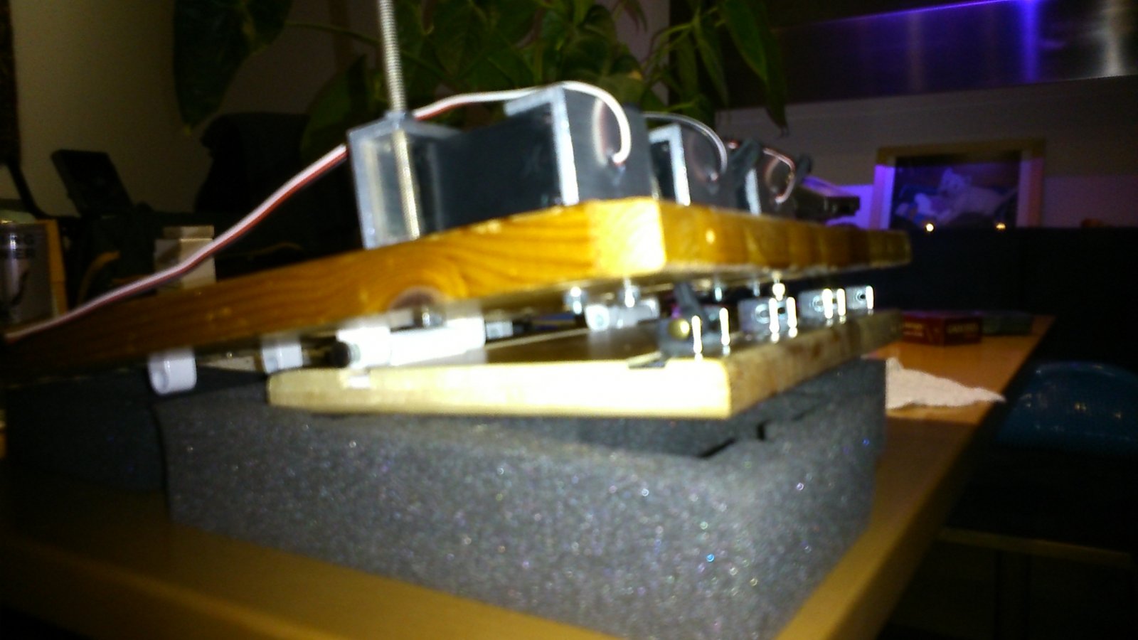

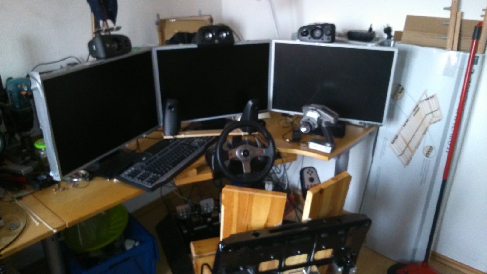

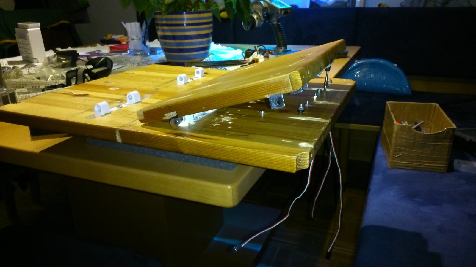

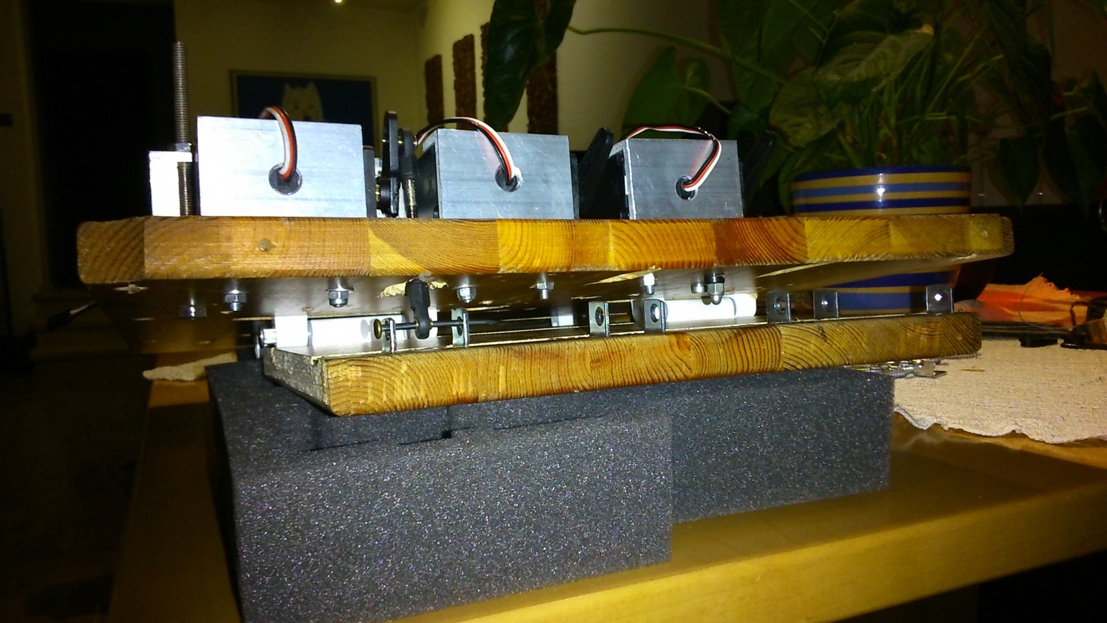

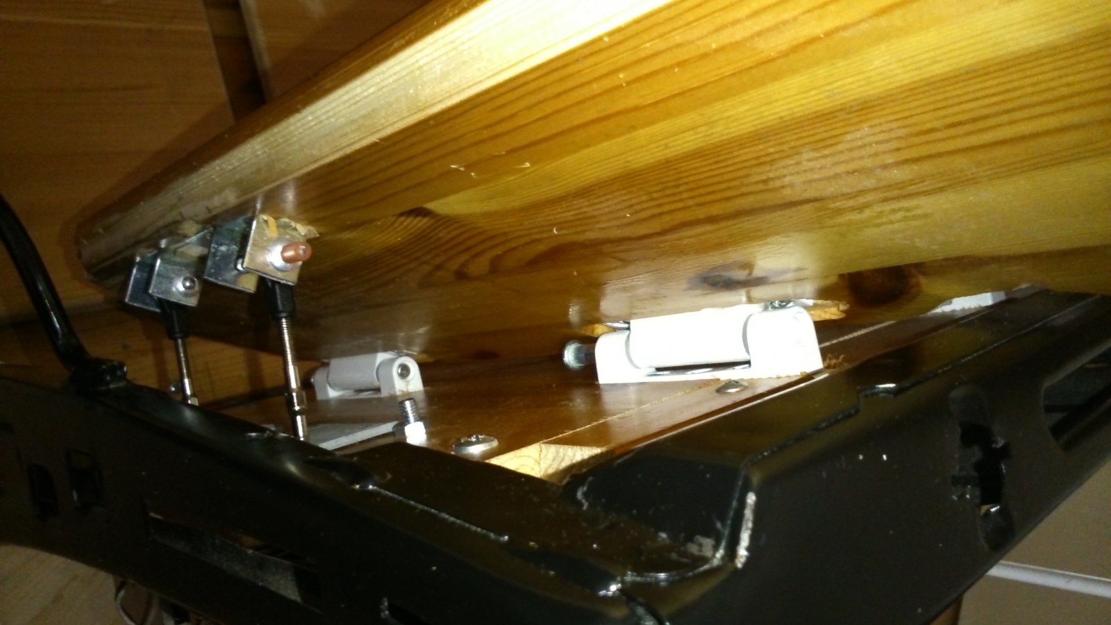

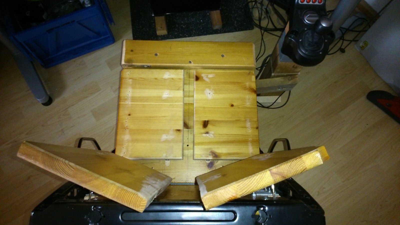

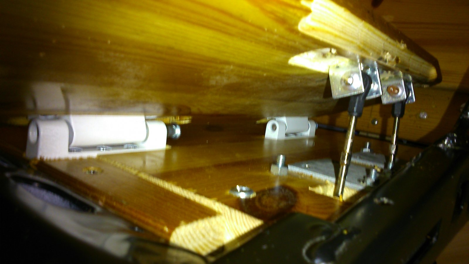

    DSC_0019.jpg Seat from a Renault Clio RS
    DSC_0020.jpg The Servos from Hobbyking
    The Servos under the Seating Surface
    The Hinge on the Seating Surface
    DSC_0027.jpg The Servos on the Backrest
    DSC_0031.jpg DSC_0032.jpg The Linkage of the Backrest
    and the Power Supply is a Meanwell 5V/55A @5,8Volt
