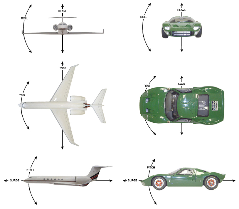

    Why using AC motors for simulators ?
    -To get your body up in the air and give you the special Heave effect " The Action Effect "...​
    The Heave effect is the most difficult and the most amazing joyful up and down feeling while playing [ changing your Altitude ].
    As other effects can be produced easily with cheap motor and DIY motor driver without effecting it's timing or force accuracy on your body ...

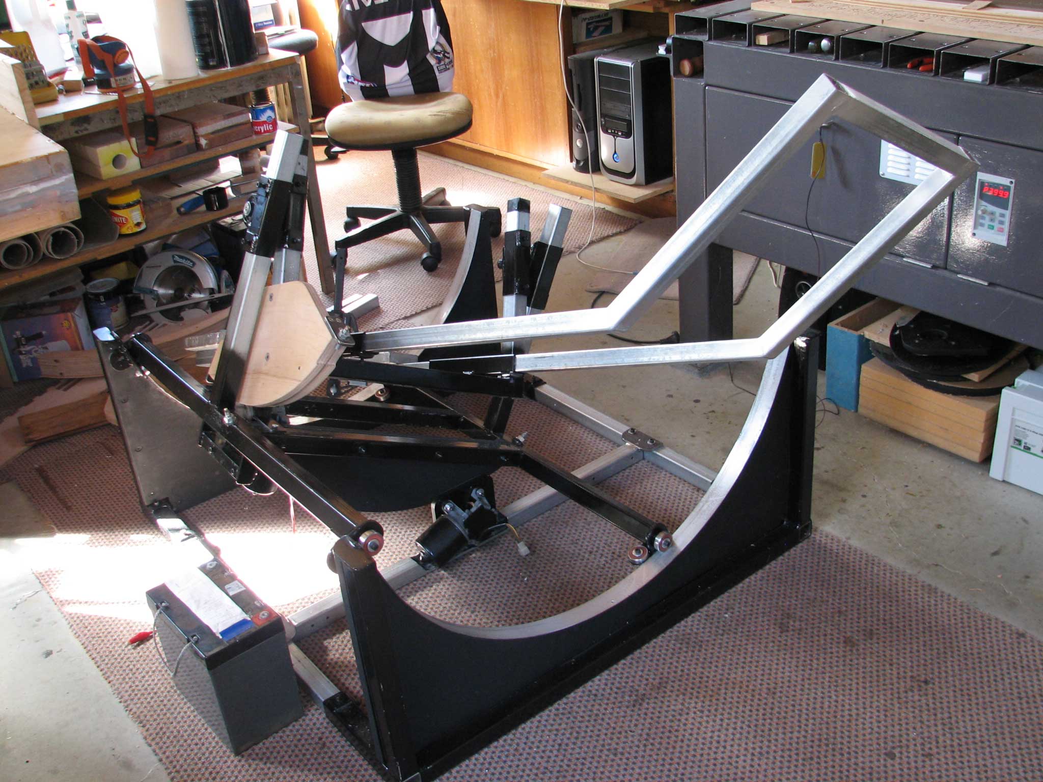

    And most Simulators in simple or complicated designs have the ability to roll, pitch ...
    See the following sliding mechanism as premium example and many others plus more modification with the same principles we get [Roll, Pitch, Yaw, Sway, Surge, Heave ] ... But not the Heave

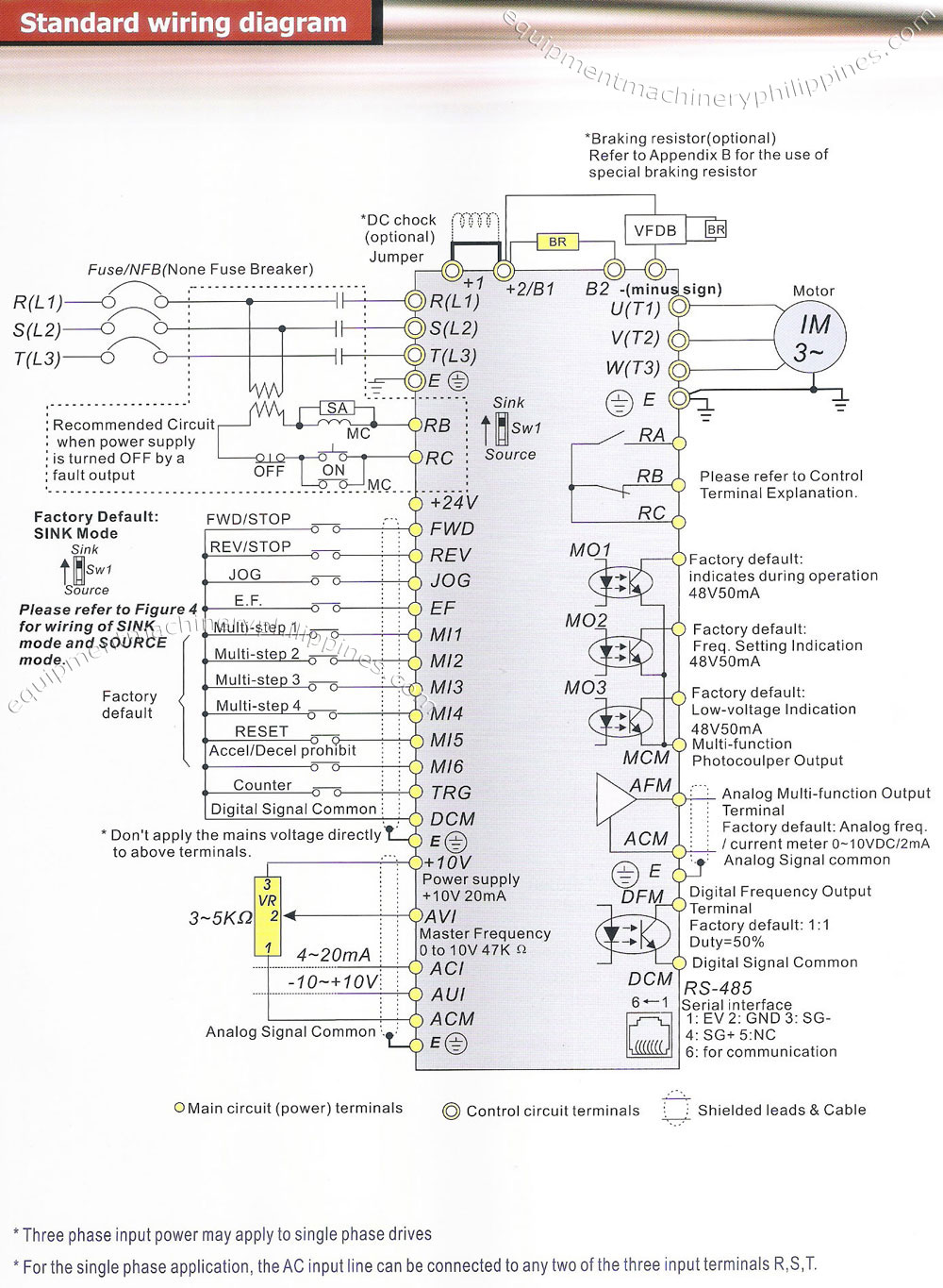

    Here is a good guide for wire things up including types of cable, routing, termination, noise management.. a must read for anyone starting their project.
    http://literature.rockwellautomation.com/idc/groups/literature/documents/in/drives-in001_-en-p.pdf
    -You have to do almost nothing in electronics " just some wiring " +"5-10 settings adjustments in the VFD S/W " it's like the settings in your new mobile phone ... and that's another beauty side of the concept ... of course not all wirings as the picture in the first post:think... you don't need all of that .:grin
    Just listing all wiring options for many driving cases all in one picture as example of a certain model .​
    And to prepare your mind in advance for what will be needed ...​
    after you have prepared the motion controller board ... connected and configured .
    you have to connect four wires from it :
    -the ground.
    -the PWM signal .
    -the two direction control signal .
    some types of VFD's accept the PWM and direction control signals as it is provided "digital level " from the motion controller board ...
    some types are not full compatible "good news these types are cheaper" with the signals that is provided and we have to convert these signals to fit the VFD's input . a very small circuit then is needed just to convert the PWM signal into a 0-10v analog signal ... Exactly like the one @yobuddy did before ...
    that's all ...

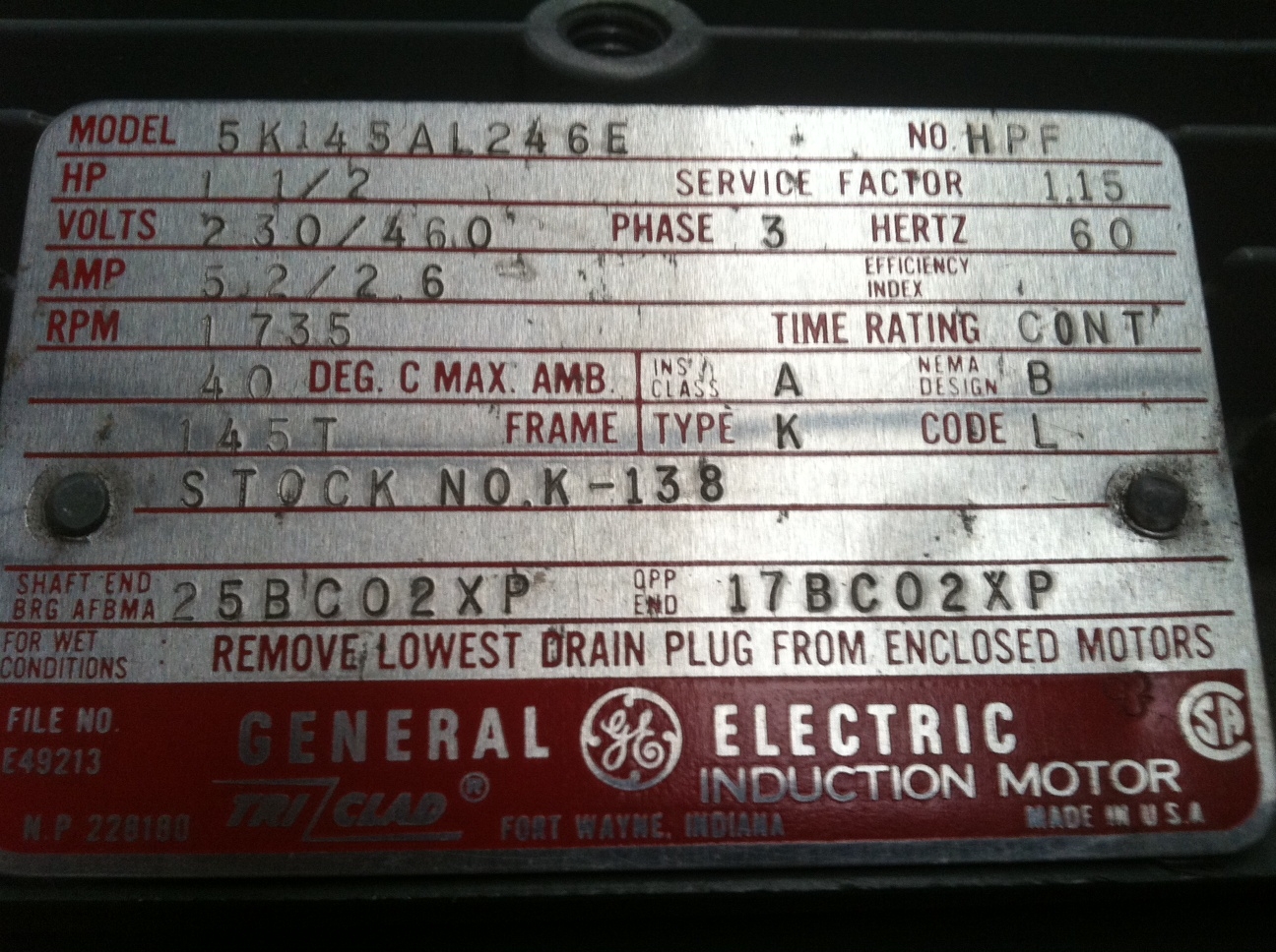

    In my sim actuators I use a 3ph - 1/2hp -50Hz-1735RPM SEW motor with it's gear that gives out 43Nm torque on it's shaft ... I'm using a max driving freq. of 70Hz in the VFD that's almost one and half the original freq. ..." see the video of my sim again "... and the total actuator have a max linear speed of 25cm per second ... and I took a bunch that knoked me back almost on the ground one day when testing it's capability at the first beginning ... so I had to reduce it's speed also not to give me an overshooting problem with the total motion .
    If a motor on the name plate is coded with 60Hz and 1735RPM ... Like the above example .
    then when driven on that frequency it will give that rpm ...
    when driven on double that frequency it will give double that rpm ...
    But not all motors windings can handle such over speed for long time ...
    so when programing a VFD ... A 80-100Hz max driving frequency is very very good setting to be saved and used ...

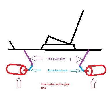

    So basically without stressing the motors or the inverters using up normal freq. or any odd VFD adjustments :
    -If you'll use a 10cm rotational arm attached to the each output gear shaft to move your chair like @vicpopo did above ... BTW " use a thick good fixed one " cause 10cm arm will give you over the 100Kg lifting force with each gear . check the torque here
    So with an output shaft speed 30 RPM/60 = 0.5/RPsecond ... you will get a [half revolution ] = 180 degree in 1 second by that rotational arm ...​
    -If you attach a push arm between the tip of the rotational arm and to be mounted beneath your motion base parameter ...
    that would be a 20cm/second change range in altitude up/down for each side of your chair per second [ that is your max linear speed ] ...
    And that would be the amount of maximum tilting for your motion base ... use longer rotational arm 15-20 cm with the front motor if you need more pitch .​
    Excuse my bad drowning ... but I guess my idea is clear .
