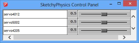

Once you have your model, make sure it moves as expected with the sliders and save a copy.
Sliders

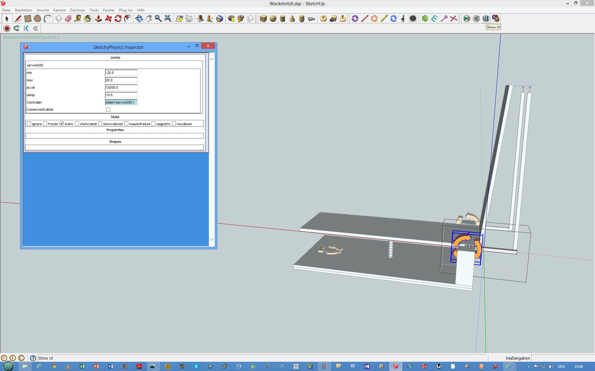

Select one of your servos and click on „UI“ to show the SketchyPhysics Inspector:
UI
Under „Controller“ you will find something like „slider(’servo4205′)“. Replace this with „$axis1“. This is our new global variable, that will be used to drive the servo instead of the slider. Repeat for all servos and replace the slider names with „$axis2“, „$axis3“, etc. When all done the SketchyPhysics Control Panel should be empty (or at least no liders for your servos) when clicking Play/Pause. Save the model and close SketchUp.

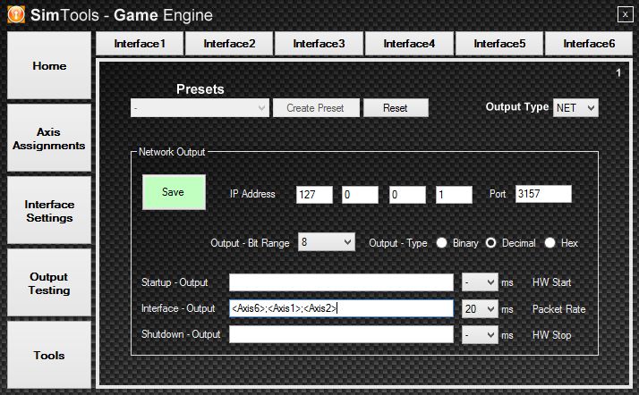

In GameEngine setup your interface to Output Type: NET. When running GameEngine and SketchUp on the same computer enter 127.0.0.1 as IP address (otherwise the IP address of the PC that runs SketchUp) and Port 3157. Output – Bit Range shall be 8 and Decimal. In the Interface – Output field enter the axis you want to assign to the servos in SketchUp, separate the axis with „;“. Then click Save.
SimTools_Interface
Here my axis settings for the model attached:
Axis Assignments
