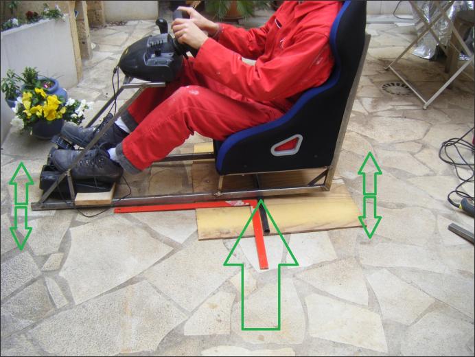

The ignition key, of course = :))
a plate on the side of the wheel holder:
and here is a „starter / emergency stop“ key §
The pedal support
the right bracket must be folded down!
folding legs with a hammer
Dirlling of the pedals and support plate at the same time
Two-components glue bonding and 4 screws M5x16
take the opportunity to remove the unnecessary ballast which adds to the inertia of the system 🙂
[gard]
after painting (and shorter legs):
[gard]
and perspective view
The 4-point harness
In fact, it is a 6 points but it’s too much ! and not comfortable : 4 is fine.
welding a small bolt
the clip can be mounted and removed
side view:
Overview:
    conclusion: the harness is great!
– For the look 😎
– For immersion: it feels like being in a rally car!
– For sensations: I think we fight less against movements playseat, it is more inclusive
but it requires a keyboard support!
The bottom
To finish the structure, a wooden bottom on which I can put my electric stuff
Drilling diameter 4, threading M5 and screw
The rubber feet
Essential accessory: small rubber feet to absorb vibrations and provide stability on the ground.
Here are some hard plastic and adjustable feet
Width of the frame
I aimed a compact size to begin with
Edit: The first tests have shown that … it was not wide enough!
then I added + 11 cm on each side (it must go through the door ^ -) for a total of 68 cm
The Center of Gravity cdg
I determined it with „precision“ with an assistant:
on a tubular steel rod, roll frame until you find the balance
with the driver in it!
(the rod has to be perpendicular to the plateform !)
