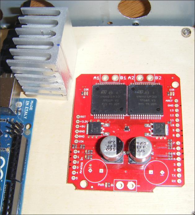

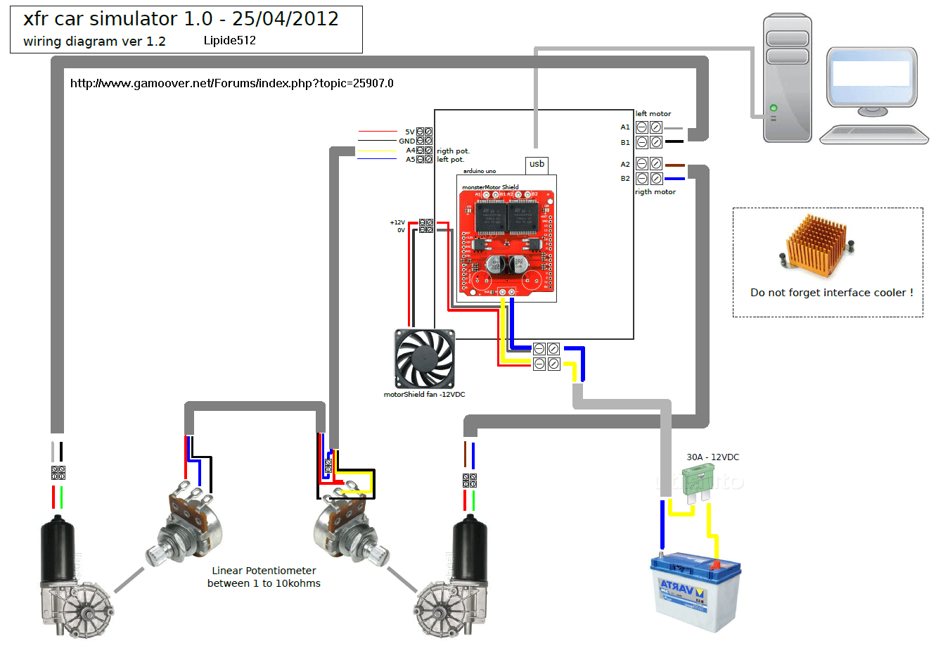

Cards: Arduino and MotoMonster:
here, the wiring diagram drawn by Lipide512
motomonster_wiring
Arduino /..Motomonster1
……GND <-> GND pin
……..5V <-> 5V
…..pin 4 <-> pin 4 inA motor1
…..pin 5 <-> pin 5 pwm1
…..pin 6 <-> pin 6 pwm2
…..pin 7 <-> pin 7 inA motor2
…..pin 8 <-> pin 8 inB motor1
…..pin 9 <-> pin 9 inB motor2
I choose not to stack the two cards although it is expected to:
– I wanted to keep me a chance to reallocate the outputs of the Arduino
– I wanted better cooling system (so I raised the motomonster)

Heat sinker had to be cut in half in order to have a good contact with the 2 chips (uneven)
go for the thermal paste
spreading the paste:

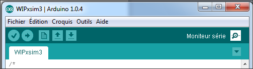

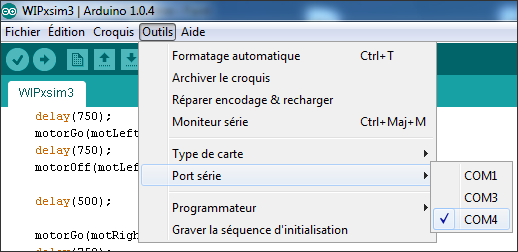

*/ Arduino : install manually the drivers (see the Arduino’s documentation for Windows Seven installation).
After complete installation, find in the Windows system on which COM Port it has been installed : you will need to put this information in SimTools interface.
Double clic on Arduino’s line and adjust the default speed :
In the Arduino plateform, put the right COM Port : if not, you won’t be able to upload your program into the Arduino…
If you need to lead some communication tests, use the Serial Monitor („magnifying lens“ on top right ).
Adjust here as well the same default speed :
