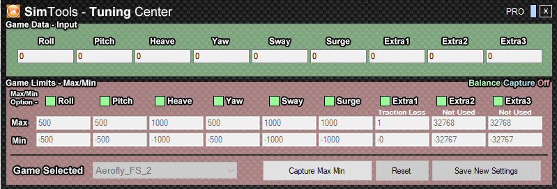

    This plugin provides pitch, roll, yaw and surge, sway and heave by using the given values from the latest aerofly sdk by IPACS and transfering it via UDP. Tested on DOF Reality P6 Motion Platform with Cessna 172SP, King Air C90 GTx, Baron 58, Boeing 777-300R, ASG 29 (Glider) and Robinson R22 (Helicopter). SimTools config (which is used for testing) are attached as images.
    Pitch (absolute angle, translated from sdk.aircraft_pitch * -1)
    Roll (absolute angle, translated from sdk.aircraft_bank)
    Yaw (relative angle, translated from sdk.aircraft_rateofturn * -1)
    Sway (relative angle, translated from sdk.aircraft_angularvelocity_x)
    Surge (relative angle, translated from sdk.aircraft_angularvelocity_z)
    Heave (relative angle, translated from sdk.aircraft_angularvelocity_y)

    Images
