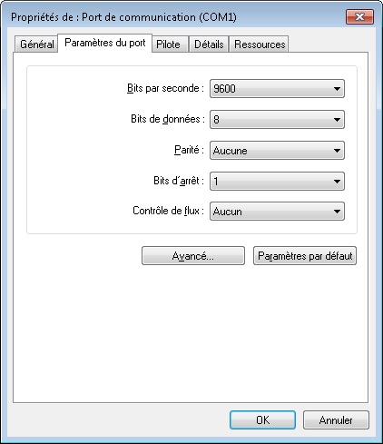

Your COM port must be configured like that (default settings) :
