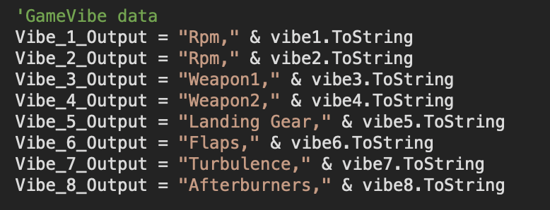

    GameDash data:
    Generic Var1-Var20. In the export script you can assign values to those slots to get the data you are interested in exported to GameDash.
    GameVibe data:
