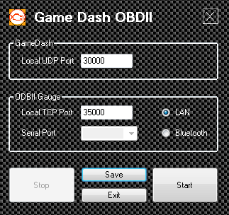

    I have create this program that emulate a ELM327 with protocol ISO 14230-4 KWP for using with a OBDII dashboard.
    (tested with free app: Dashcommand, Torque , CANdroid, OBD dashboard)
    this work via LAN (WiFi) o bluetooth

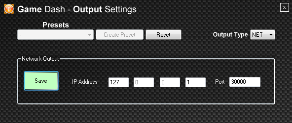

    you must configure Game Dash to send data via LAN

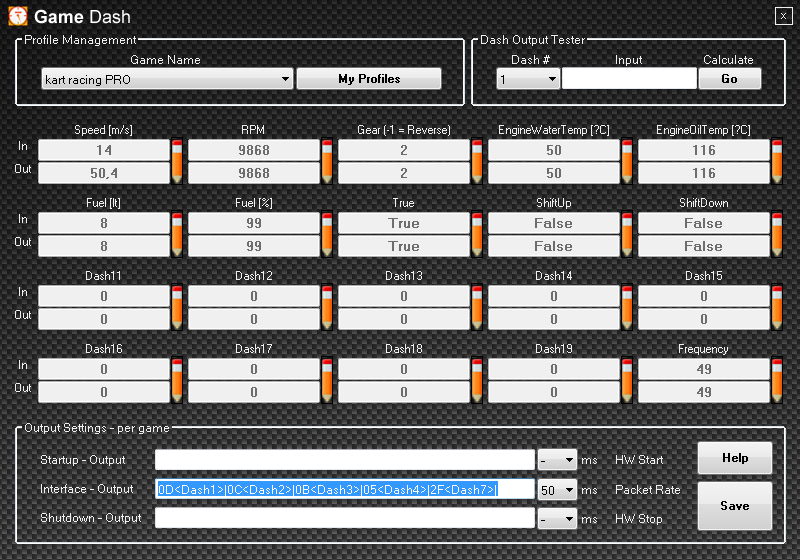

    and in interface output an hexadecimal number according OBDII protocol for Mode 01 PIDs and separator (|)
    http://en.wikipedia.org/wiki/OBD-II_PIDs
    my config :
    Interface – Output : 0D<Dash1>|0C<Dash2>|0B<Dash3>|05<Dash4>|2F<Dash7>|
    where 0D is speed, 0C is RPm, 05 Oil Temp, 2F % Fuel and 0B for GEAR.

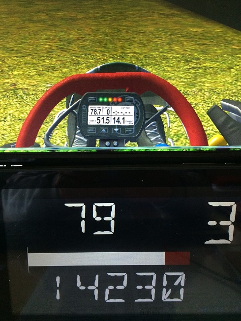

    The gear parameter is not standard of OBD protocol, but with CANdroid i have personalized a widget to see a big number.

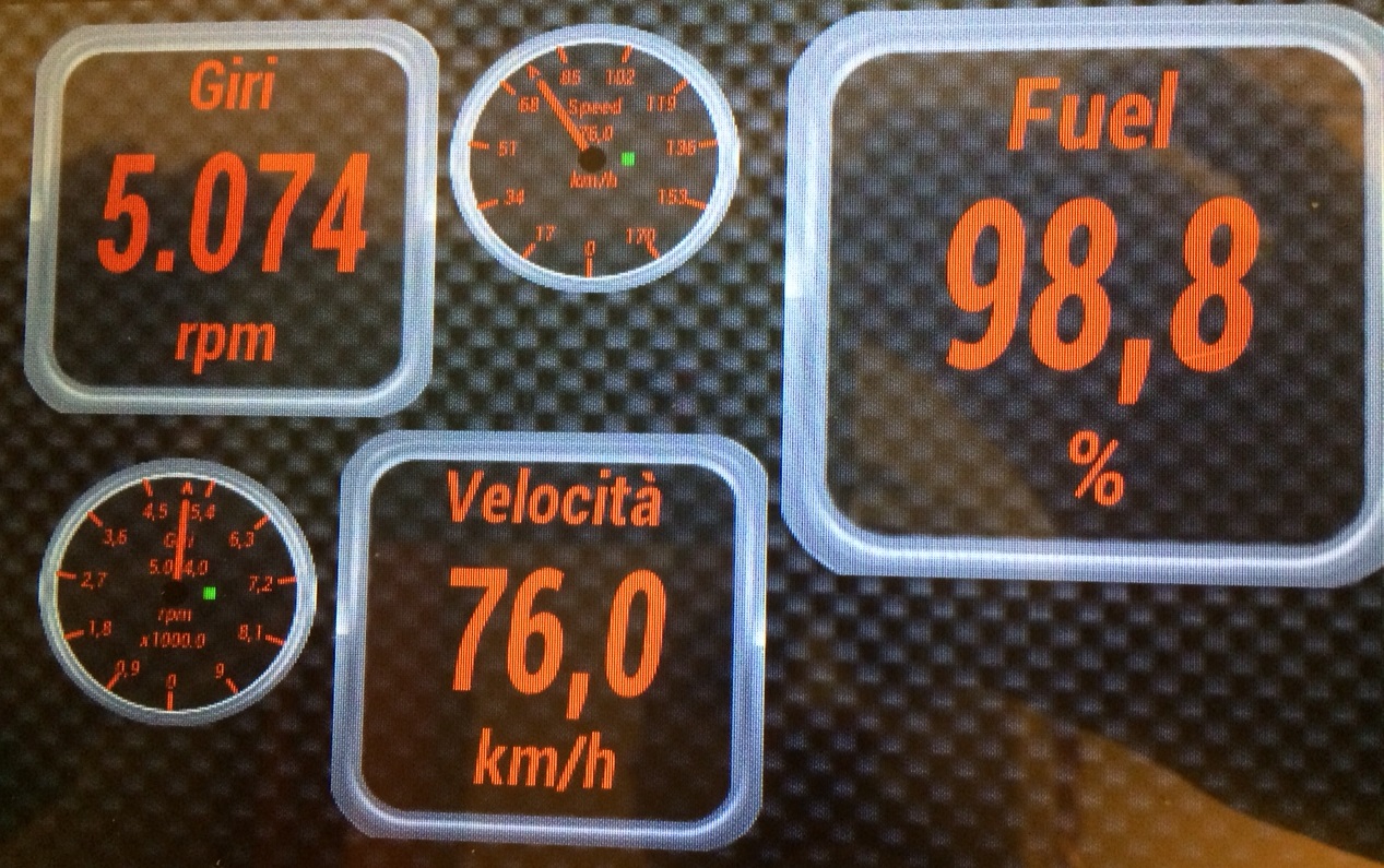

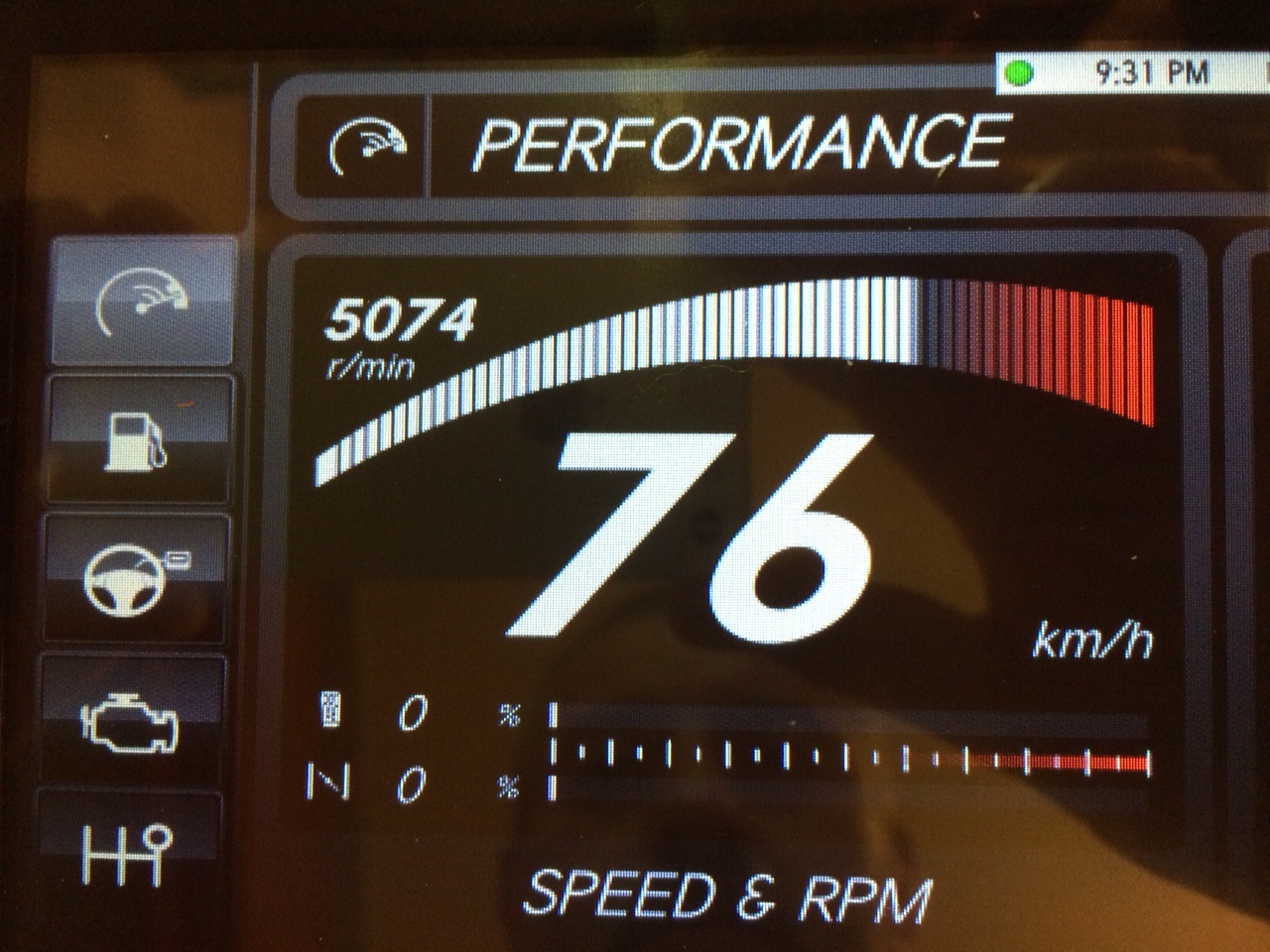

    there are saveral app for OBDII with more widget and theme for create a personalized dahsboard
