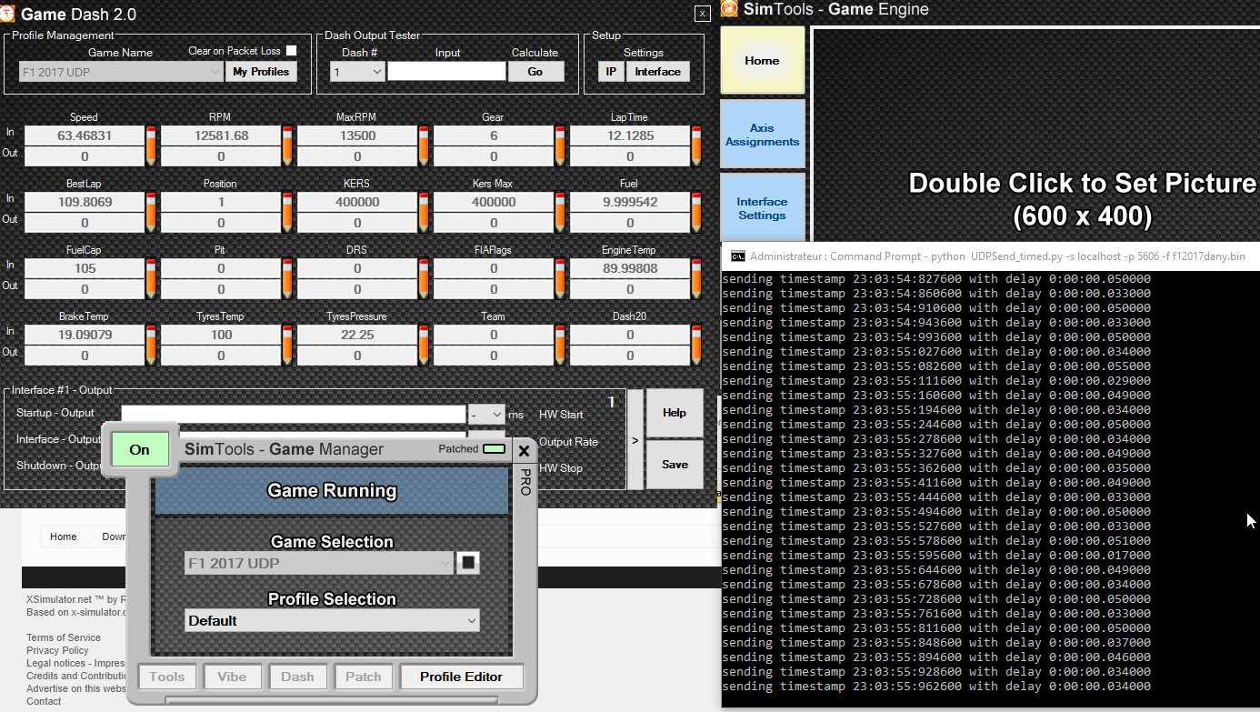

    This plugin uses the updated codemasters UDP data which provides directly roll/pitch/yaw/heave/sway/surge with no additional calculation.
    Max/Min not included in the plugin, so remember to adjust it in Tuning Center
    Thanks to @santanadany who gave me a UDP capture so I could make some
    code adjustements.
    Installation: drag/drop the zip file onto SimTools Plugin Updater, then select the plugin in GameManager and go through Patching to activate it. Then start the plugin by clicking the "Play" icon . You will also have to capture Min/Max values if needed.
