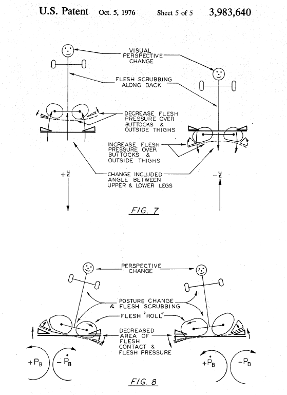

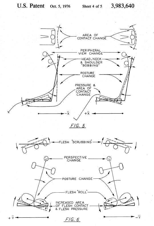

US3983640 "Advanced Gseat for aircraft simulation" 1976
  1. RacingMat
    To complete the DIY posts :
    - this nice post about DIY Gseat "G-SEAT with K8055 - WIP"
    - and Scluzu's gSeat,
    - and bergison,
    - and spyderwash
    here is the full patent document -> clic on the "Download Now" orange button
    US3983640 Advanced G seat for aircraft simulation 1.png US3983640 Advanced G seat for aircraft simulation 2.png

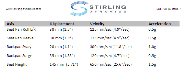

    pdf with technical data (speed, acceleration)

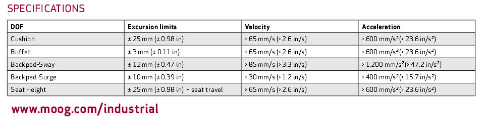

    Simulates positive and negative G-forces by changing shape of the seat pan, altering the tension on the seatharness straps and raising or lowering the height of the seat bucket.
