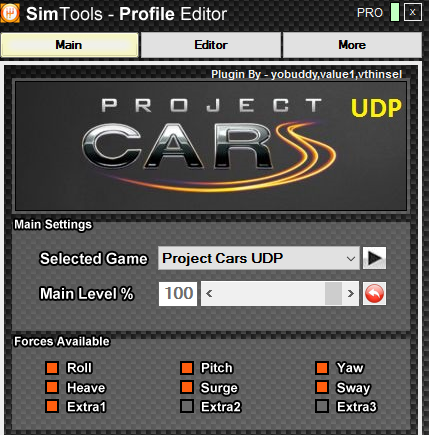

The plugin supports yaw/pitch/roll, heave/sway/surge/traction loss (in extra1) and also full GameDash support.

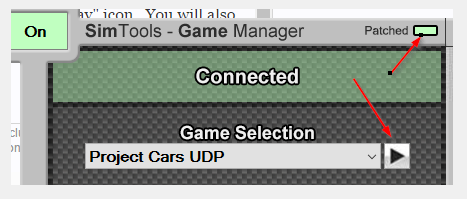

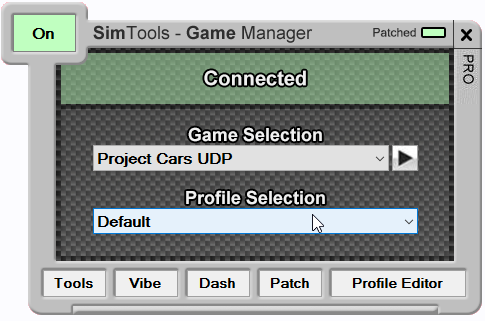

Installation: drag/drop the zip file onto SimTools Plugin Updater, then select the Project Cars UDP in GameManager and go through Patching to activate it. Then start the plugin by clicking the "Play" icon . You will also have to capture Min/Max values if needed.
