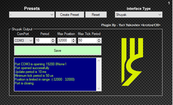

    This plug-in allows you to interact with the control board of the 6-axis platform "Shuyak". The plugin implements a binary protocol over a serial port.
    The following serial port parameters are used 19200 8N 1 .
    At startup, the plugin sends a message
    0xFF 0xF0 0x00 <low byte of output rate ms> 0x00 <high byte of output rate ms> 0x00 <low byte of min tick period> 0x00 <high byte of min tick period> 0x00 <low byte of max pos> 0x00 <high byte of max pos> 0x00 checksum
    During the game, the plugin sends a message
    0xFF 0xFF 0x00 <low byte of Axis1a> 0x00 <high byte of Axis1a> 0x00 <low byte of Axis2a> 0x00 <high byte of Axis2a> 0x00 <low byte of Axis3a> 0x00 <high byte of Axis3a> 0x00 <low byte of Axis4a> 0x00 <high byte of Axis4a> 0x00 <low byte of Axis5a> 0x00 <high byte of Axis5a> 0x00 <low byte of Axis6a> 0x00 <high byte of Axis6a> 0x00 checksum
    The checksum calculates as bitwise not (<size of data (6 for setup and 12 for axis)> xor <all data bytes>).
    This is debugged version of the plugin.
