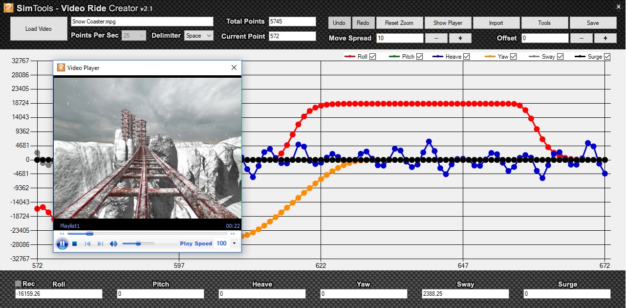

    Here is the official release of the Video Ride Creator!
    The goal of this project is to enable the ability to make our own video rides films for our simulators.
    Here are some Highlights of the Video Ride Creator.
    - Creating New Telemetry files for videos.
    - Editing Telemetry files for a videos.
    - Re-formatting an Existing Telemetry file for SimTools.
    - Telemetry Offset
    - Axis Scaling (by slider, by a known max value, or by percent)
    - Axis Shifting
    - Axis Smoothing
    - Axis Flipping
    - Axis Swapping
    - Undo & Redo Buttons!! (Up to 100 moves - This one was challenging!)
    - Manipulate Multiple ‘Points’ at the Same Time. (You can move 1 to 201 at a time)
    - Live Telemetry Recordings (with sender example source code ready to post!)
    - Telemetry Point Doubling
    - Exact point Value edit
    - Telemetry Importer
    - Axis Zooming

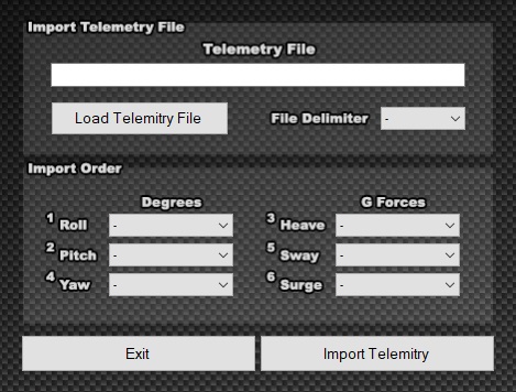

    Here is a pic of the Telemetry Importer.

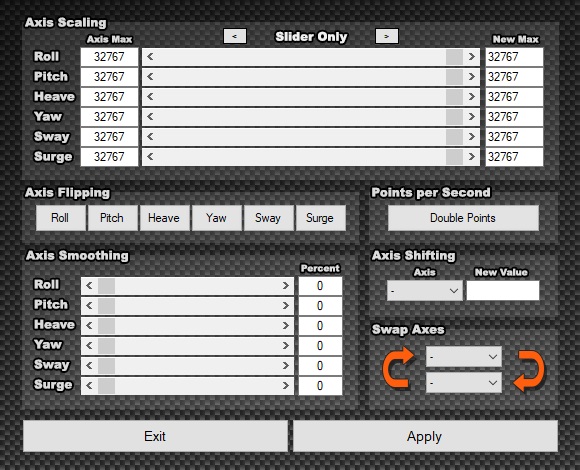

    Here is a pic of the Tools.
