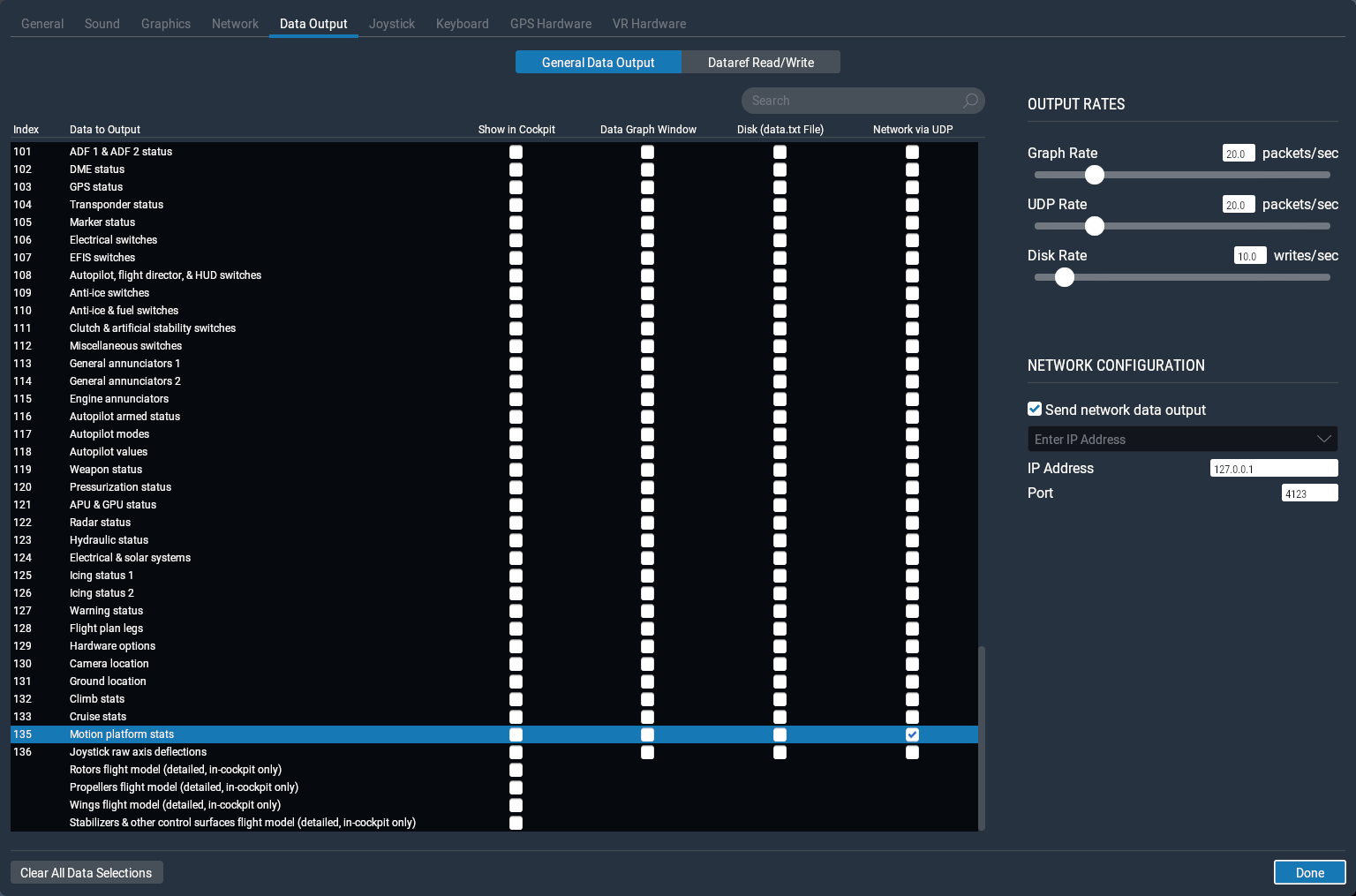

    Notes on installation:
    • If you had installed the old X-Plane V10 plugin, you might need to remove all xplane* files from C:\Users\user\AppData\Local\SimTools\
    • In the settings menu of X-Plane (upper top right corner) upload_2019-9-1_16-10-12.png check at least index 135, Motion platform stats – Network via UDP, IP address 127.0.0.1 and Port 4123.
    For SimDash and Simvibe also check index 3 (Speeds), 17 (Pitch, roll & headings), 37 (Engine RPM) and 38 (Propeller RPM). Other datasets can be checked additionally, we don't care.
