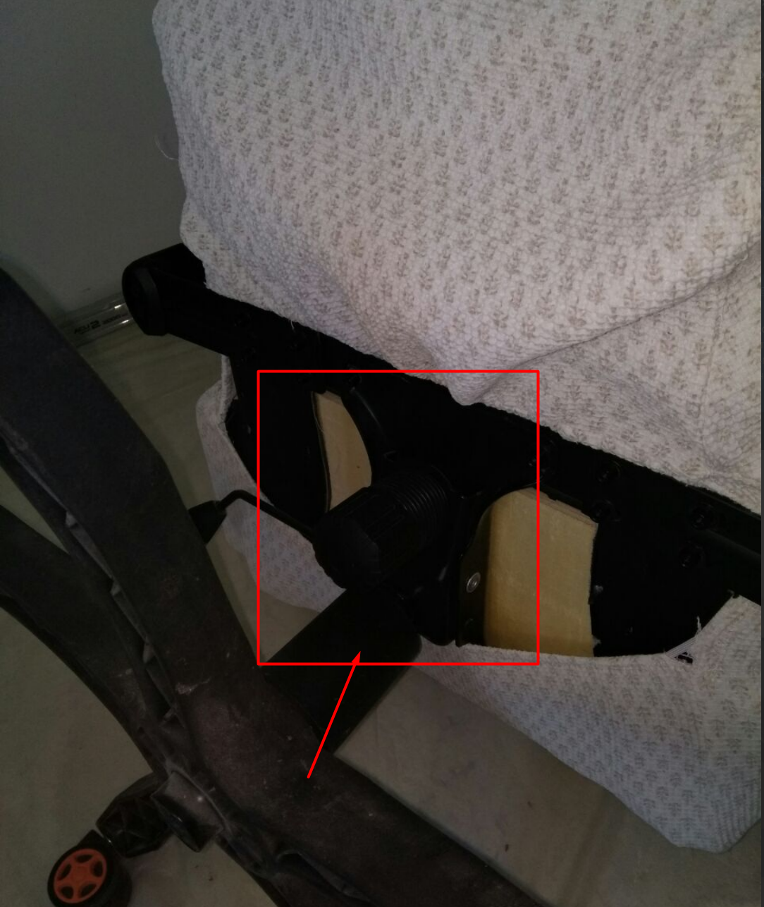

    Concept:
    To create an inexpensive project for a deeper immersion into sim racing without cluttering up the space with a large cockpit.

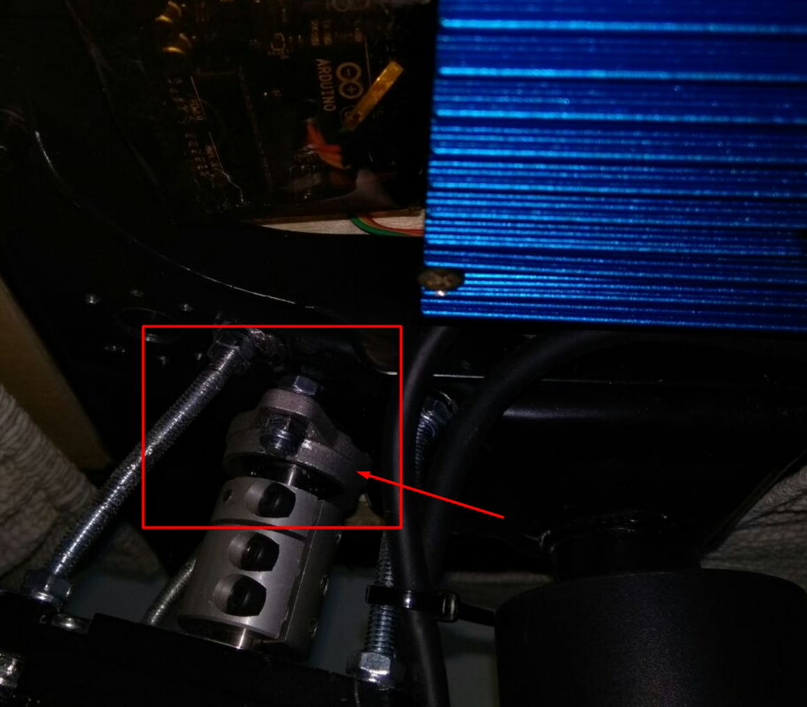

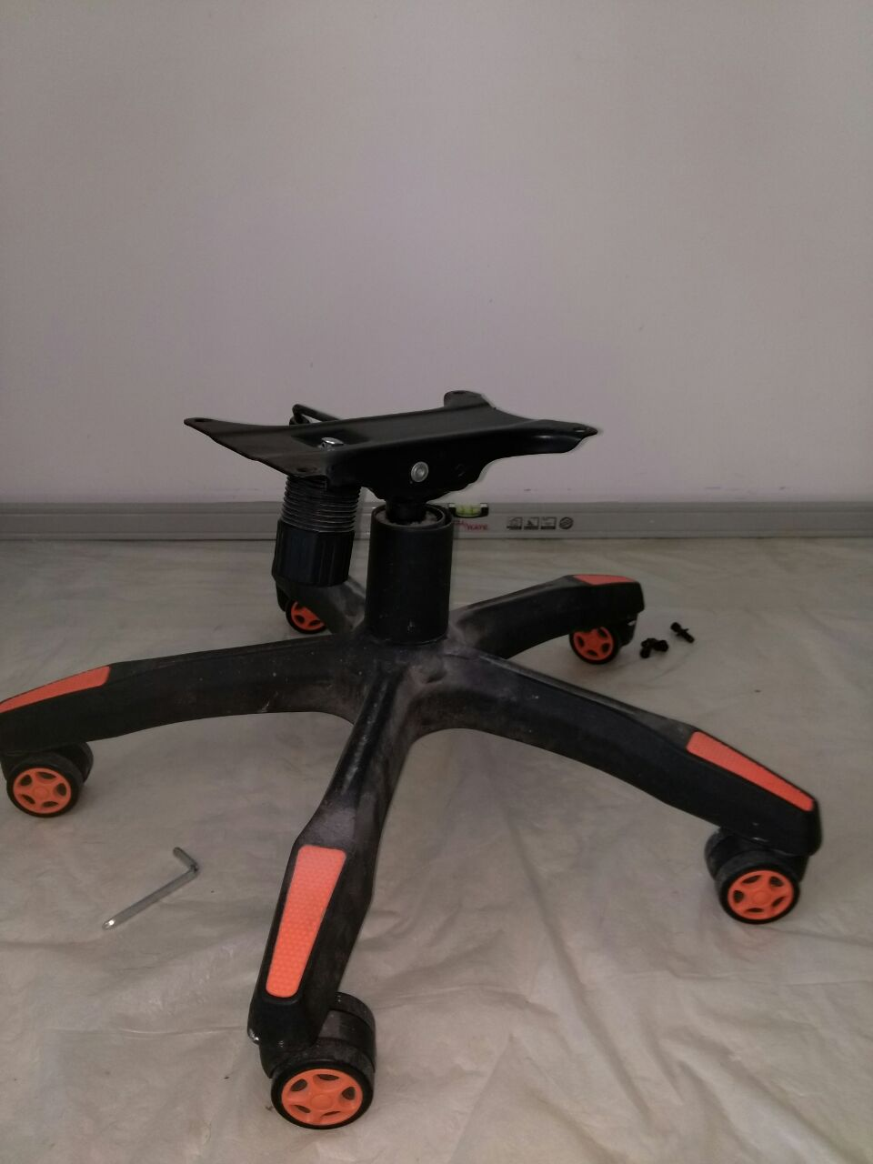

    We have a regular office chair with a rocking chair option. Our task is to remove the spring and replace it with a servo drive. We are not changing the rest of the functionality. upload_2025-7-14_10-4-29.png upload_2025-7-14_10-5-23.png

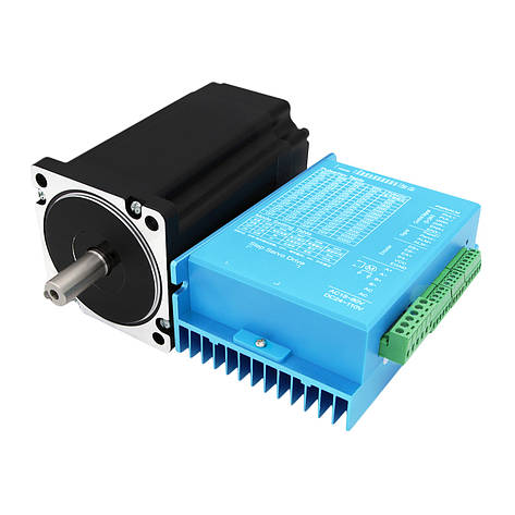

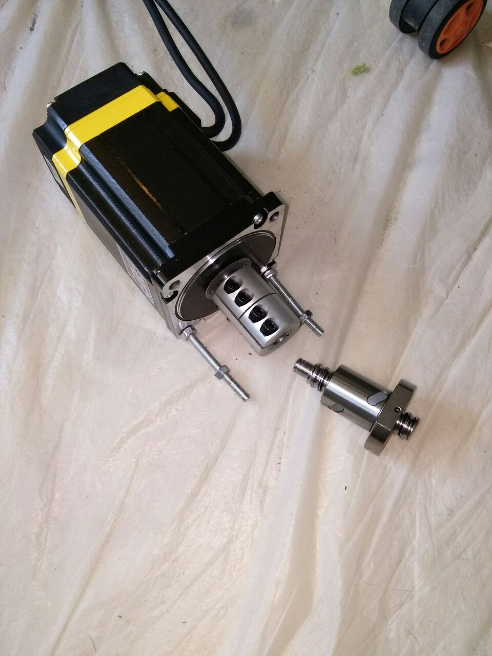

    Calculations showed that a 2 Nm motor would be sufficient to generate a lifting force of 100 kg. However, we decided to play it safe and go for an 8.5 Nm motor. [​IMG]
    Stepper servo drive with encoder (feedback) 86EBP145ALC-TK0 + HBS86H, 8.5 Nm

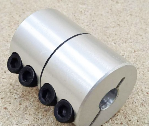

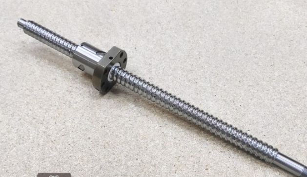

    We will also need a SHV1605 screw and a 10-14 mm D32L45 rigid coupling.

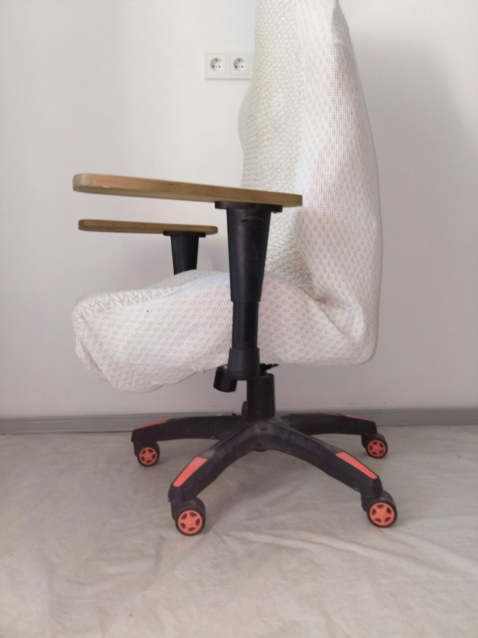

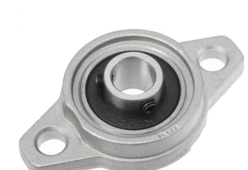

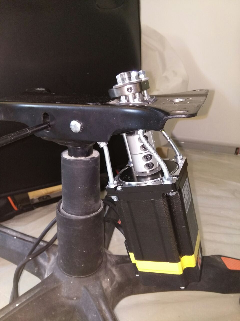

    We take apart the chair, remove the spring, drill a hole to put the axle in, cut the axle to size, and screw it on.

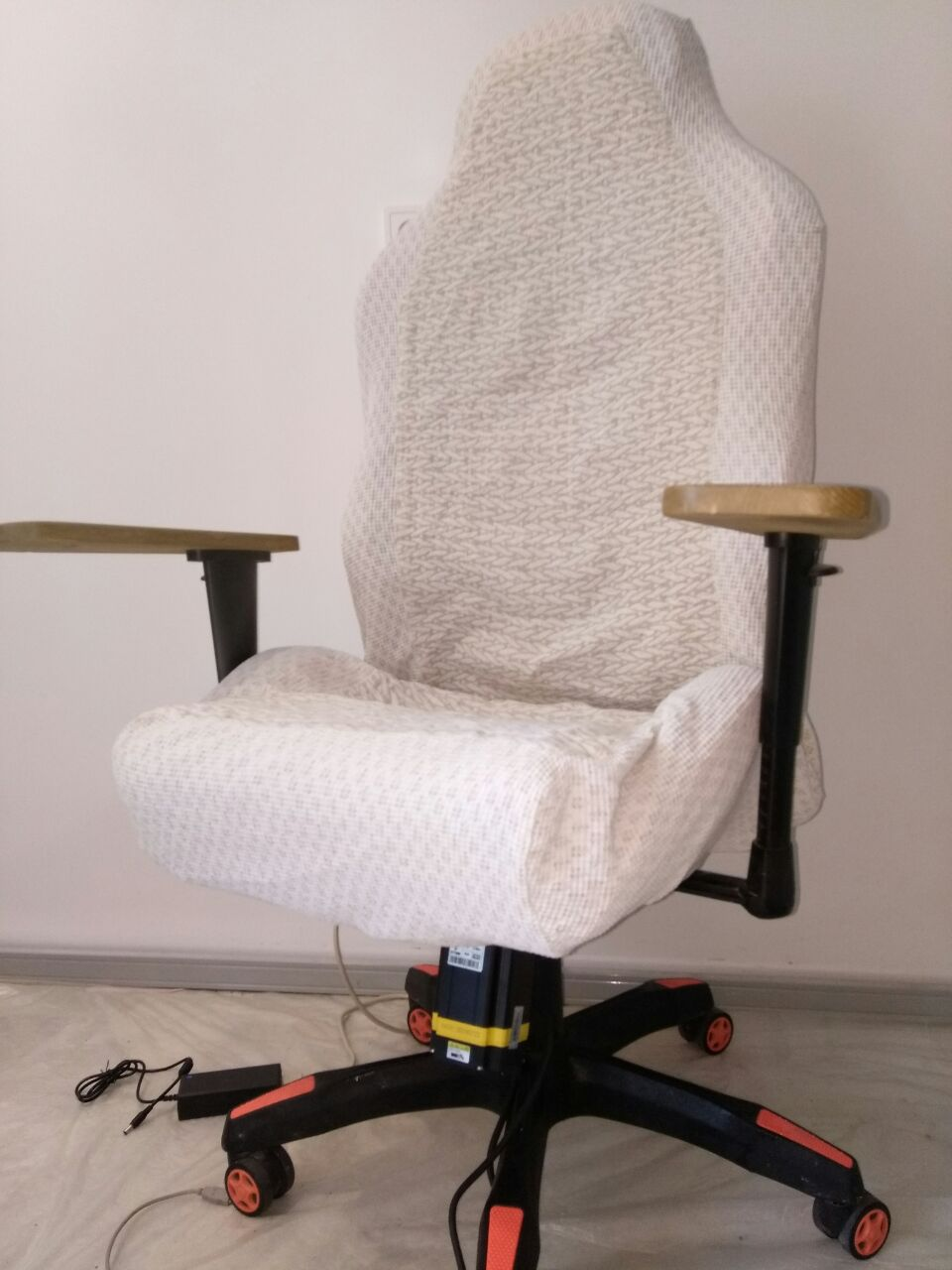

    We received a chair that can be used as a regular chair, but can also be used as a single-axis sim racing chair.

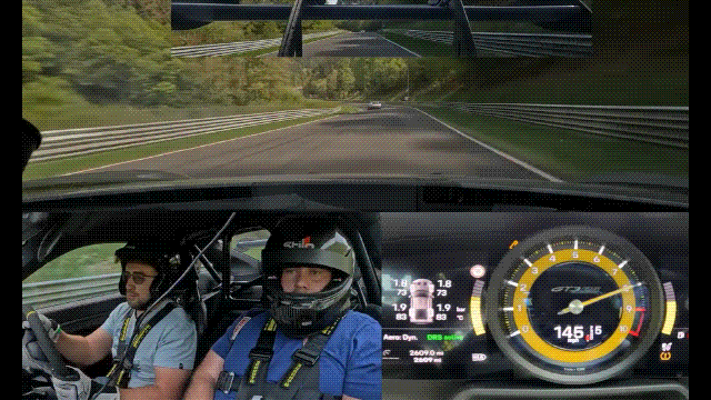

    I would like to say a few more words in support of such single-axis cockpits.
    Three types of input data can be used:
    heave
    surge
    pitch
    This is sufficient for normal driving. Probably the most sought-after axis is heave, which is responsible for shaking.
    The pitch axis is also good when driving up or down a hill, as the car tilts.
    Surge gives the effect of tilting the car when pressing the accelerator or brake pedal.
    Side tilt is not usually present when driving a car in reality. upload_2025-7-14_21-55-11.gif
