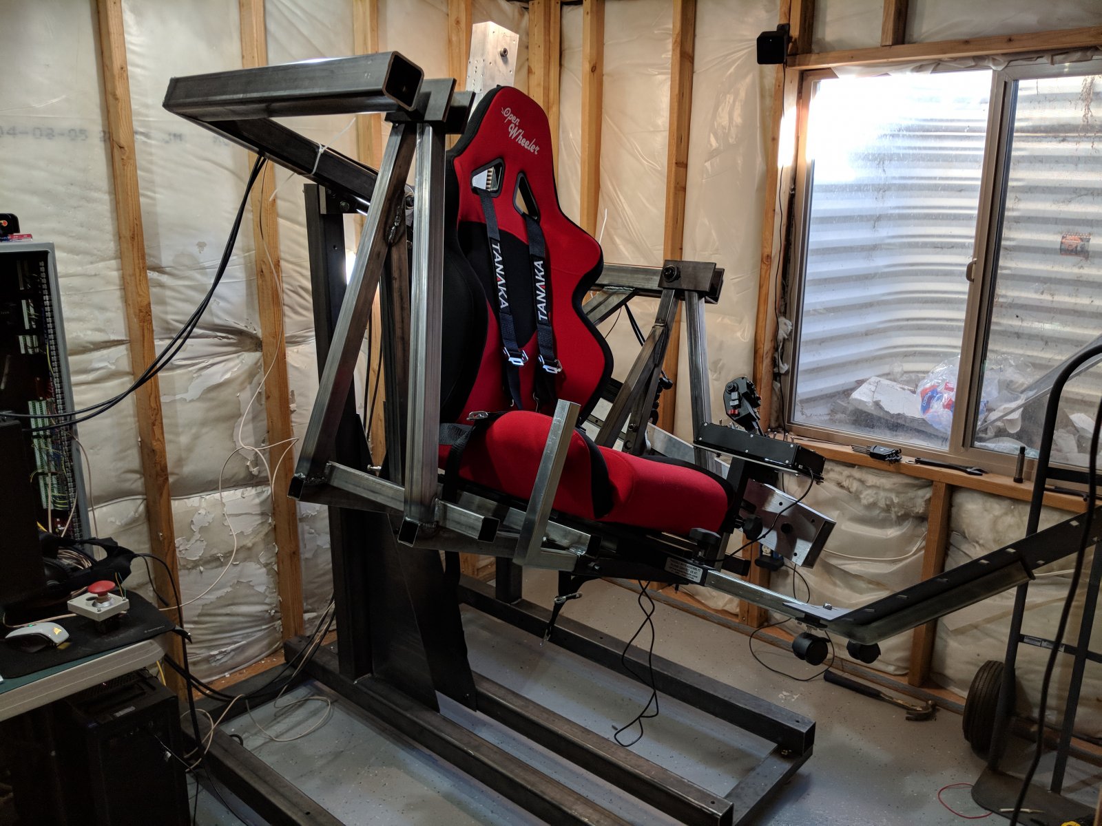

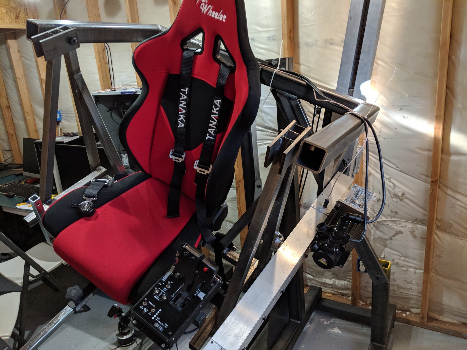

    Hey all! Someone pointed out that this community exists, so I thought I'd jump in and share my project.
    My brothers and I have been working on a 2-DOF motion simulator for VR (see the attached pictures).
    Some system specs:
    Max rotation: +/- 45 degrees pitch and roll
    Max rotation rate: ~ 30 inches / second
    Actuators: 2.3 kW servo motors driving timing belts, connected to linear guides on rails.
    It is currently controlled via a PLC, which is in turn connected to a simulation running on a PC. We intend to replace that with a custom control board so that we can do more complex motion profiles at the hardware level. But that's a project for later.

    Very awesome project! What model of motors do you use?

    Thanks! We used two 2.3 kW servo motors. Part number 130ST-M15015. I'd post a link, but I'm not allowed yet. :)
