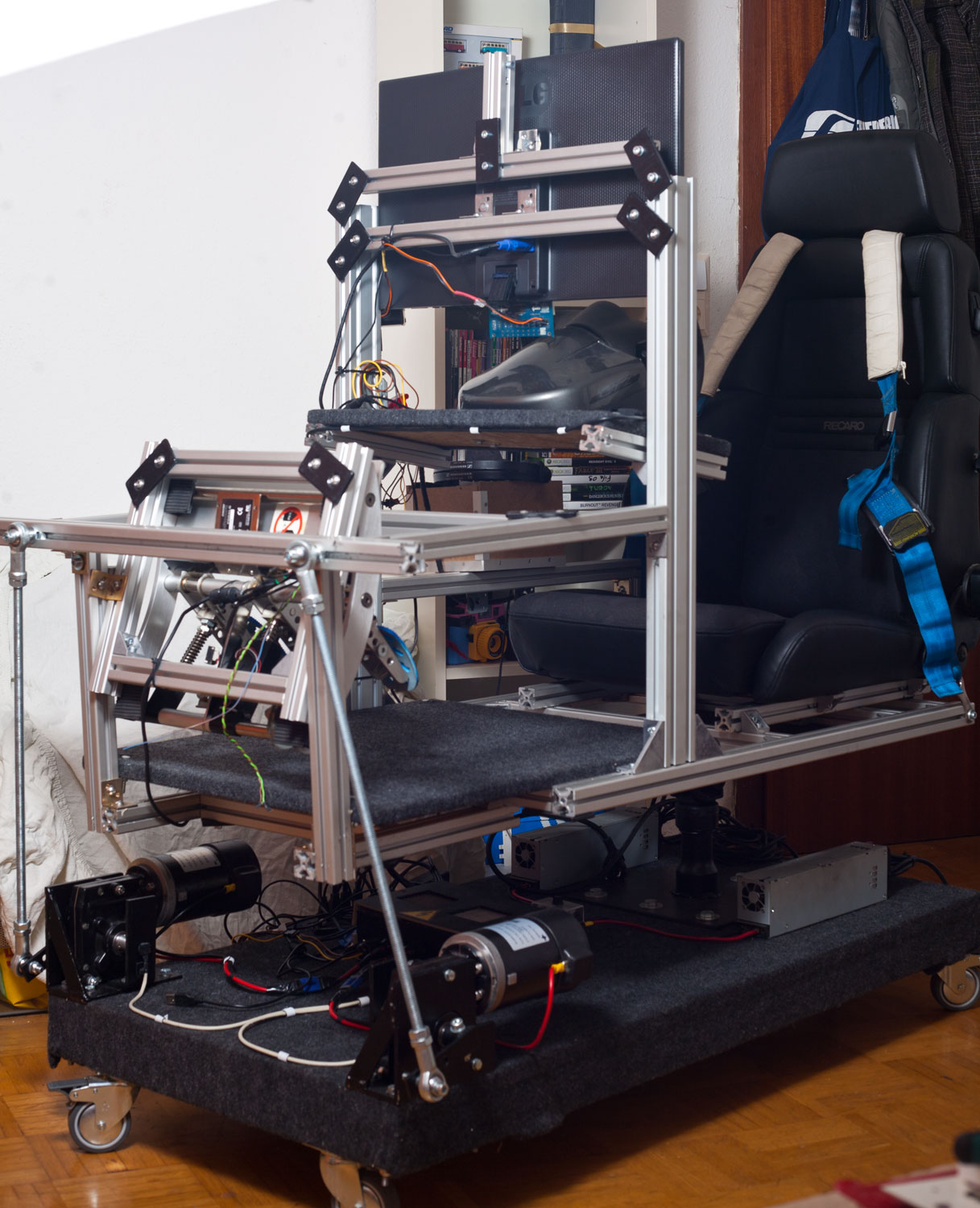

    i had many years a stady rig and some time ago i build my first simulator out of wood. It was a lot of fun at building phase, but it didn't worked very well. NowI thought about building a new one, because I have all of the parts.
    This time I want to make nice so that the result is som fun in gaming too :)

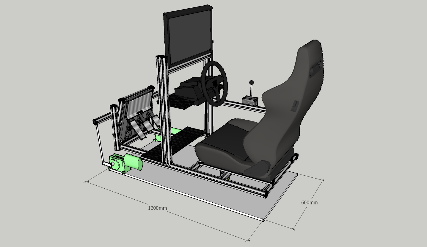

    I decided to make the rig out of aluminium Profile, because i think it's a great system. I never build something with this Material.

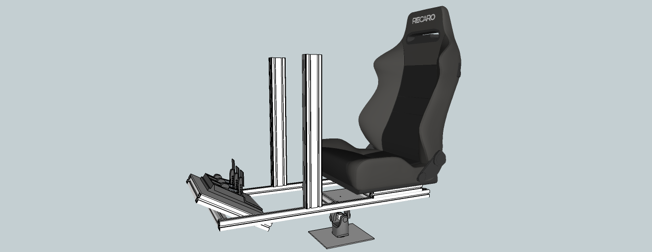

    I've made a simple sketch in setchup to show you what I want to build.

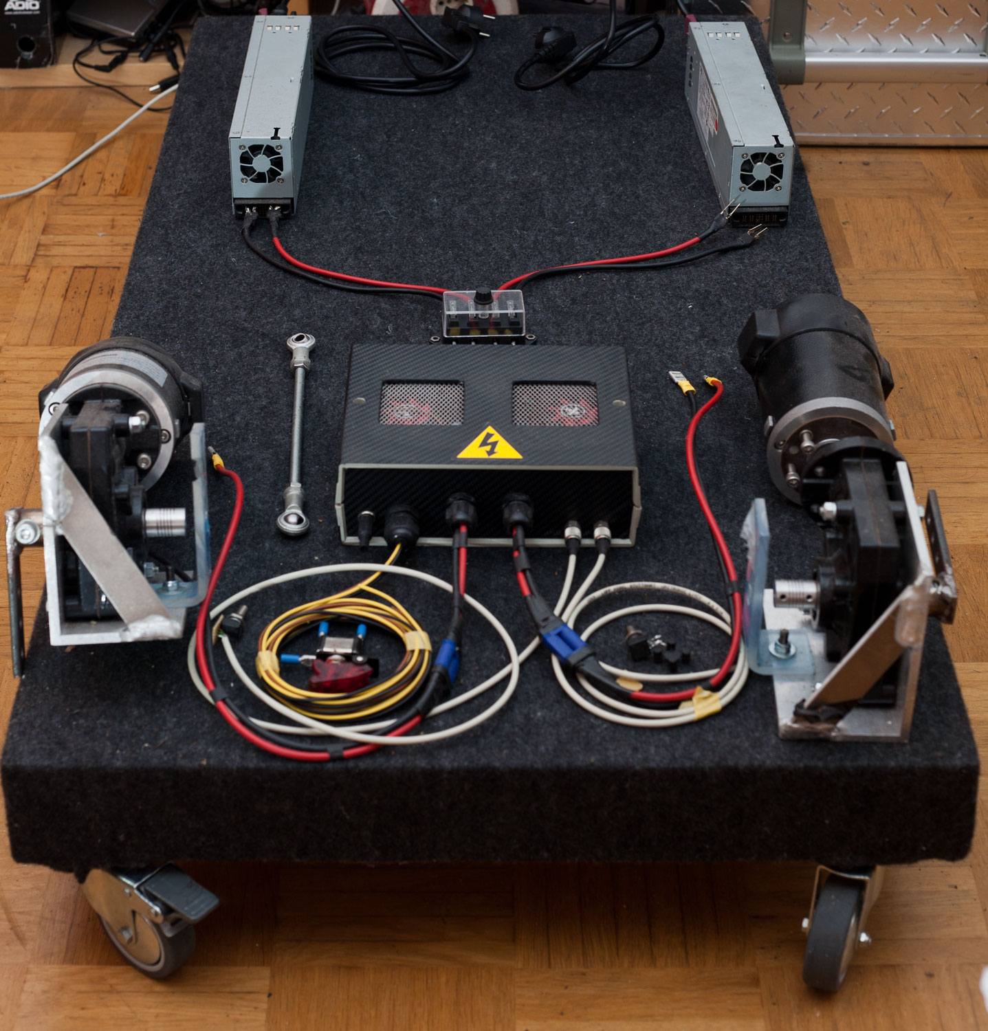

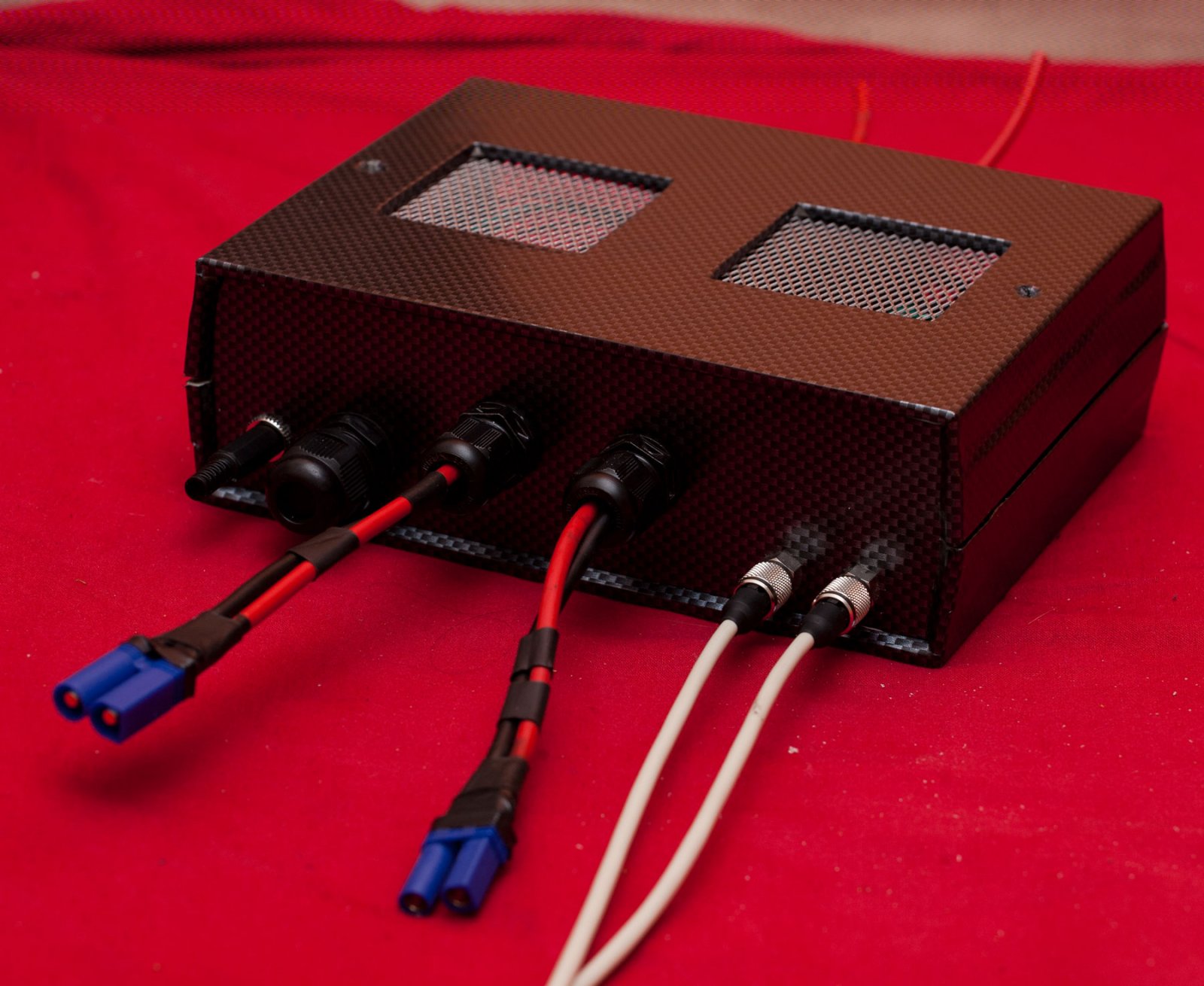

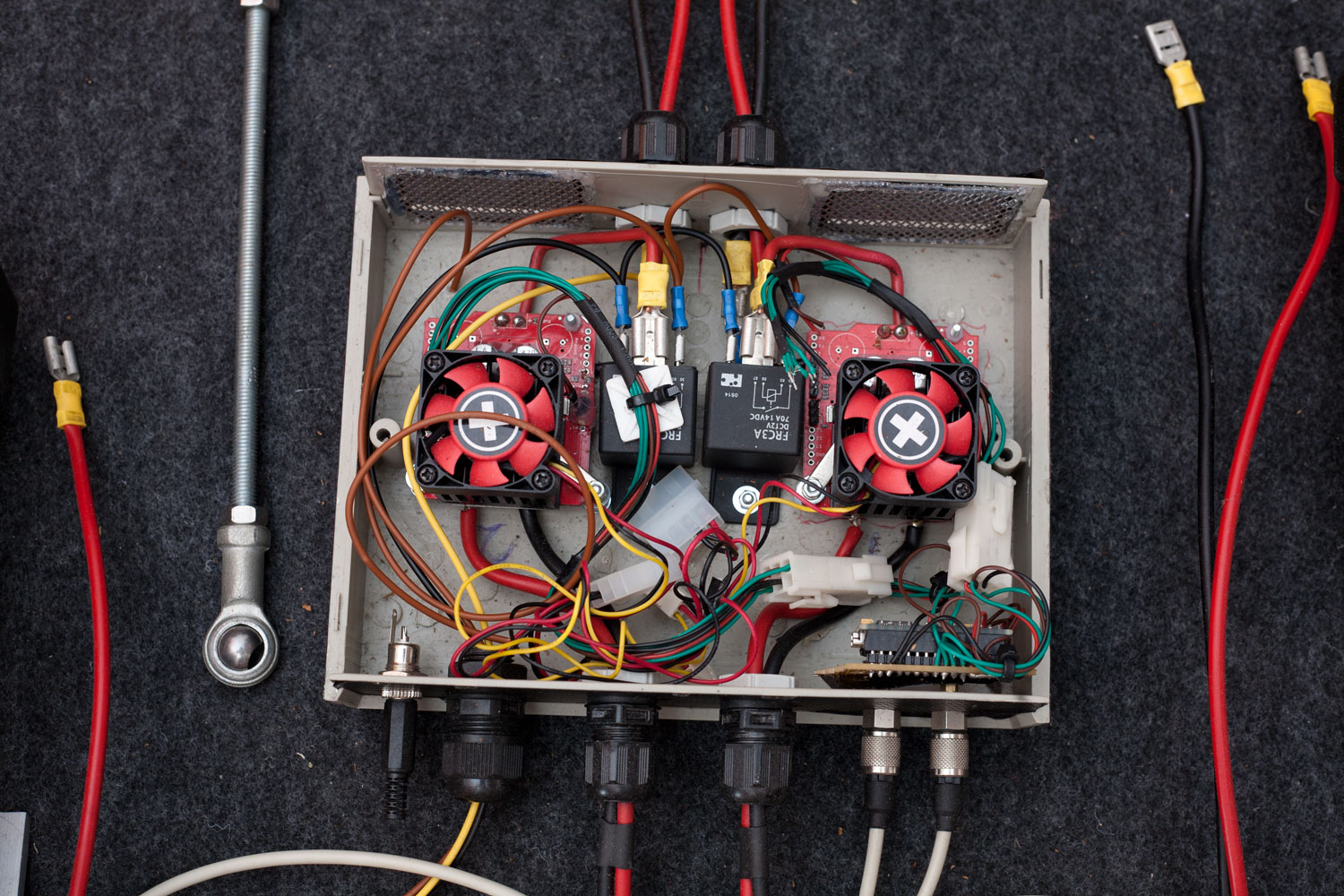

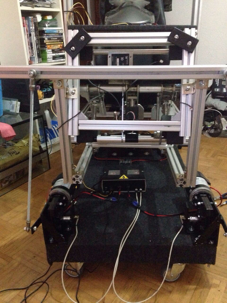

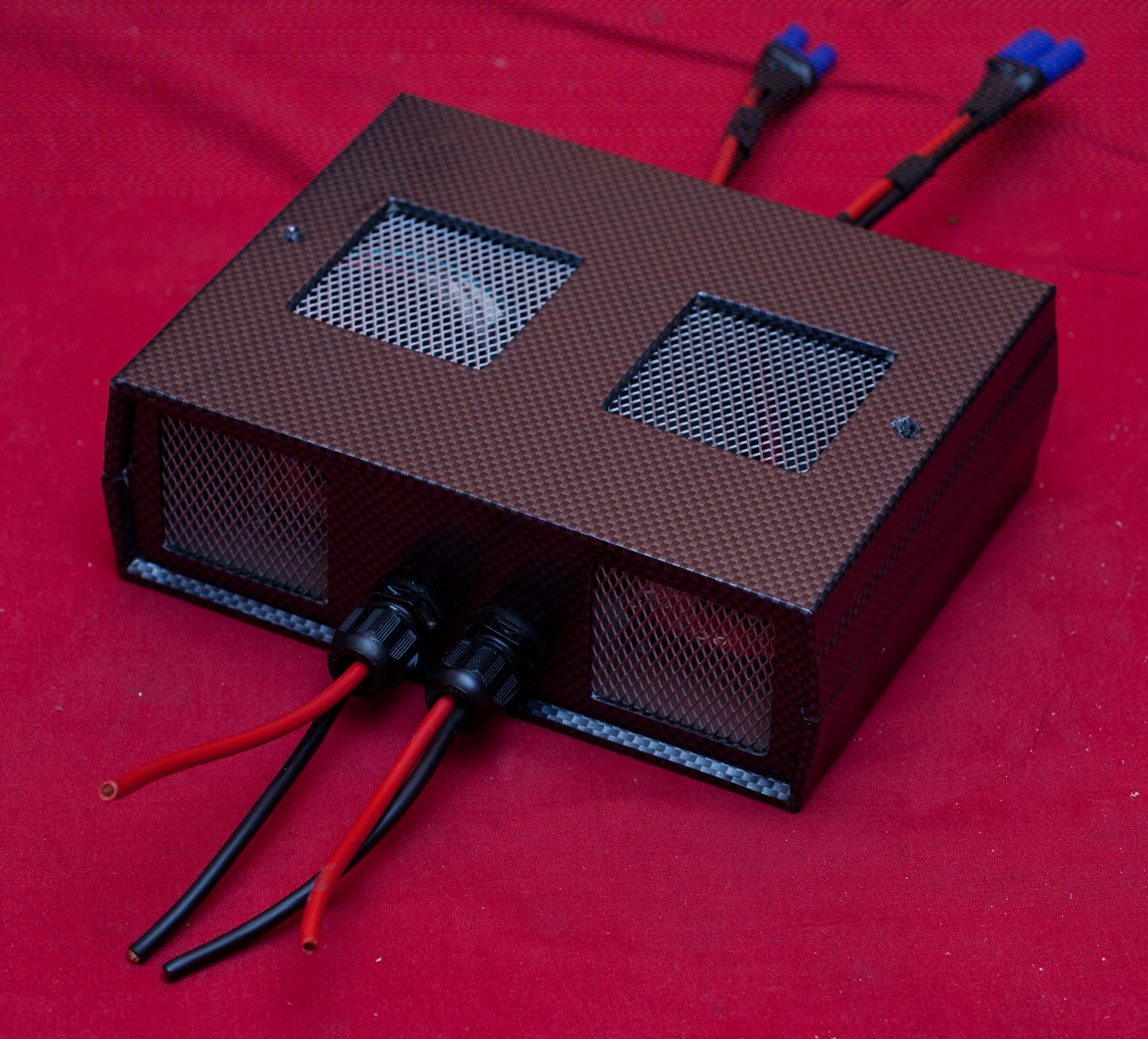

    1. Electronics

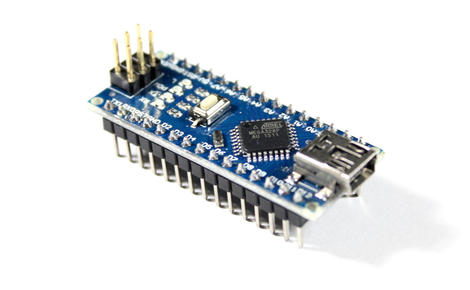

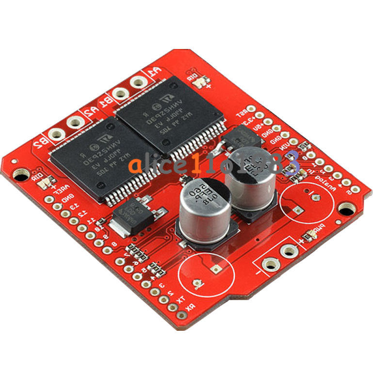

    The Sim is driven by arduino nano and one Monster Moto per Motor. Software I used is Smc.
    The box is designed to quickly plug of the sim to take it to the workbench for service. All parts are exchangable very quick.

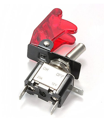

    The Killswitch can be mounted on top of the Platform as Emergency shut down button and also will Provide 12v for other Dashboard applications.

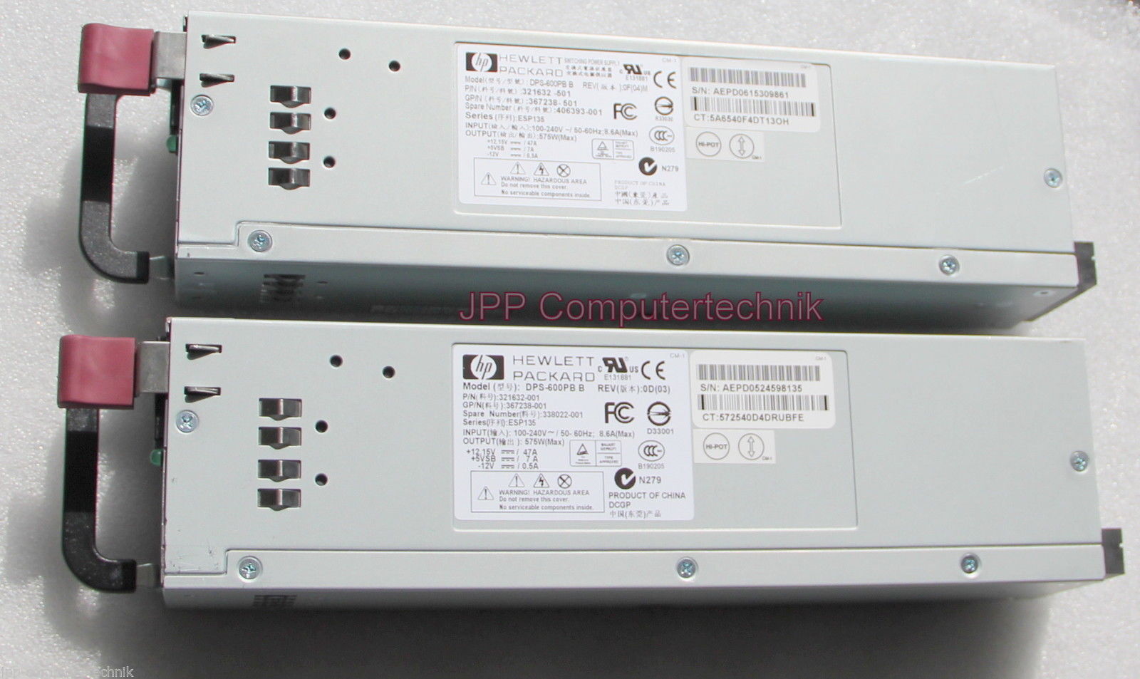

    2x HP DSP 600 PB Powersupply
    http://www.ebay.de/itm/2-Stuck-HP-D...3-001-575-W-/321498985600?hash=item4adad53480
    2x Monster Motor
    http://www.ebay.de/itm/310780916584?_trksid=p2057872.m2749.l2649&ssPageName=STRK:MEBIDX:IT

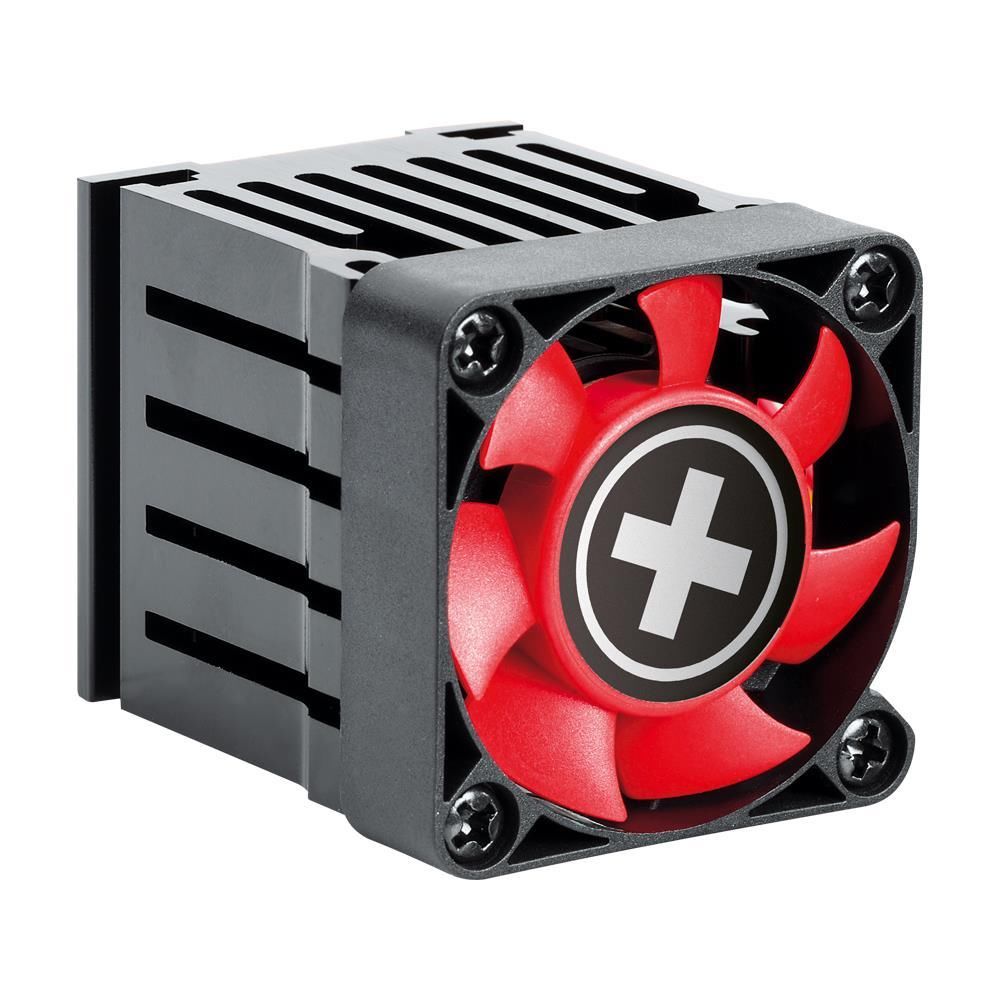

    2x Xsilence Coolers mentioned py Pit
    http://www.ebay.de/itm/Xilence-Nort...sink-Cooler-/121101706990?hash=item1c323966ee

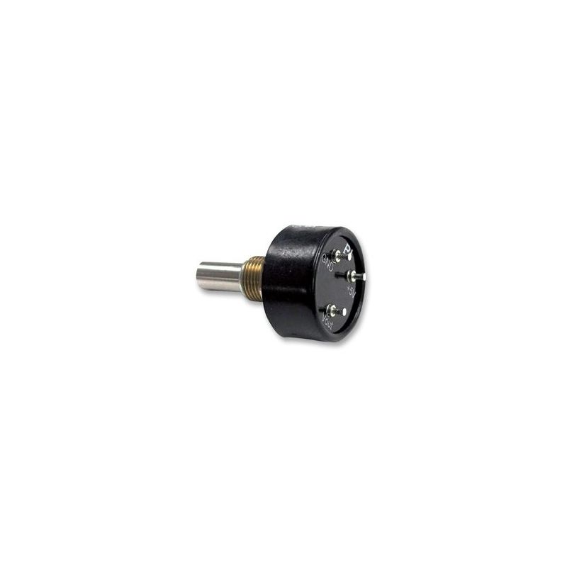

    2xHal effect pot
    https://hbe-shop.de/Art-2319662-HALLSENSOR-02V-20V-BIS-10V-PIN

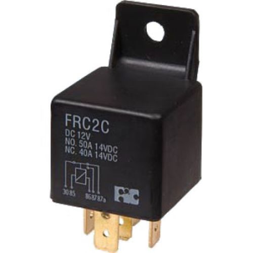

    2x Relays 12v min 30A
    http://www.ebay.de/itm/Hochstromrel...0A-Wechsler-/151617106861?hash=item234d1573ad
    1x Killswitch
    http://www.ebay.de/itm/Kill-Switch-...70?pt=LH_DefaultDomain_77&hash=item5662179ac2
    1x Arduino Nano
    http://www.ebay.de/itm/Arduino-Nano...-RS232-Chip-/331614631556?hash=item4d35c5b684

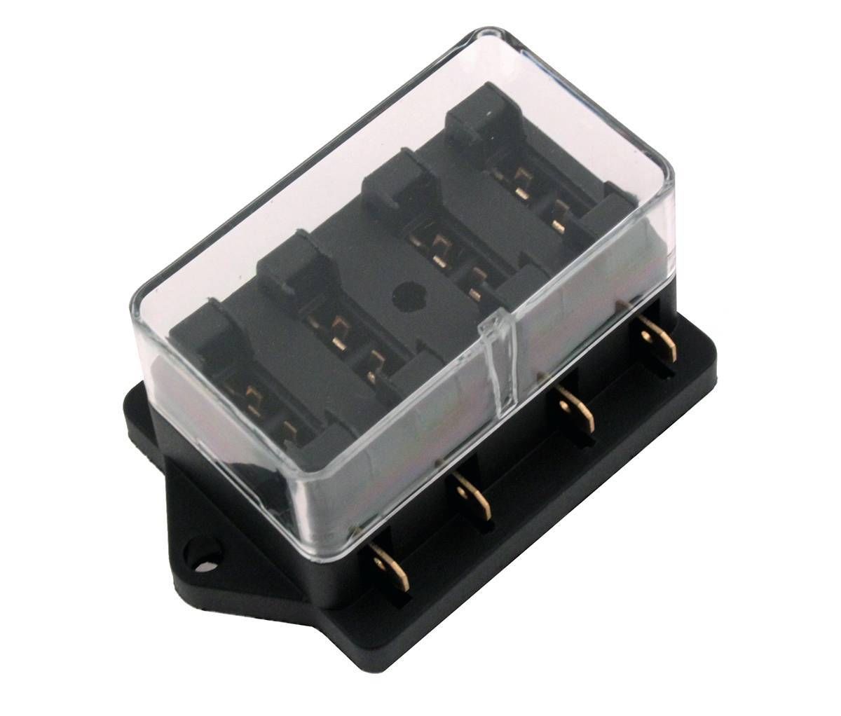

    1x Fusebox
    http://www.ebay.de/itm/4-Fach-Siche...en-Schraubb-/121668761016?hash=item1c5405f5b8

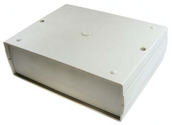

    1x Box to store electronics
    https://www.luedeke-elektronic.de/p...use/Gehaeuse-Kemo-G108-210-x-160-x-66-mm.html

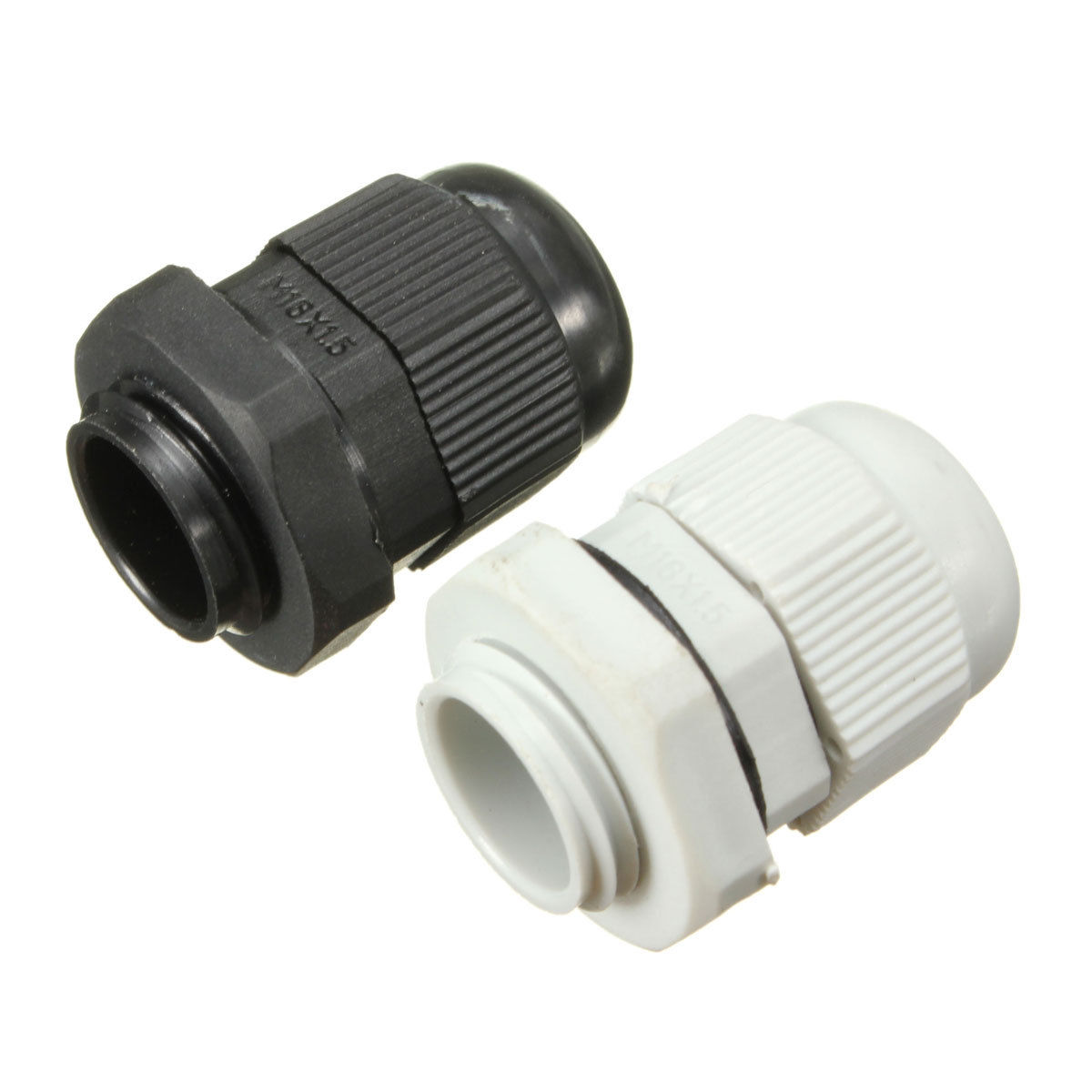

    5x Cable screws (I don't know the word in English)

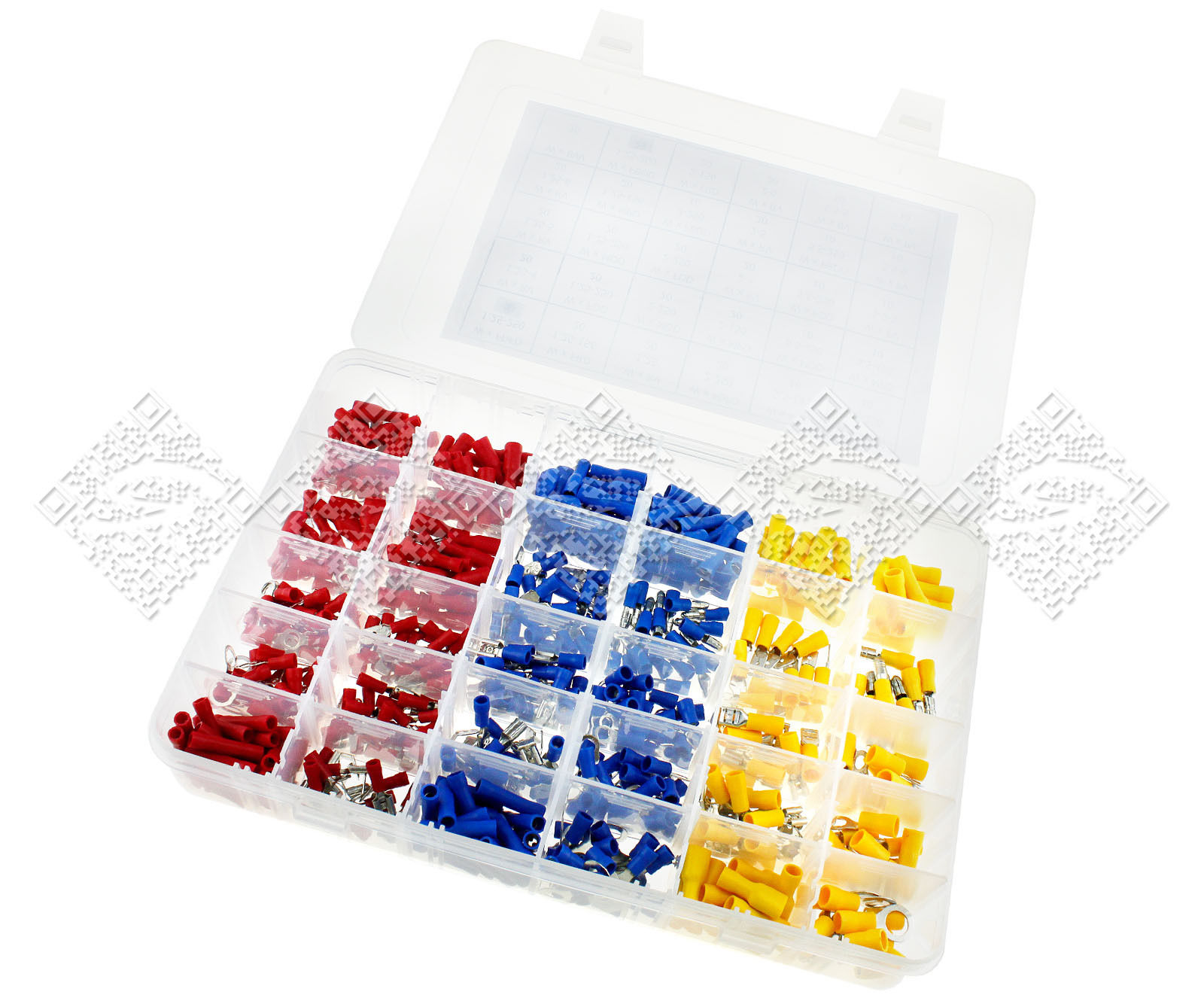

    Some Cable shoes in different Size
    http://www.ebay.de/itm/480er-Kabels...stecker-Set-/171400603599?hash=item27e845a7cf

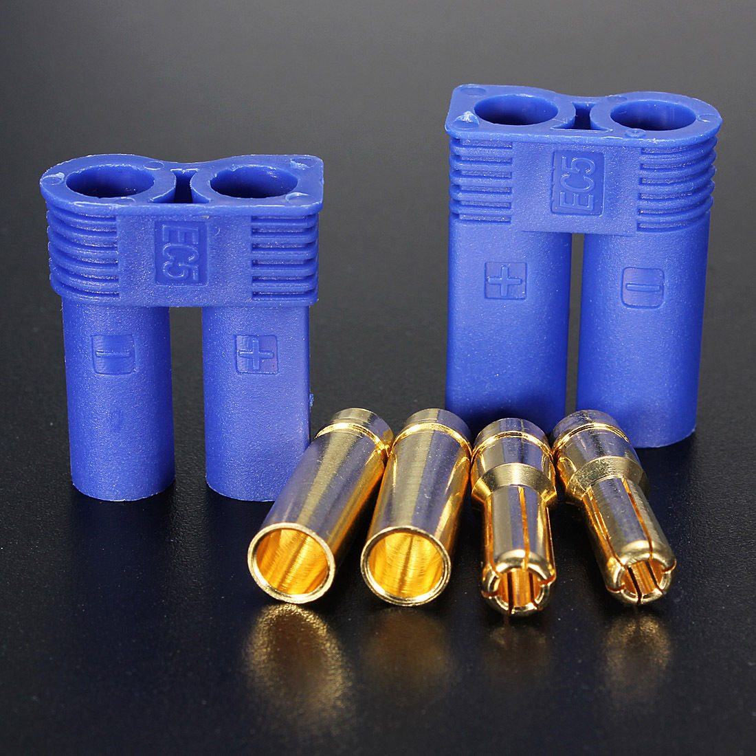

    4x EC5 Connector
    http://www.ebay.de/itm/5-10Paar-EC5...-Plugs-/191611139603?var=&hash=item2c9ce9f613

    Also you need some soldering tools, Shrinktube, Saw to cut the case etc.
    I also used some mtal mesh for the Fan holes and some Carbonfoil to wrap the whole box up.
    Everything is connected like shown in this schematic.
    There are no connection from Arduino to Monster Moto or pots included. This depends on what Method you use your MM. I used mine like descriped very well in the Post from Pit.
    http://www.xsimulator.net/community...cts-as-a-single-motor-driver-more-power.5482/
    The 6 Pole connectors are used for connection between each MM and arduino.
    For more Information about Arduino and Monster Moto take a look in the Faq
    http://www.xsimulator.net/community/faq/motor-driver-for-arduino-compatible-controller.11/category

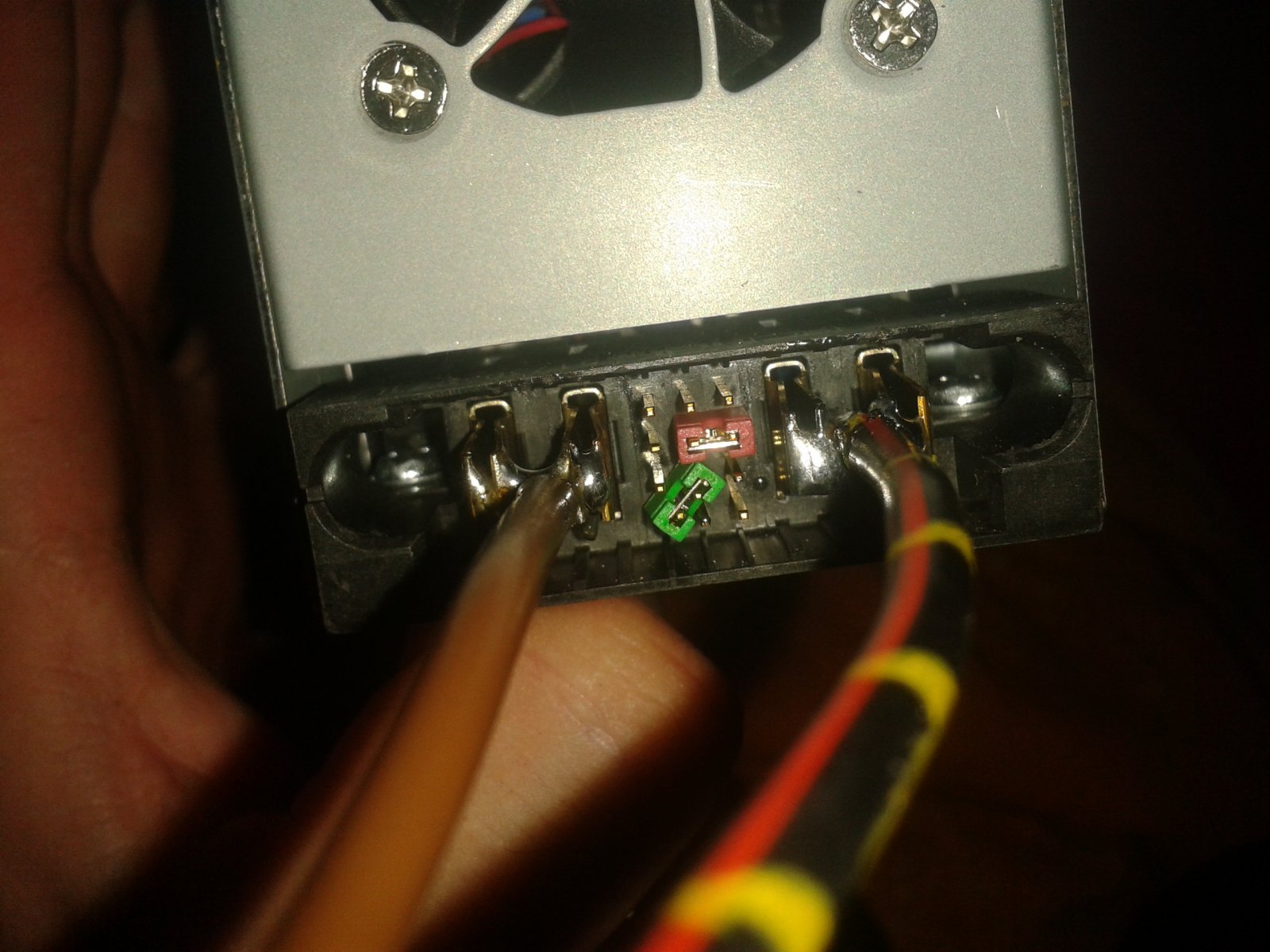

    The Psus are prepared like shown in the Picture. The cables are soldered to the contacts and little jumpers making the connection to bring the psu alive.

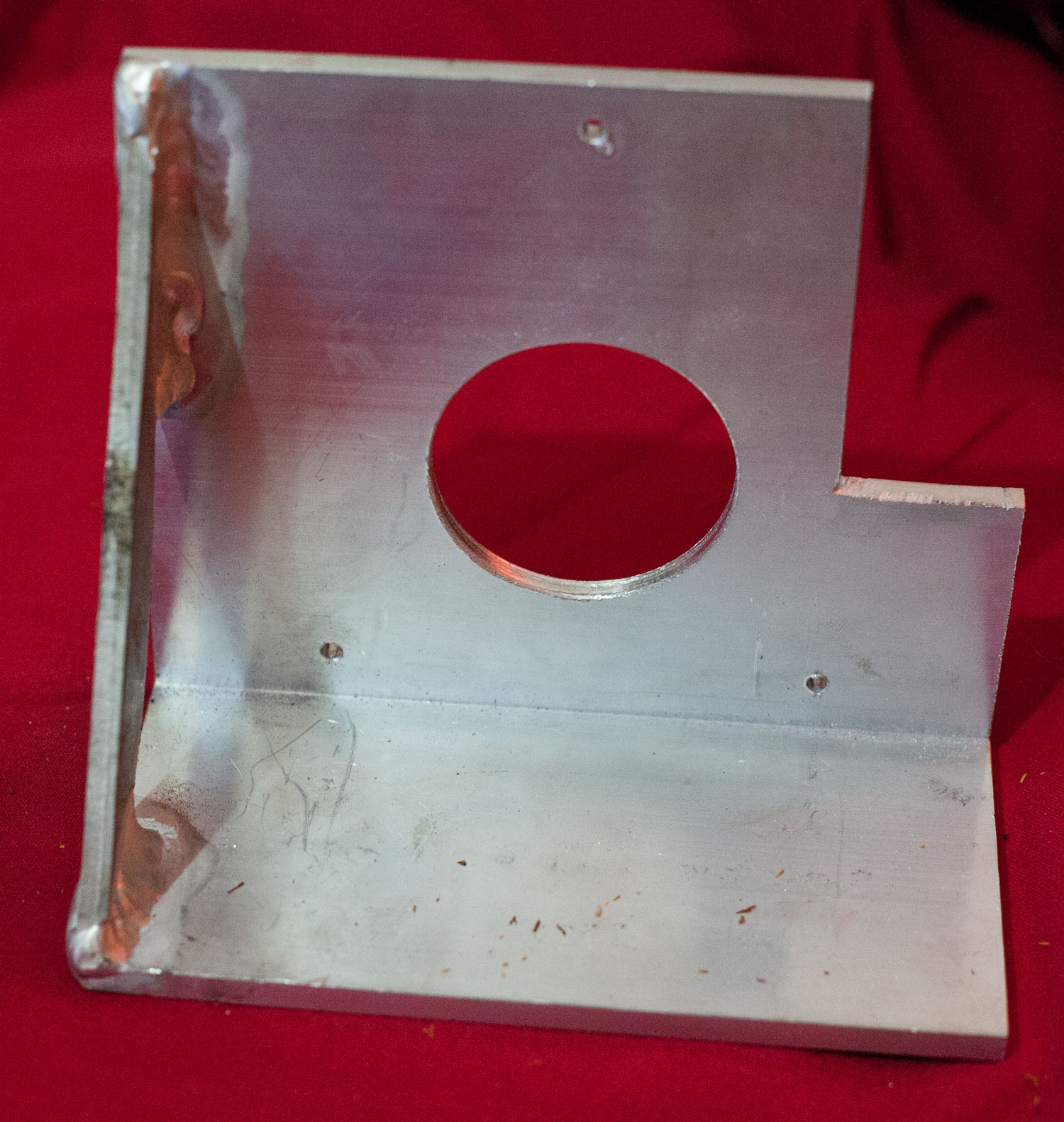

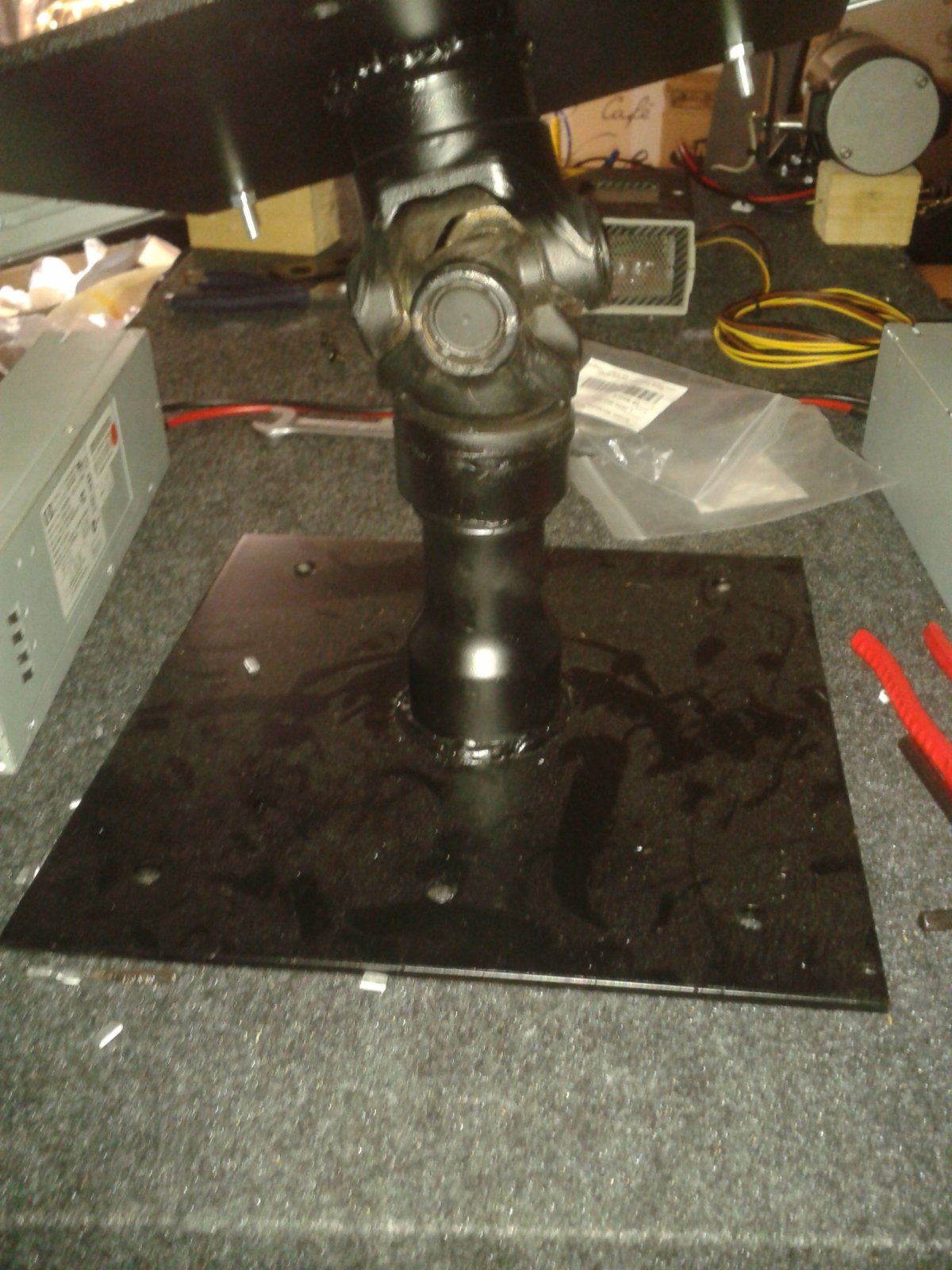

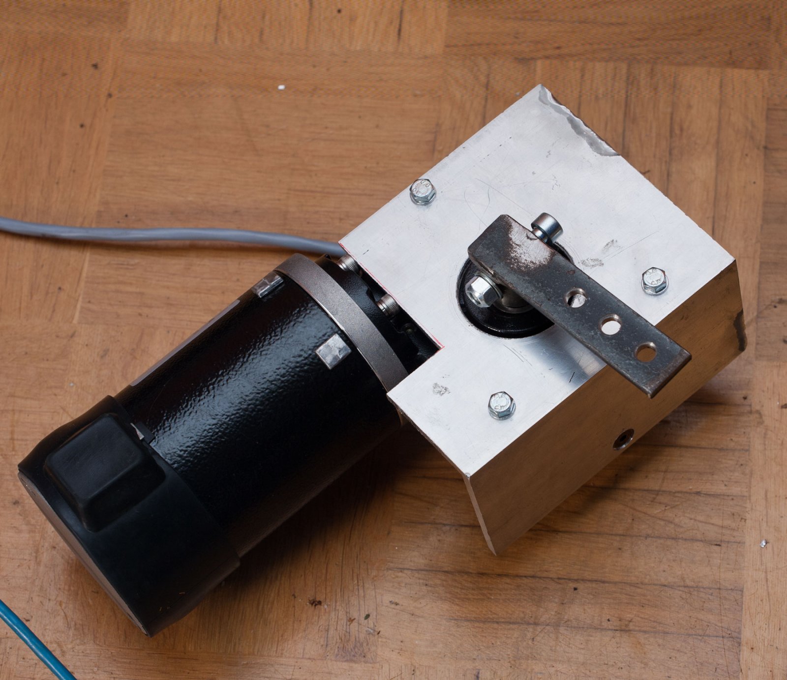

    2. Metal works

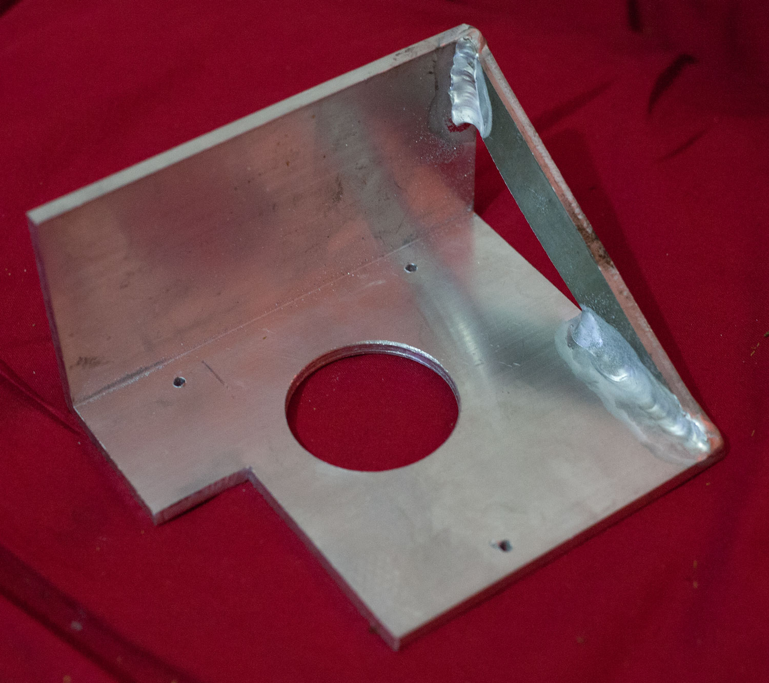

    If made some Motorholders out of Aluminium. There is a lilltle bar welded on one side to prevent the holder from bending. I used 6mm thickness , 100x100mm aluminium profile. The lever is made out of steel and allowing multiple mounting points. The pot holder is made out of 6mm plexiglass bended 90° with a heatgun.
    motorhalterimage.jpg motorhalter.jpg motorhalter2.jpg lever.jpg motorholder3.jpg motorhalter4.jpg motorhalter5.jpg

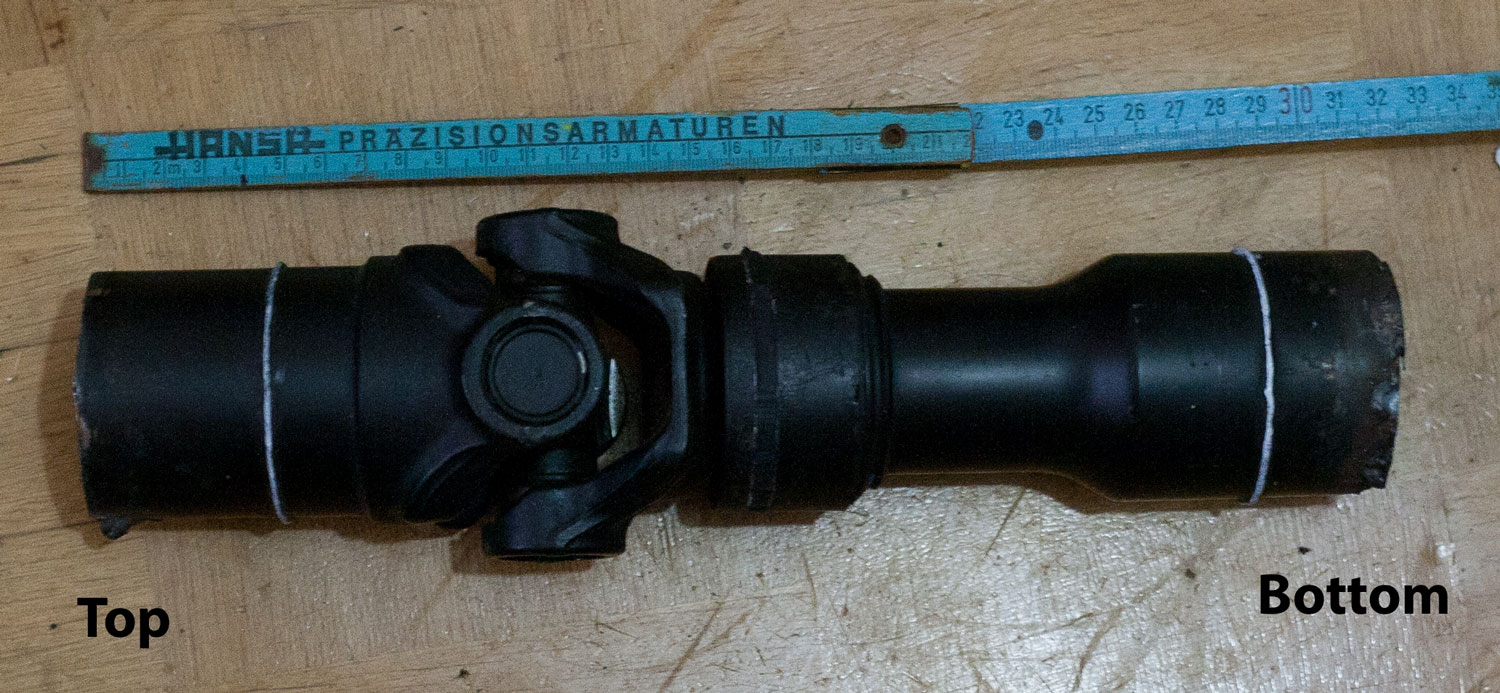

    For the Ujoint I used a cardan joint from a Bmw and welded some steel plates on.

    Overall design is not bad at all mate.
    Centre pivot you will find may need to move backwards towards the seat, I would make that section adjustable, profile allow you to do this too.
    Motors in current position will have to be fairly strong , wipers wont cope for long.
    You CG is very high from the centre of the pivot too, I would advise lifting the centre of the pivot to as close to the base of the chair as possible or even equal or higher than the base of the top, this means less work for your motors, meaning better movements once in motion.
    Sorry to seem picky but a nice start.
    P.S there should be some pics on here on several profile rigs, if I remember I will post back.

    thanks for your reply.
    Take a note that this is a basic scetch. I didn't look carefully at point of Gravity. I'll make this adjjustable later to find the right point.
    Also the u joint is an example where to place.
    By CG you mean center Gravity? sorry but i don't know. I now have a ujoint out of a ne Bmw f10 cardan unit I made both ends in equal length. But i take your advice and cut the upper section that will be mountet to the seatbase. So like in picture the joint is 180 rotated. thn the lower part will be longer.
    I'll try to get some motors but it's harrd to find some for a moderate Price in Germany. I contactet Telfel here from the forum because he sells 2 motors that would be right i think http://www.xsimulator.net/community/threads/motion-rig-hardware-for-sale.6057/
    or would this ones be better http://www.ebay.de/itm/380956910371?_trksid=p2060778.m1438.l2649&ssPageName=STRK:MEBIDX:IT
    If someone knows a good Motor source in Germany let me know.
    For the design, i want to make it very stable. But for me it looks very heavy in the front section and i have a small room. So something looking lighter would be better :p

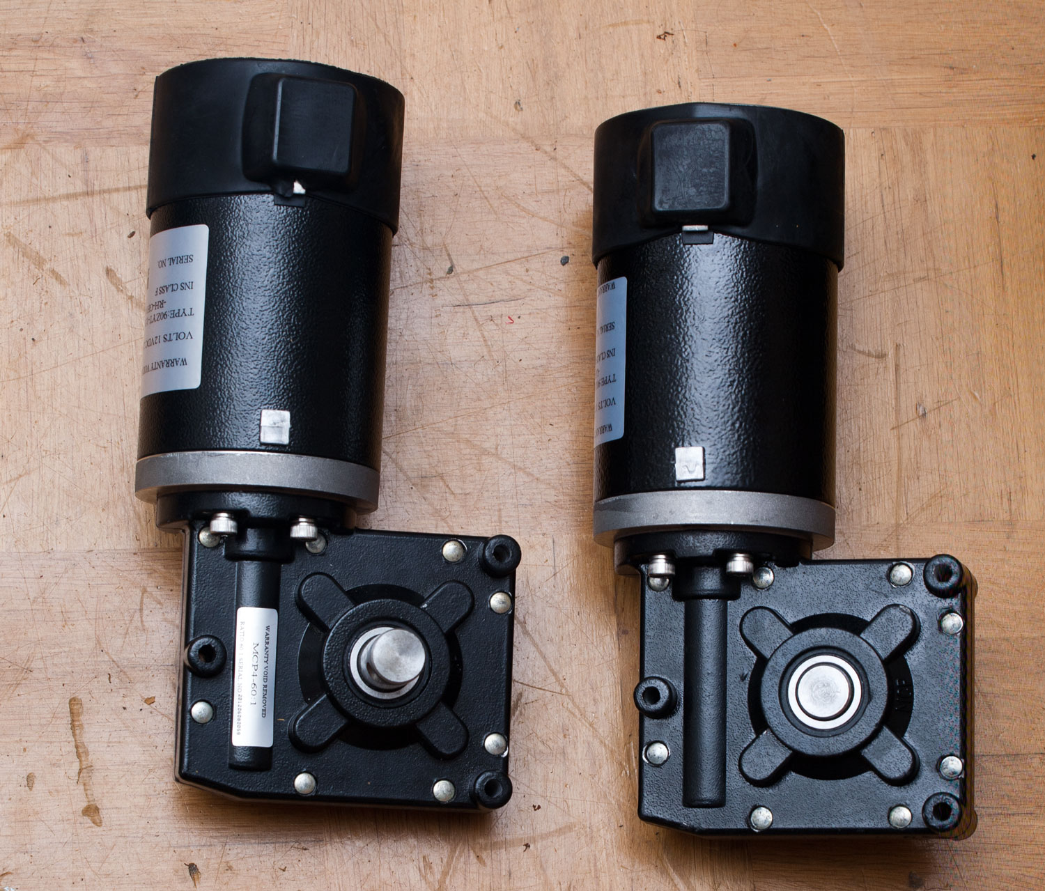

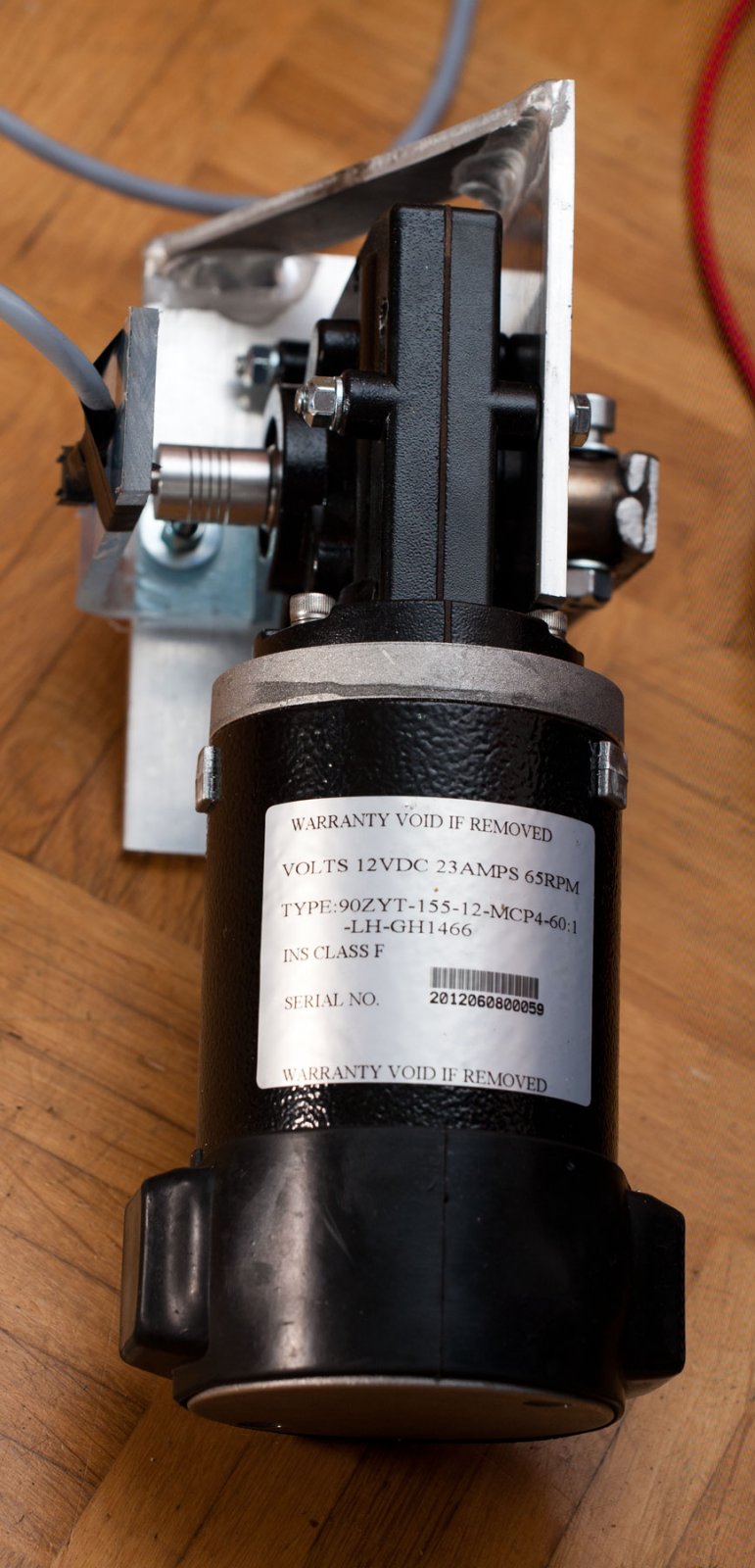

    After no one was replying for the other motors i bought the 60:1 90zyt at Motion Control Products. The arrived today.
    I wasn't able to test them with controller, because my Monster Moto arent arrived. I hope one per Motor will be enough.

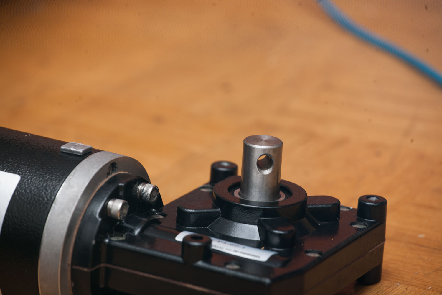

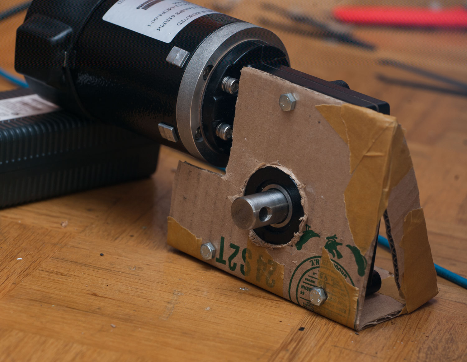

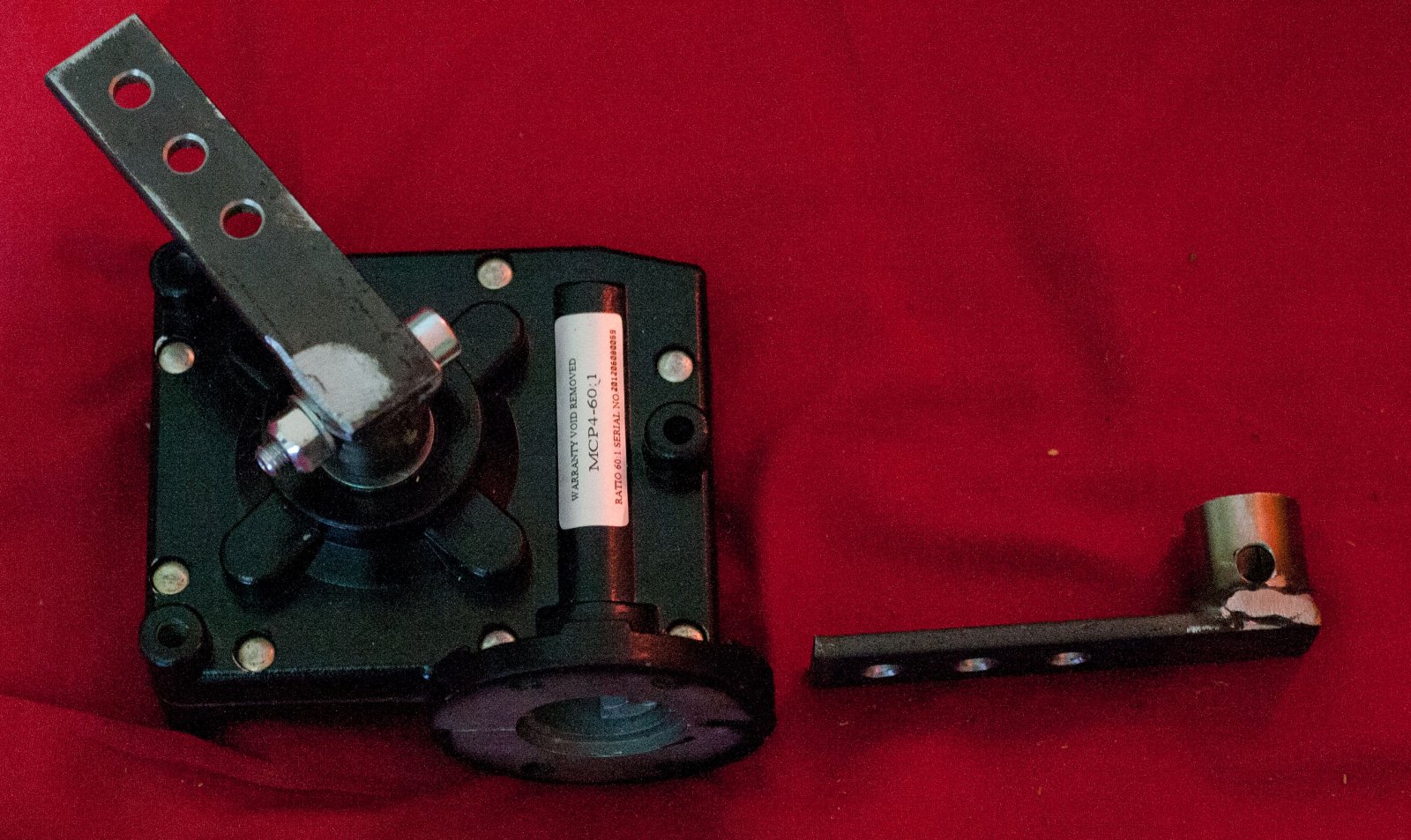

    Als after having Motos in my hand i've seen trouble in mounting pots and Leaver, because i don't want do drill wholes or something to void warranty.
    I thought about a tube going over the shaft with a welded leaver on It. The whole is 8mm so i decide to screw the tube with m8 screws. I hope thiss will be stable enoigh.
    I also changed my rig design.
    It's a common rig uses by many people.

    so for the lever a steel tube or square tubin that fits the outer diameter of that shaft with a bolt through both should do you fine, weld the actual lever on the end. Would be cleaner to drill a hole on the other side for you POT shaft mount bout you could put it oin the other side of your lever arm.
    sucks that they dont have a hollow shaft on the end through. I would prob drill and tap. Did you make sure that would void the warranty? And if it does, is it just on the gear box and no the motor? The gear box is the lesser of the expense if that helps. Havent heard a lot of stories of the 90zyt going bad though.

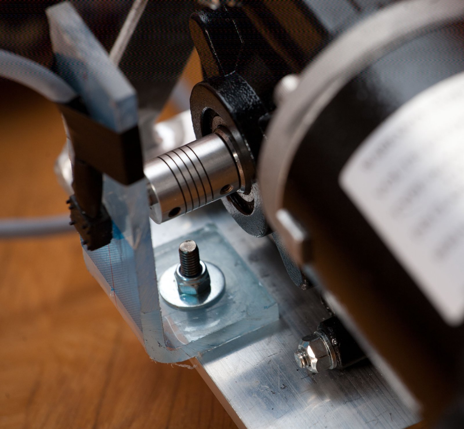

    Thanks for the Link. For the potmounting i thought about something like you did. It looks very nice. And also Thans for the detailed Information and Pictures of Potmounting. I think i'll di it like you but will use some Flexcouplings to protect my Potentiometers.

    I thought a little about the motor brakets.
    Here is my final design.
    I will make this out of aluminium Profile with 130mmX80mm with 6mm width.
    http://www.ebay.de/itm/141309789006?var=440429649031
    In the back the Motors will be holded by some clamps. They have 90mm diameter. The will be also screwed to the base to make the motor more stable.

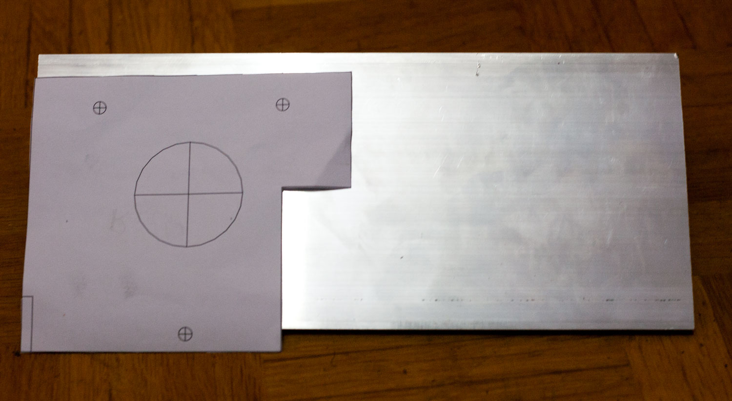

    @Ville Pesonen
    i made some sketchup files to print out, to put it on top the metal for exact drilling wholes. The measurements are very acurate. You said you'll be using the same motors as me. Let me know if you are interested, then i will upload them.

    Tombo The Motor's Do NOT need to be supported by anything other than the gearbox itself. Completely not needed.

    @Nick Moxely
    Thanks for that information. But since these Clamps are very cheap and easy to install i think i'll do it anyway to reduce the force on the 3 M6 bolts.
    Today while searching for some coolers for my Monstermotos i find some nice one at ebay
    http://www.ebay.de/itm/Kuhlkorper-A.../311028291360?pt=Bauteile&hash=item486abb1720
    This one should be fitting perfect.
    I know it's better to use 2 coolers for each chip because theay are not plan. But all coolers i can find in such a small measurement are really low in hight.
  19. Nick Moxley
    17,055Coins
    +2,505 / 30 / -2
    For what its worth, I hang my 2 motor's off 2 1/4" bolts as seen in the pic, so 3 bolts is plenty
  20. Ville Pesonen
    Ville Pesonen Active Member
    Jan 13, 2015
    136
    842Coins
    +200 / 0 / -0
    that would be much appreciated. My motors are on their way and this way I can probably get something done until I get them.
