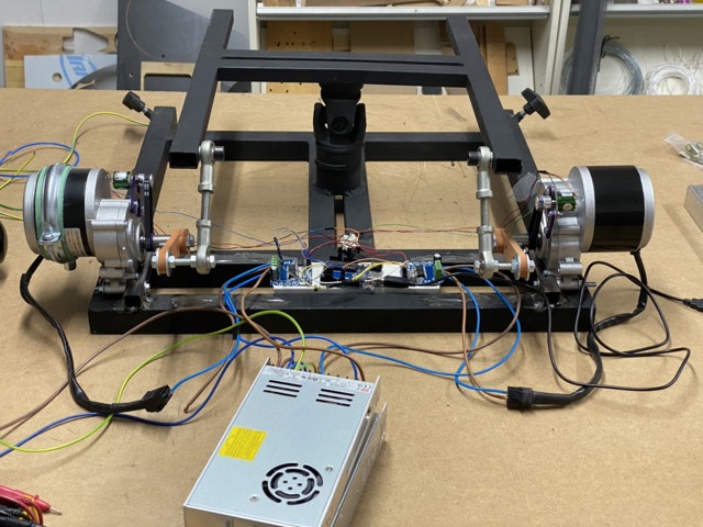

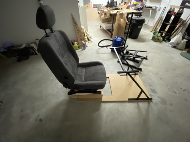

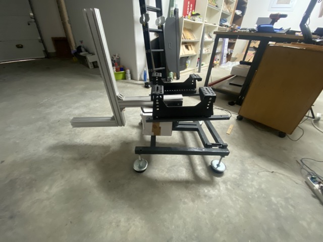

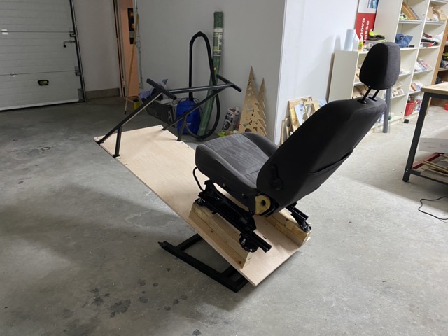

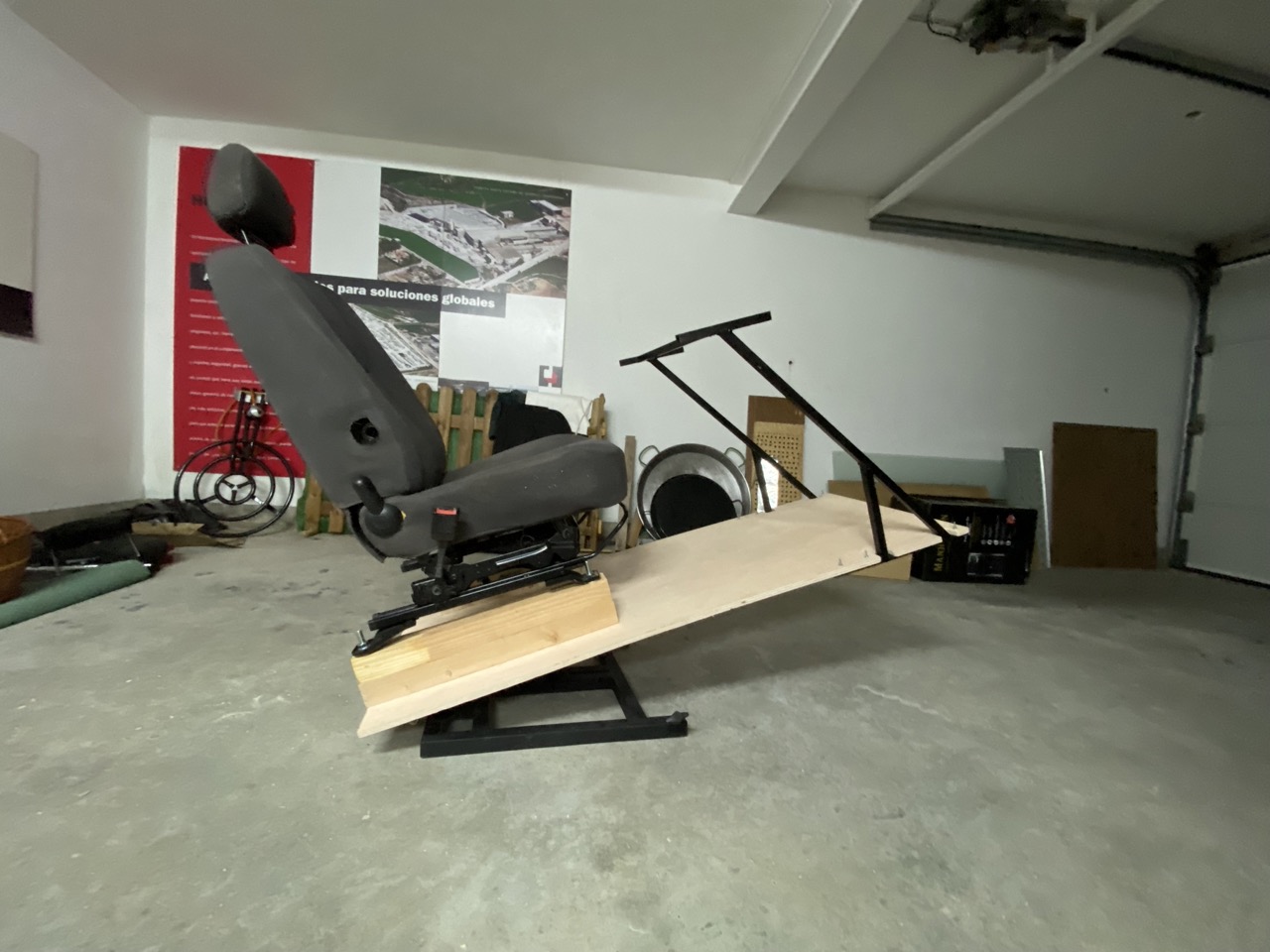

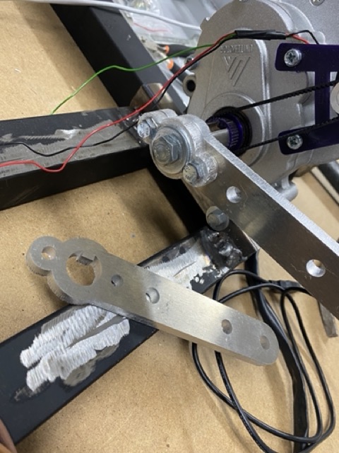

    I builded the 600x600mm base with other partner but he abandoned this project after a while. The first intention was build a 2DOF for sim racing but after he gone I started to be a flight simer and I restart this build keeping in mind use it for flight simulator. The first problem was that that base was designed for move only the chair and I wanted to move all the structure so the first solution was elevate the structure to a point where the pedals don’t touch the floor when the structure moves forward. First error. The wheight was very far from the pivot point and the force were too much for the motors and electronics due to the lever effect. Furthermore the playwood that I used as structure floor was too flexible and when I push or pull the yoke the playwood blents.

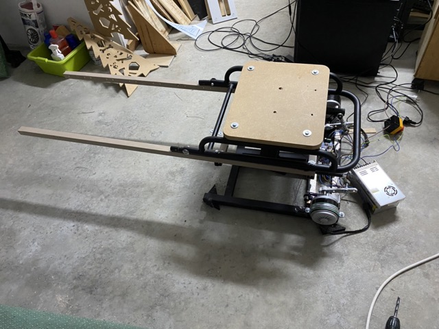

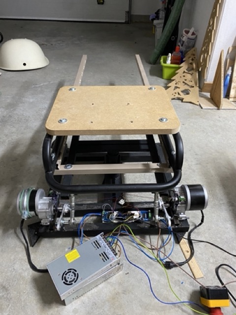

    The first tests was with a MDF levers and LFS demo.

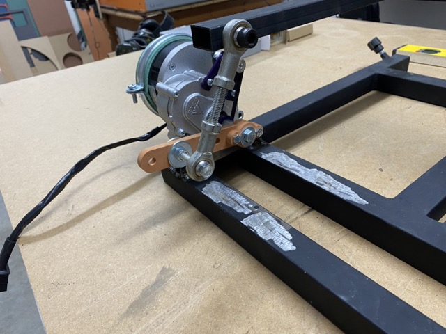

    Finally the iron levers arrive:
    And some tests was done:

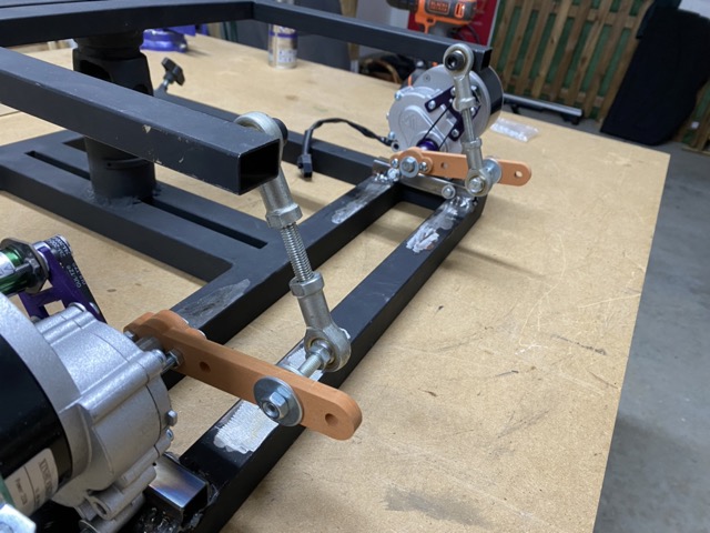

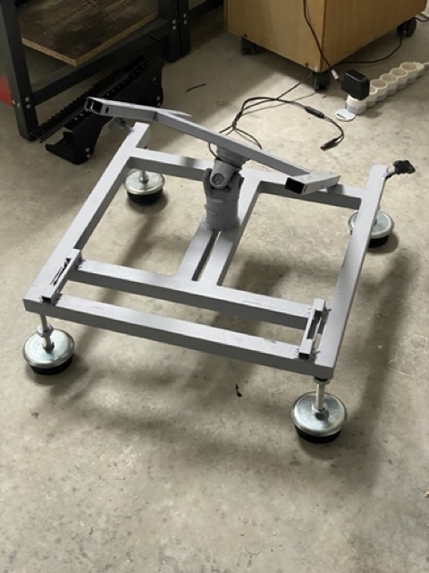

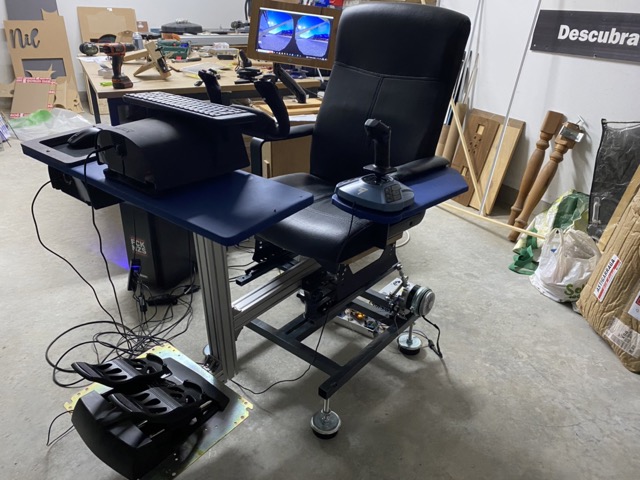

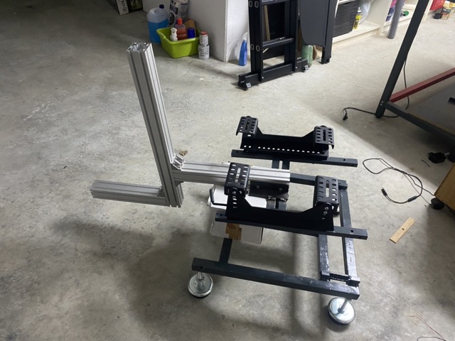

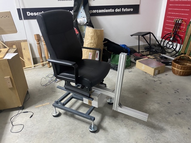

    Finally I stop trying to do it by the cheapest way and spent some money to make a "well thinked alluminium structure". I changed the motor levers and soldered four legs to the base to raise it up and install the chair colser to the pivot point and the result was a very strong and balanced structure. Also I trashed the car seat (that was very very heavy) and install a office chair with a backet base. After some paint work the structure looks more professional.

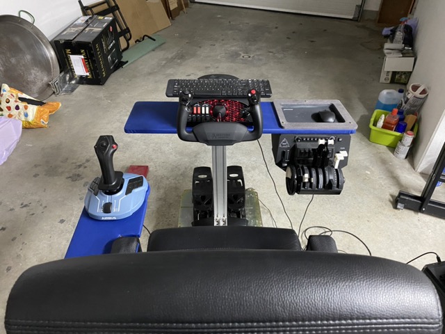

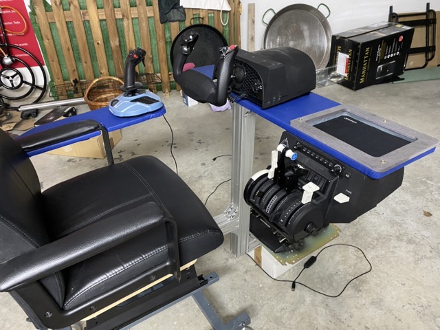

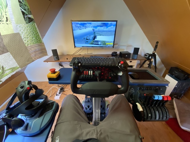

    At this point I started to think how to attach the Honeycomb Alpha and Bravo, the Thustmaster Sidestick and the pedals. The pedals was the easyest part to solve but I wanted a small desk to put on there the yoke and in the downside the throttle levers. For the Sidestick i designed a piece of playwood and then i attached it to the left armrest of the chair. Both the desk and the playwood was lined with blue leatherette.
    When the whole build was mostly finished I was anxious to do the first tests and well, that was absolutely incredible, what a experience! After some tests I noticed that the chair was not well balanced and i did some adjustments to balance it.

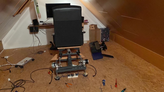

    After the build and tests I needed to disassemble all and transport it to the attic/garret where it would be placed to.

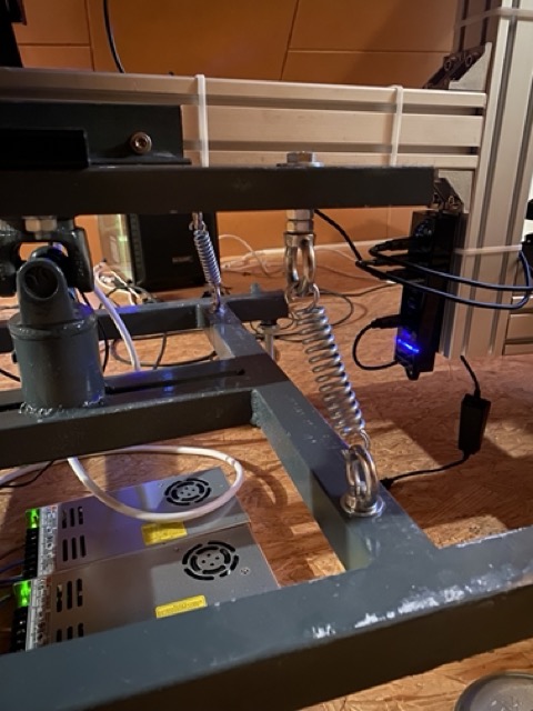

    Then i already noticed the digusting feel of the backlash and I solved it installing two tracktion sprincs in the frontside of the base.

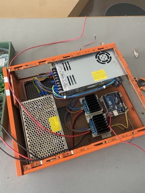

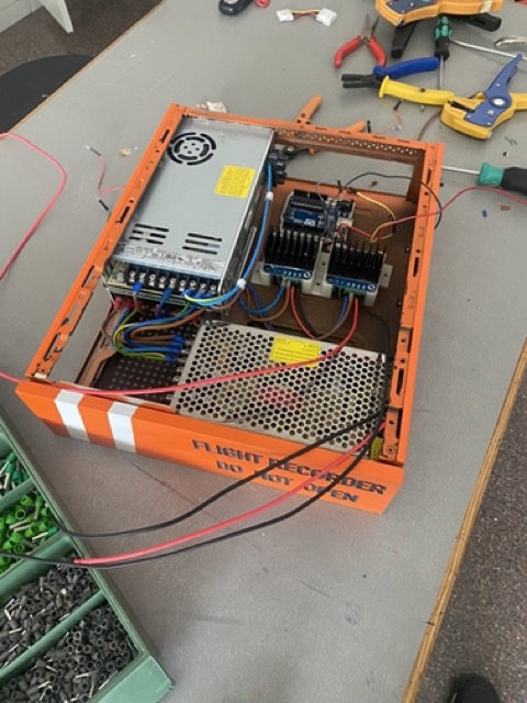

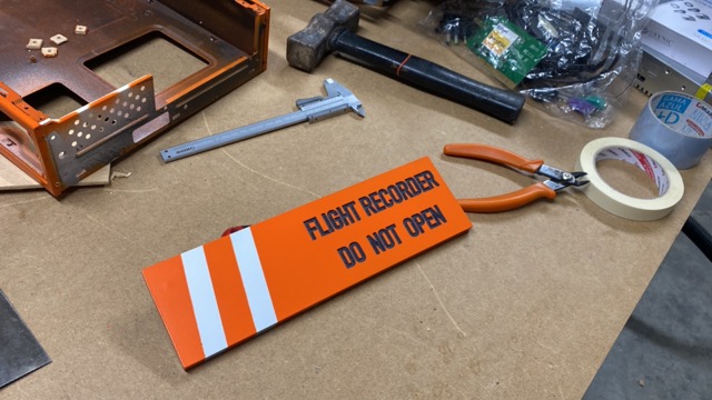

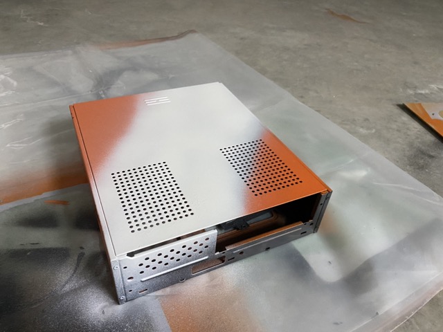

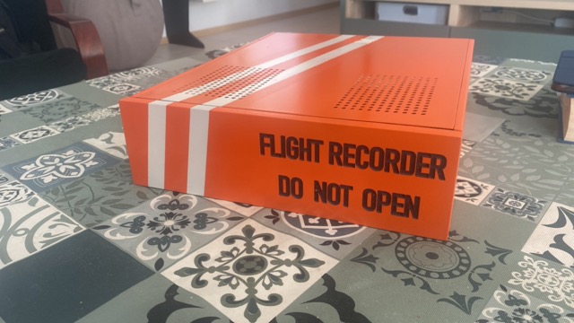

    With some woodwork skills I also made a fake-blackbox to put in the electronics
    IMG_1659 2 a mida mitjana.jpeg IMG_1660 2 a mida mitjana.jpeg E175016C-B879-4C81-BB5B-9F27F728DCD7 2 a mida mitjana.jpeg 8A849D21-D499-40BD-B0E6-46C6DE4305BD 2 a mida mitjana.jpeg IMG_1815 a mida mitjana.jpeg IMG_1816 a mida mitjana.jpeg
    And finally after the final test and adjustments with FlyPT mover I got it.
