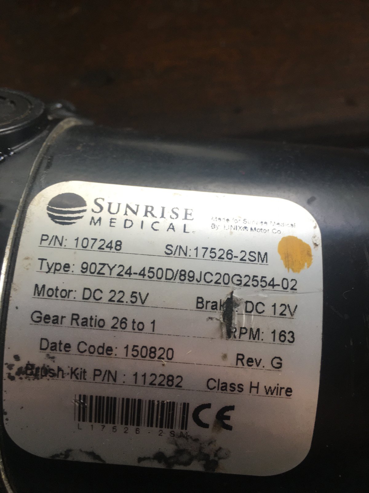

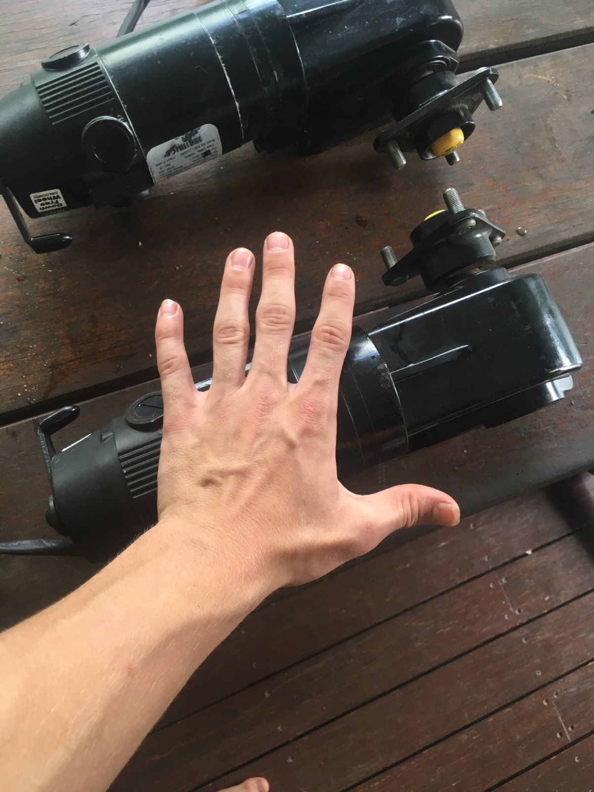

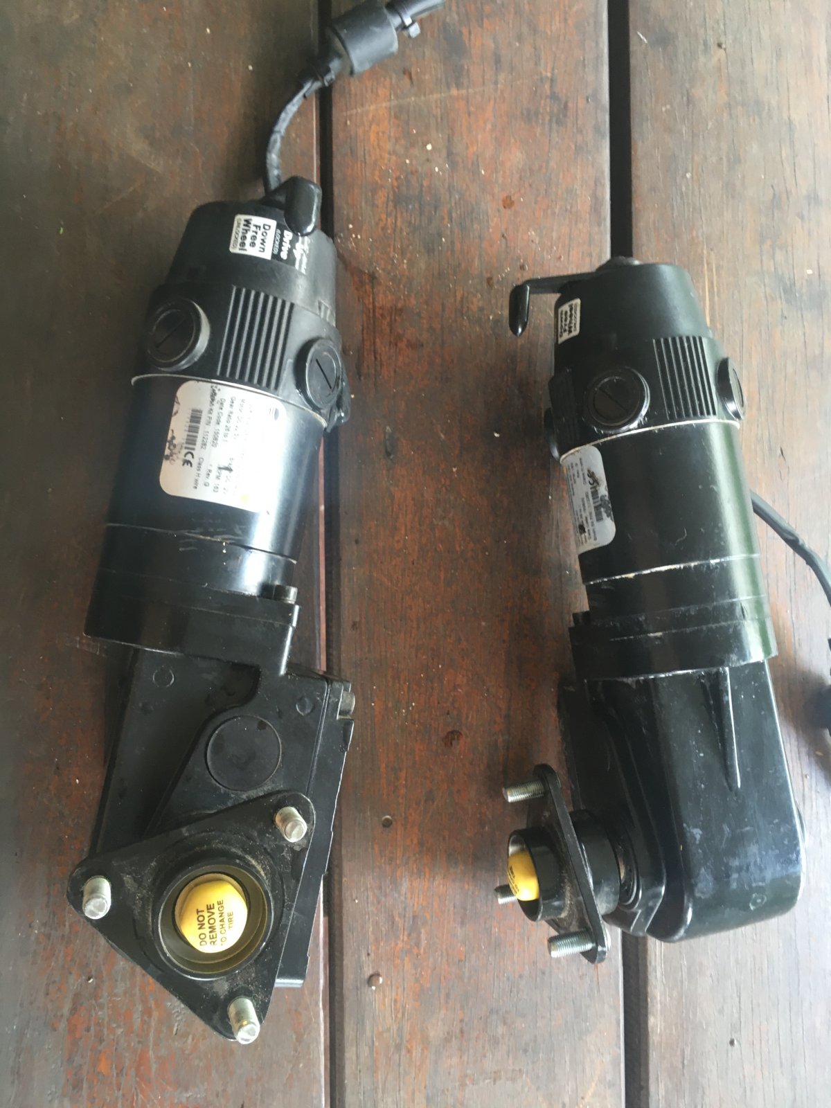

    im using all of the normal parts that dmax used exept for different motors and potentiometers mine are 10 k and the moters are wheelchair motors

    At the end of those videos he kinda says the motors don’t have enough power. Can you post a picture of the label? It should at lease have a wattage on there that is related to the power. Also, the RPM since higher RPM implies lower torque.
    It is also possible to measure the torque with a luggage scale of a fish scale.
