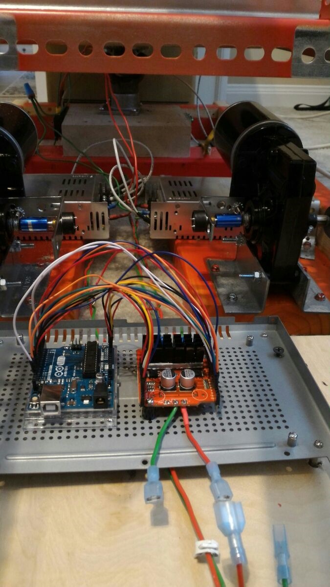

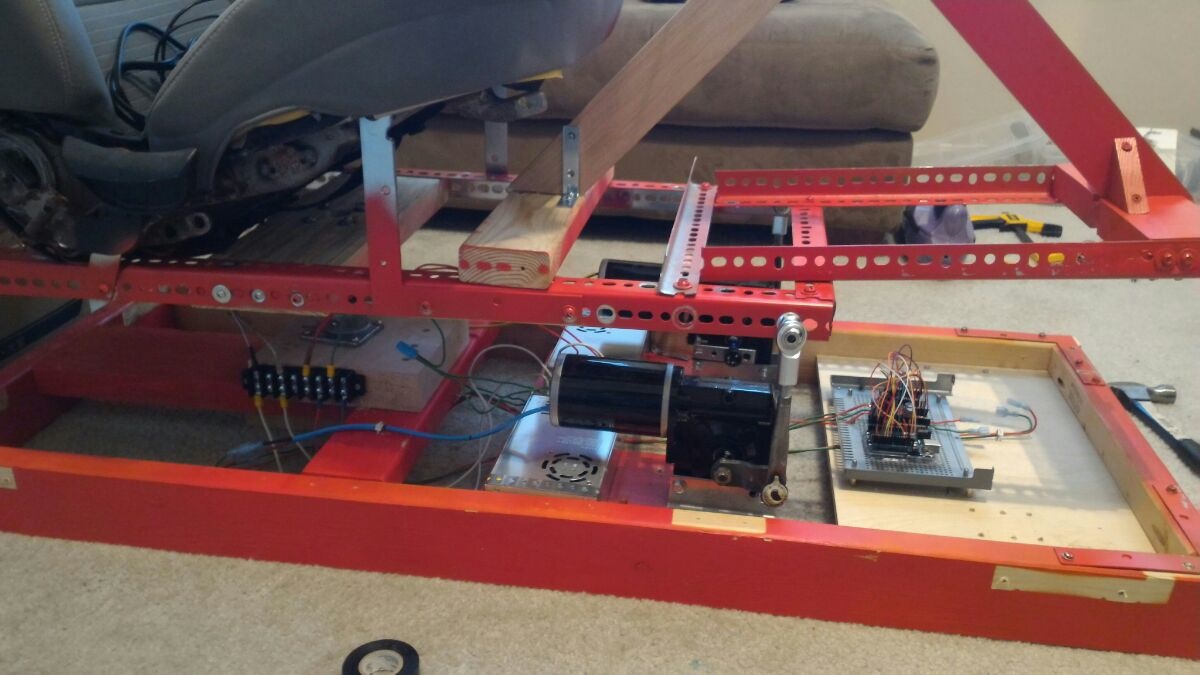

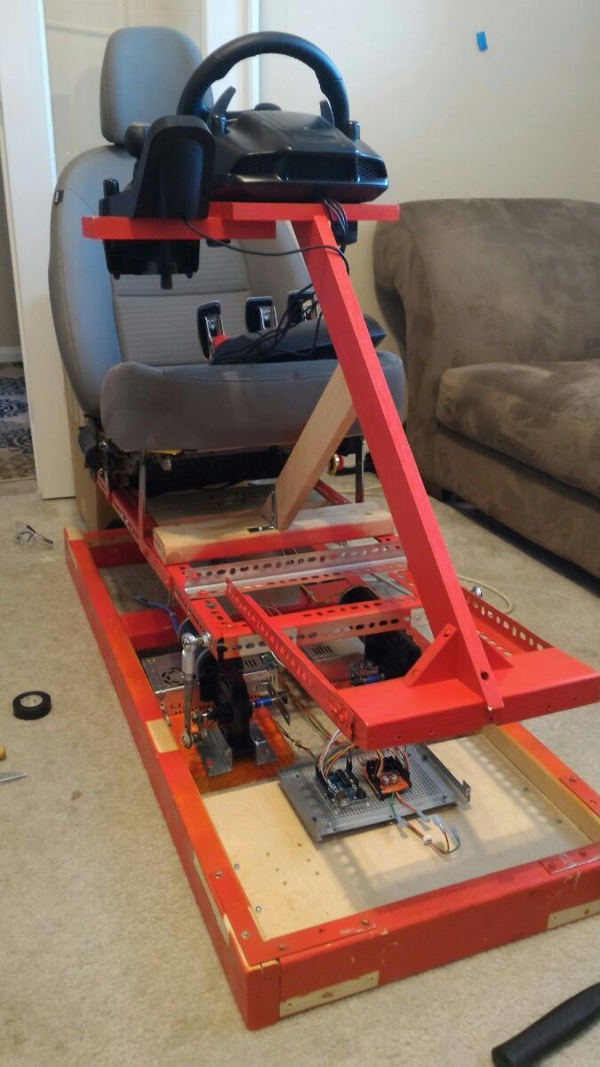

    After 4 months finding and making parts, finally I finish my first 2 DOF racing simulator. Right now I atesting each motion and fine tune simtools setting.

    At first my racing seat always stuck on right side so I thought I set over the power limit. After changing the setting( limit 70 to 50), I still got the same result. It seems not a rotation angle problem. I guessed there was low power output from right side. However I do not have a current meter to check if the current output is correct, I just changed a spare mm shield on my system. Then it worked well. ( my mm shields are all china clone boards) The quality is really not good.

    BTW you may check the ball joint which is very sluggish. Furthermore you could still tune your SimTools settings, I determine a lack of sway and heave.

    I knew the the ball joint issue but still thinking how to fix it.

    What motors are you using? They look like the ones from MotionDynamics (12V / 200W) with the 25:1 gear box and hollow axis. Is this correct?

    Should be similar. I bought them from pgsaw Canada on ebay, because my location is US. The ratio that I choose is 50:1.
    speed is 50-60 rpm.
