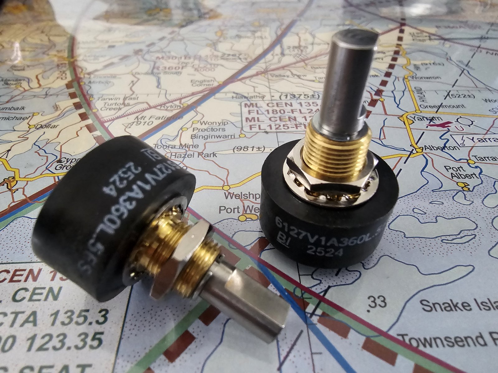

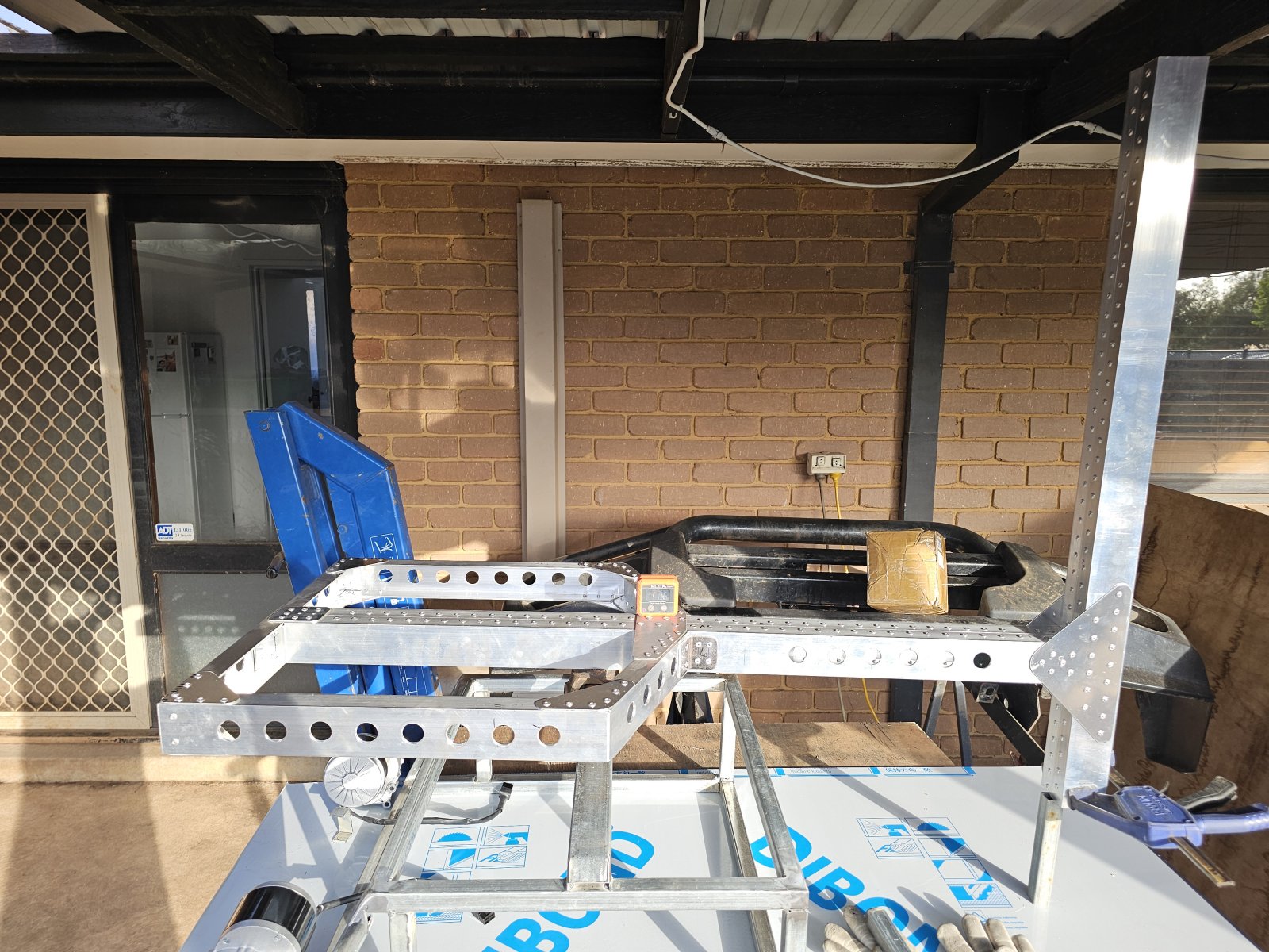

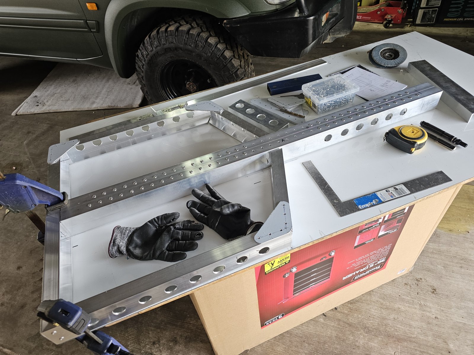

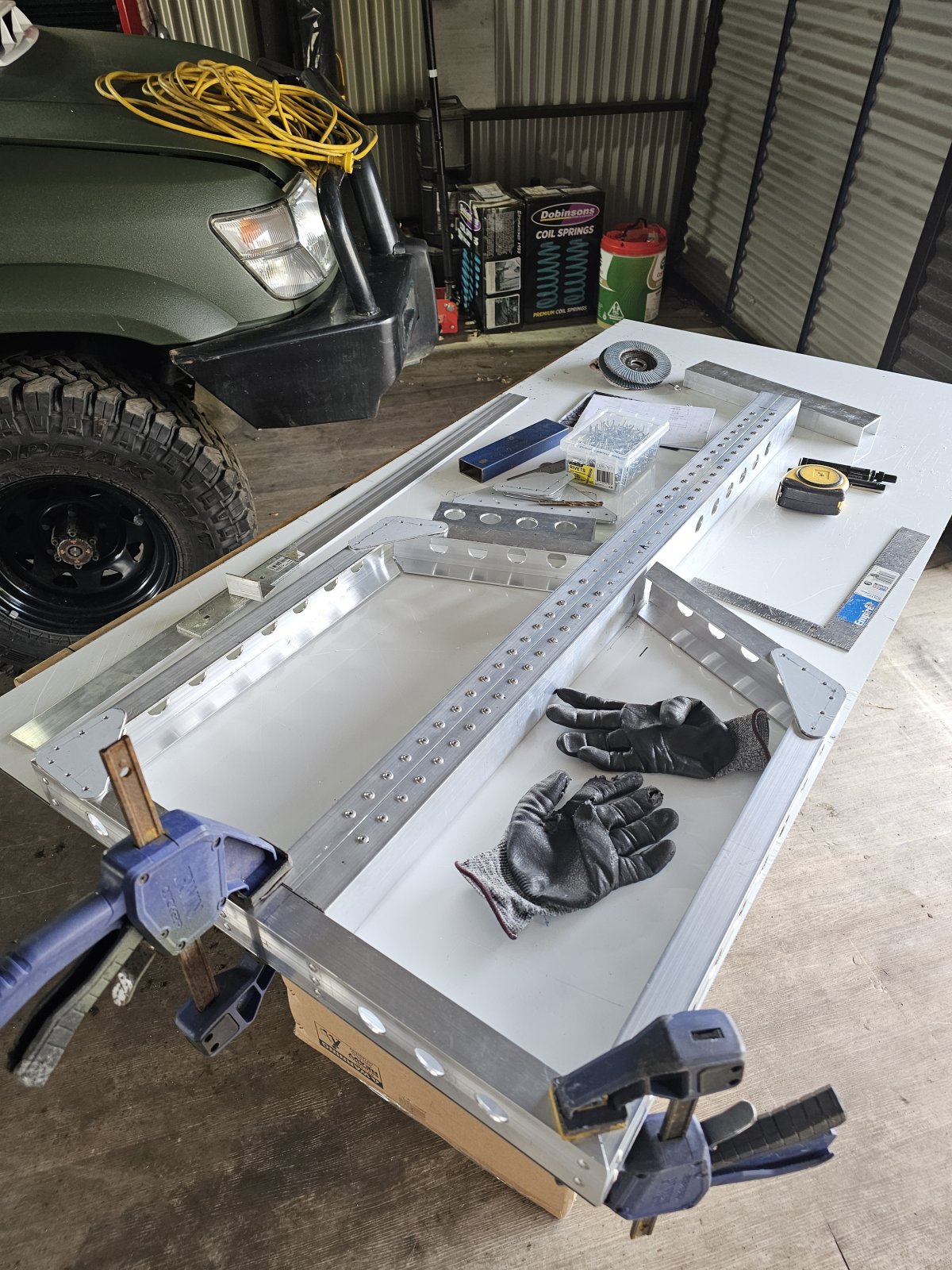

    Hi guys, i have been reading on heaps of build threads, some very impressive builds out there for sure.
    I have finally commenced my very own motion sim build, it will be primarily VR but also with a 42" tv screen for long airliner flights.
    Being in aviation industry myself, it was fitting to use aluminium for construction.
    Heres my part list so far :
    Motors : 250W 24V wheelchair (TBC)
    Hall Sensors : 6127V1A360L.5FS

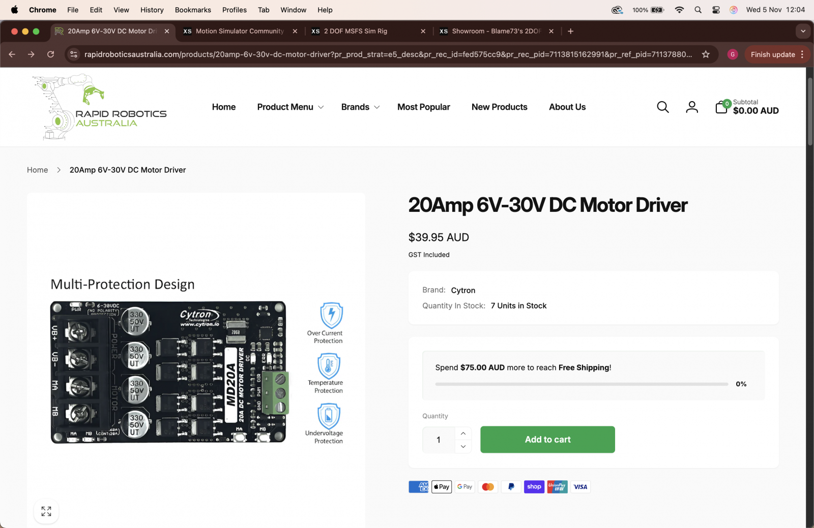

    Power Supplies : DIGISHUO DC 24V 20A 480W Power Supply (Amazon)
    Driver : Cytron MD20A OR IBT2 ? (TBC)
    Chasing advice on driver choice, please feel free to suggest which one is more suitable for my project.

    Nice fabrication work :thumbs
    For the Hall sensors 180s will give you better resolution, while still retaining a bit of headroom, so 6127V1A180L.5FS.
    Be mindful that many members have reported quality control issues with IBTs, it seems reducing the voltage a little helps, but you may want to consider more robust options.
    There is relevant info in the FAQs re alternative: https://www.xsimulator.net/community/faq/reasonably-priced-100a-motor-controllers.412/
    Cytron: https://www.xsimulator.net/community/threads/blame73s-2dof-seat-mover.6029/page-26#post-251285
    And all SMC versions: https://www.xsimulator.net/community/faq/arduino-code-for-use-with-various-hardware-and-simtools.31/

    Thanks @noorbeast for the prompt response. Very kind of you.
    Unfortunately I have already ordered 360 Hall sensors, would it be possible to still use these, say with a reduction drive GT2 belt and gears ?
    i might stick to 20A (MD20A) then.
    Still bit of fabrication to do.

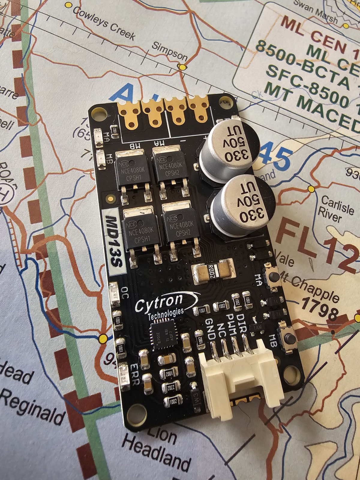

    Just to confirm, this driver should be ok before i place the order? i thought of going with 20A instead of 13A to ensure some redundancy.

    The 360 degree Hall sensors will work fine, even direct drive, you just loose a little resolution. I don't think the additional complication of gearing is worth the effort or associated cost.

    Choose the controller model that has supporting code available, not variations of them.
    Cytron MD30C: https://www.xsimulator.net/community/threads/blame73s-2dof-seat-mover.6029/page-26#post-251285
    Please see the FAQs here re the MD13s: https://www.xsimulator.net/community/faq/cytron-md13s-for-smc3.358/

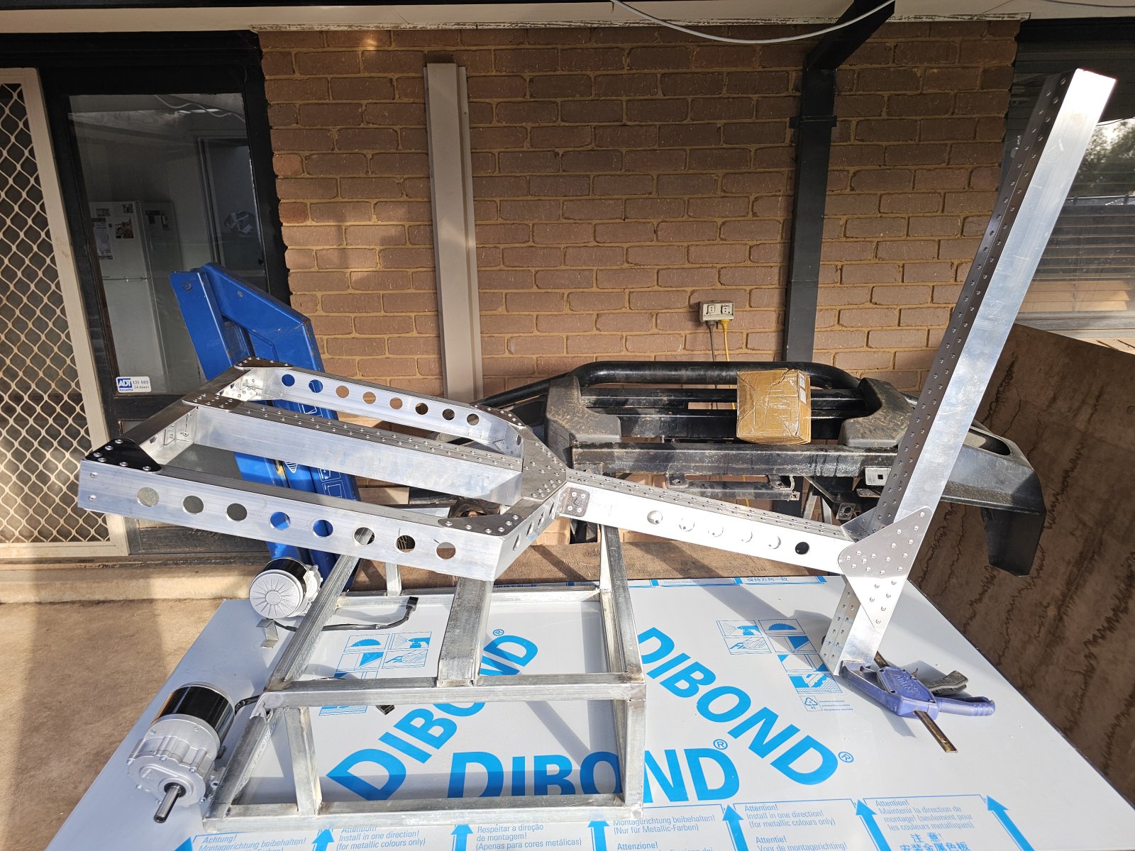

    Thanks mate, I will need to read up more on the controllers i think, im good at mechanical and syructural stuff but unfortunatwly ot much on electronics.
    Is there much to lose running 360 vs 180 hall sensor? Ive found that i might be able to return it but if there isnt much difference then i might keep it.
    Made bit more progress on the frame, hopefully finish it by the end od this week, then start the base.

    I use the Cytron MDDS30 for an industrial project (crane for lifting windows). It can drive two motors and costs €79 which is about the same as two MD20A. Both are a good choice, I think.

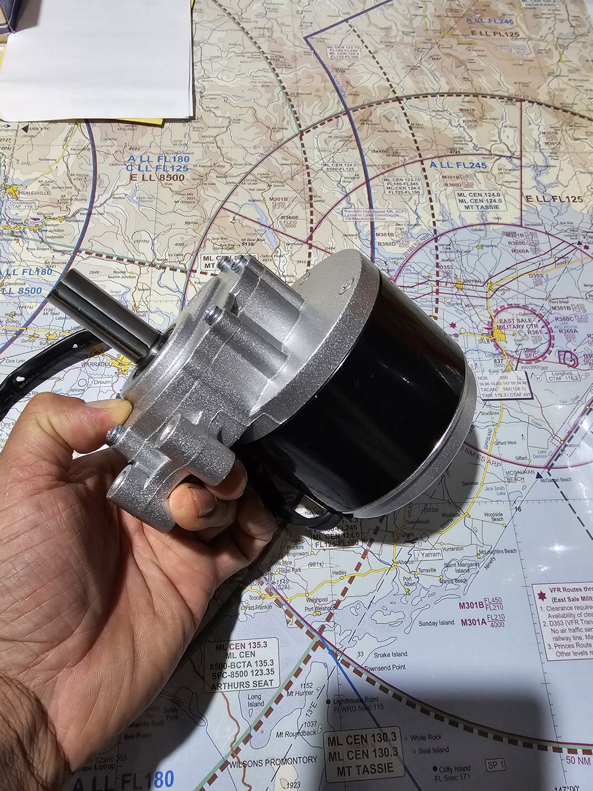

    Thank you @noorbeast and @Aerosmith , will look into these. ordered the M1016Z 24v 250W motors, getting the ARD UNO R3 today, just gotta decide on the drivers soon.
    Upon reading some threads, ive found the MDD30 may need batteries as well to combat regen currrent, this may be an issue for me, has anyone tried these drivers without the batteries?

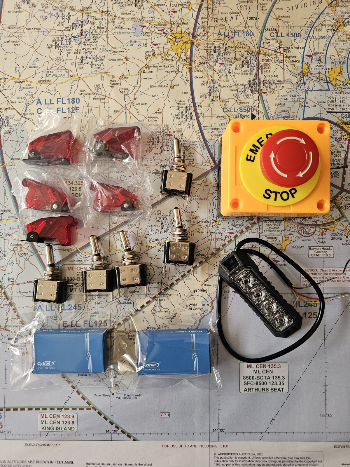

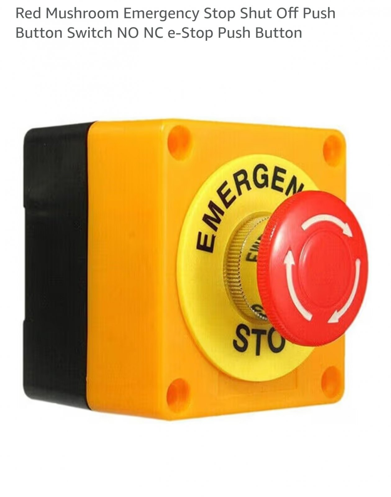

    Hall sensors have arrived, just waiting for the motors, Arduino and drivers to show up, after heaps of reading up on drivers, I decided to go with cytron MD13s units.
    Just wondering how have you guys wired up Emergency stop switches, I'm about to order the one pictured below ?
