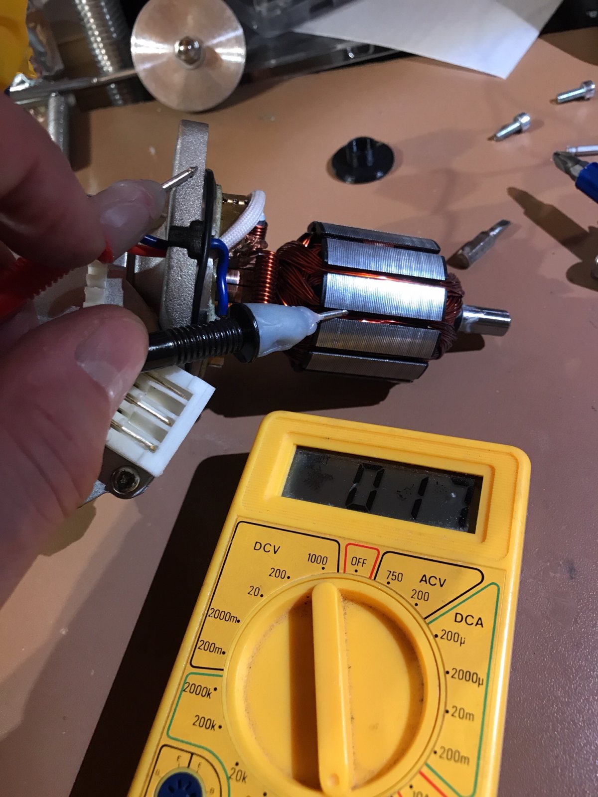

    The first thing is to remove the mass of the motor housing and cables, the motors must be disassembled and check if there is a connection between cables and housing, if there is a connection, it must be removed by desoldering the cable that gives mass to the housing (see photos) We must also remove the possible capacitors that the motor has, once this is done the motors are ready to run.

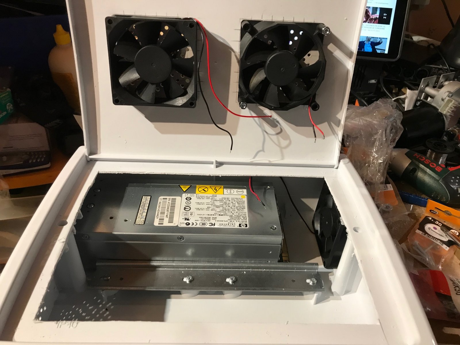

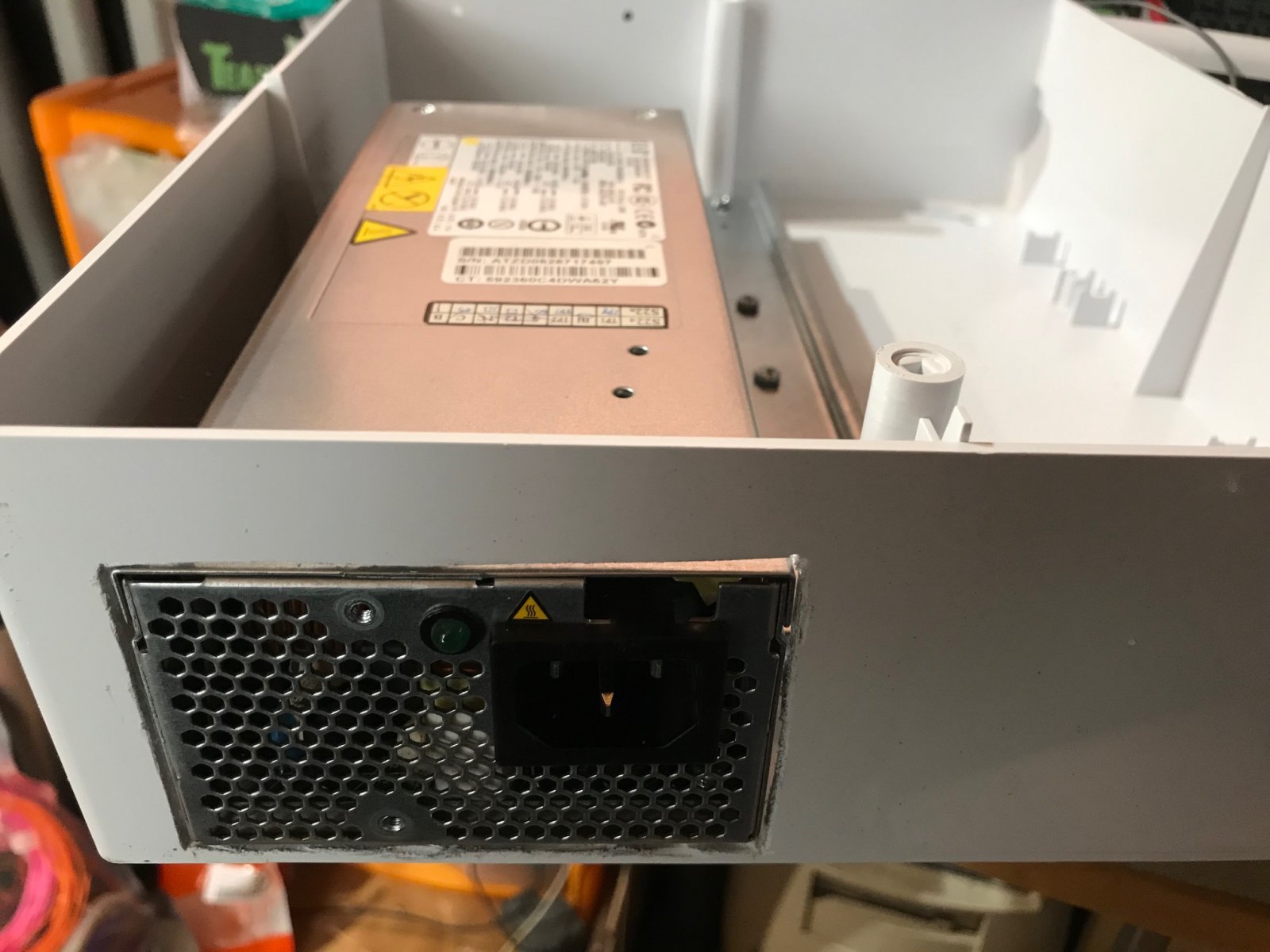

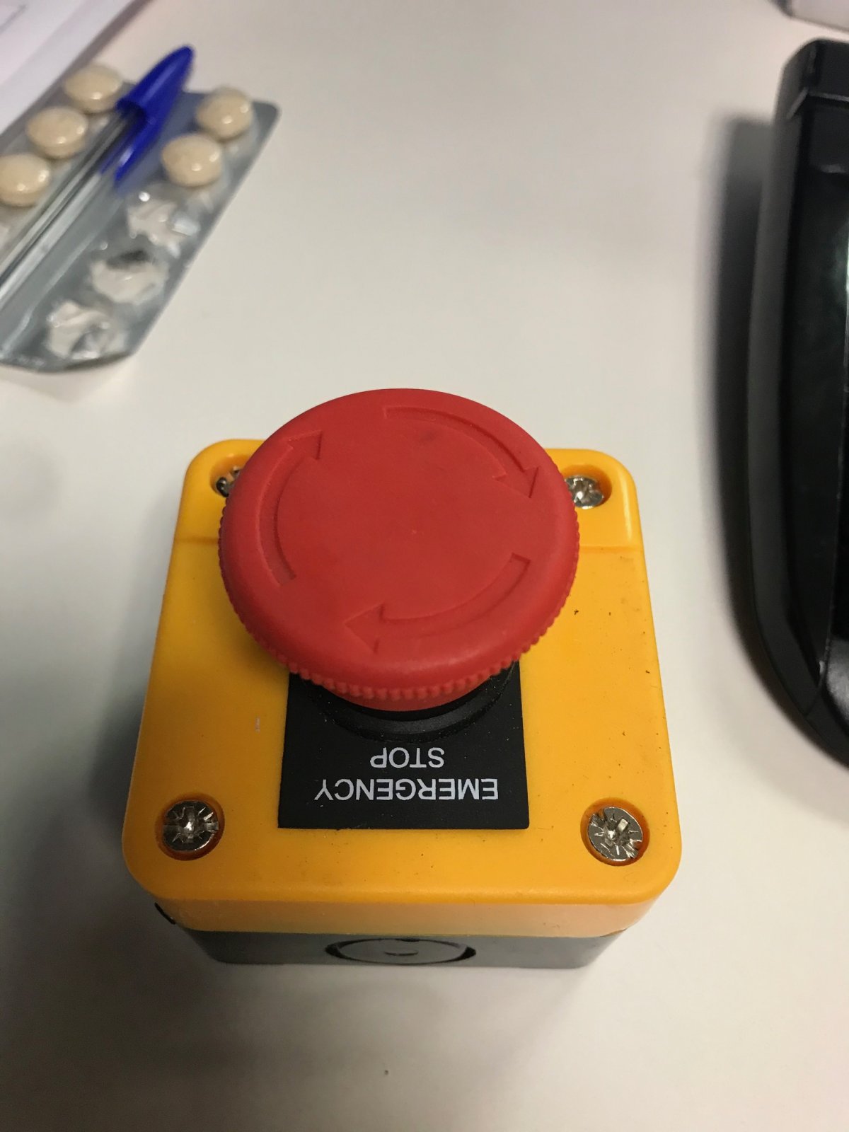

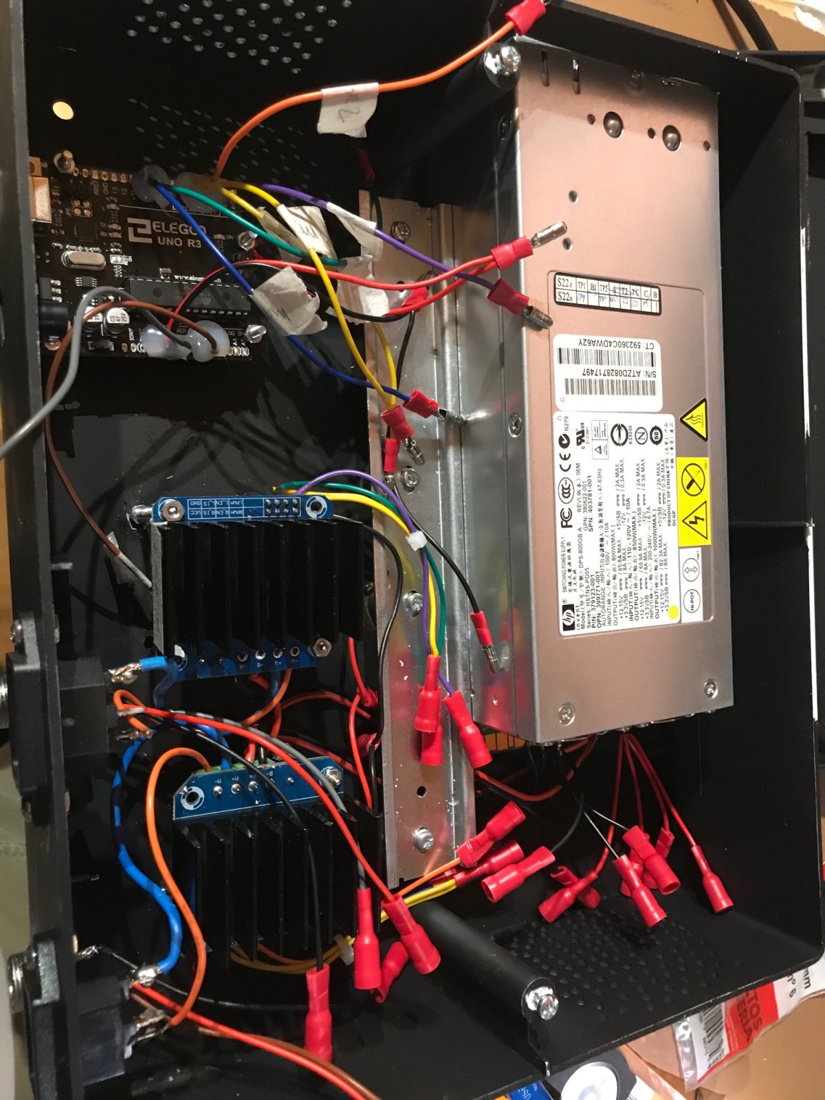

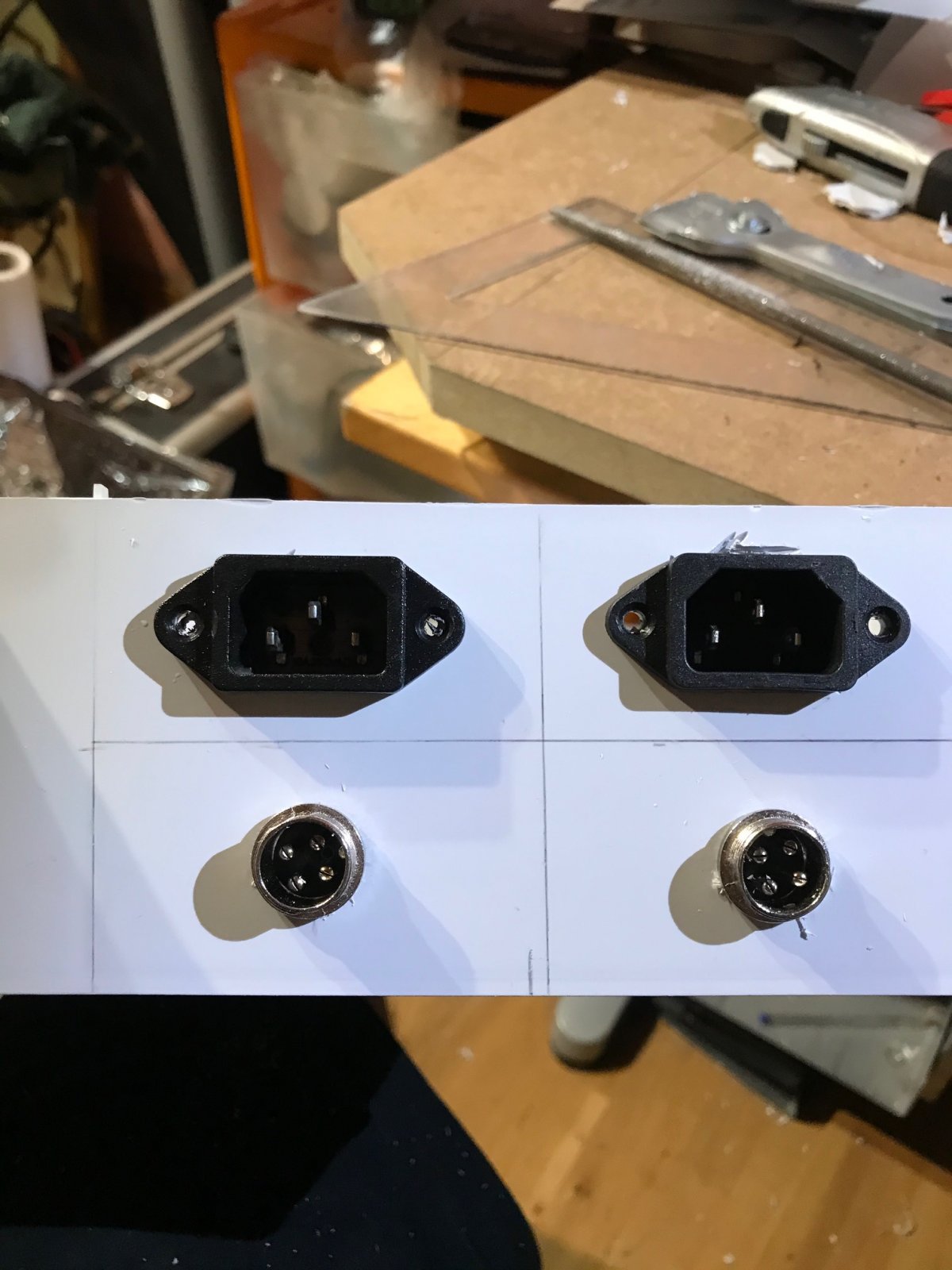

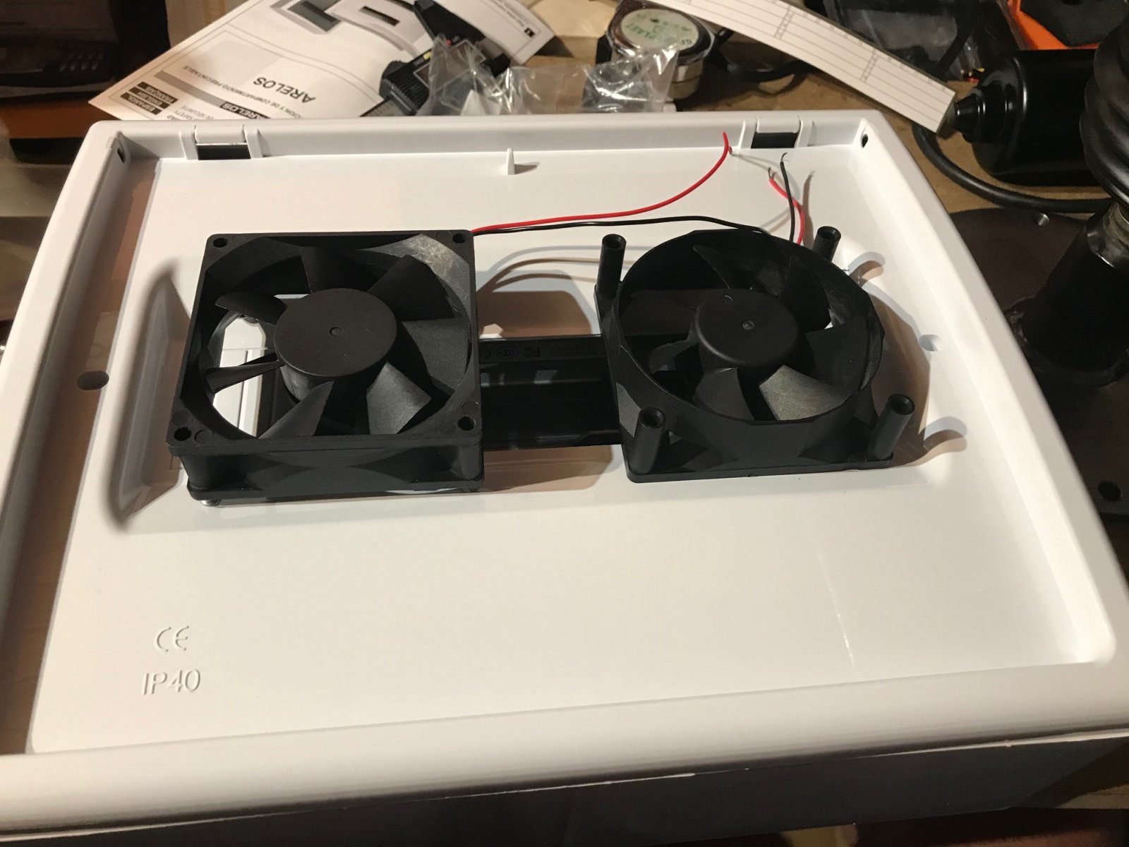

    you have to mount the power supply, with the IBT2 and the Arduino UNO in the box, (you can see the connections in the SMC3 tutorial) and I have also put 4 fans, 2 of them direct to the IBT2, one direct to the air inlet of the power supply and the last one as a hot air extractor to the outside (see video of how the box was mounted), all the cables of the box outwards mounted with clips for easy disassembly, I also mounted a Emergency stop to avoid problems if something does not work.

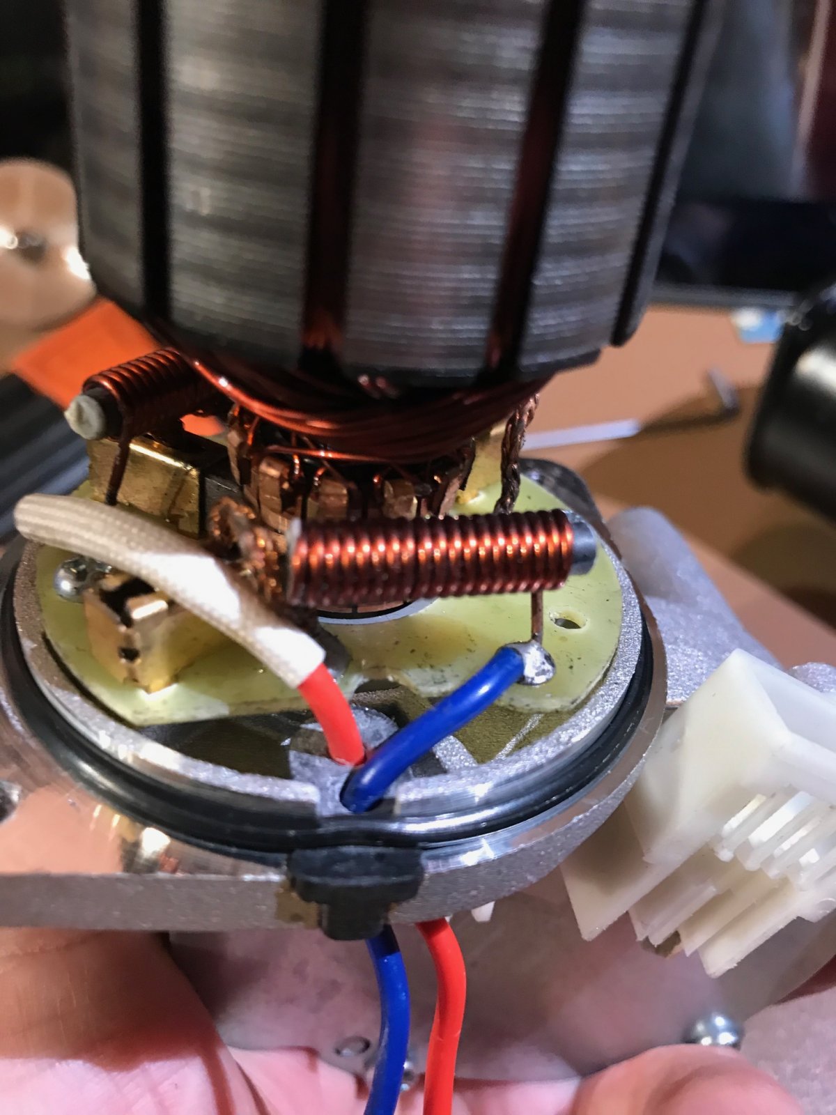

    this is a explained that i made to put the Wiper Motors in condition to work:
    -Motors
    first check if your motor have conection between cables and housing, check with multimeter if have conection (see photo)
    if you not have connection you not need to make nothing, take multimeter and check cable with Housing..... if you have connection you need to dismount the motor and take of the connection of mass like photo
    if you have some capacitor you need to take of see photo with capacitor and in before photo without capacitor
    when you take of the mass and the capacitor you can close the motor and is ready to work, make the same operation with second motor.... don't forget
    see you en next step of my building 2DOF

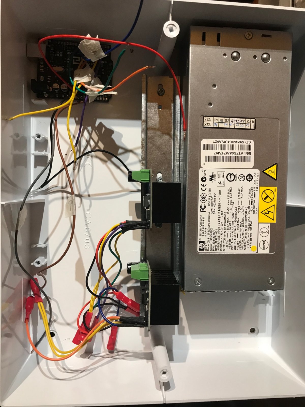

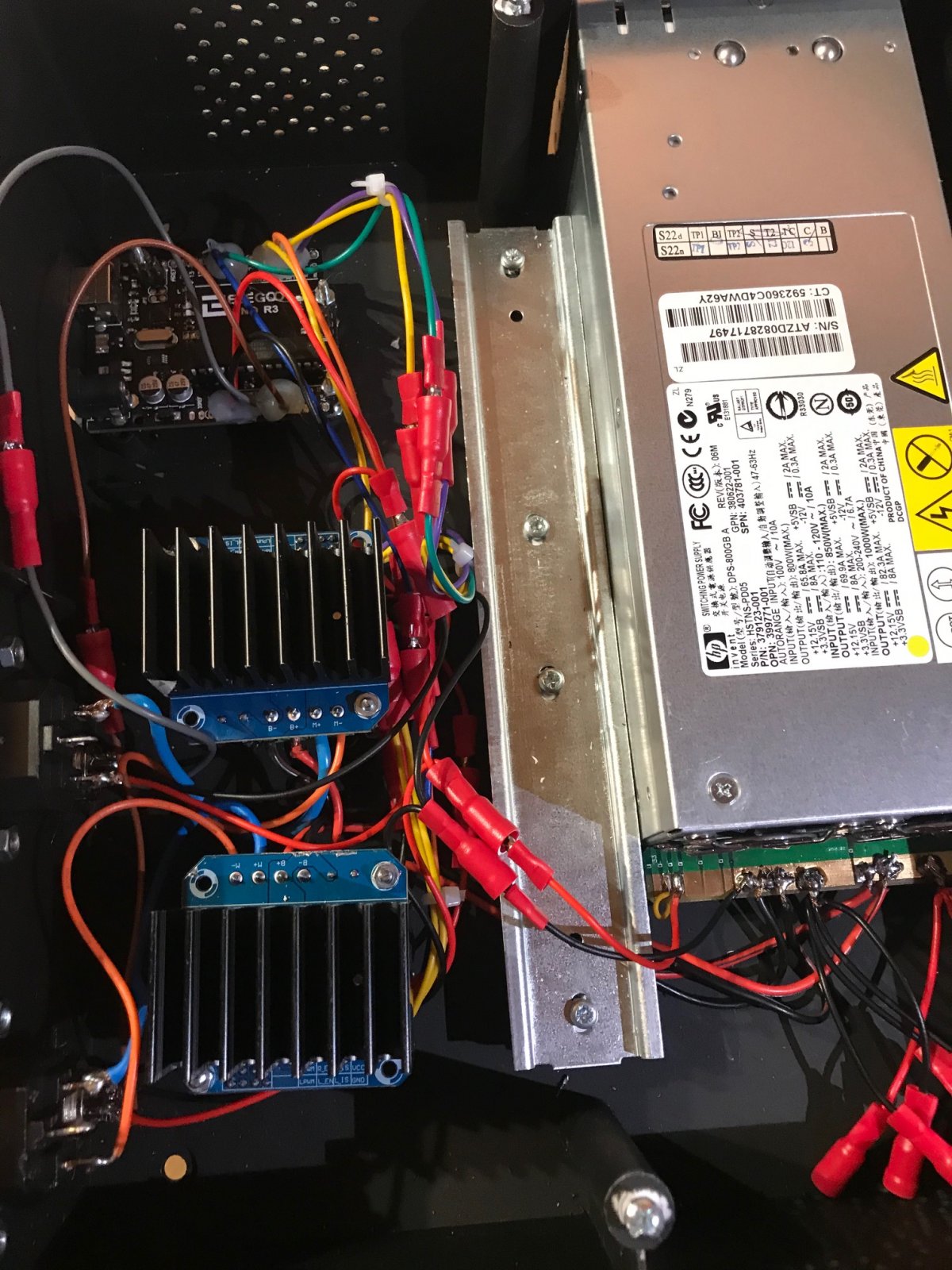

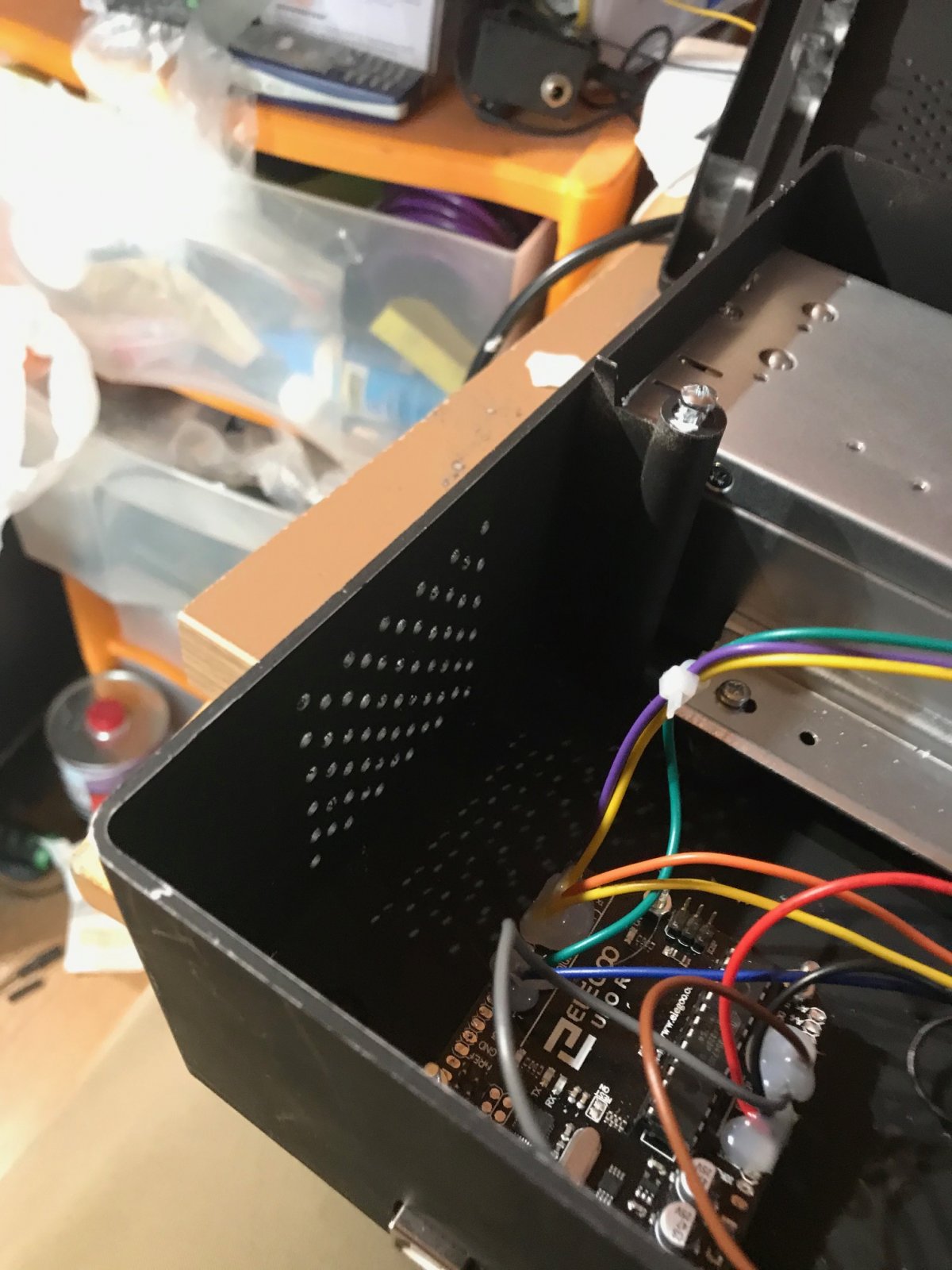

    Electronic Box:
    one of the steps more important to have a motion elegant is the Electronical Box in this box i put the Power Supply, Arduino Uno, IBT2 and all conexions including for Emergency Step button, i buy a chipper Box from electrical shop, see photo
    and i prepare to put fans
    power supply, Arduino and IBT2
    IMG_2642.jpg IMG_2644.jpg IMG_2648.jpg IMG_2653.jpg IMG_2655.jpg IMG_2656.jpg IMG_2657.jpg
    you can see in this video the final result
    see you in next step.
    bye
