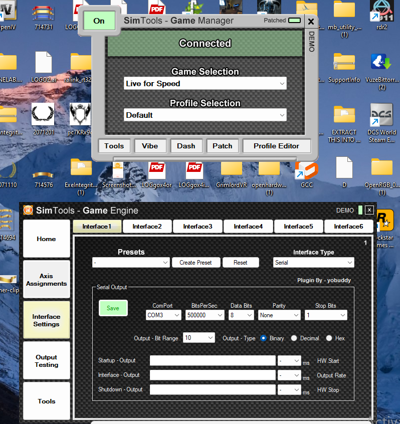

    sorry to be a pain in the ass but i have another question
    ive set the rig up and configured it in smc 3 all good
    i cant eem to control ithe rig through simtools ill trry and post settings its the interface output values that are throwint me in interface settings in game engine
    ive been following dmax and he says copy and paste the values but from where
    ive tried to folow the gide swel and seem to be missing steps could it be to do with ip ??
    thanx for all your help i will be purchasing a license once i understand

    heres how far i got

    Also to note when I try to test output and I switch the box to on the 2nf orange light on my arduino comes on but absolutely nothing to the motors
    5 hrs reading and trying so many things but cannot get simtools to control my rig
    Works fine with smc3

    Please see the actual SMC3 thread: https://www.xsimulator.net/communit...3dof-motor-driver-and-windows-utilities.4957/
    Simtools Setup
    Setup for Simtools 2 is very straight forward:
    Interface Type - Serial
    ComPort = the Arduino ComPort, you can find it in Windows Device Manager.
    BitsPerSec - 500000
    Data Bits - 8
    Parity - None
    Stop Bit -1
    Output Bit Range - 10
    Output Type - Binary
    Interface Output - [A<Axis1a>][B<Axis2a>][C<Axis3a>]
    Also note LFS must be run before it is patched for motion: https://www.xsimulator.net/communit...run-in-first-person-mode-before-patching.365/

    got it working changed usb worked in the end
