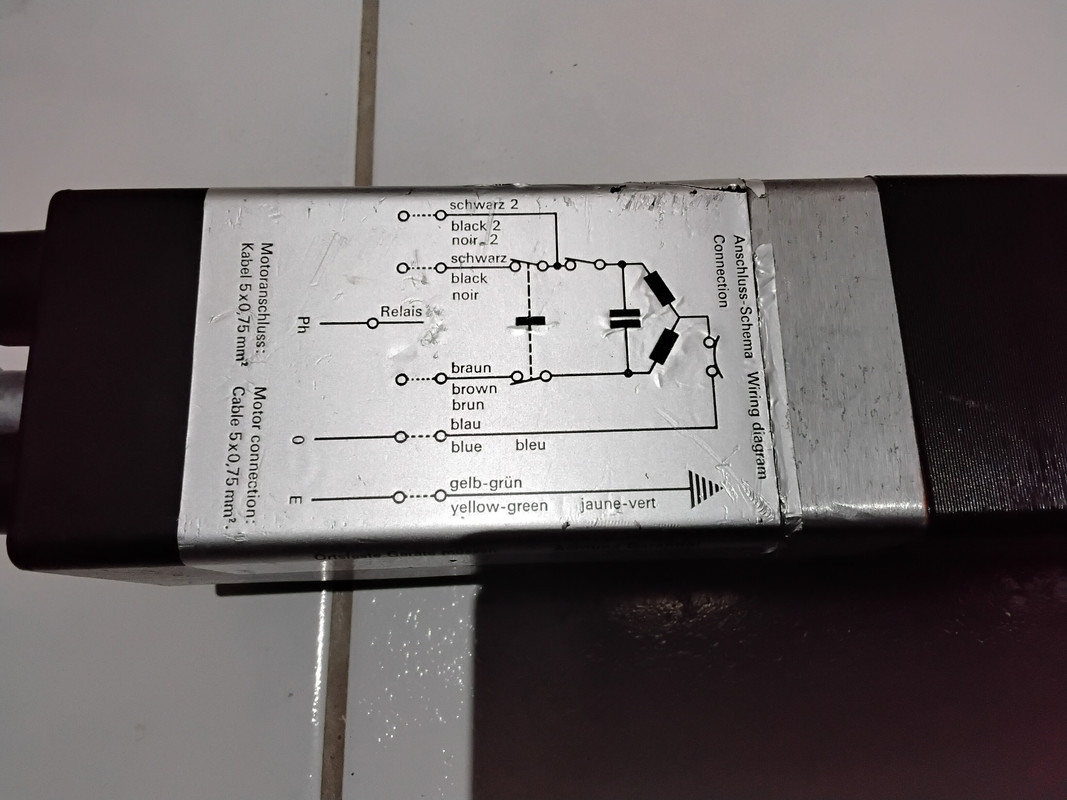

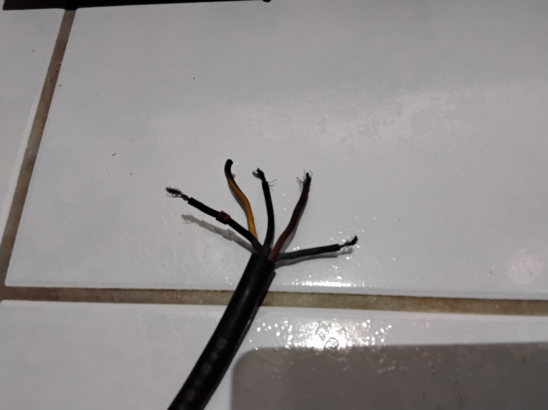

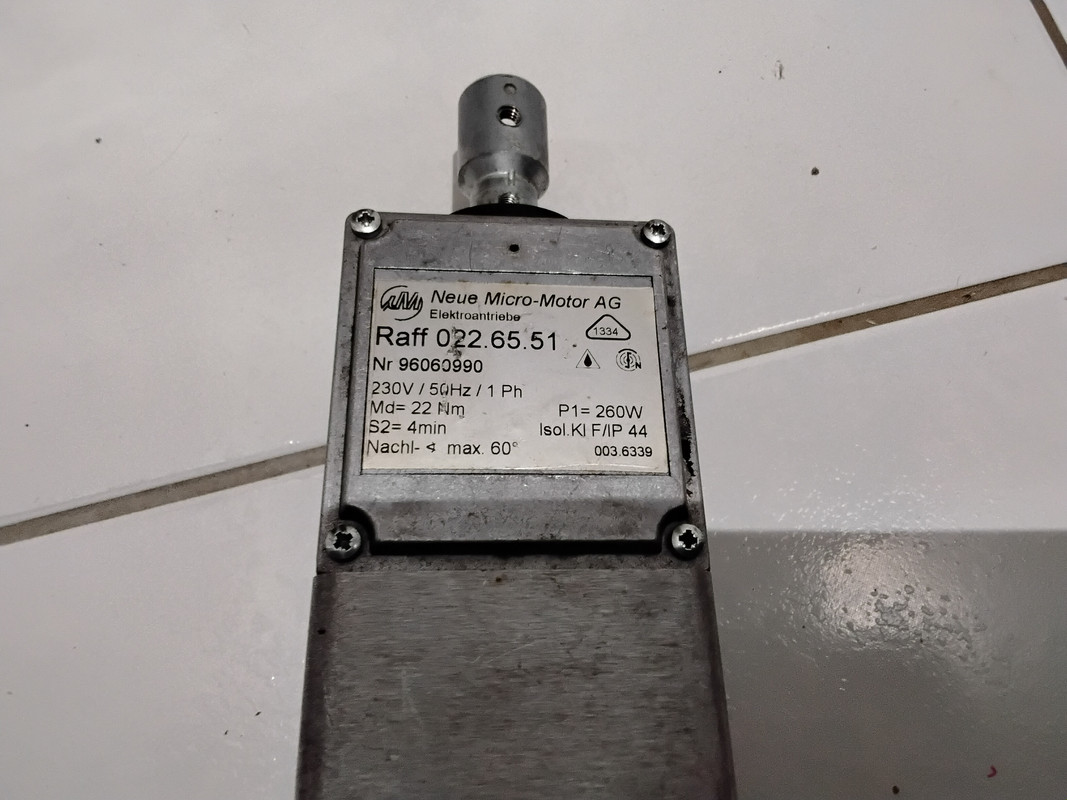

    I am actually building my first motionrig. Seen some tutorials and started with 12V wipermotors. It works so far. But I have two 220V Motors from big Garagedoors laying around and I am wondering if I can make any use of them in the motionrig. I tested them. When I connect brown and blue it moves in one direction. With one of the black and the blue cable it turns in the other direction. Can I make thes3 motors work?
    1. What motor drivers will be used for 220v, if possible?
    2. Can it be done with a relay modul?
    3. Helpfull links?
    Appreciate your help. Thx.

    This is a reversable AC motor with starter capacitor. It is meant for running at constant speed so unfortunatelly it's not suitable for driving a motion rig.
    Yesterday I accidentally found theese incredibly cheap industrial servo motors. They are 103€ for a whole set of motor, driver and cables. For that price it no longer makes sense to use wheelchair or wiper motors. Those are only ~$30 but you need a driver, a feedback hall sensor and an arduino to make them work. Not to mention the countless hours to program and wire it and the headache until it performs the way it should.
