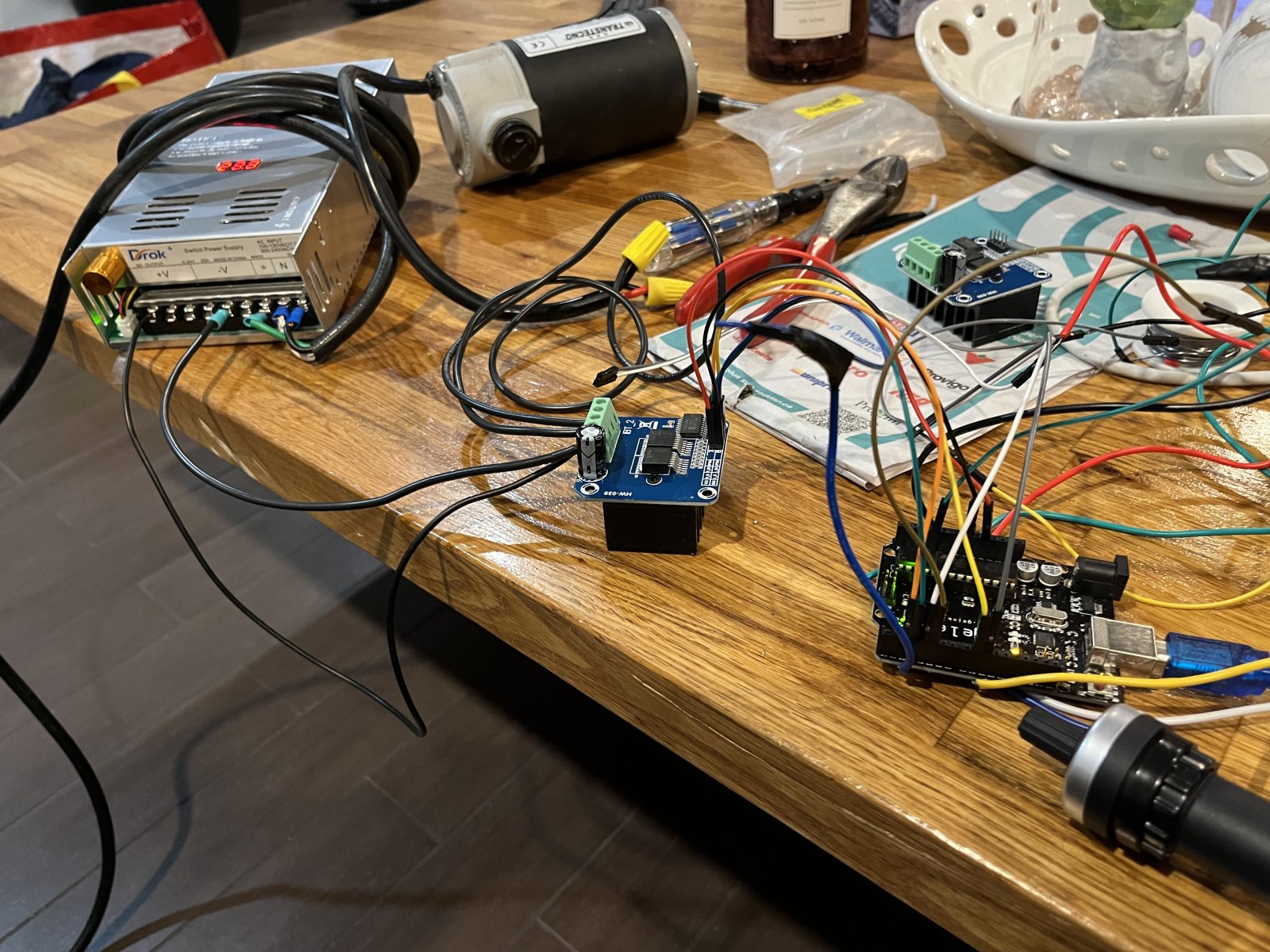

    ok so re program the arduino with the smc3 , change it to mode 2 . again the pot I see the green line going up and down when I move the pot. but if I put the sim utility to motion nothing is happing to the motor. I check the output for the motor on IBT-2 and the is no 24v coming out i have 0 volt. here is the image of my connection re check all of my connection to make sure and all is done correct.

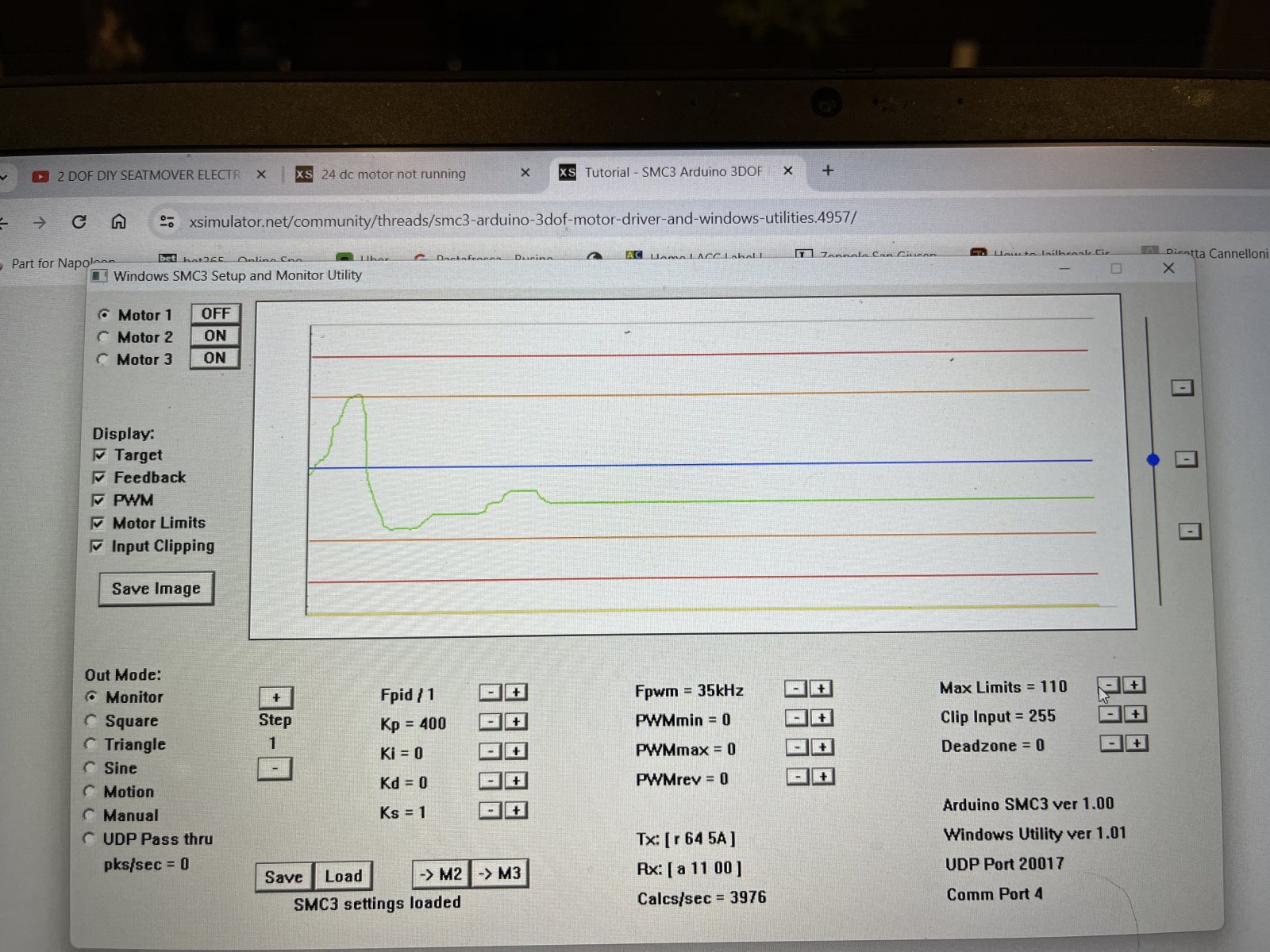

    here is the picture. so if i move the pot green line goes up and down
    21,724
    152,057Coins
    +11,063 / 56 / -2
    I am presuming the wiring is complete as per the SMC3 instructions and the pot is attached to the motor, is that correct?
    From the image it seems PWMmax is not set, step 9 in the initial SMC3 setup:
    8. Set Kp to about 400
    10. Do the above for each motor
    Once that is done can you please run the Sine test in Out Mode and post a picture of the result.

    so recheck my connections and now i am sure 100% that everything is connected right from Arduino to IBT with pod and also power supply. check with multimeter continuity and a that is good check also the 5v power supply and that is good also. now on to the the programming which is what i suspect is my problem. My Arduino is connected on com 4, what I need to now is what is the program that needs to be load to Arduino to be visual by the simtool. if someone can attach the file and give me steps on the how to of it all would greatly be appreciative of this. Keep in mine the motor I will be using is 24v, 3000rpm, torque is0.43nm, amps 8.4. thanks

    First, the motor will not start until the button next to Motor 1 is off, click it and switch it to ON
    Secondly, set Fpwm to 20mHz because you will burn IBT2
    Third, set the green line in the middle of the screen and set the PWMmax to 120-130 and gently turn the potentiometer the motor should start
