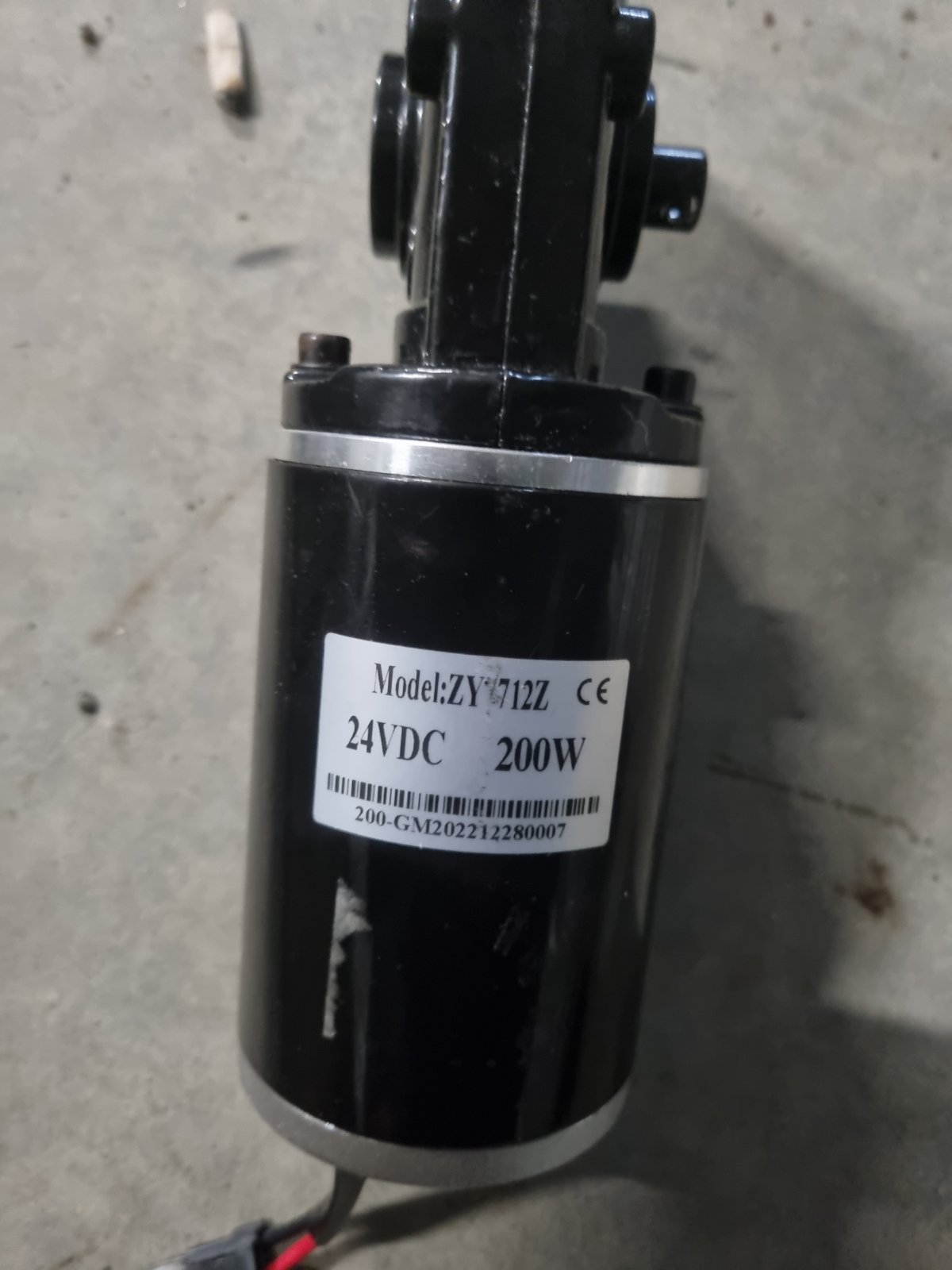

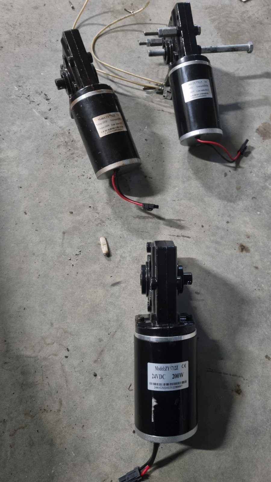

    I scored 3 motors for $50 which leaves me no excuse not to build a 2 dof with TL sim
    Found these on FB marketplace

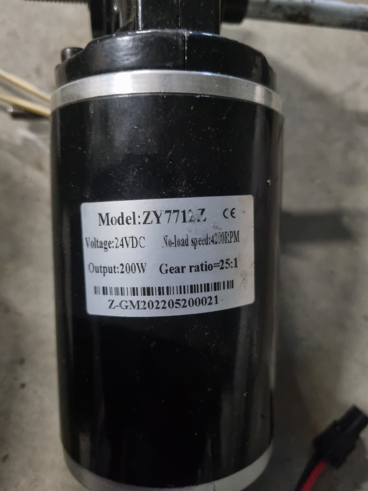

    2 of them have stickers with
    model zy7712z
    200w
    24v dc
    25:1 gearbox
    I haven't seen these specs for the motors @ 4200rpm unloaded speed - the ones I've seen on motion dynamics and other builds are 3600 rpm - Has anyone used these specific motors before ?
    the third motor appears to be the same but different sticker
    Im guessing that there are the motion dynamics motors,

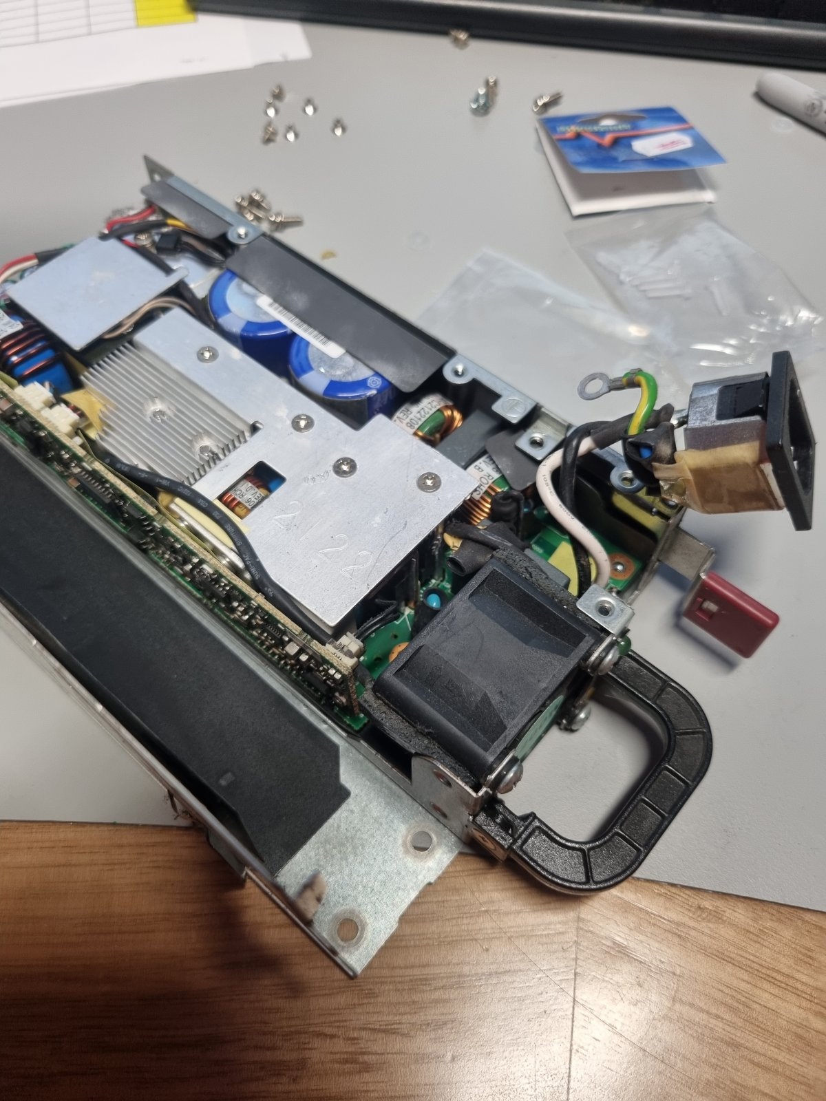

    I have 4 HP 1200W Power Supplies in order to make 2 separate 24v power sources
    I found this Youtube on how to get 24v out of 2 of these

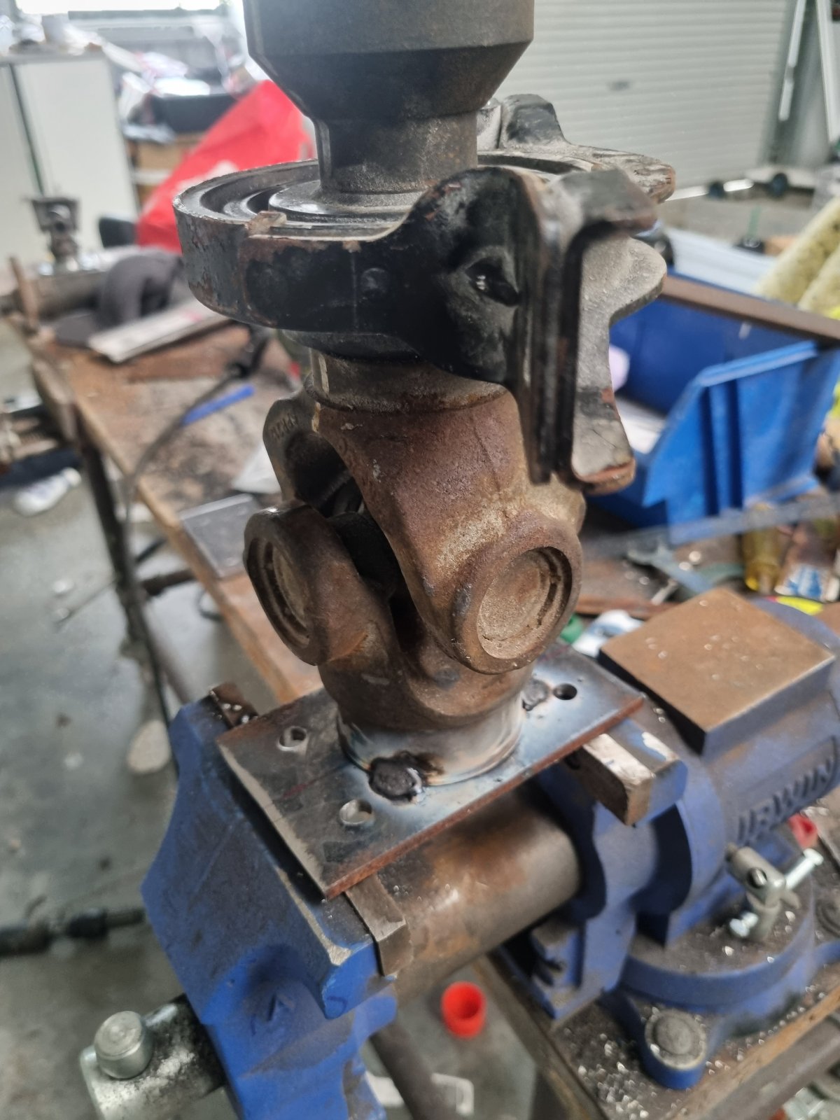

    I'm using a Ford falcon tail shaft i got for $50 from a mechanic for the universal joint
    as seen in the image above I have welded steel plates to the Uni joint
    I've already cut of the centre bearing and bracket but I'm interested to know has anyone thought of using the centre bearing under the uni as some form of YAR or traction loss ?

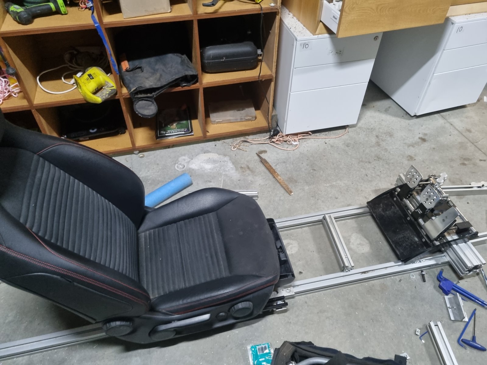

    I have a seat from a Mercedes I am concerned its a bit heavy probably 20-30kg time will tell.....
    I'm thinking I may use the Seat rails as my pedal mount so I have adjustability without messing with COG to much
