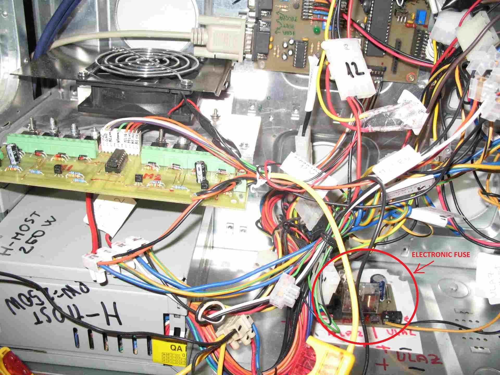

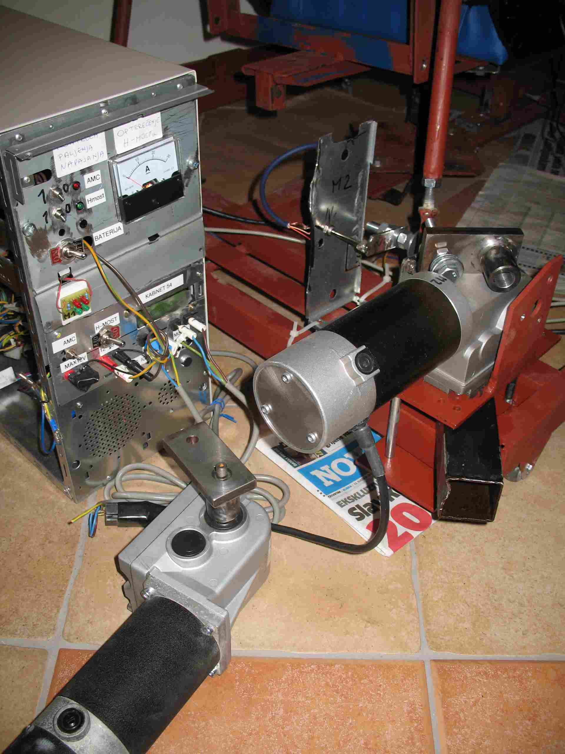

    hello!
    I juse 24V DC motors from electrical wheelchairs
    something like this :
    http://www.ebay.com/itm/Merits-metro-Po ... 43aca4787c
    they have very quality robust metal gearbox
    and after some burn out MOSFETs (mostly P type- IRF 4905), I was find out that this motors work fine on 12V !
    because of less Volts, torque was probable dropped from 10 Nm on 8 or 7, but they work
    fine with me on chair (my and chair load about 100kg) :D
    so now I juse them on my 250W PC power supply (from older PC type one) on 12V and
    I use electronic fuse (just in case) to protect my H-bridge FETs
    regars
    Igor
