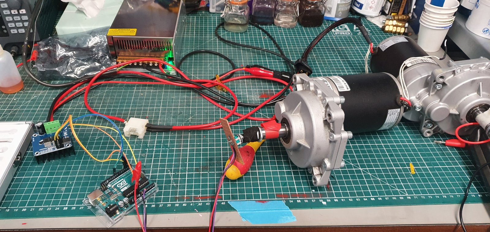

    Well here's the start of my motion sim we'll the electronics part anyways.
    I have sourced
    2 x 520W electric wheelchair motors
    2 x IBT2 motor drivers
    1 x arduino uno 3
    1 x 1200W 24V SMPS power supply.
    I may have to go down the route of batteries if the psu isn't man enough for the job right now. But appears to be working on the bench for the moment. Pic attached.

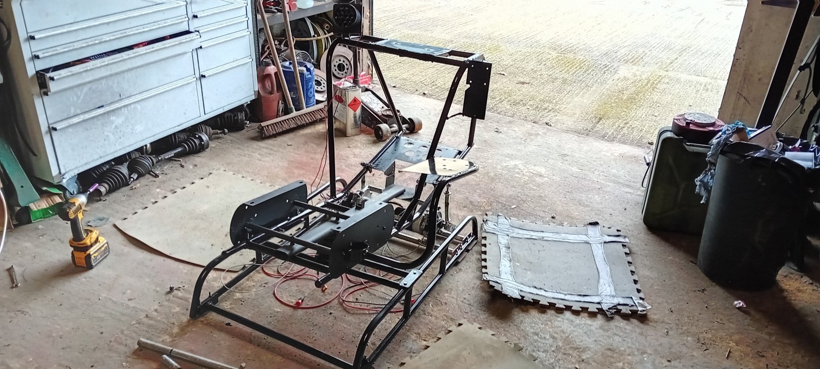

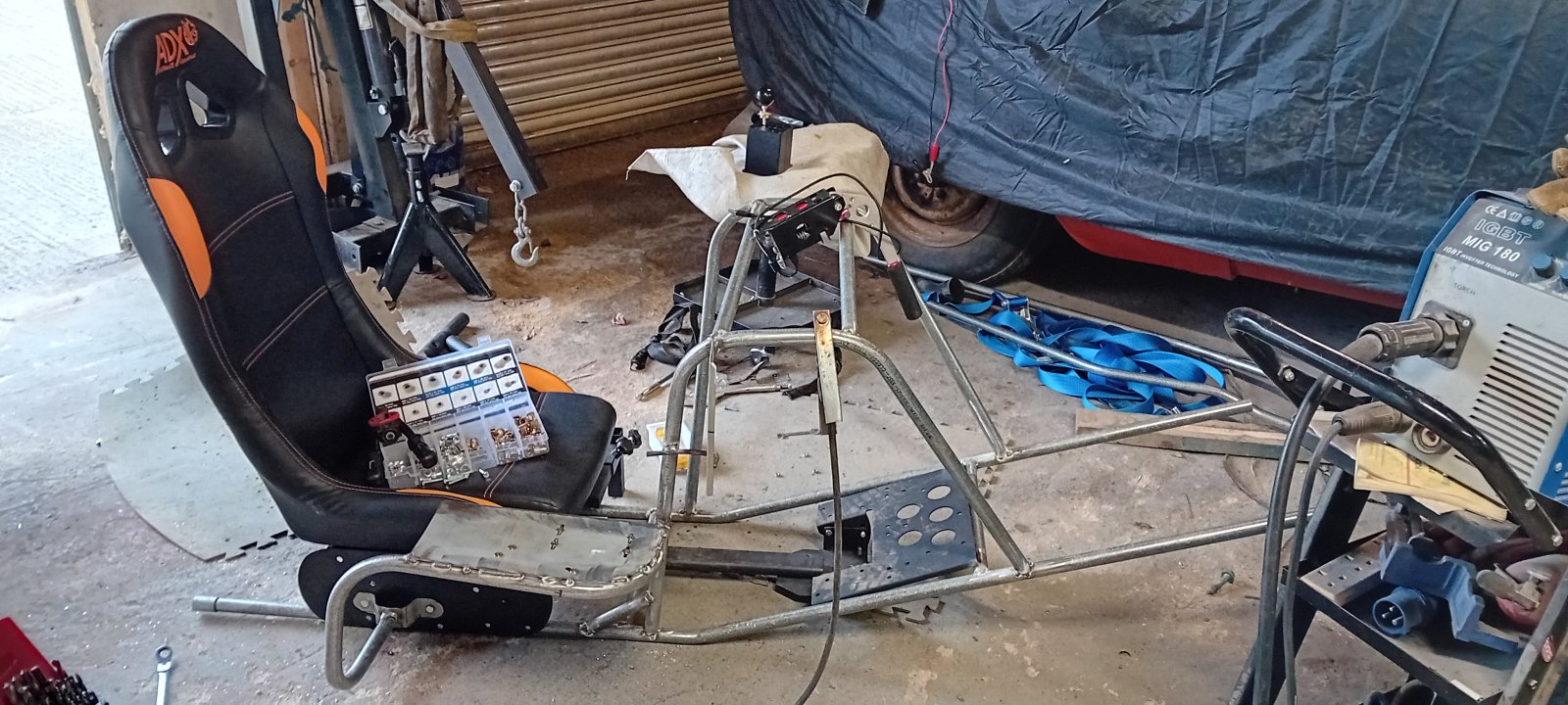

    Well it's been far to long with so many other projects. But I had some time of work so here's what I've come up with so far
    This is the initial frame that all my sim stuff will be mounted to and me

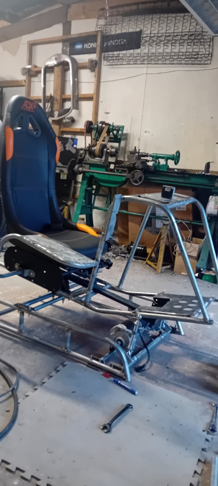

    And then it attached to the base frame and wheel chair motors mounted

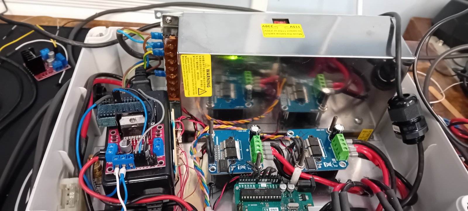

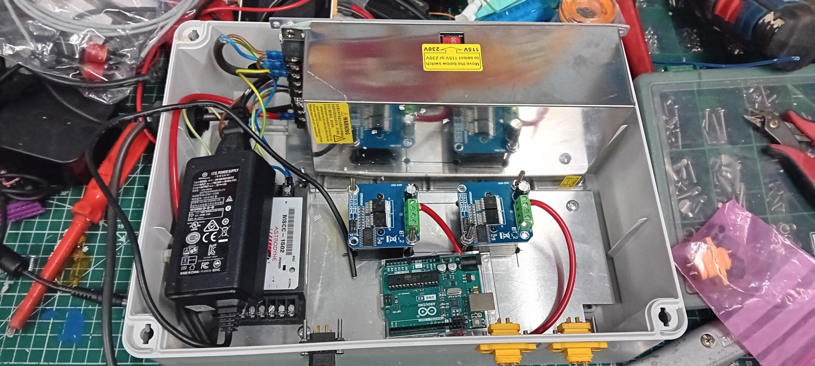

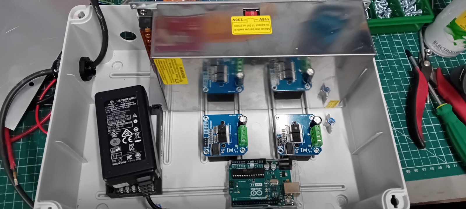

    I've made a start on the electronics too will add some more pictures to the post once I've wired it all in.
    Edit. High voltage wired in just starting on the dc wiring and signal stuff now. Can't wait to test the rig.

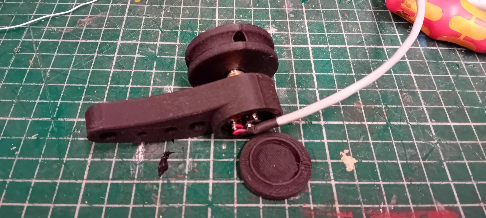

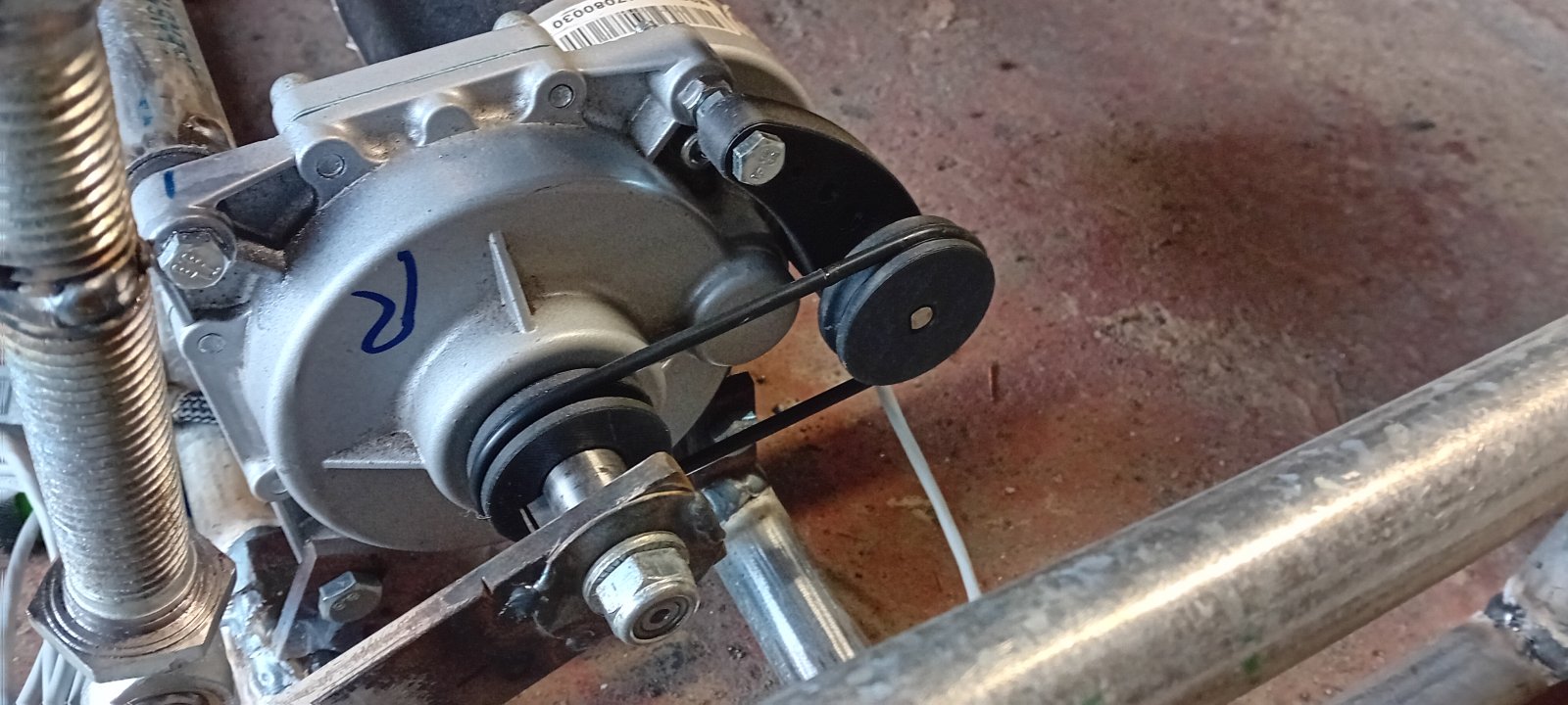

    So I got a 3d printer and have been busy making holders for my hall effect pots and got them all mounted to the motors. Really happy with the finish on this part. 20240301_173809.jpg
    This will protect the hall effect wiring one fused on.
    All mounted to the motors and working sweet
    Also managed to finish the wiring and ad in some wiring for my wind sim also

    Frame is now all painted" sim racing black" aka what I had left over in the shed 20240313_131213.jpg and moving on smc3 utils one motor at a time :)
