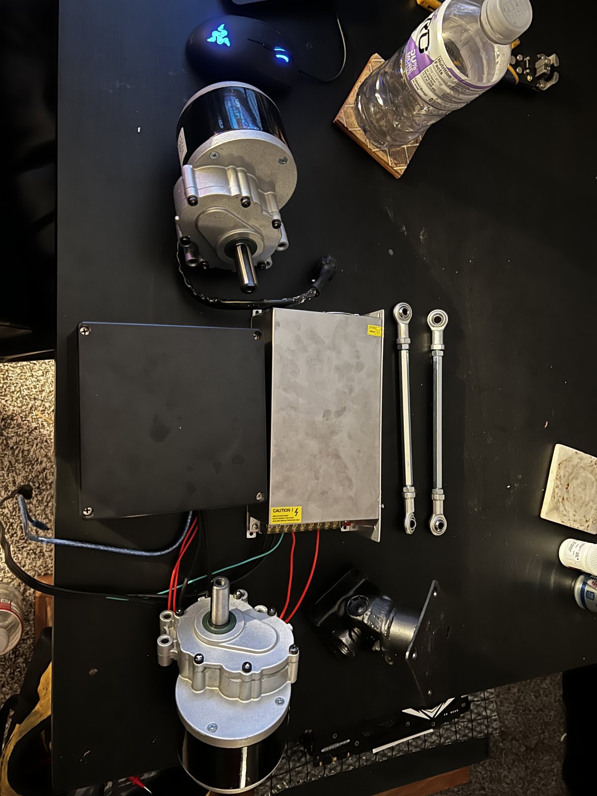

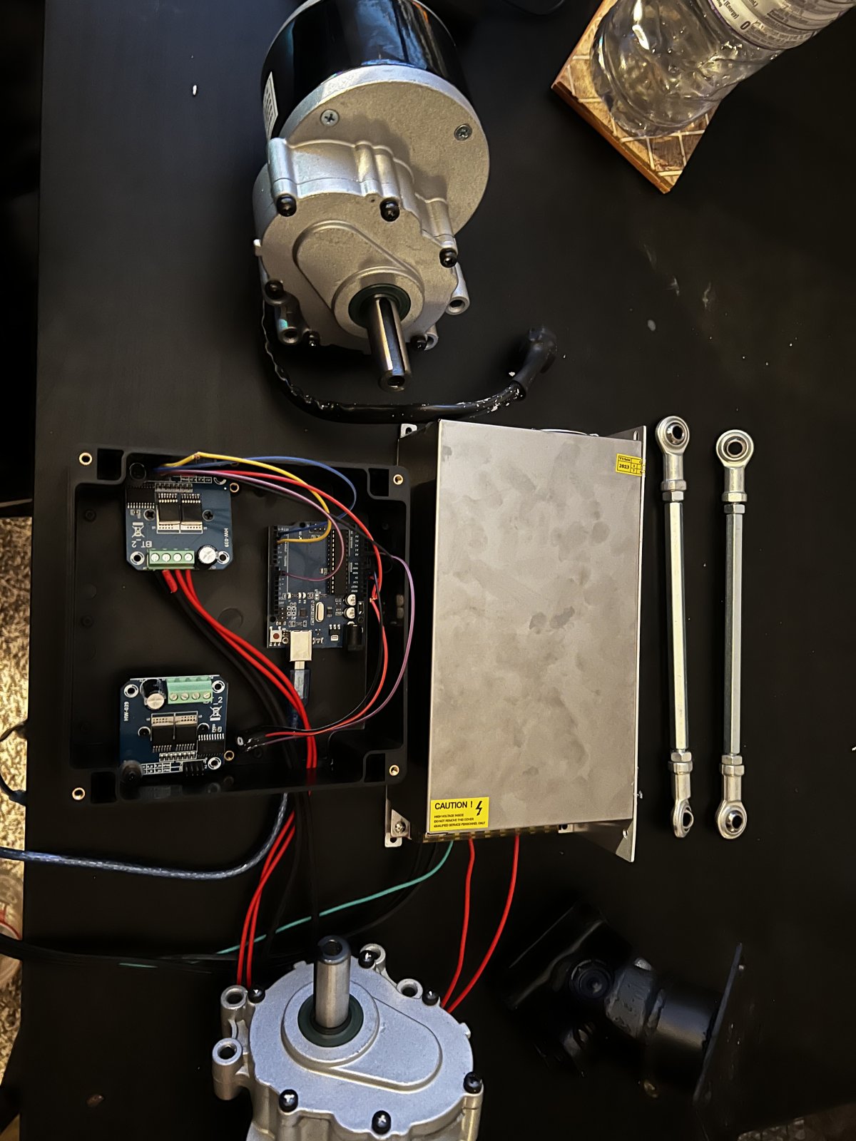

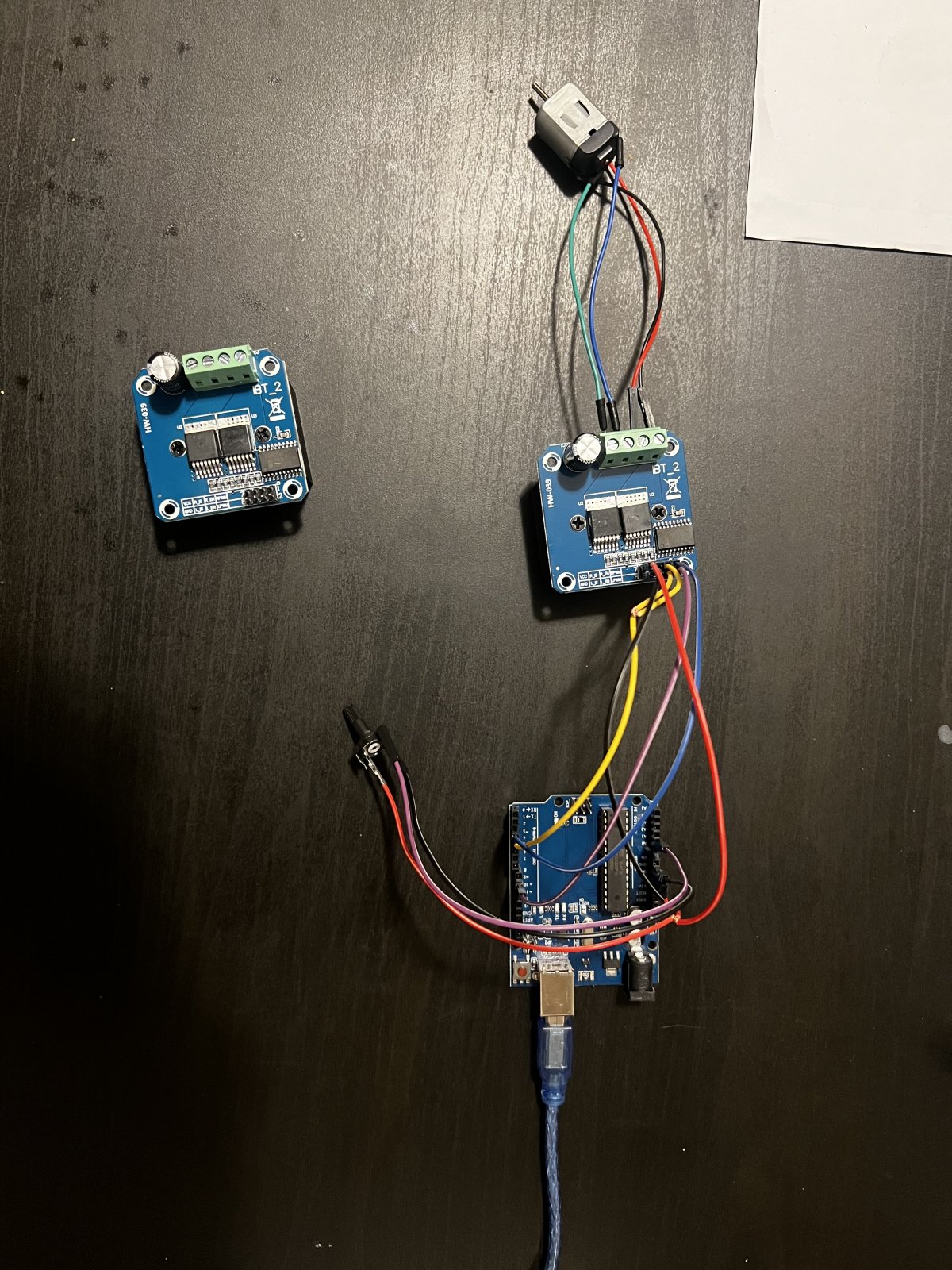

    Excited to be posting this. Should be testing out the sim this weekend, and wanted to get a build thread started. So far this is what I’ve had to buy:
    • x1 arduino Uno R3 (rexqualis off brand)
    • x2 IBT-2 BTS7960 43amp
    • x2 24v 250w 13.4a 75rpm wheelchair motors
    • x1 24v 1000w 42amp power supply (have voltage set to 18.5v, to protect the ibt2’s)
    • x2 “motoforti” tie rods
    • x3 8ft 2x4’s from the local hardware store.
    • x1 Mazda Miata driveshaft(cut and welded flare plate to one end)
    I was lucky enough to be able to purchase everything on Amazon, short of the wood and driveshaft.
    The motors are hooked up and have been tested with SMC3, just have to join the motion platform to the base, and I’ll be on my way to getting on it for the first time.
    Here are a few pics from earlier this week. Any tips or questions are 100% welcomed!

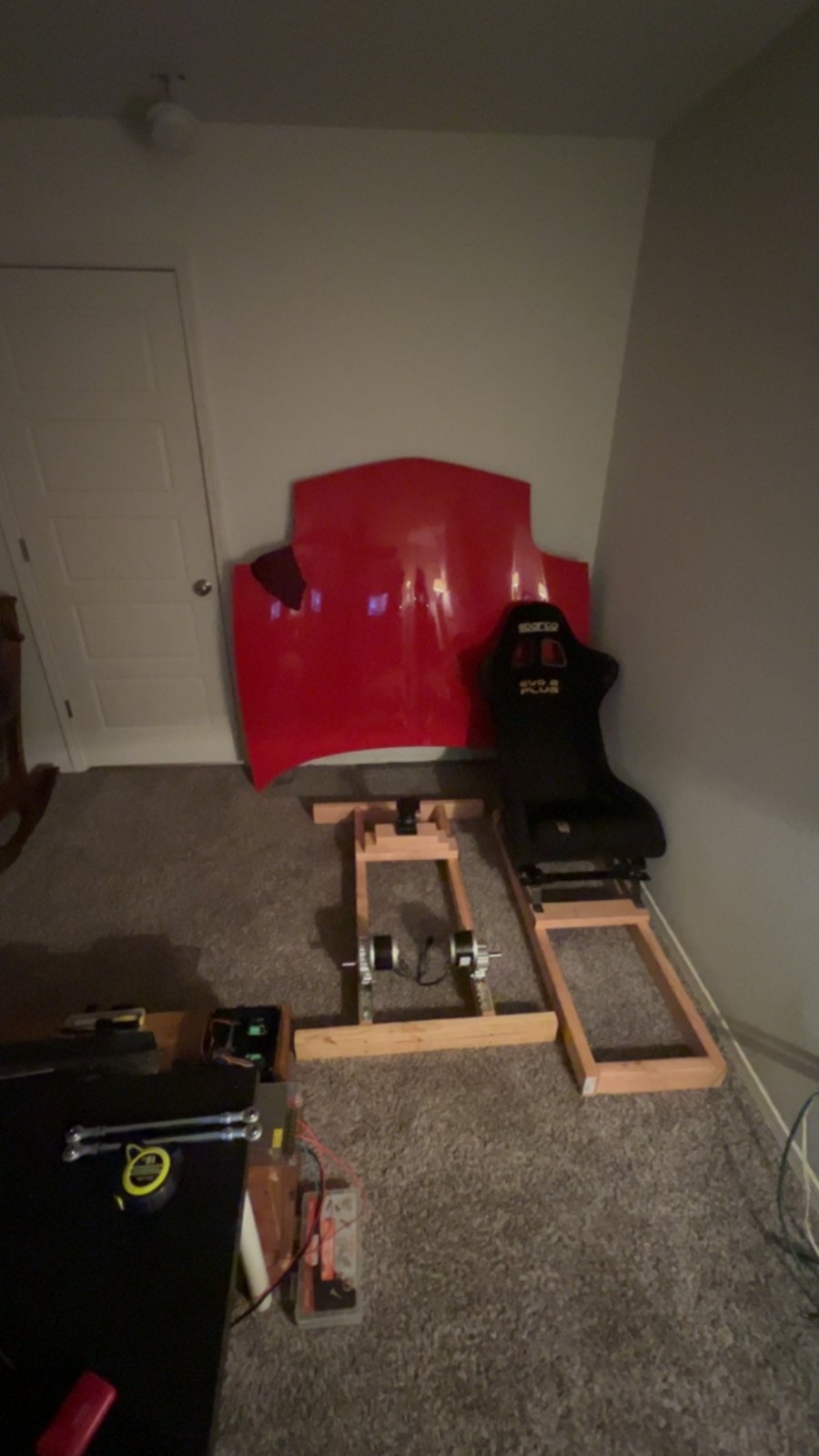

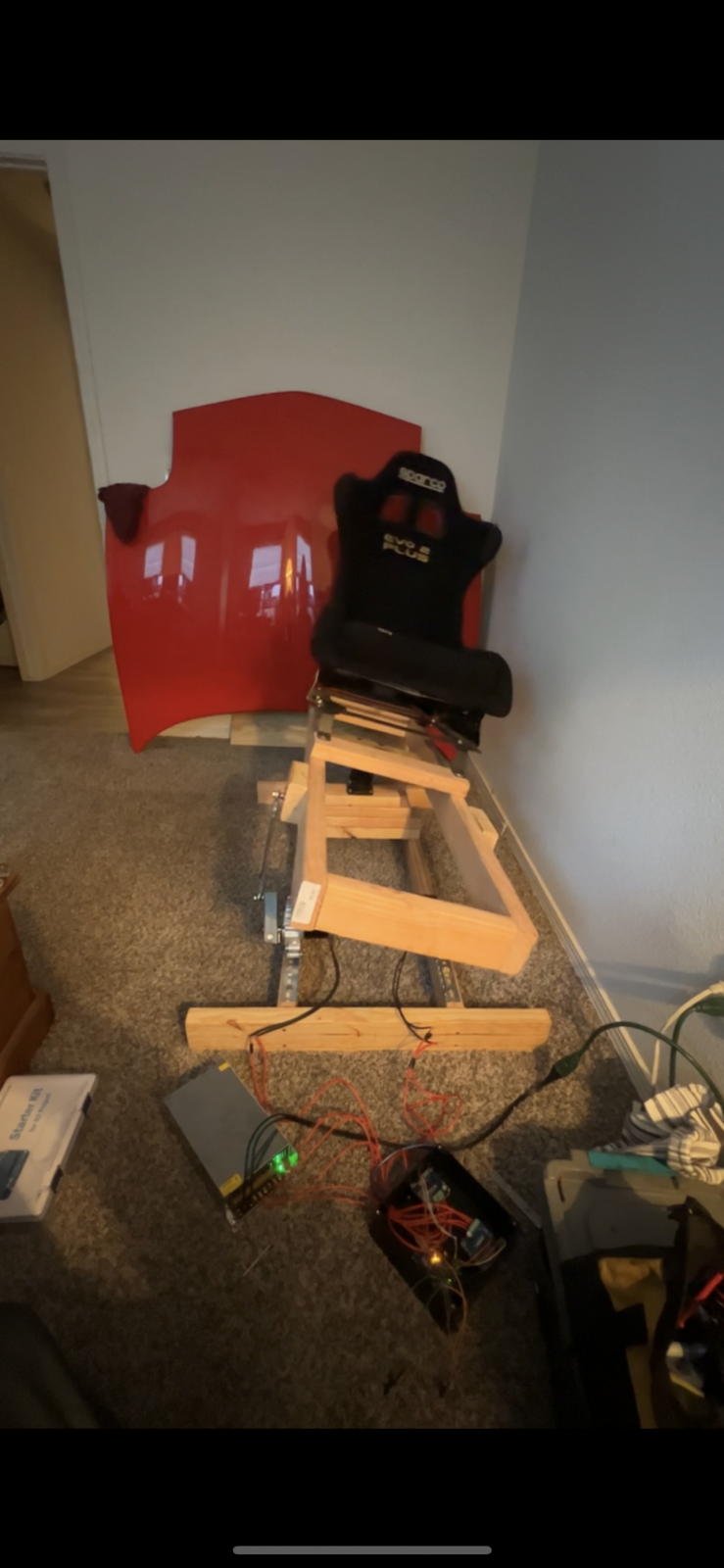

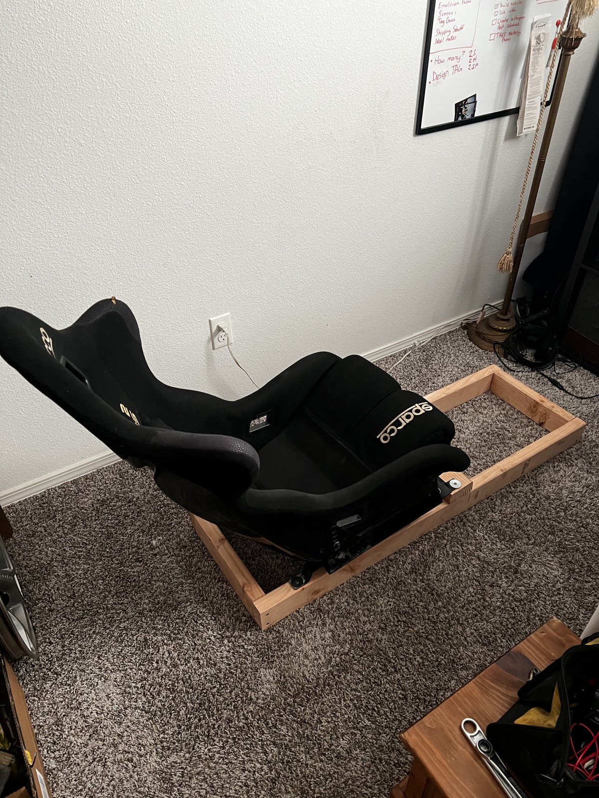

    Got it all mounted up. Putting together the lever arms and control arms now!

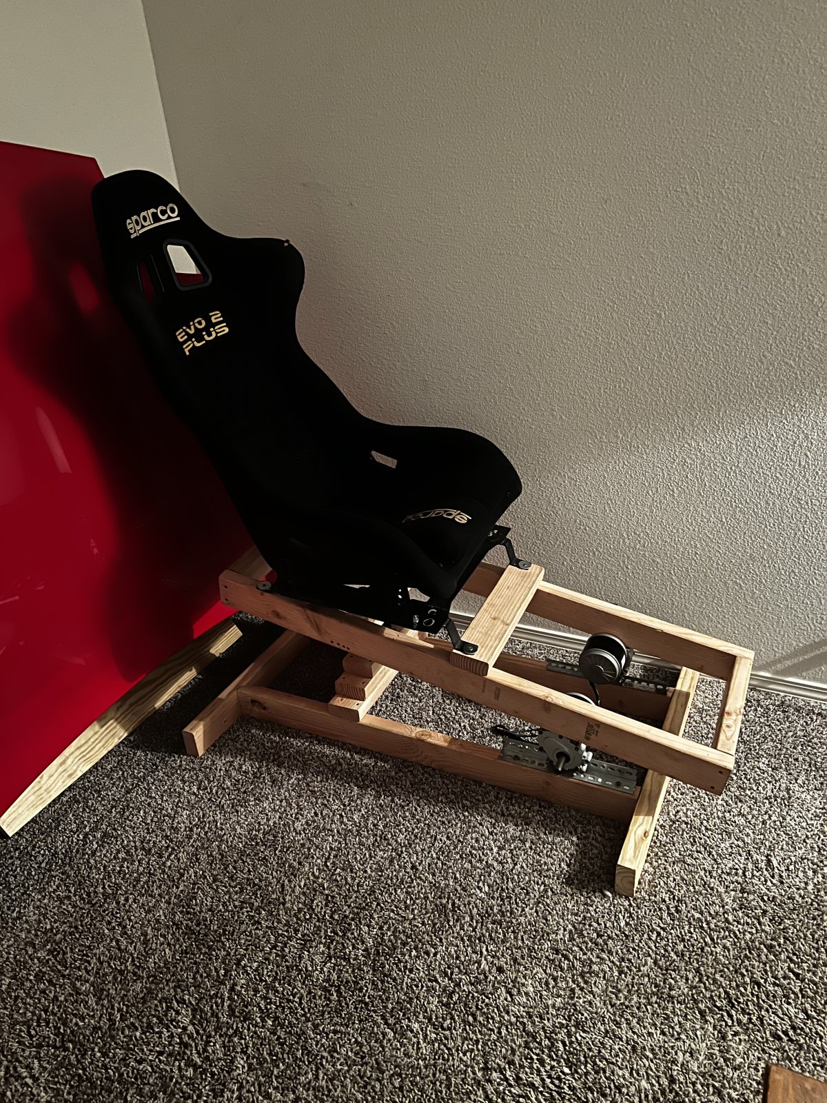

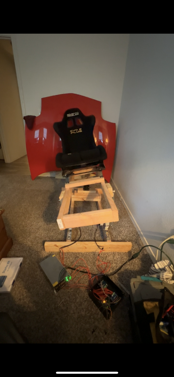

    just got everything done. hooked it up to SMC3 and got movement! but now my problem is the motors are spinning freely, even when i shut down SMC3. is this a pot sensor issue?
    21,142
    148,547Coins
    +10,902 / 54 / -2
    The pot provides positional feedback. I presume it is connected to the motor and correctly wired but want to confirm that is indeed correct?

    Got it moving around. Got in it, and it’s a little unbalanced. Make sure y’all don’t make the center of gravity too high!

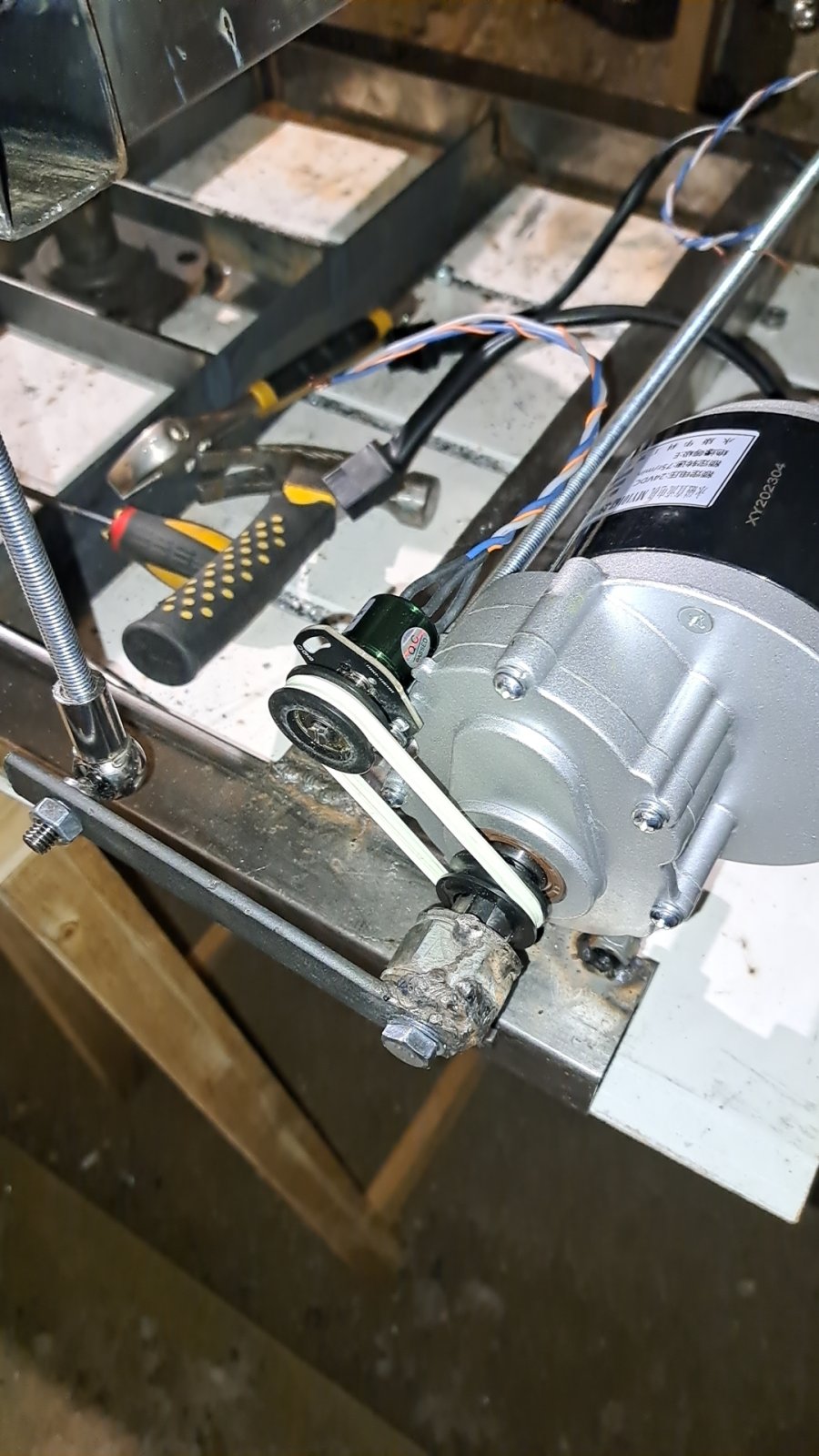

    Nice to hear! I have no idea about technically calibrating the pot.meters to be more sensitive. I can only imagine some sort of gearing, like bicycle sprocket sizes. This ofcourse depend on how you mounted it.
    I have a 1:1 ratio. Hope it works out. The shaft from the motor will only operate in half a revolution on my build so I hope the pots are sensitive enough for this.
    Postet a photo of my current assambely for some clearification :)

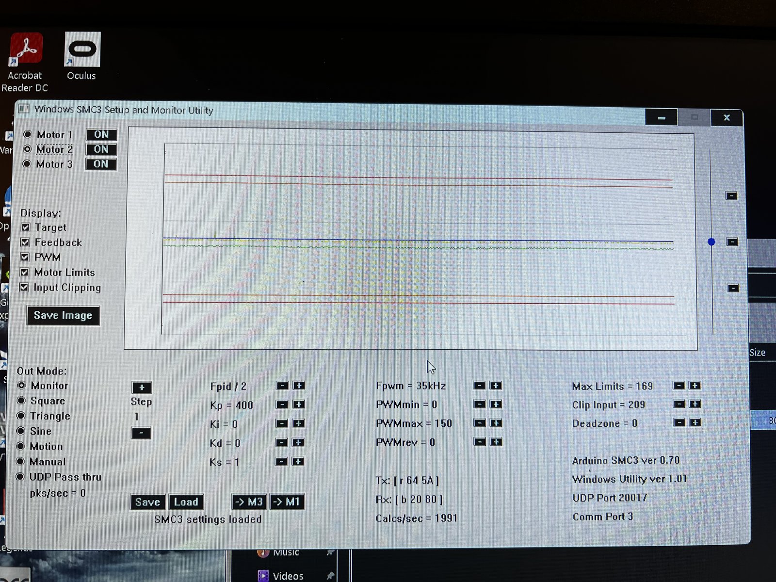

    had some time today to mess with the rig. got it moving around with smc3, and was just tweaking with it to get it smooth. after some trial and error, i got it smooth enough to where i wanted to hop in it and see how it felt. well for some reason when i put my weight on the motors they act like they can not support my weight. they drop all the way to max limit bottom and shuts the motor off. after a couple of tries i managed to snap a tie rod because the extra movement broke the pot mount, resulting in endless spinning of the motor.. face palm.. anyone else have any issue like this? ill post a picture of my SMC3 settings right below this.
  12. xFFBx Tearier
    xFFBx Tearier ffb Tearier
    Nov 30, 2023
    20
    122Coins
  13. noorbeast
    21,142
    148,547Coins
    +10,902 / 54 / -2
    How long is the CTC distance on the leaver?
