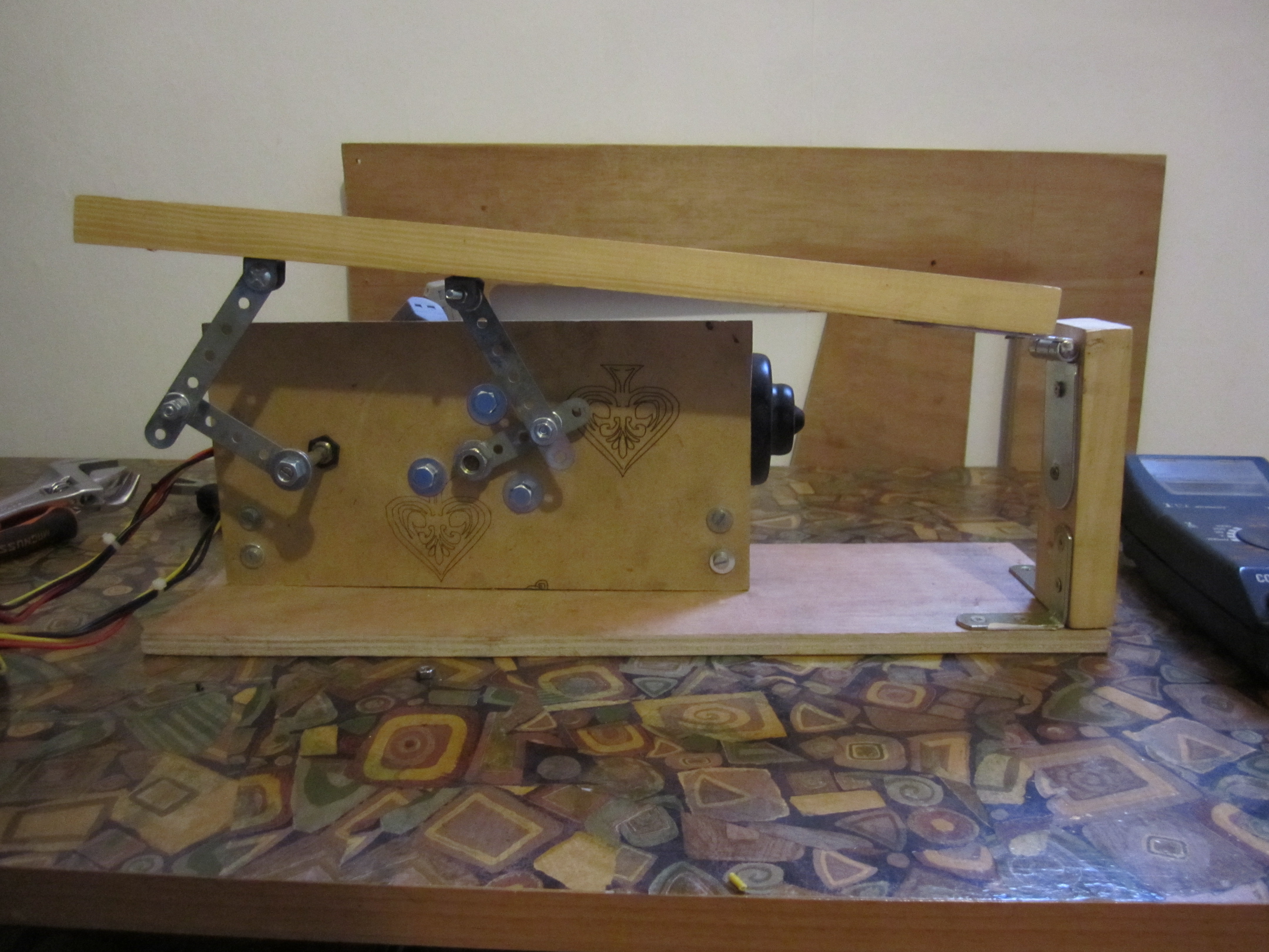

    Hello everybody,

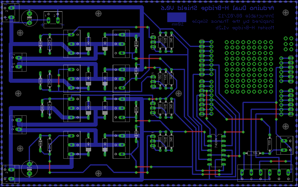

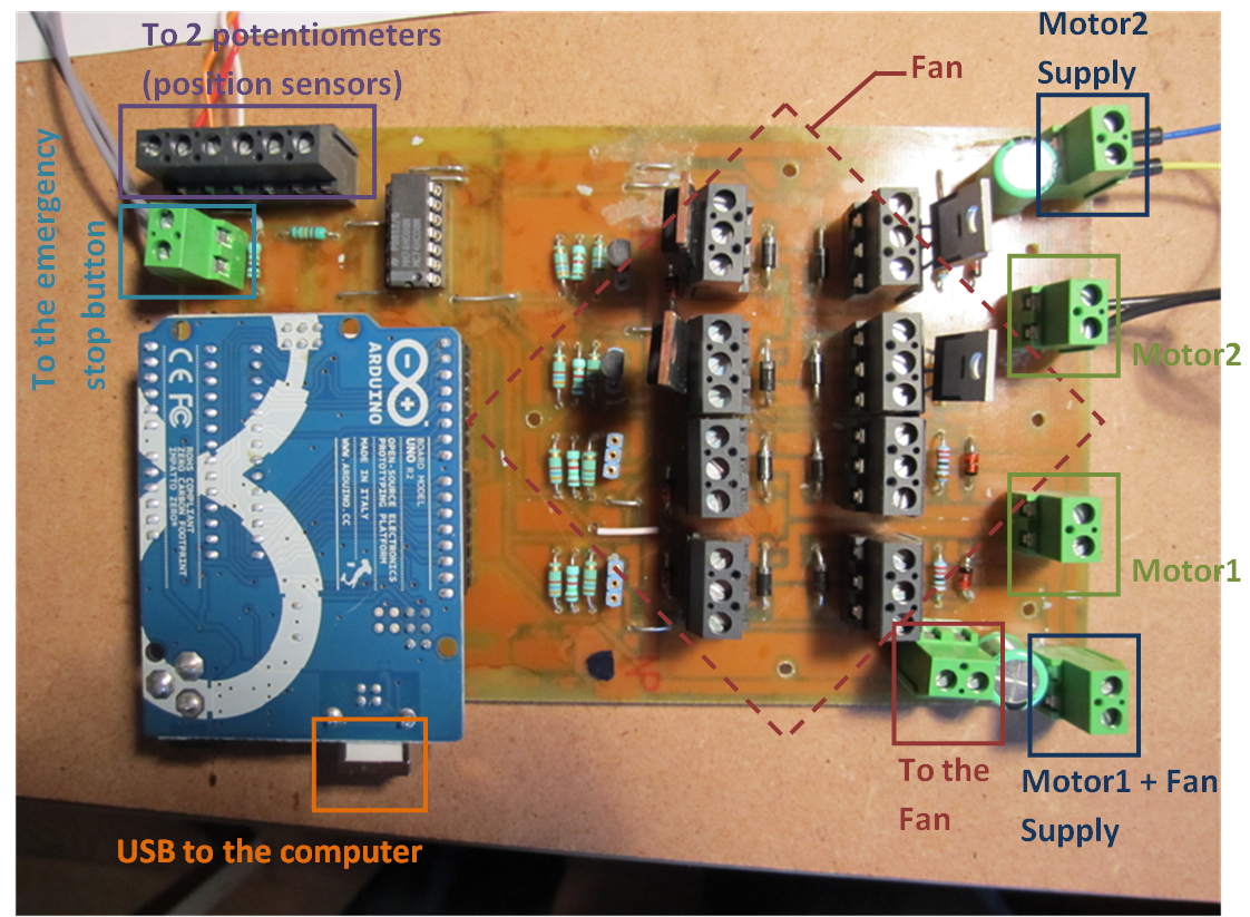

    I am pleased to show you my 2DOF Joyrider controller using an Arduino interface.
    This controller has an integrated H-Bridge based from the Thanos (Tronicgr) Dual Mosfet H-Bridge (all credit goes to him :clap: ).
    This controller is composed of :
    -An Arduino Uno to communicate with the computer
    -2 plugs (ground,signal, +5V) for position sensors (10K potentiometers)
    -1 plugs for an emergency button (using the interrupt pin (pin 2) of the Ardunio
    -2 H-Bridges to supply the two axis motors
    Here is a video where I am testing the controller by rotating in 2 different ways
    http://www.youtube.com/watch?v=vIm0q84zlrg
    Here is a video where I am testing the controller with a potentiometer (acting as a speed regulator) and the emergency button.
    http://www.youtube.com/watch?v=yF9FLZGv9No
    Hope you like it, I try to give you the circuit model asap, feel free to ask questions.
    Cheers

    Hi

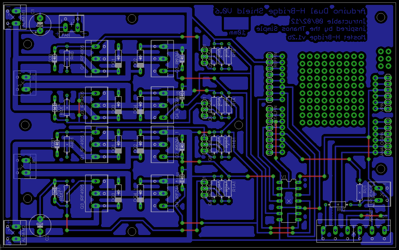

    I updated the post : I added the mask and the components map.
    to daymoney13 :
    I haven't yet a code with a PID because I am making the setup with a wiper motor, once done I will start to code.
    The controller works like a standard h-bridge; you have 3 pins to control a motor (2 for the direction A and B, 1 for the speed called PWM).
    The Motor 1 is controlled by the pins : A = pin 3, B = pin 4, PWM = 5
    The Motor 2 is controlled by the pins : A = pin 8, B = pin 9, PWM = 10
    To use it you could code a class like that :
    (code not tested and could be faster by using direct bus control, but anyway...)
    Code:

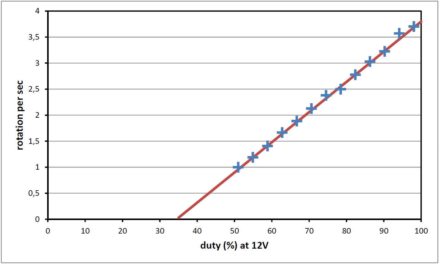

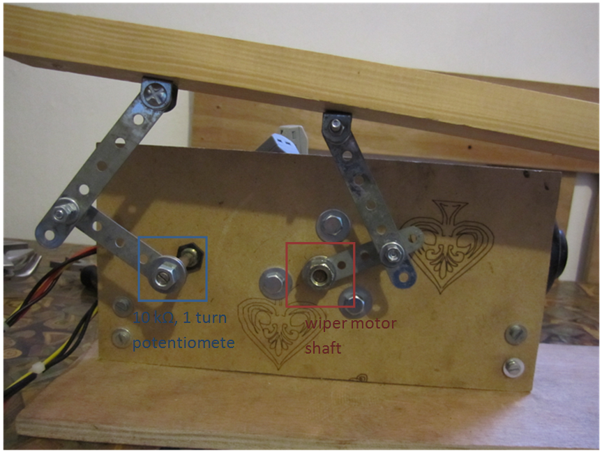

    Hello everybody,
    I just post a new video of my wiper-testing-machine.
    http://www.youtube.com/watch?v=qDH5WK3ajzQ
    Here you can see the rotation speed versus the duty of the PWM.

    Just a new video of my testing machine using Flight Simulator + XSim.
    http://www.youtube.com/watch?v=MZLgtIKqRMI
    This video shows my controller using a servo loop. As the movements are quite slow I just code a P regulator (instead of a PID).
    Soon I will add the source code.

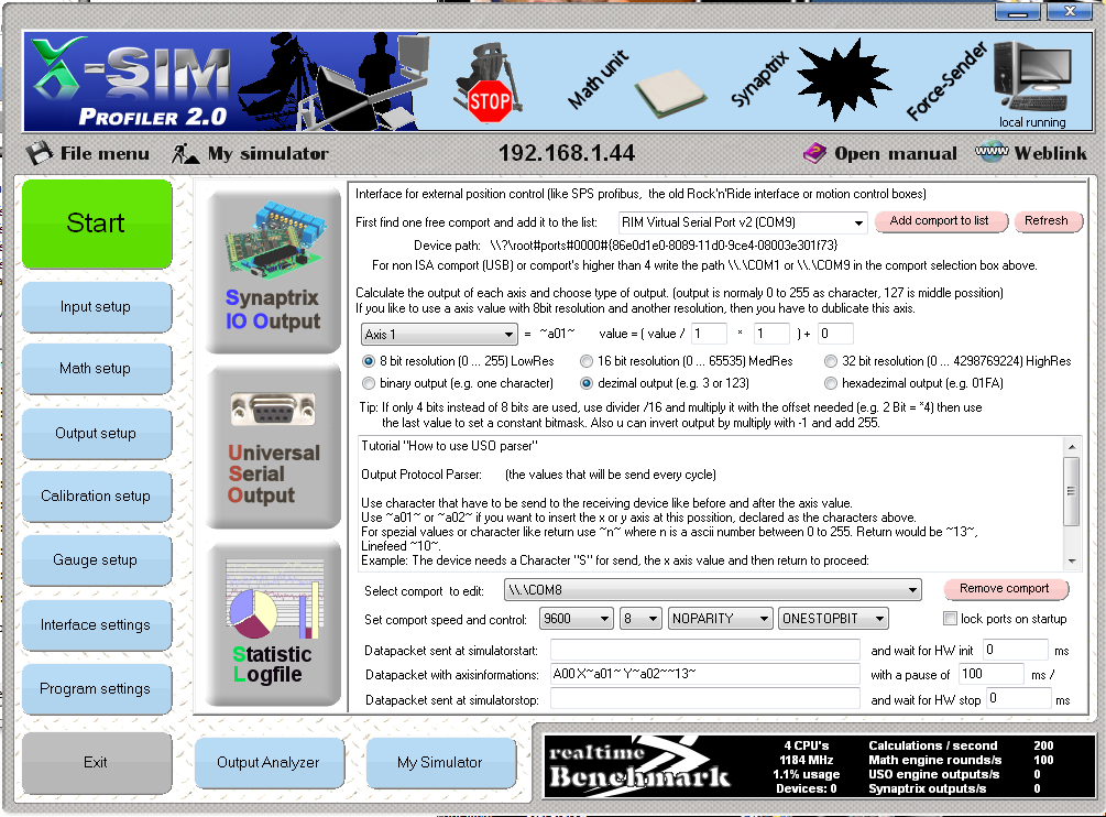

    hey instructable can you post a tutorial on how to test your code ? I uploaded it to my arduino but now im stuck with the x sim software.
    thanks :)
  14. intructable
    intructable New Member
    Sep 16, 2011
    10
    14Coins
    hi daymoney,
    To try my code you have to start X-Sim Profiler and X-Sim Sender (I recommend you to launch the Testplugin instead of a real game).
    On the Math Setup add a new axis (or two if you have 2 degrees of freedom), you can check on Input which slot you can choose.
    Then go to Output Setup, USO, then add the com address of your Arduino (for me com 8 )
    Fill the line Datapacket with axisinformations: with A00 X~a01~~~13~
    (or for a 2dof :A00 X~a01~ Y~a02~~13~)
    Set the options as shown on this picture
    Then press start.
    I also recommend you to install VSPE, a program which allows you to create a virtual port.
    You can then connect X-Sim to this port (while connected to your Arduino).
    You can then check the commands sent by X-Sim by using the hyperterminal. (or Tera Term if you are on Win Seven).
    I hope it help you, fill free to ask more precision.

    hello thks for the list but where i use de R680ohm?????? You can get a picture with the sites of the components to be easier to solder the components. the image that has only the component type is not what amount. and now already not find resistances of 3.6K, only 3.3k / 3.9K whatDo you recommend ?
    thank you and hug
  16. intructable
    Sep 16, 2011
    10
    14Coins
    hello timothy,
    thanks for this post, actually I did not erase the 680ohm on the thanos component list, you won't need it for the controller.
    I added a new picture with the resistor value, tell me if you need more informations.
    For the 3.3K/3.9K, I not enough skilled to tell you what is the best solution. I recommend you to ask directly thanos.
    If your provider can sell you 3.3k and a 300ohm resistor, you can use them in a serial way to get the good resistor value (this wouldn't be the most beautiful solution but a least it works perfectly)

    Hi intructable,
    Very god job. I'm building my simulator, following your instructions. Did you finish the code for arduino?, I tried to complete to work with 2 motors, but no luck, there is much noise in the second engine and does not move as it should.
    Thanks!
  18. intructable
    Sep 16, 2011
    10
    14Coins
    Hi astro,
    Nice to see that you are building the controller.
    I have not worked on the arduino code since my friend started to build the seat. What would you like to add to the former arduino code?
    To help you I will need more information :
    Did you first try to swap the two motors to see if you get the same response with the other one?
    What do you mean by does not move as it should?
    Does the noise sound like a typical frequency or more or less like switching on and off rapidly?
    Cheers
  19. astro
    astro New Member
    Jun 6, 2012
    16
    Argentina
    25Coins
    Hi intructable,
    I try to explain better.
    In your code, you start program for two motors, but at the end, is for one.
    There are no commands for the second motor.
    Like:
    Motor motor2(M2PWM,M2A,M2B);
    motor2.stopper();
    The reading of the Y part.
    So I try to complete. I don't understand PID, I am new in arduino so I'm sure I'm doing something wrong.
    I think there is a problem when I use commands to see the variables in the monitor using VSPE, like:
    Serial.print(pot1=);
    Serial.print(pot1);
    I think that is interfering in some way.
    This is the code:

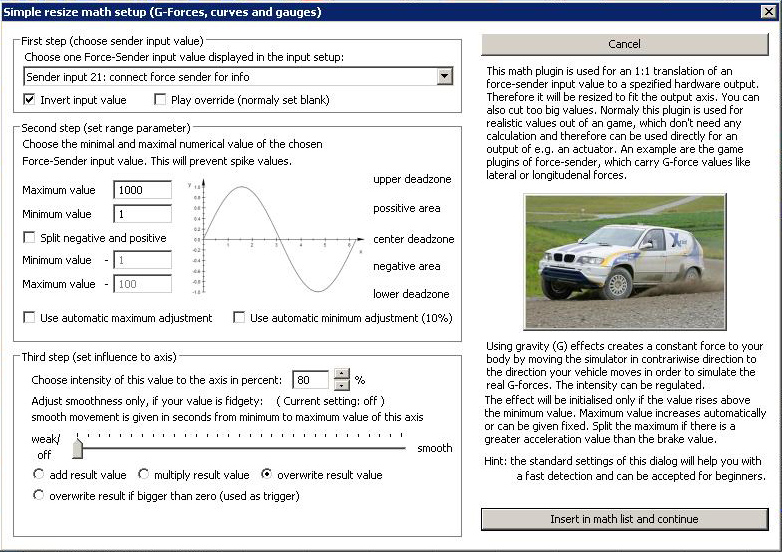

    The noise in the second motor is like high frequency and does not move.
    I change all de components to the other side of H-bridge, to see if something is burn, but nothing change, everything seems to be ok.
    I 'm using TestPlugin.
    Can you post your screen Simple resize math setup?
    This is what I have:
    Can you test your motor in the other conector to see if working?
    Sorry for my english. :(
    Thanks!!!!
