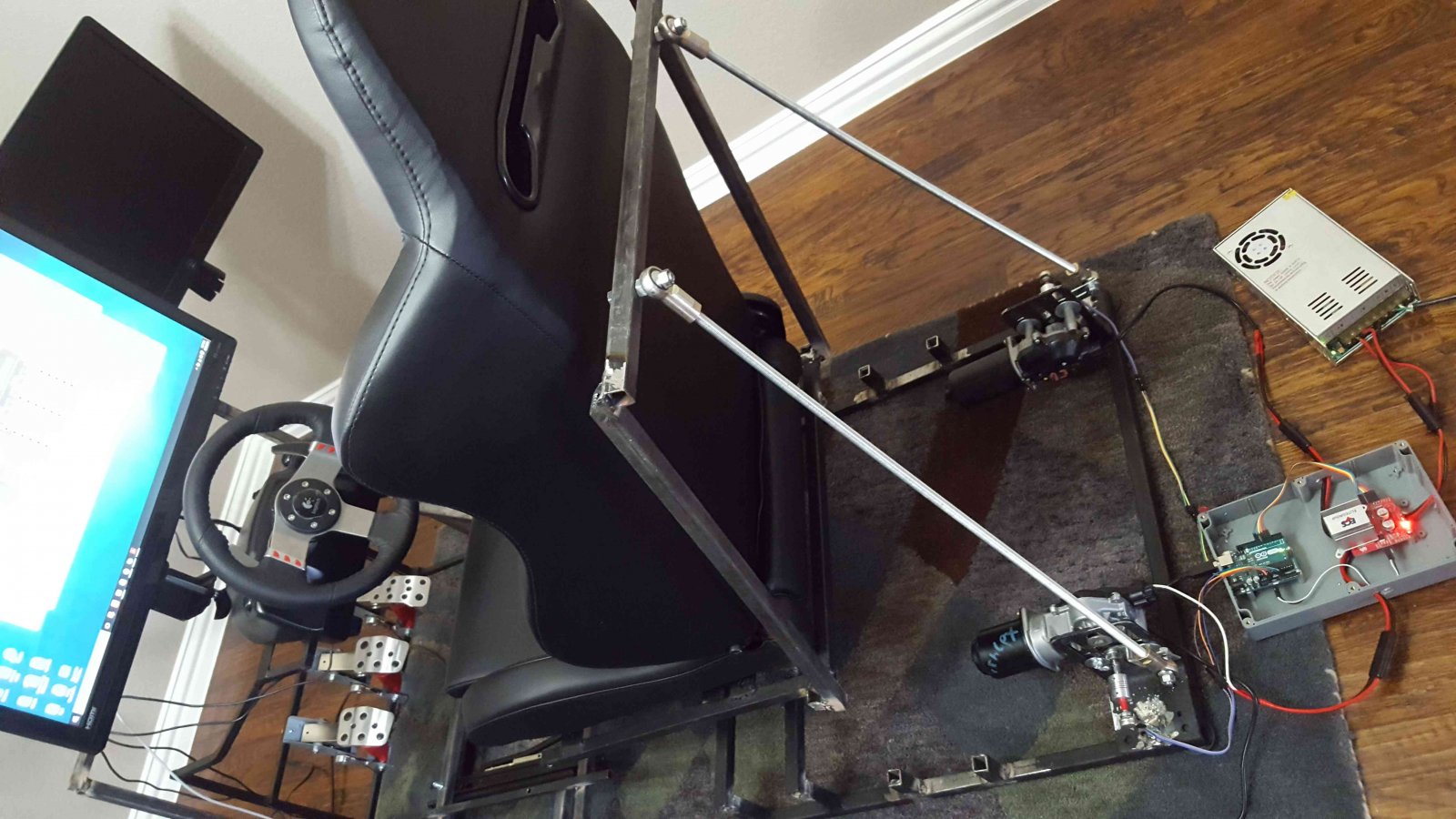

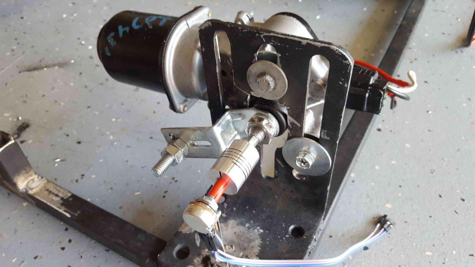

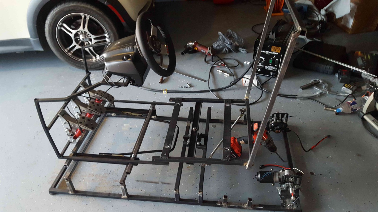

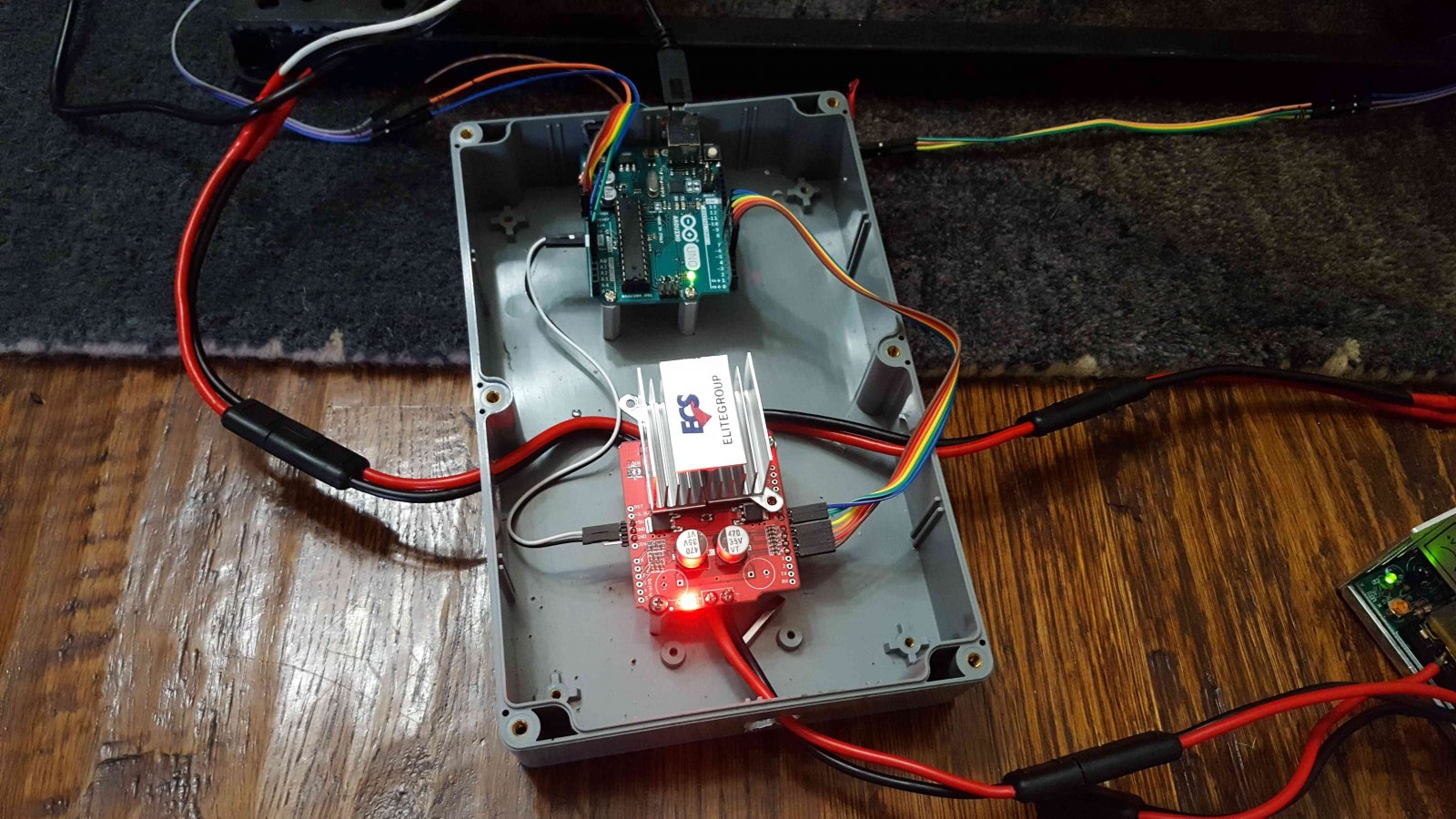

    On Going Project .
    2 Wiper Motor
    1 Moto Monster Shield ( Change 1 per motor soon)
    1 Arduino Uno R3
    3 Monitor
    Logitech G27
    Running Simtools with RacingMat code
    Any suggestion would be great .. Thanks

    What do you use as universal joint ? It seems a little bit light..

    Looking good. What are the extra square tubes behind the seat
  4. toanhung
    toanhung New Member
    Jul 12, 2012
    17
    - 16Coins
    It actually a ball joint for the lower front lower suspension from a car .
    Those extra where original chair was. but i move toward the front so i can have some angle for shoulder mount. was at bottom seat but i changed

    Ball joint? Is it able to twist? Hope not.
    21,159
    148,640Coins
    +10,913 / 54 / -2
    It has a panhard style bar so I am guessing it does.
  8. toanhung
    toanhung New Member
    Jul 12, 2012
    17
    - 16Coins
    Yes it does twist, I put a bar so prevented, but might change to u joint , if something doesn't work right .

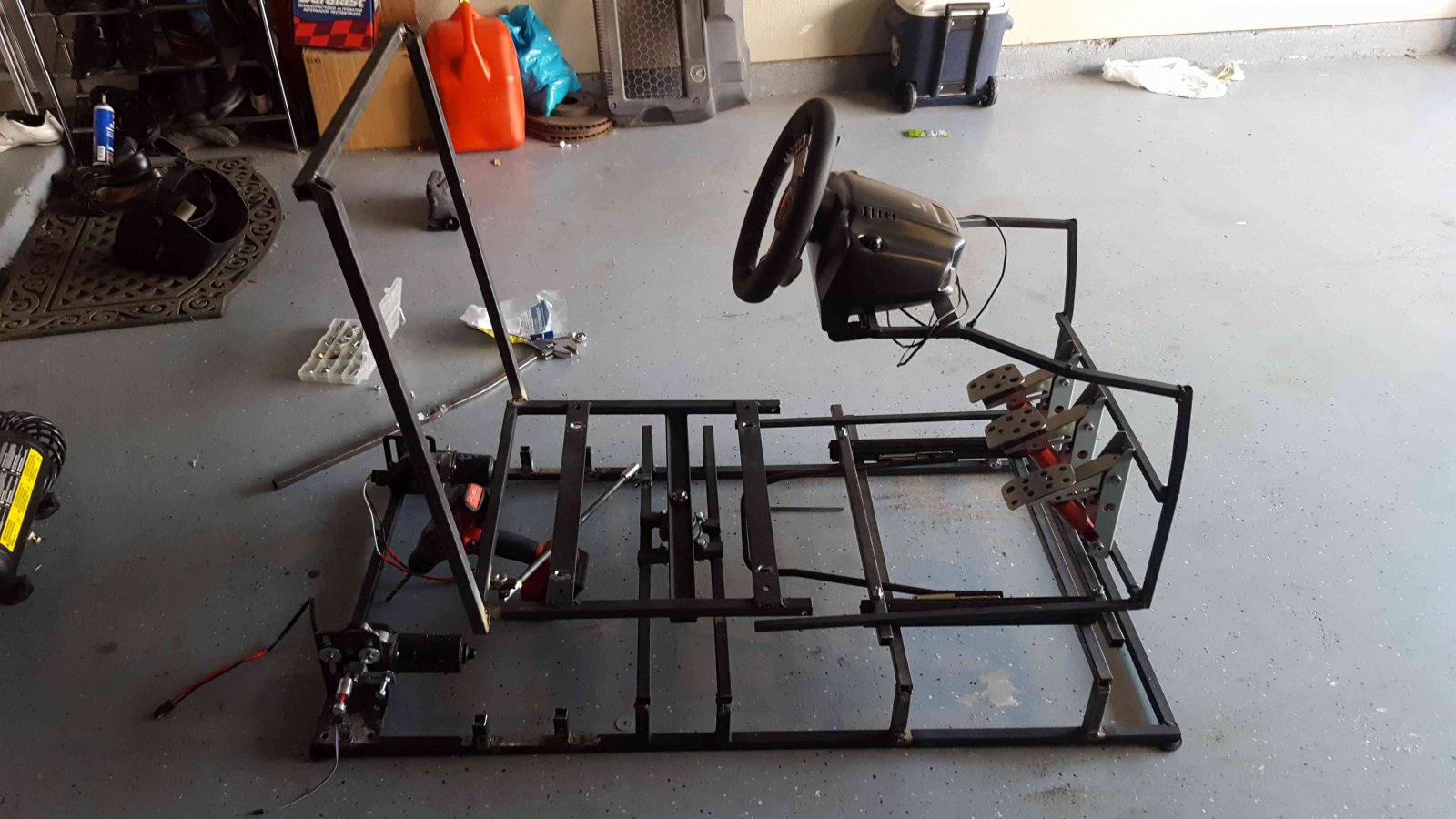

  9. toanhung
    toanhung New Member
    Jul 12, 2012
    17

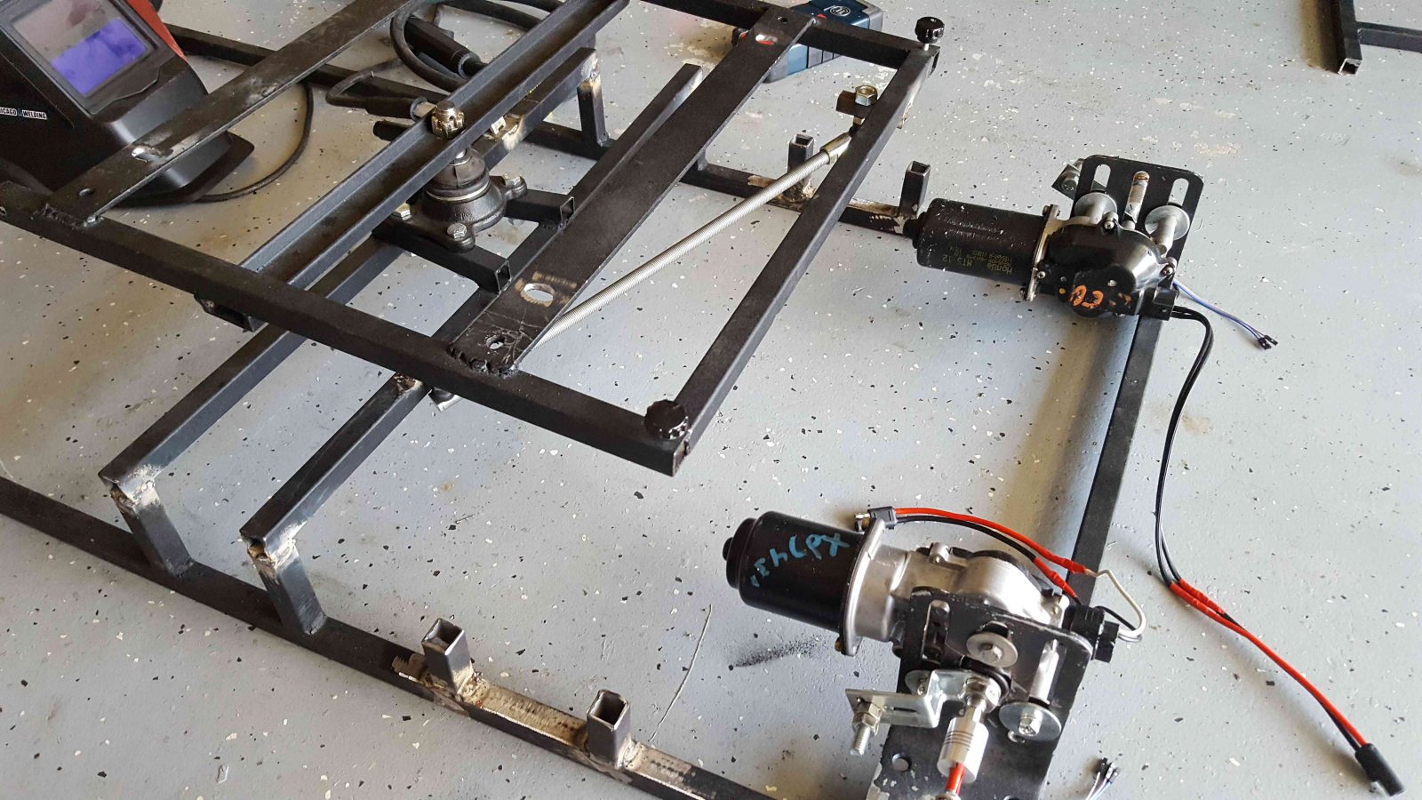

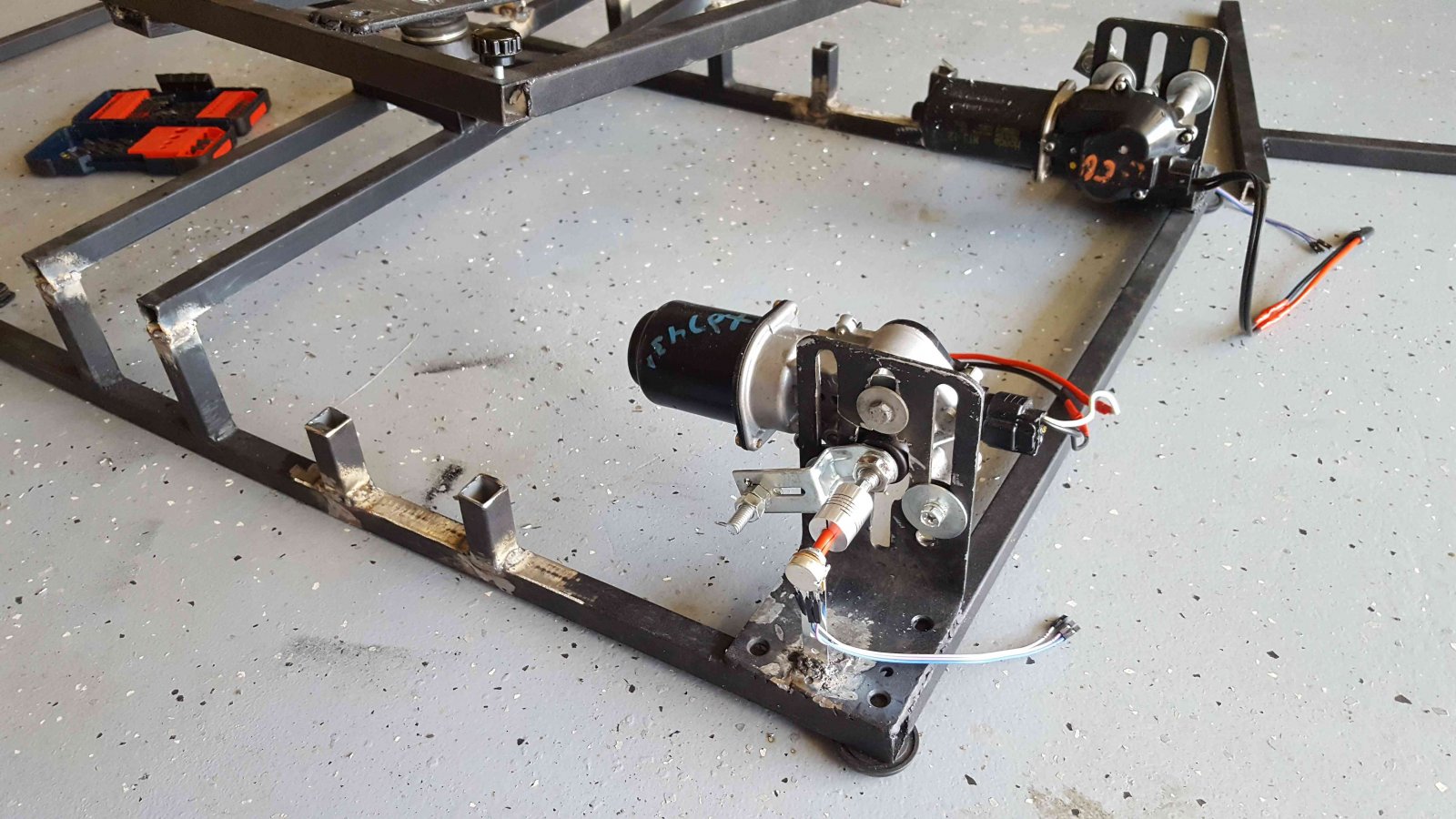

    - 16Coins
    So far moving slowly but sure do move.

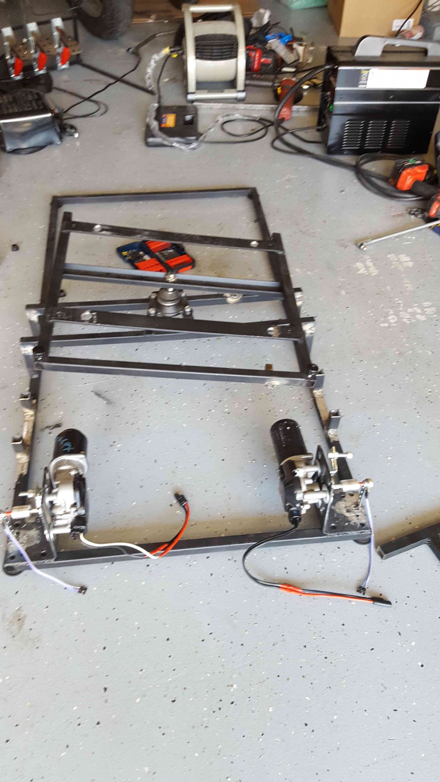

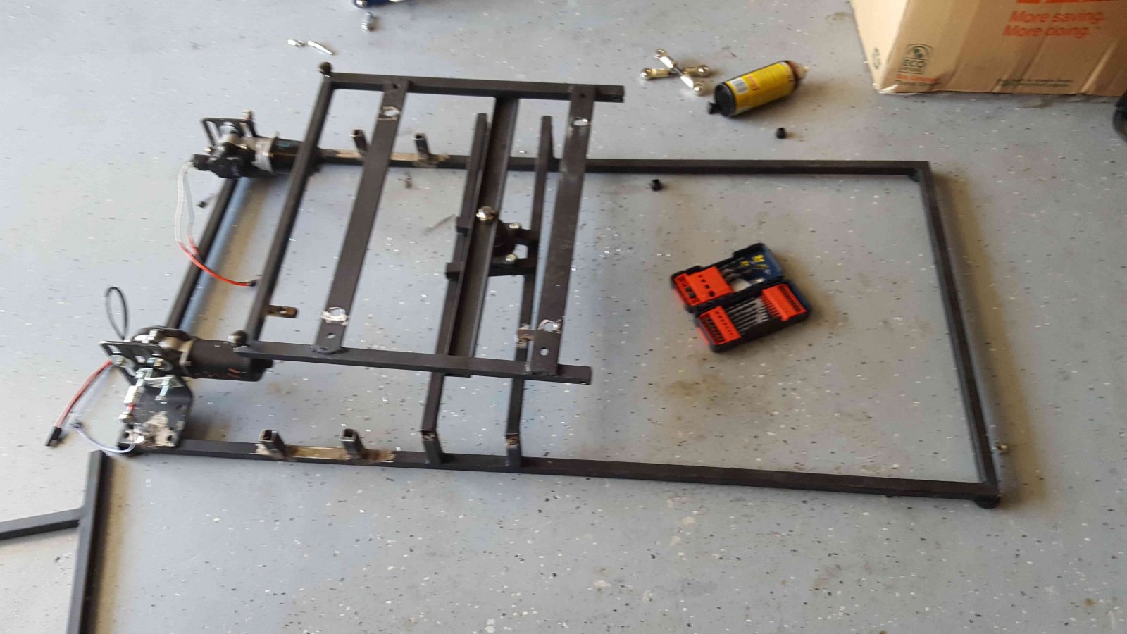

  10. toanhung
    toanhung New Member
    Jul 12, 2012
    17
    - 16Coins
    More progress today , still more to do.

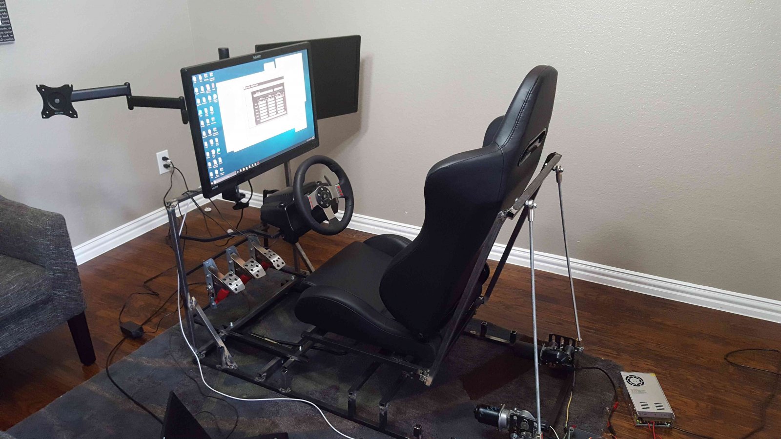

    Is there any easy solution for adjustable steering wheel height ? thanks
    Currently pedal are sitting on slider. but now i need to make for steering too ..

    if you have two sizes of square tubing i just drill a hole and weld a nut onto the bigger size then the smaller size slides through and locks down with the bolt through the welded nut.
    1.25" and 1" works well as does 1.25" and 1.5"
    if it doesn't make sense i can take some closer pictures of my rig to show you

    Thanks @noorbeast and @PiaMan , gotta find tube that are .25 bigger, local hardware store dont store that kinda size only .50 bigger.

    17
    - 16Coins
    On adruino can we define a finer motion? for example
    if (gap>50) pwm=215
    can i define more value between would that help on motion or that the only 3 speed it would go ? thanks
  18. insanegr
    insanegr !N$@n€
    Jan 14, 2014
    504
    Athens
    16,718Coins
    +499 / 1 / -0
  19. toanhung
    toanhung New Member
    Jul 12, 2012
    17
    - 16Coins
    Thanks @insanegr , that exactly what i need.
