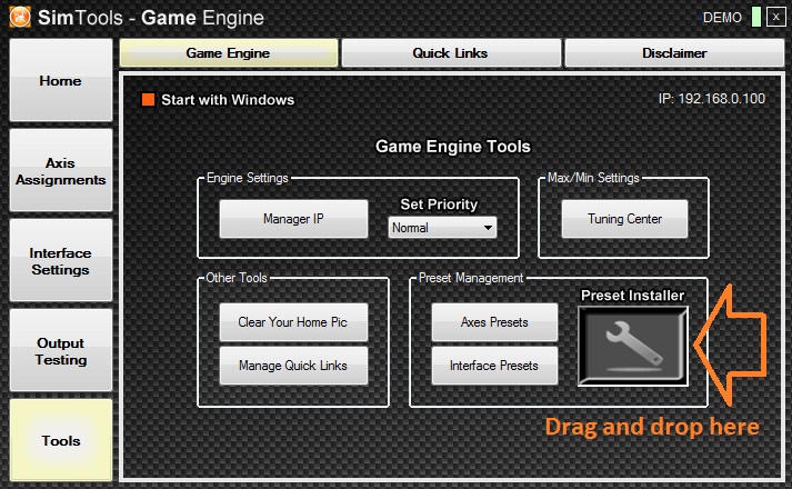

    If you are using my code for Arduino and Sabertooth, you can use this config file.
    You just need to unzip the file and drag and drop in Tools of Game Engine !
    Please do not forget to set your right Com port :rolleyes:

    SimTools v2.0 Wanegain_InterfaceConfig ... UPDATED .
    just extract the zipped file and drag and drop it to the preset installer ...

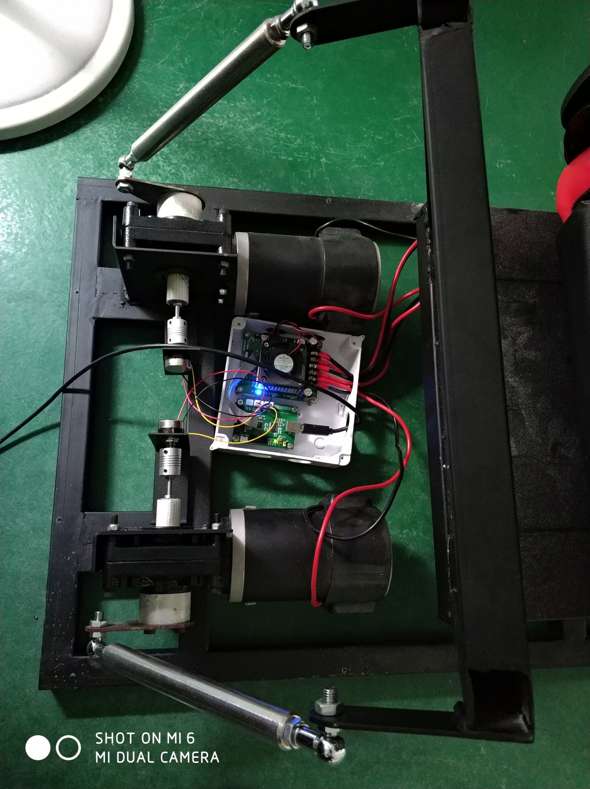

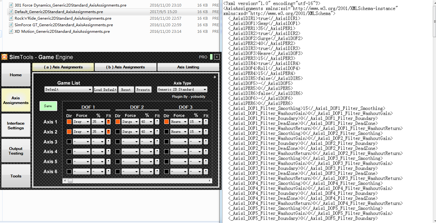

    2DOF, DC motor, SCN6, Arduino, Joyrider, Motion platform, 4DOF, 6DOF
    I have a question: I use this InterfaceConfig and my Com port is right, but my emulator isn't moving, what's wrong?If it is convenient, please give me an AxisAssignments configuration file, thank you!

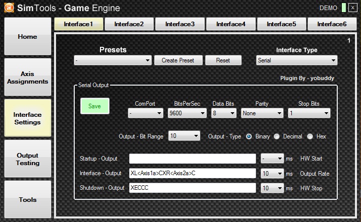

    Can you please show your Interface Settings in Simtools ?
    What is the version of your Sabertooth ?
