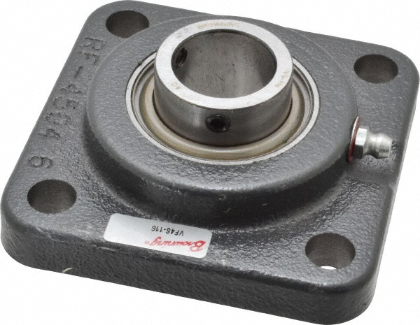

    @noorbeast, I agree, adding another couple of cm in addition to 500x500mm would not make a whole lot of difference if it means an easier built. I like your design a lot, I would consider changing a couple of things. First, for rift I am thinking of mounting a chair to a pillow block bearing similar to this:
    I also would like to come up with a solution of not having to adjust a position of the mounting post when changing between flight and race sim. I am thinking something similar to adjusting a seat position in a real car, as opposed to re-mounting the seat and adjusting the u-joint support position at the same time. Or maybe using controls that are not so much different in weight. Not sure if this is an option, I wouldn't want to use something that is inferior to your setup.

    Hi. Just my 2cents worth. If that pillow block twists (most do), then it will not be suitable for mounting a chair.

    could you explain why not? according to the spec loading capacity is several thousand pounds. This would be sitting on top of the universal joint and would only allow for the chair to turn around vertical axis. I will try to come up with the sketch.

    I thought you wanted to use this bearing instead of a universal joint. I do not understand why you need this? A good quality uni joint (recommend one from a car drive shaft) is all you need. For this type of Sim, the chair should not be able to twist in any way.

    i thought that drift is simulated by rotating a chair around a vertical axis?

    Not exactly, traction loss moves the whole frame of the seat mover, normally via rollers at the back and a bearing up the front. Recommend you have a look at some of the designs already detailed on this site, before proceeding further with your design. It will save you allot of time\frustration\money.

    @SeatTime is right and the pivot point would be a little in front of your feet. You can use the bearing you have but best to sketch and post an initial design so others know what you have in mind and can advise accordingly as to what will and will not work.
