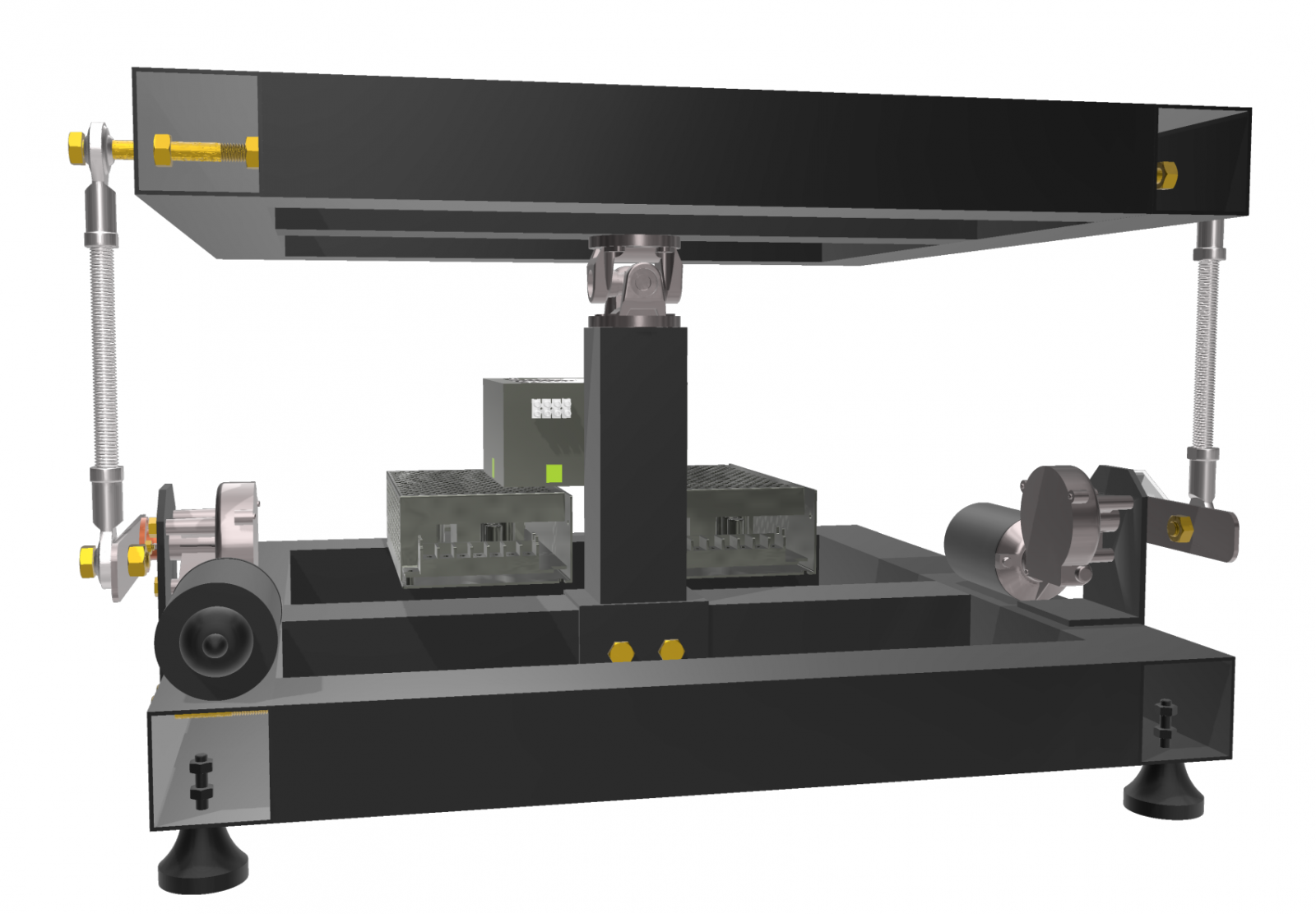

    Hello everybody. It's my turn to do my 2DOF Motion Simulator project.
    After reading and seeing many topics in this Forum, observing the challenges, facilities and difficulties, I showed the project to my cousin and we took courage to start.
    In a very brief presentation, we are both Engineers, one Civil and the other from Telecommunication and we live in Brazil. In this way I will translate it into English, so I ask for understanding with some errors, but in the end I will also leave the description in Portuguese BR.
    The initial Budget is to spend around $300 USD (R$1500.00) on everything needed to make the RIG Motion.
    We intend to also put support for Pedals and Yoke/Wheel in this Rig.
    As I wrote Yoke, it is clear that the initial idea was to make the Rig to use with a flight simulator (FS2020), but we will use it with car simulators too, of course.
    At first, the project is to place a "chair" on the structure, but in parallel we are already adding support for the pedals and Yoke/Wheel and who knows a support for a small monitor in the last stage.
    The problem with the low Budget is to get a stronger engine here in Brazil, so that's why I left the last step of the screen support for the end.. see how the engines behave with more weight.
    The Rig will be compact (600x600mm) base if we count step 1, but still the idea is to have around +/- 20 degrees (40º) Pitch and Roll.

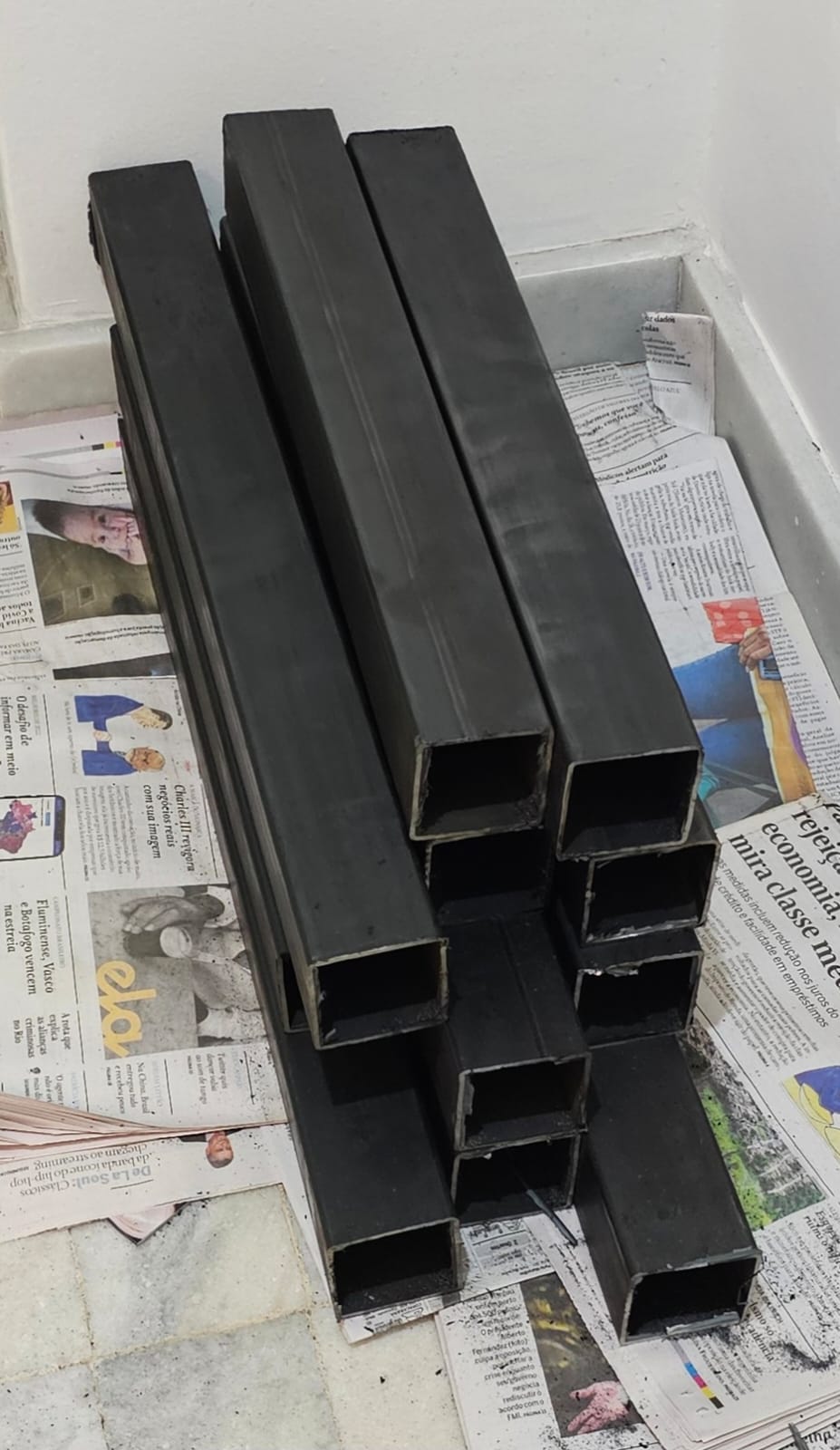

    Today the last purchased material arrived, the Metalon 60mm x 60mm x 2mm steel that we are going to use to make the Rig and so we start the project.
    Below is the full scale drawing:

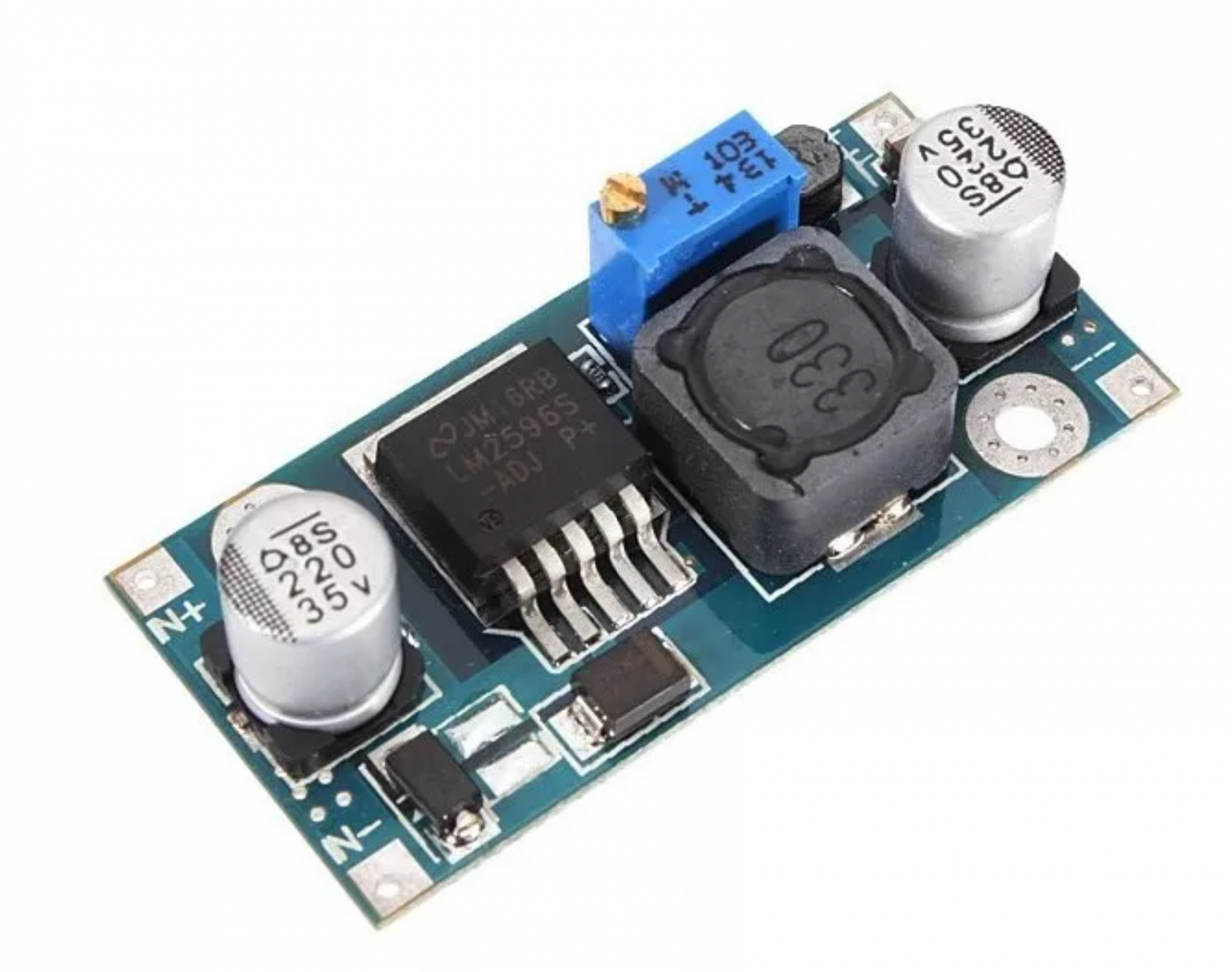

    The electronics are the same used in the vast majority of projects I've seen around here, but I added a DC-DC Step Down LM2596 voltage converter to connect a 12V fan, reducing to 6V to slow down and cool the Driver Motors. I will call this system Brain and talk more about it in detail in the next post:

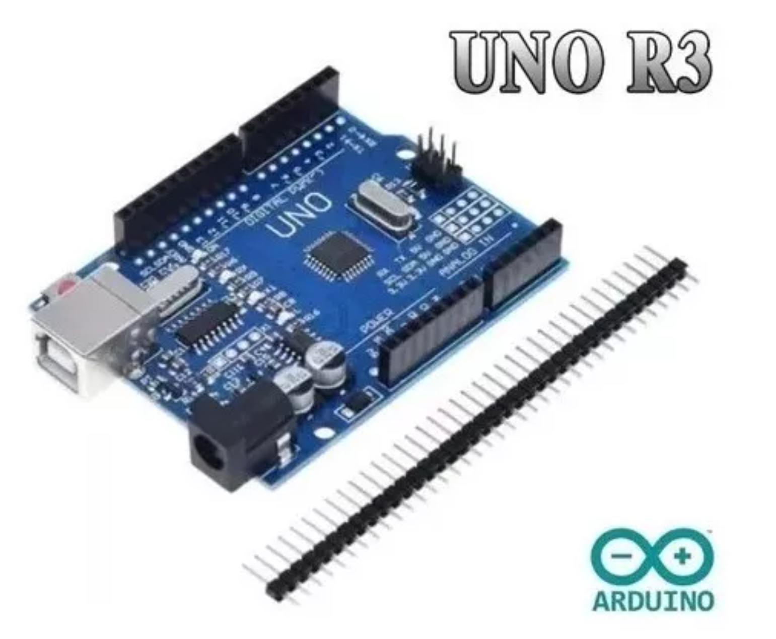

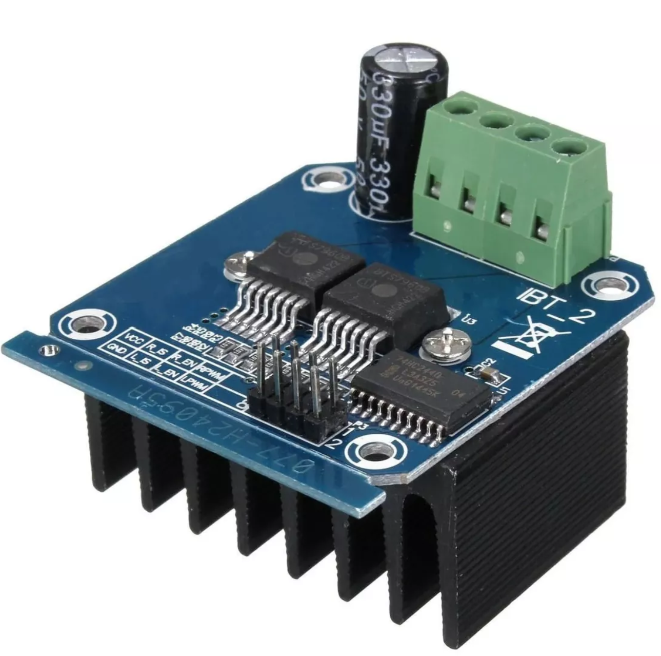

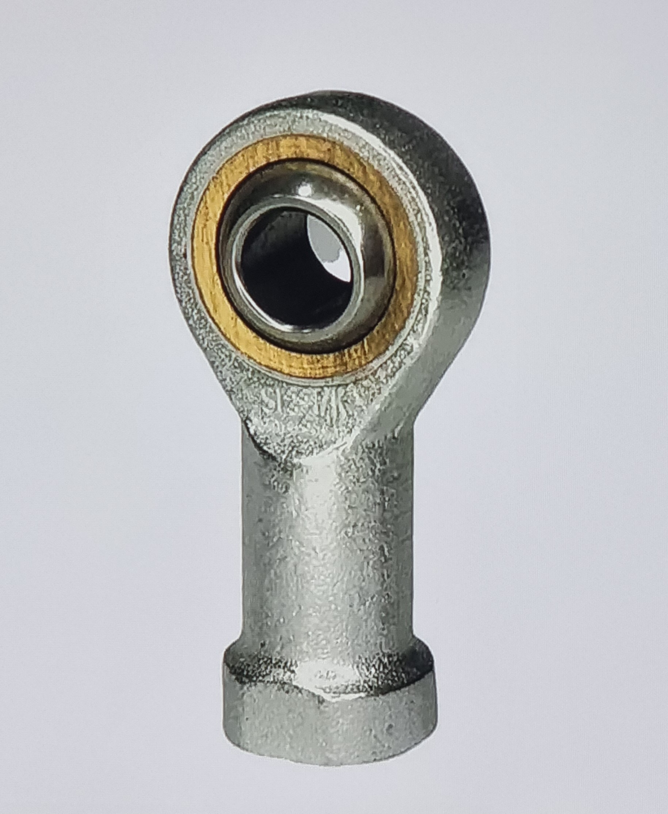

    4x Rod End M12

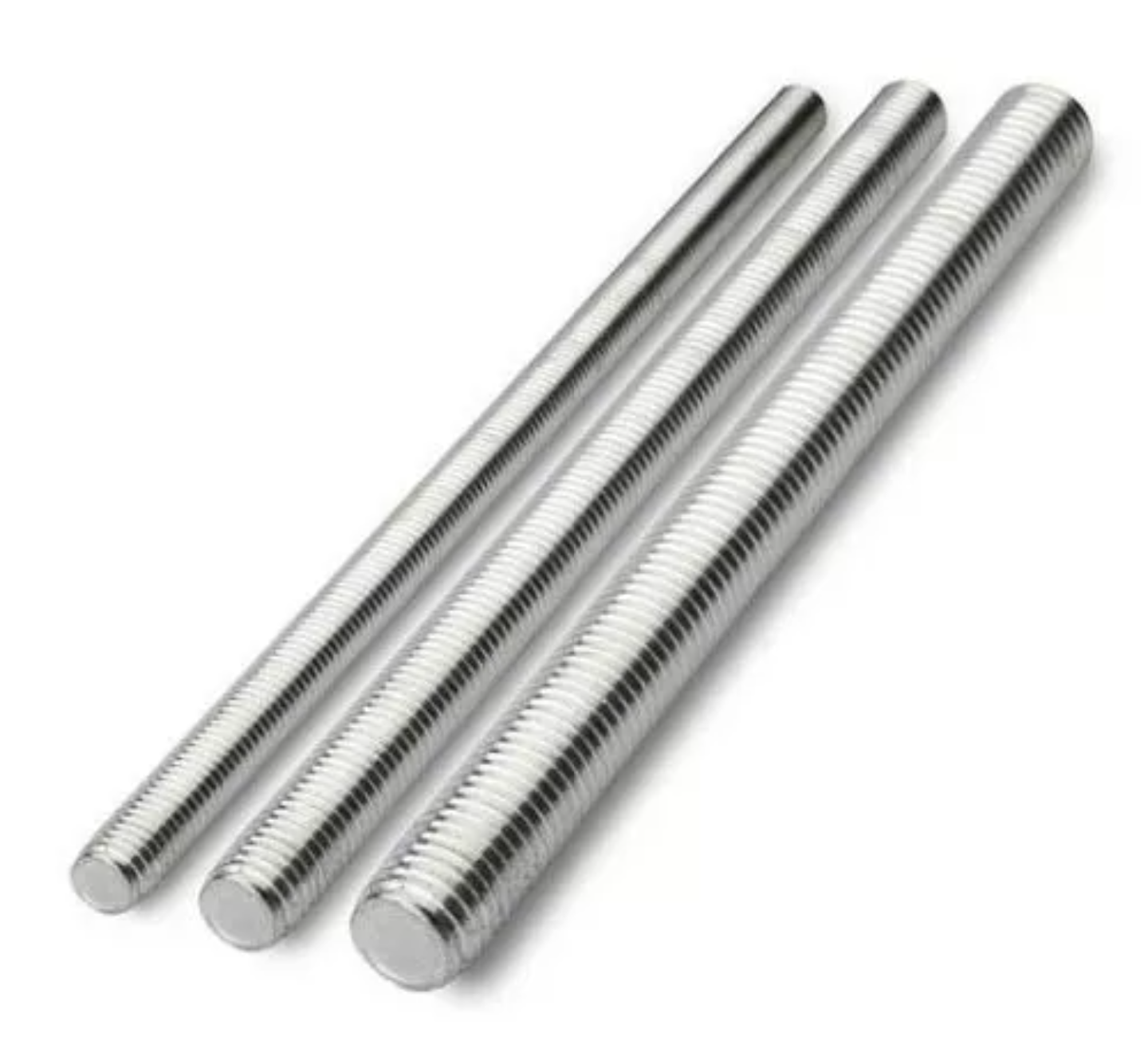

    1 threaded rod of 1 meter M12

    Metalon 6 meters measuring 60mm x 60mm x 2mm

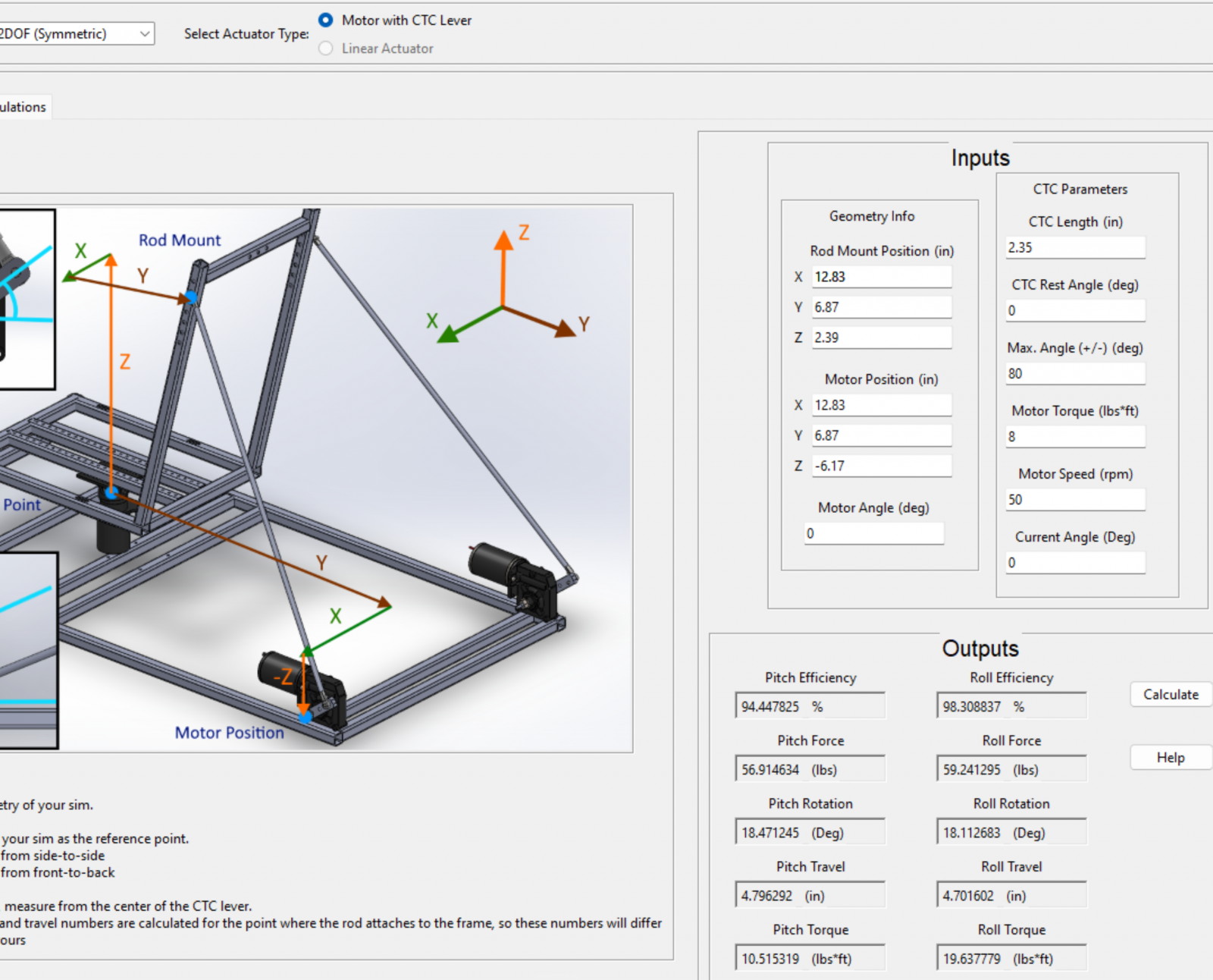

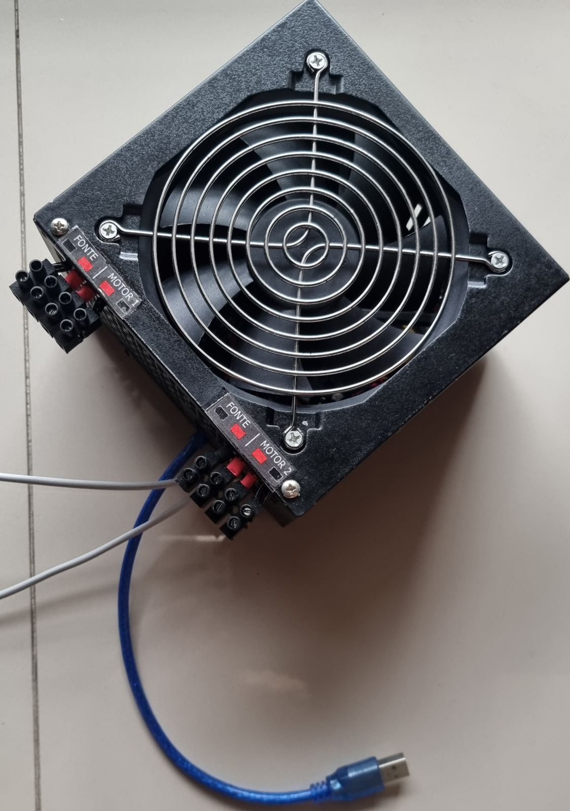

    Now I'm going to give details about the "Brain", electronics of our Rig Motion, but first I'll post the calculations made by SIMCALC.
    As stated earlier the intention is to get 20 degrees to both sides for PICTH and ROLL. By calculations we have more than 18 degrees, but I think there is still room to reach 20 degrees. An example is to increase the length of the CTC from 2.35in (5.97cm) to 2.60in (6.6cm) we have already achieved the goal. We will return to this topic later on, once we have completed the welding of the structure.

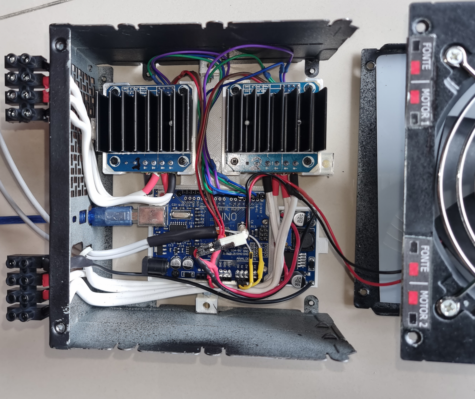

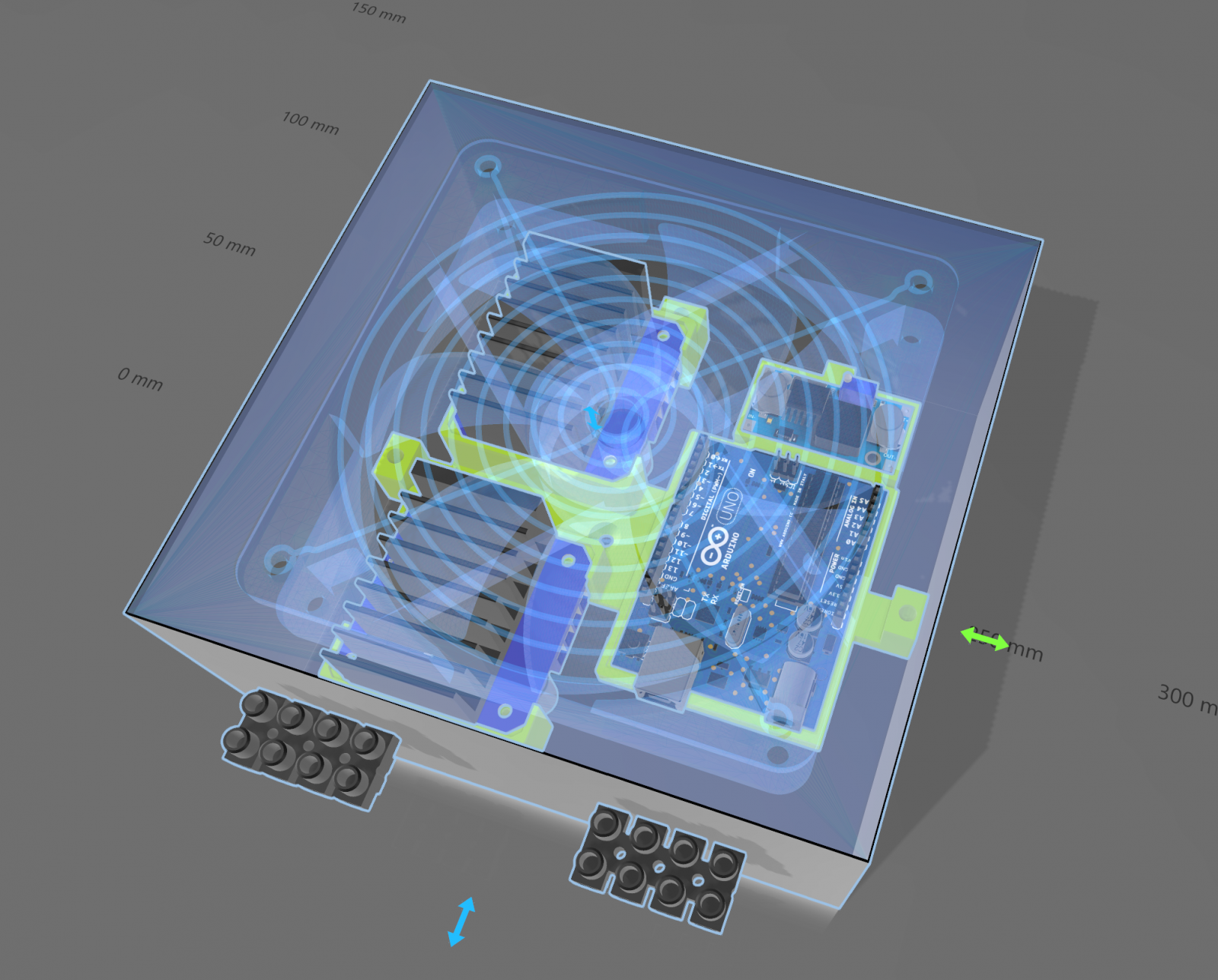

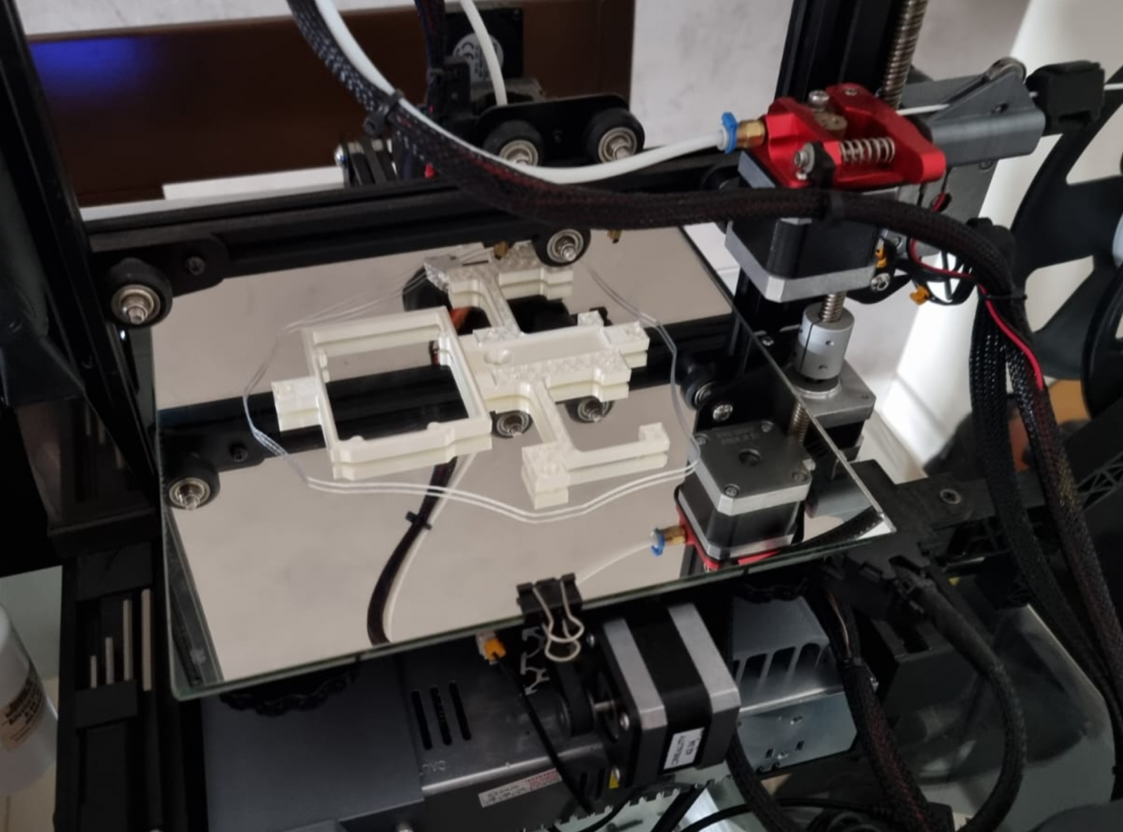

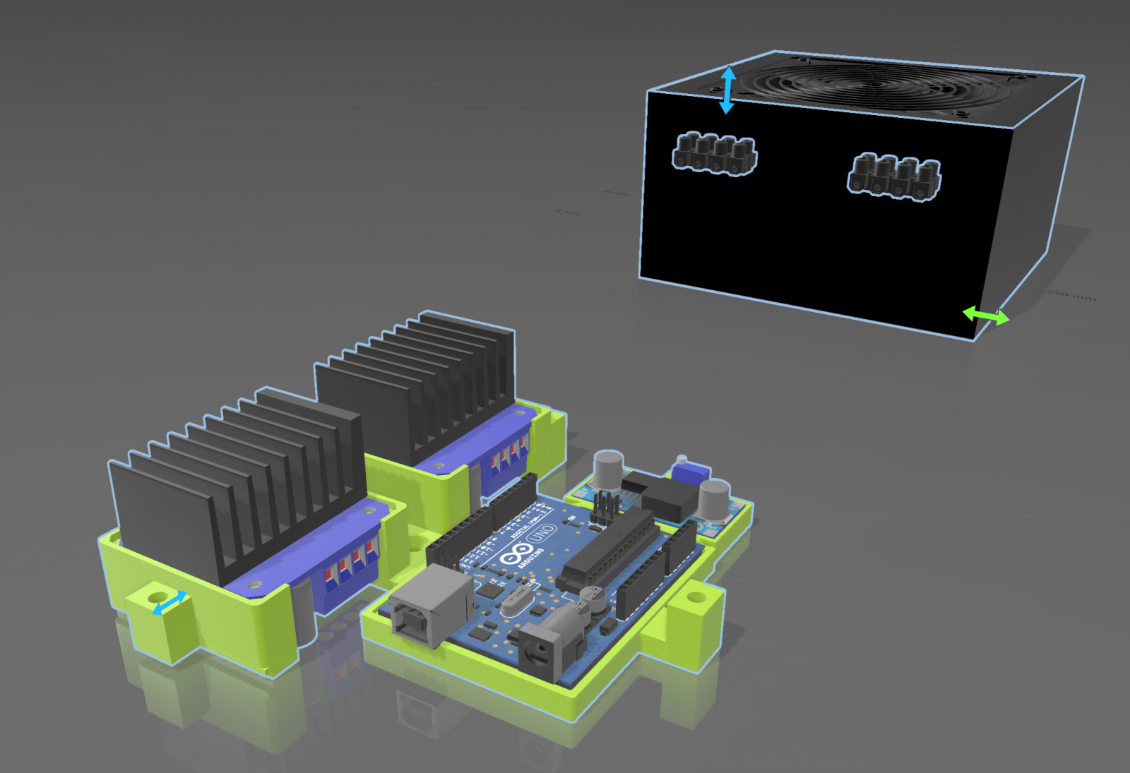

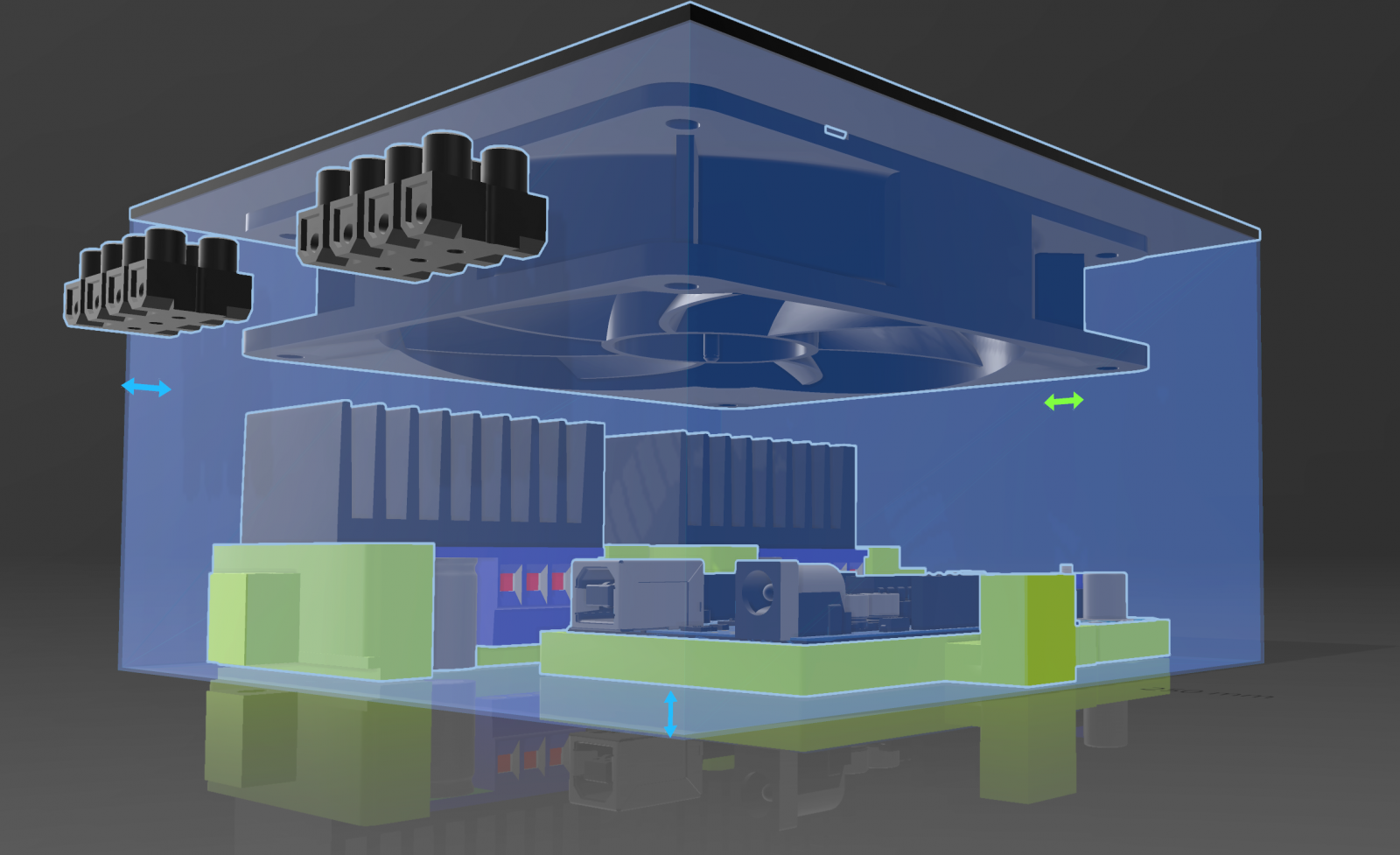

    Now talking about the "Brain" I'm going to use an old burnt PC Power Supply to put the Arduino board, 2x Driver Motor and the DC-DC Step Down converter inside. So we can use the Fan to cool the BTS4690.
    I produced a part on the 3D printer to join the electronics inside the old PC Power Supply. The piece made appears "painted" green in the images and was printed with White PLA:

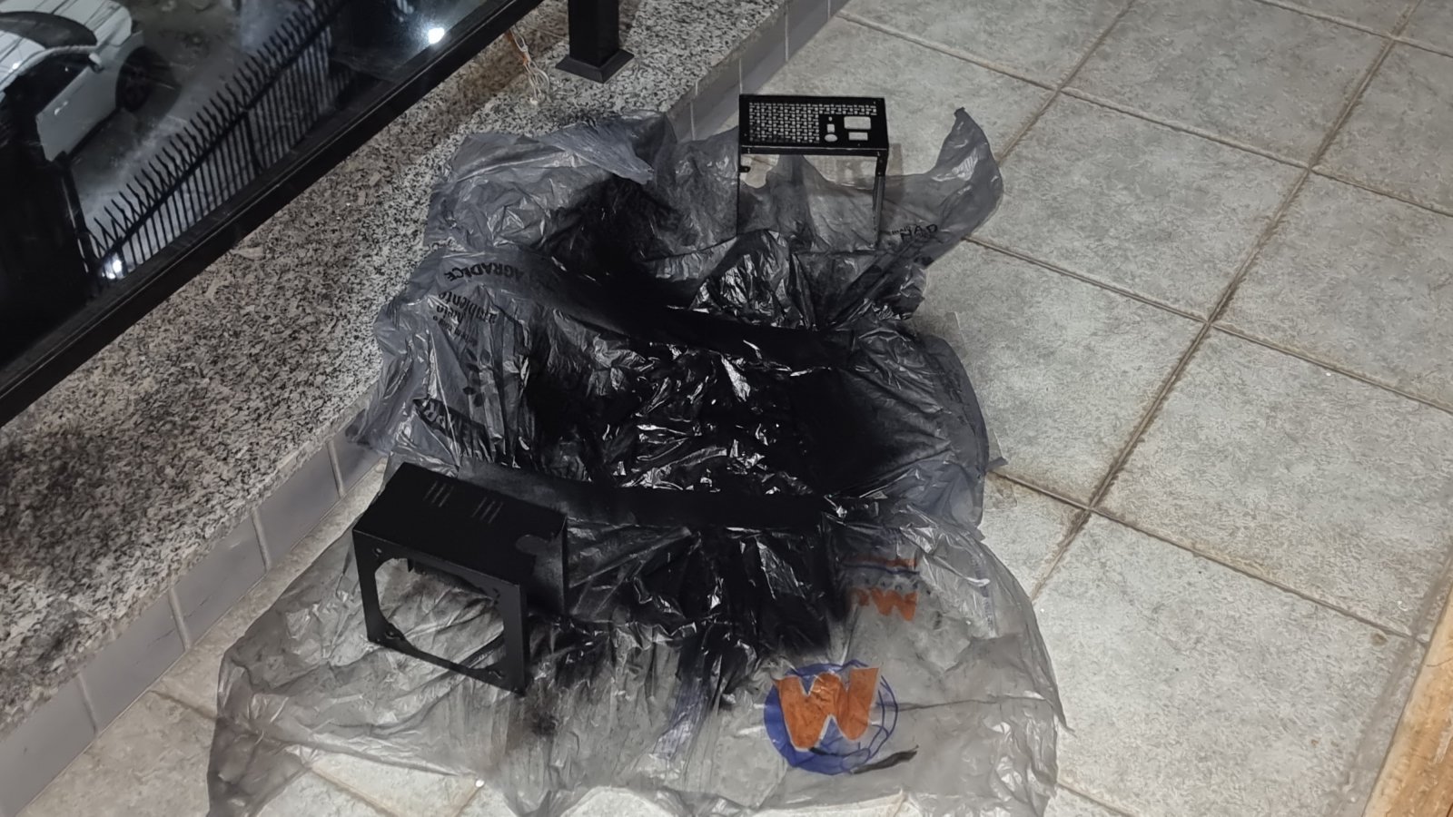

    I gave the power supply housing a coat of black paint, originally it was gray.

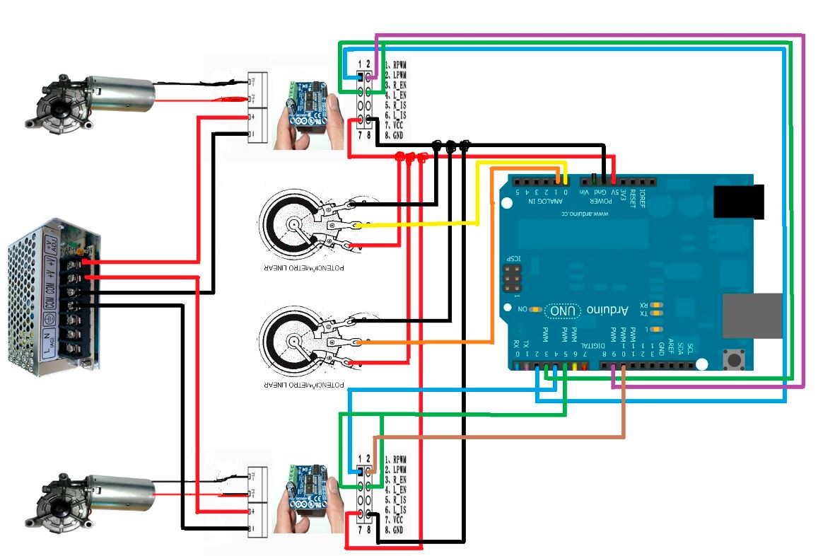

    And finally, I used the already known wiring diagram with 2.5mm parallel wires for connections between 24V power supply and motors with the 2 Driver Motor BTS7609.
    And our "Brain" is ready.
    I have an Arduino UNO R3 CLONE, so I had to install a driver to recognize the CH341 chip in Windows 11, but everything went smoothly. Firmware SMC3.ino v1.0 has already been installed without problems. In the next post I test with the SMC3 utils and engine. Here I will face the first challenge. I want to use Sensor Hall 49e instead of Potentiometer.
